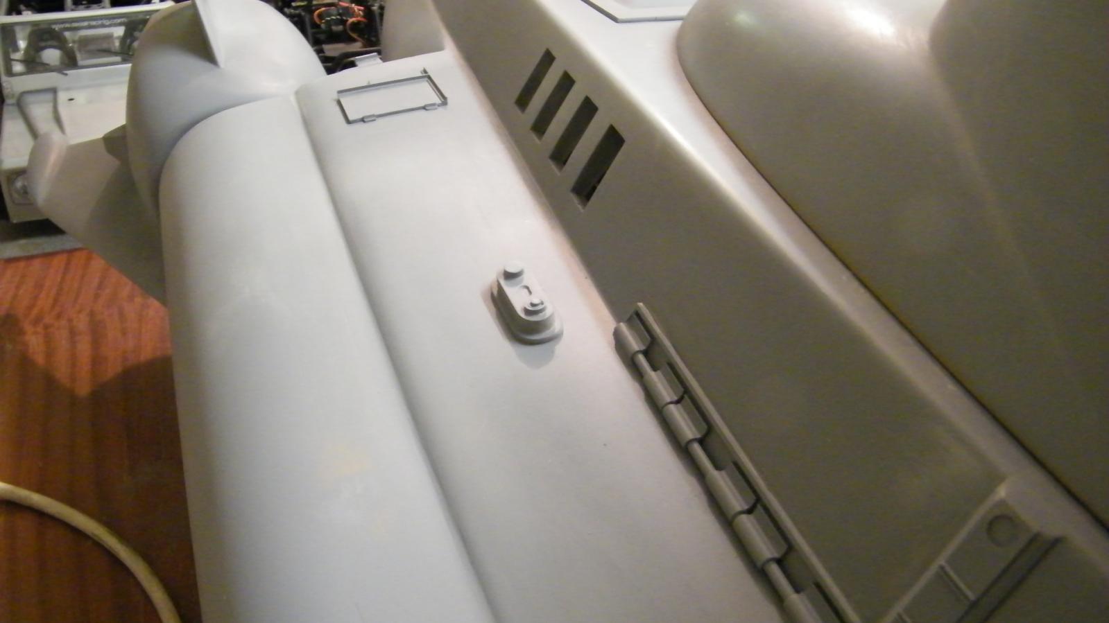

      Today was Pip day and the detail bit on the top of the Diver neck. Theres a round bit on the other side as well.

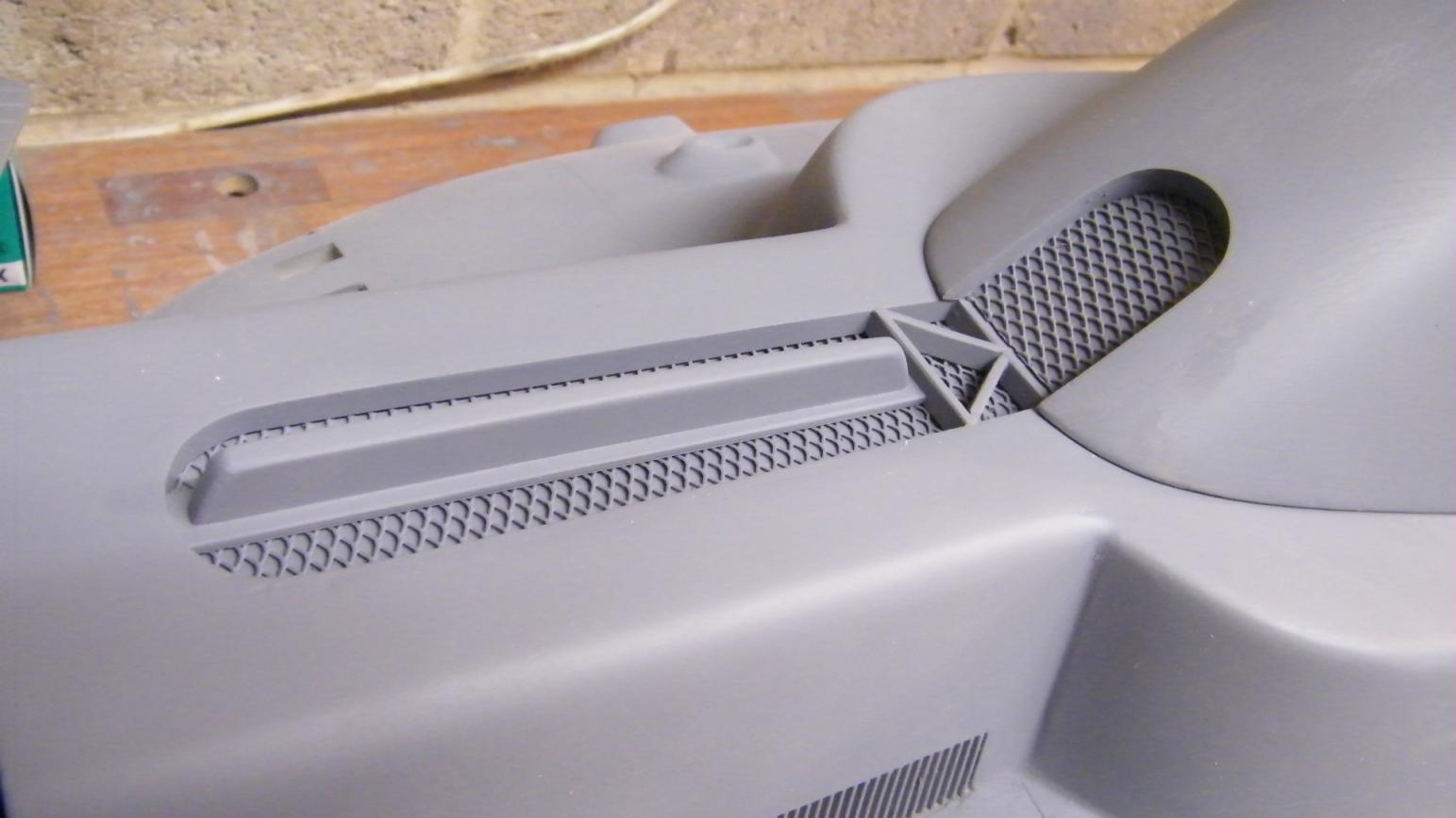

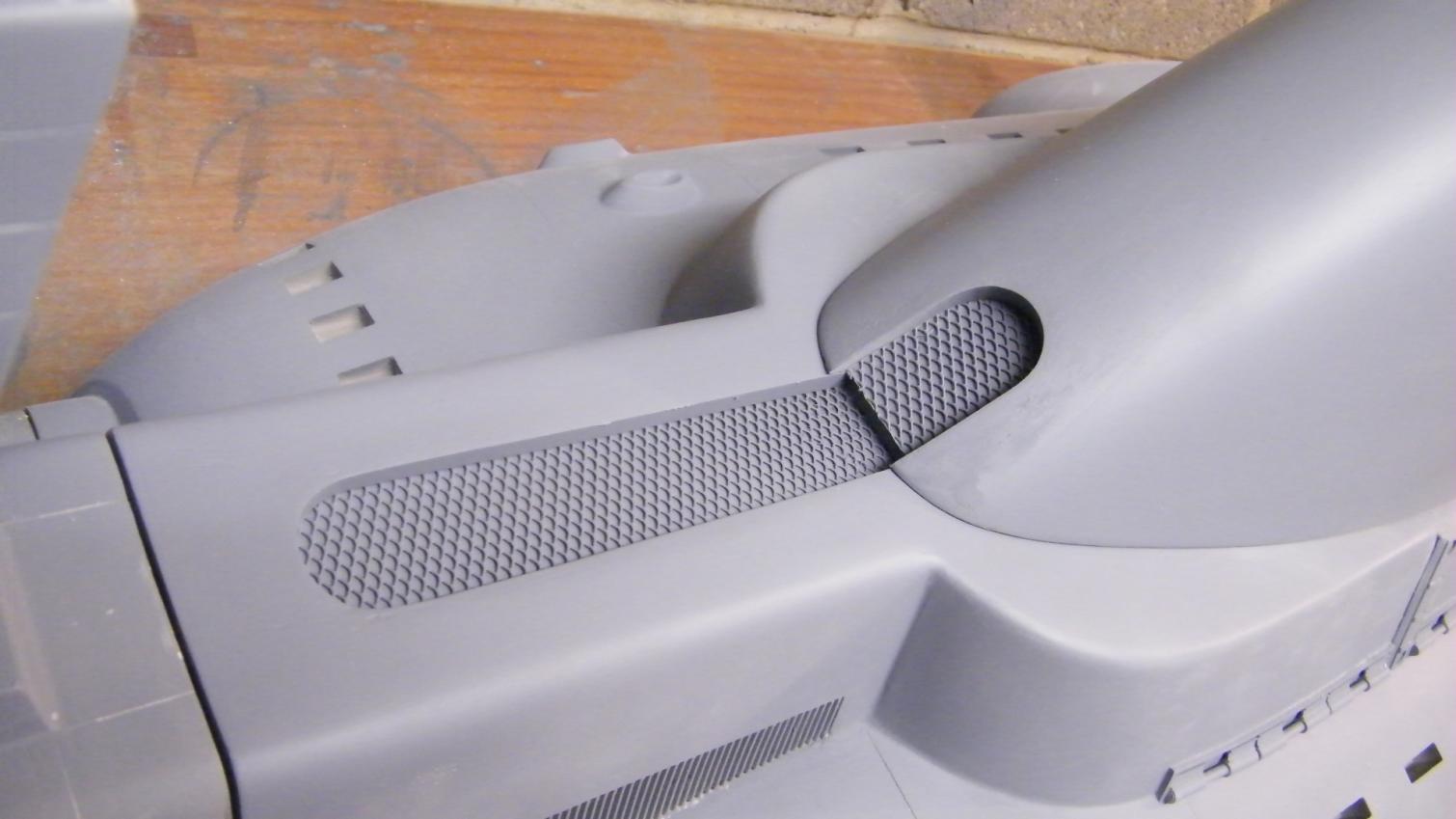

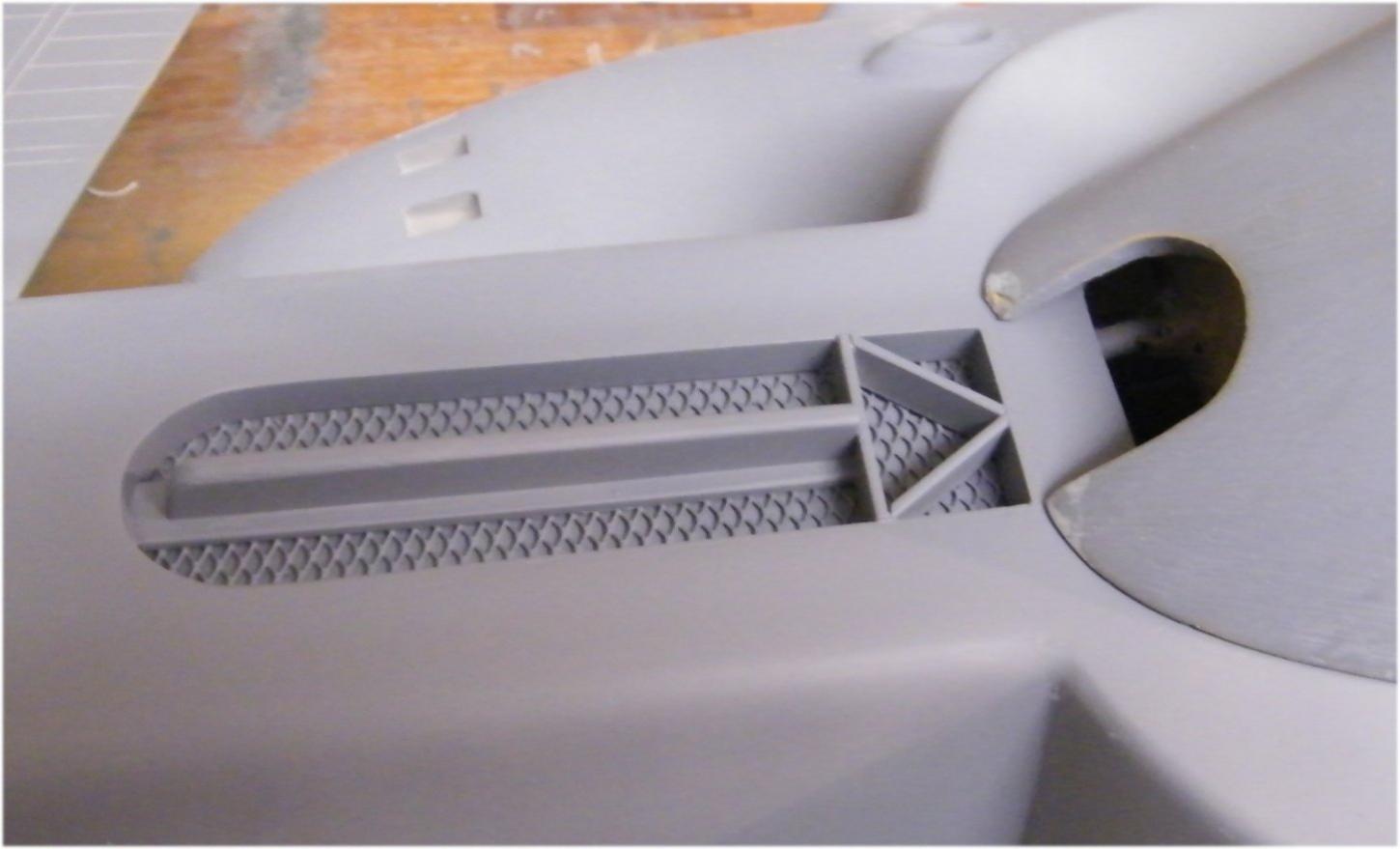

        Re done the top neck vent and did the coning tower part of it. Its one of those dont ask things,
          #109
          I think it looks better this way anyway.

            #110
            Top venty vent thing re done, Rear and front view

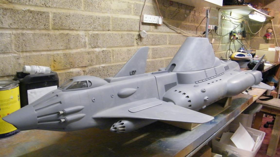

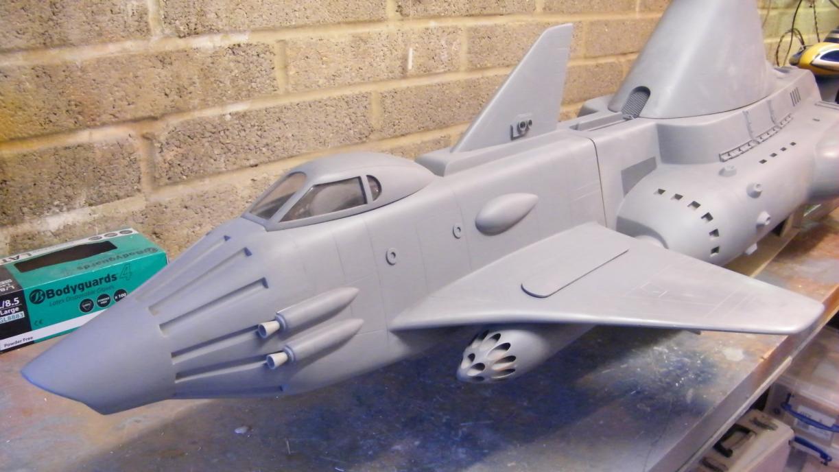

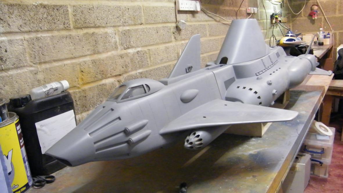

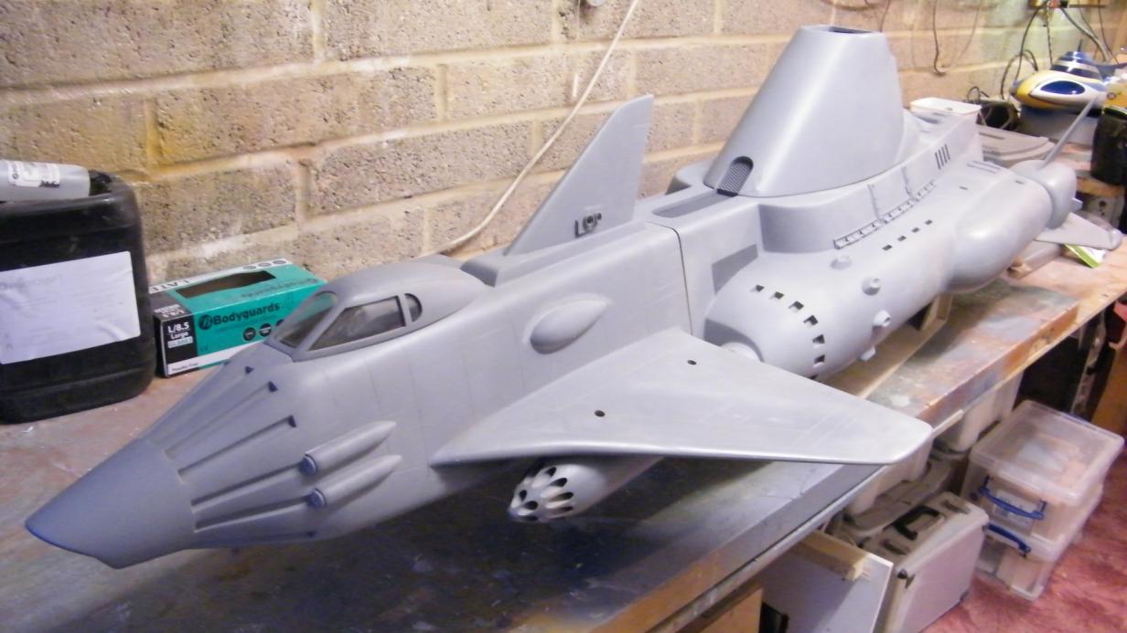

              Wing plates done (need to be contoured), side pips on, front gun nozzels in but removable.
                #112
                Did you find those gun nozzles in a kit or did you make them?
                • RCnut
                  • Apr 2012
                  • 441
                  #113
                  They are the ends of some Missiles from the spares box :)

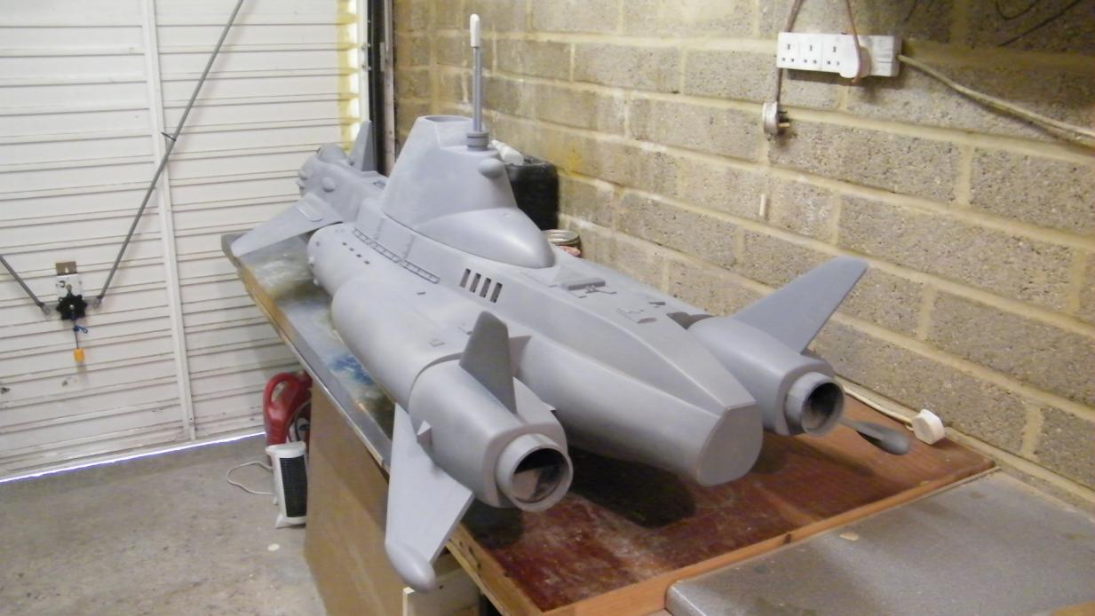

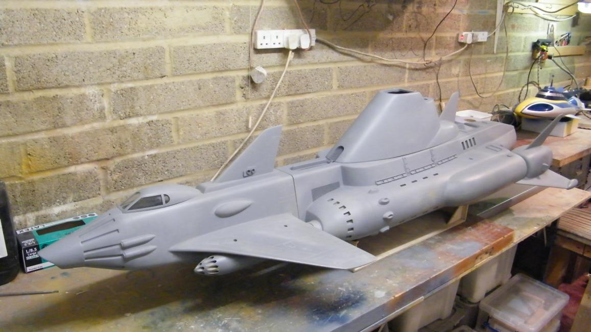

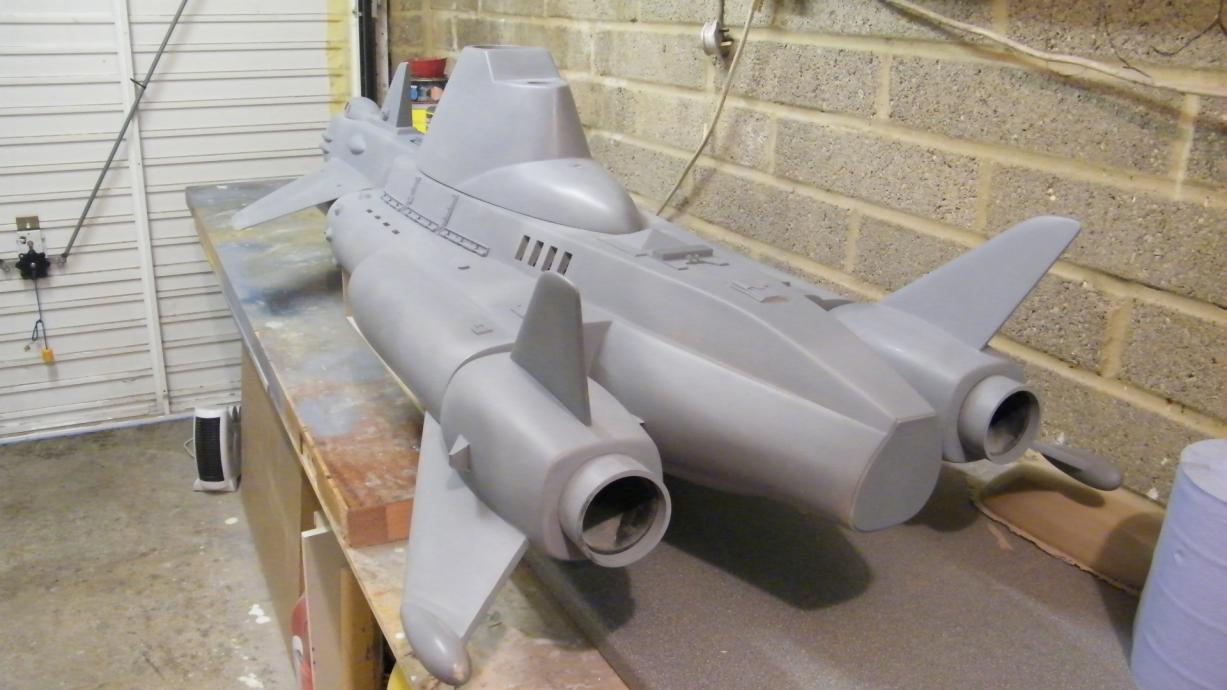

                    Well, Thats 99% of the building done, Minor stuff to do which should be done tomorrow, Then Paint.
