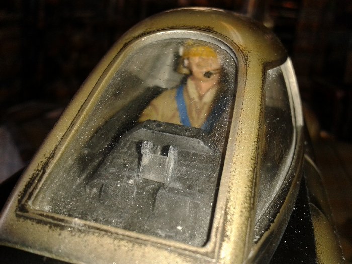

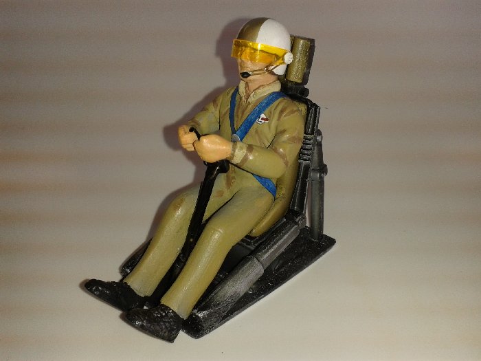

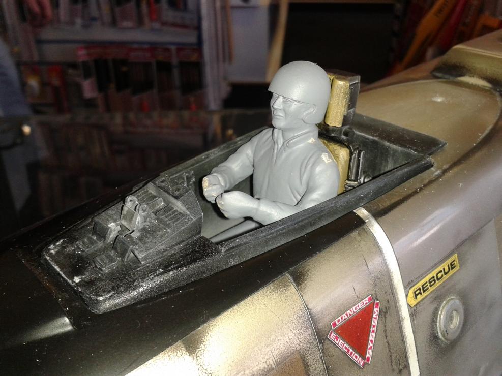

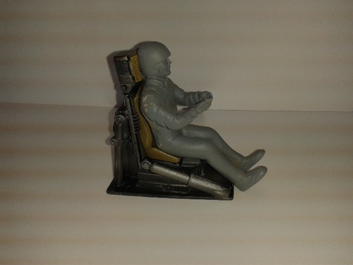

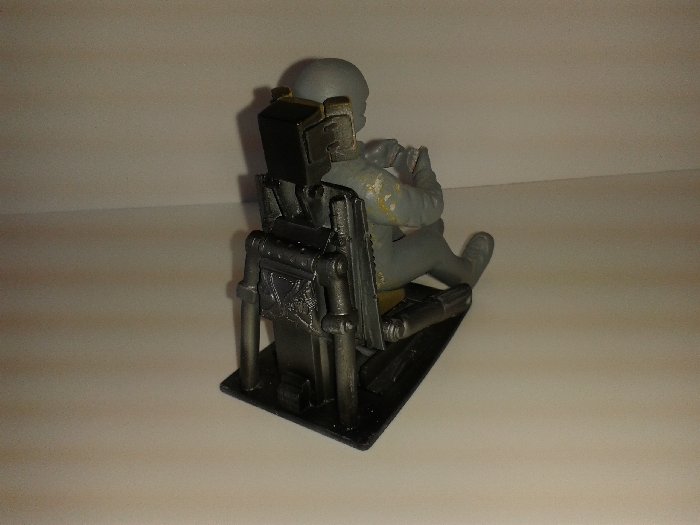

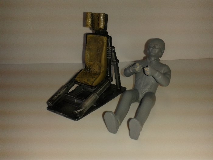

        Been doing some remidial work on Sky1 nose and also Seat and Pilot done, Pilot is a Tiger Joe Gunner as used on the original with the addition of Legs. Last pic In situ.

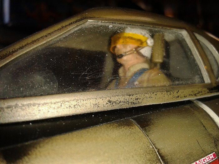

          Painting done, not the best but then I hate doing figures (I'm no good at it) Anyway, couple of pics in situ. Well thats it for Sky1, unless I think of anything else. On to the Diver and jet install.

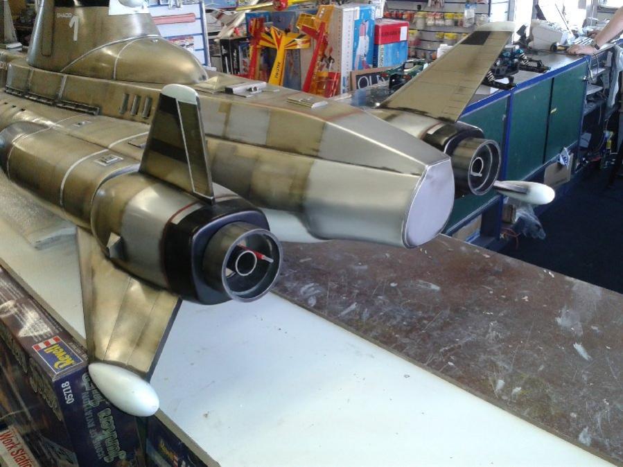

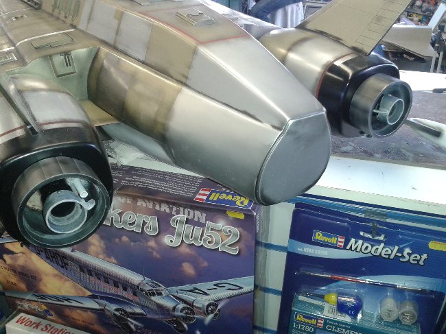

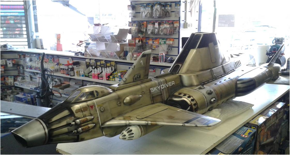

              Well here it is again, This time with the new nose and all plumbed up water jets, Might take it out on Sunday to give it a test run. I will be adding vectoring nozzels on the jets to assist steering.
                #187
                COOL! Whats the red pokey thing sticking out of the nozzle?
                • RCnut
                  • Apr 2012
                  • 441
                  #188
                  Those are the snake lines to turn the Nozzles that I will be adding.

                      Made up the nozzle parts, they are removable for display. I may have to add a central vane as they are really short...... To be honest I hate having them there so if it turns well enough without them, then there coming off. :)

                          At the moment it is, but my main concern is how it goes on the surface. I just tested the jets in the bath and was a bit peeved to see water spouting out of the join between the the impeller housing and the stator housing (Graupner jets) the plastic has cracked in places so I have dismantled them and used UHU Por when re assembling them. I have left them to dry overnight, Ill try again in the bath tomorrow and see how it goes. After having hooked up the nozzles I found them to be totally useless. Way to short, so they will need a central vane at least before they have any effect.

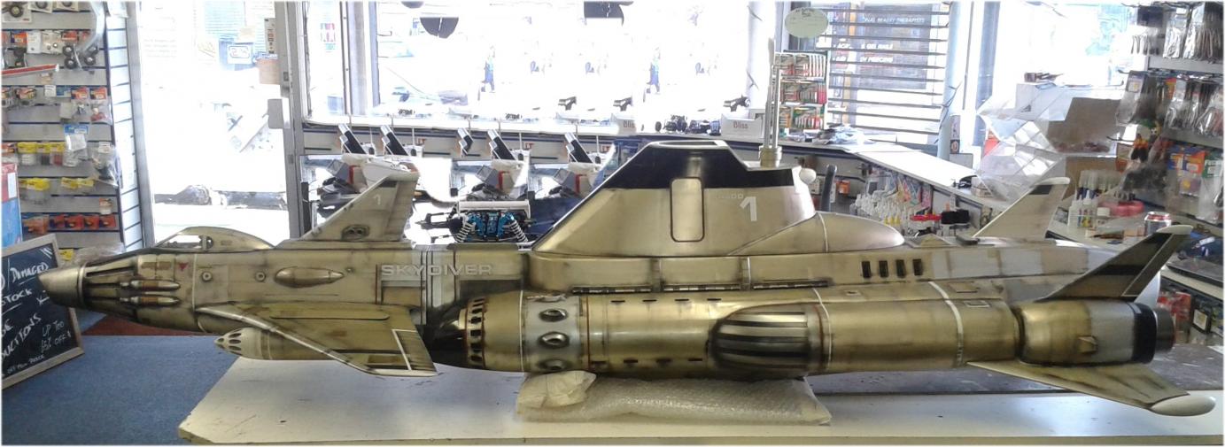

                            #193
                            Went out to test this today and as soon as I put it in the water it was plain to see it was dipping way to much at the front, But I thought what the hell. Obviously I will be making some adjustments and go again next week :)
