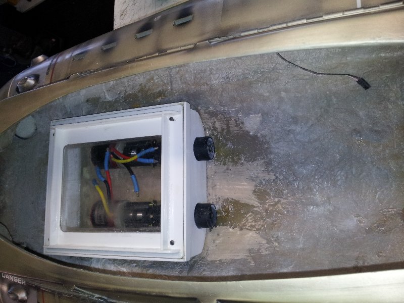

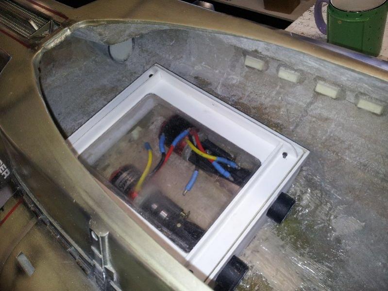

                      Ok Just replaced the Graupner Jets, they were failing under the load, So I have installed New Kehrers, I am keeping the Brushless motors so a direct comparison can now be made between the two different Jet drives. I have fabricated a waterproof Box Just for the motors and jets and if this works as well I will be thinking of ways to get this beast under water in the future.

                        Looks great! I hope that they are big enough
