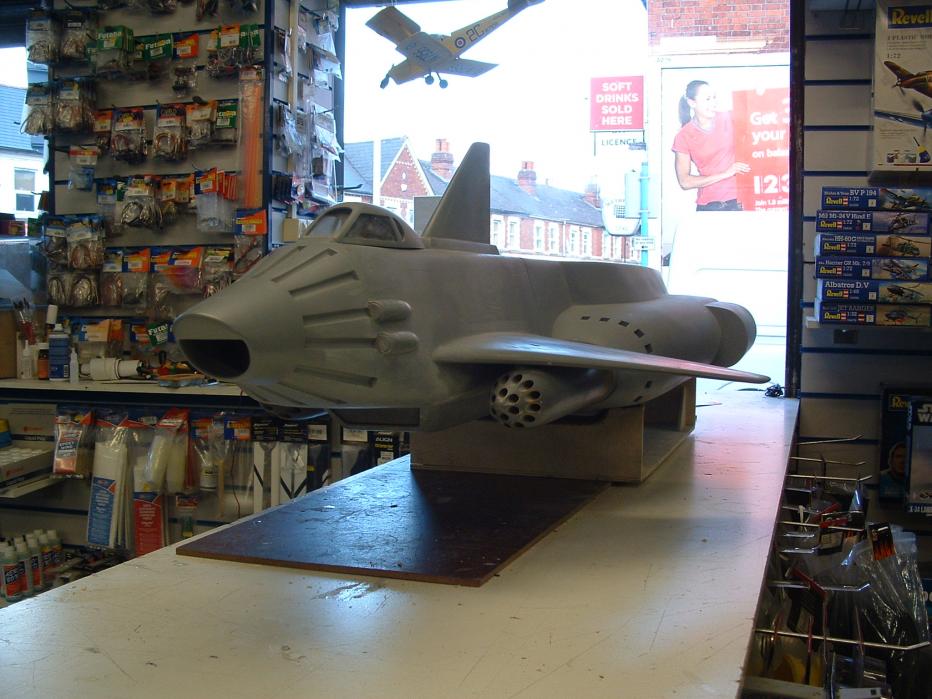

    Side Gun pods back on, Still a few niks to fill.

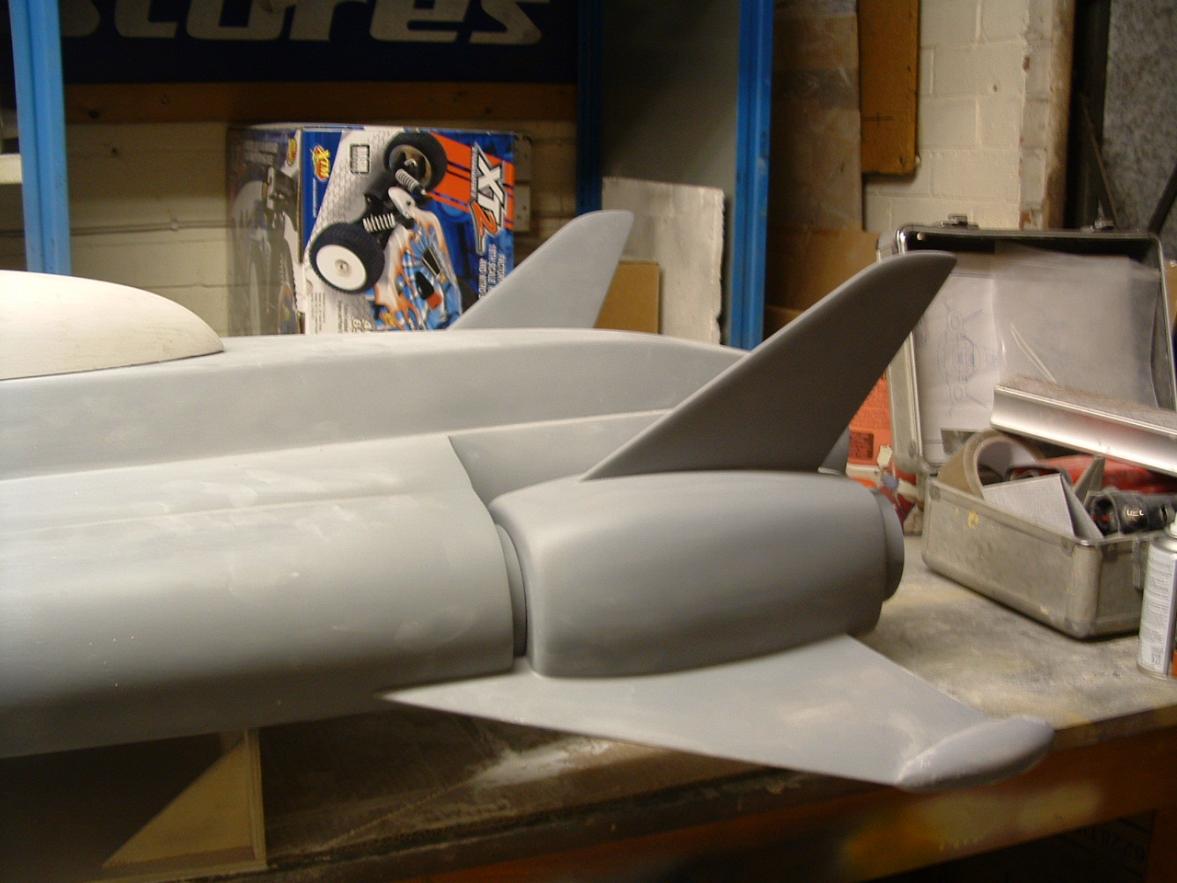

          #49

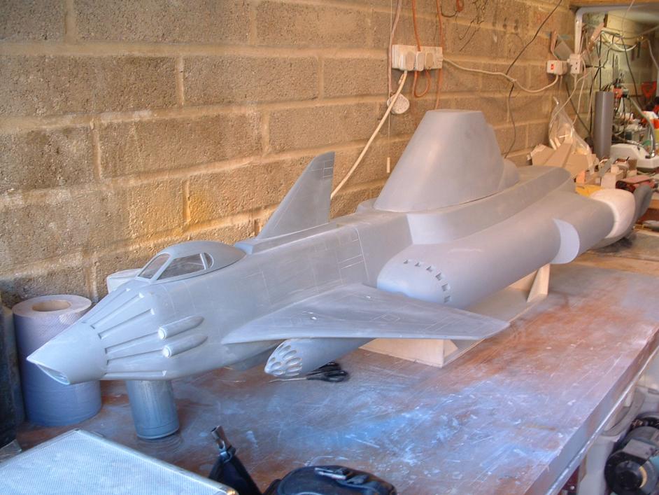

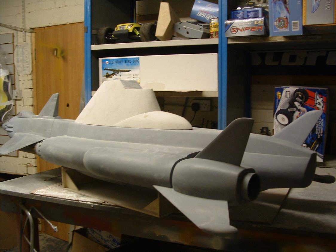

          Its quite big is it not, Engine pipes in and just been re enforced from the inside.
            #50
            A Monster! You could almost ride it.

              #51
              Yep, Thankfully the engines will be removable to asist in easy transportation.

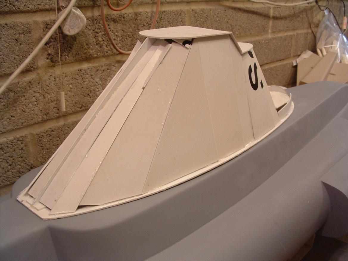

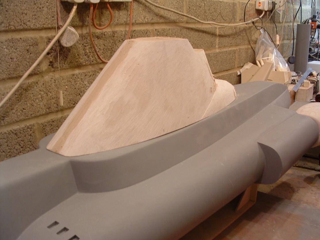

                #52

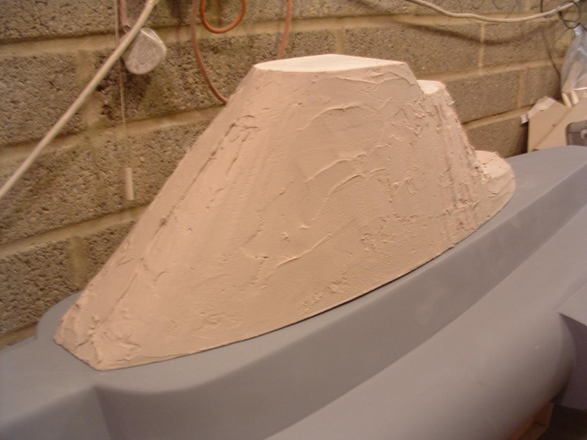

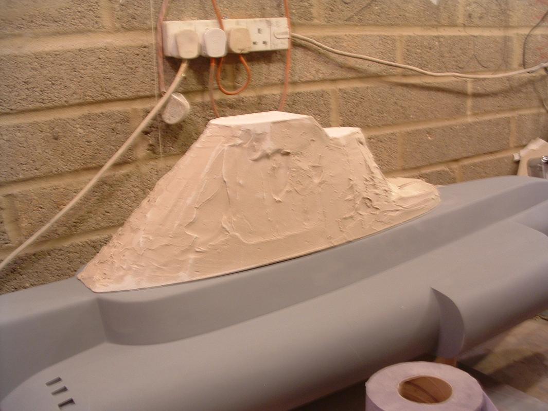

                Basic shape of the conning tower. Filler plastered all over it then screeded :)
                • RCnut
                  • Apr 2012
                  • 441
                  #53

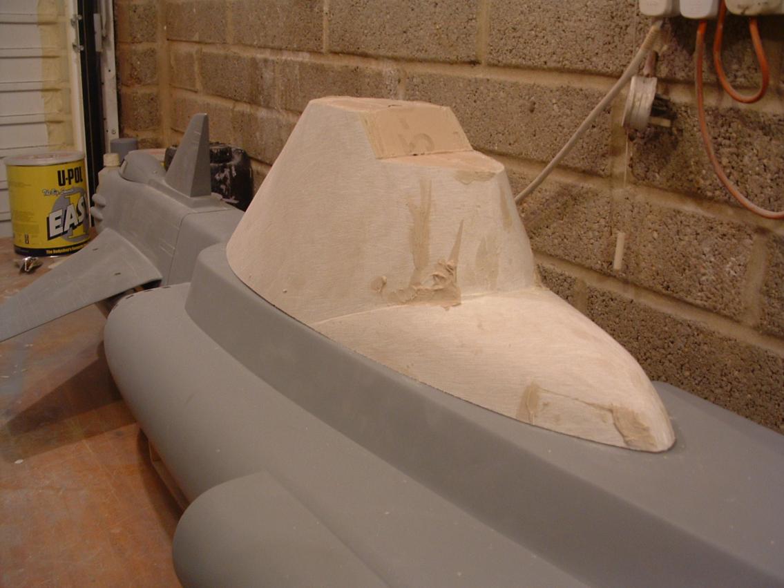

                  All the plastic taken out and and surprisingly enough its turned out quite nicely. Still a bit of sanding to do.
                  • RCnut
                    • Apr 2012
                    • 441
                    #54
                    Spent most of the day with a dremal (Home made) and thined the inner walls to the point where I went thru in some places, Fibreglassed it inside and gave it a first primer indicator coat.

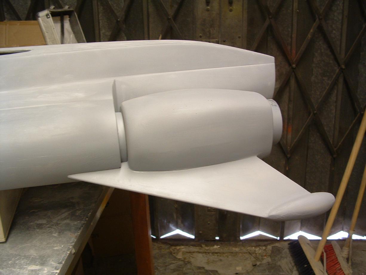

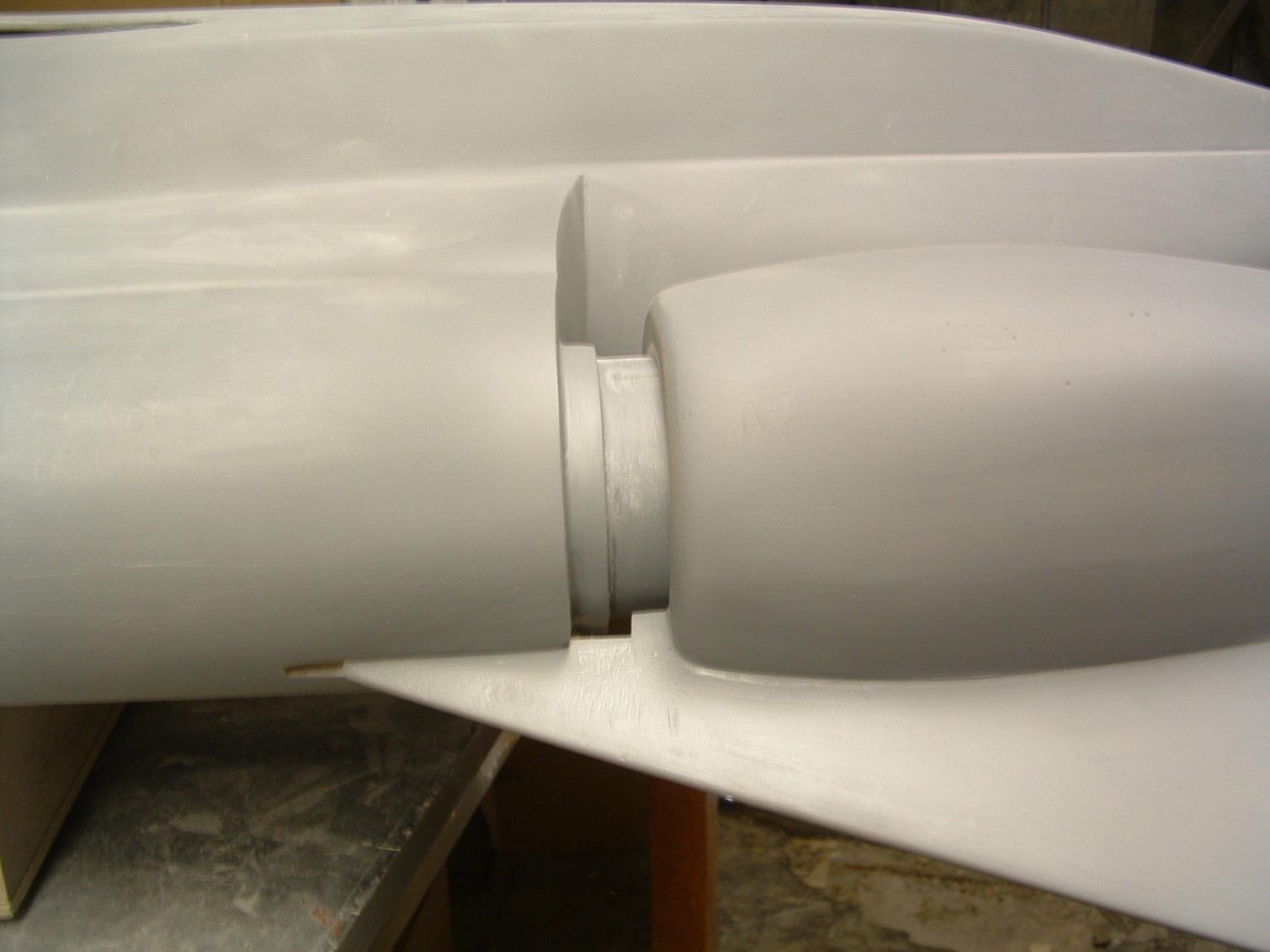

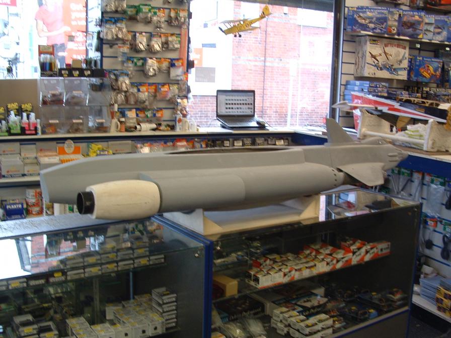

                      #55

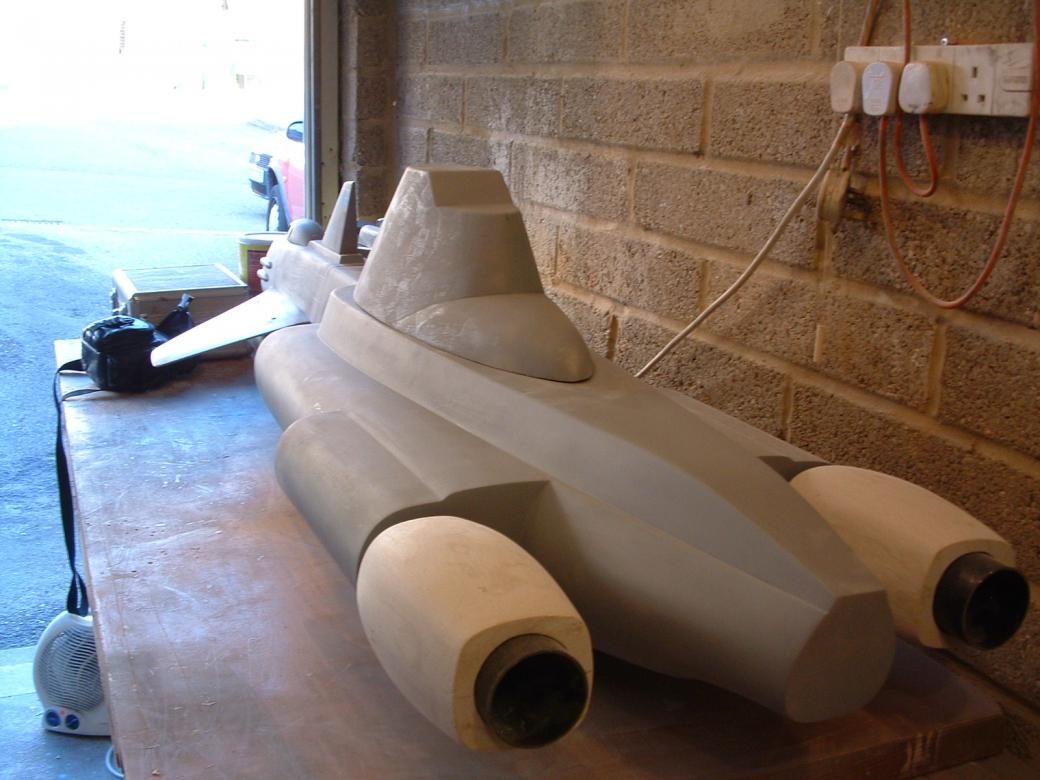

                      Sorry to jump ahead a bit, engines are on and removable for ease of transportation. they will be secured by the engine nozzels that I will have to make.
                        #56
                        Looks Good. Ive got to come up with a way to do my 3 footer. Those pods will have to come off to access the propulsors on mine. Still thinking about it.

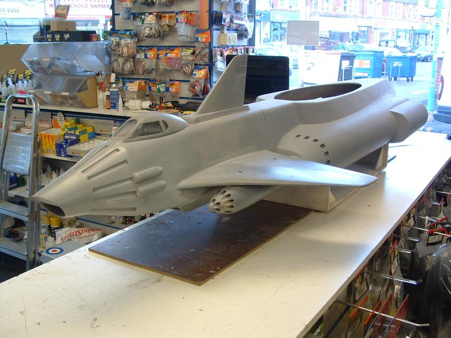

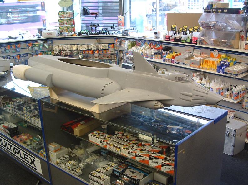

                          #57

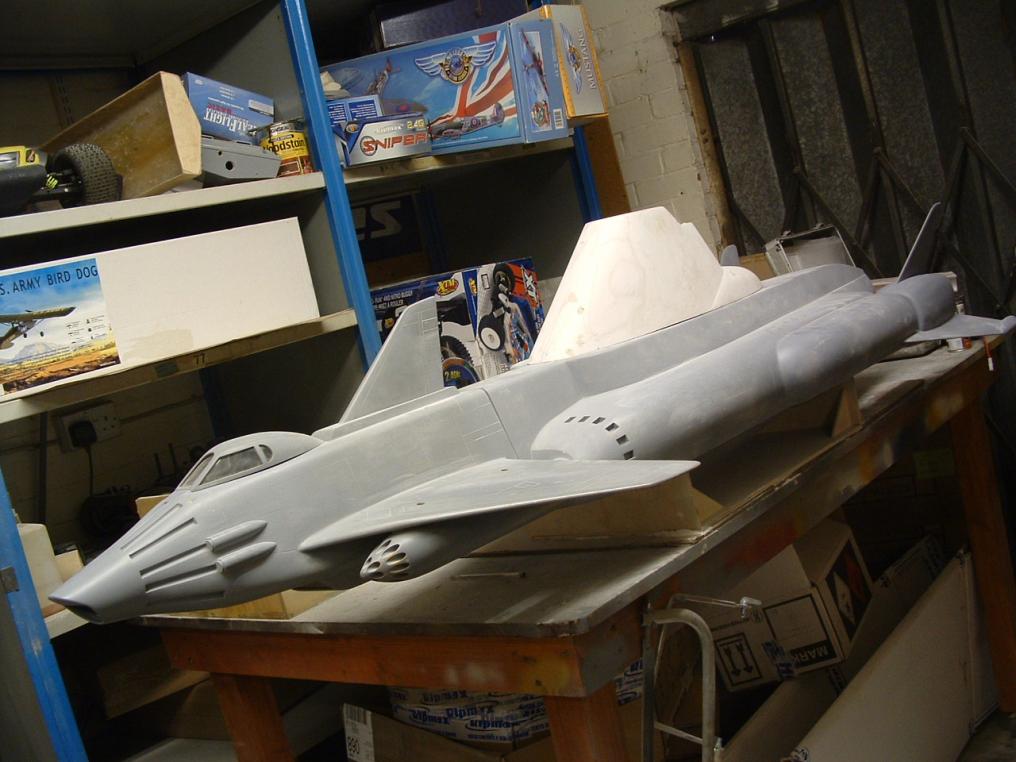

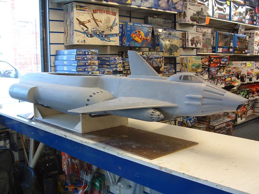

                          So thats all the major parts done and assembled now. All thats left is the small details and scribing, oh and I still have to finish the conning tower And install the jets :)
                            #58
                            Mamas, any suggestions on how to hold the pods on my 3 footer?
                            • RCnut
                              • Apr 2012
                              • 441
                              #59
                              Yeh, same as I have done :)
                                #60
                                Unfortunately I cant tell how they are attached. From the inside with screws?
