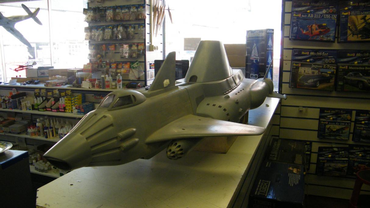

    Oh and could you have posted a bigger picture lol. :D
      #92
      Good, please show me everything on how you cut the recesses and keep them looking straight. Thanks

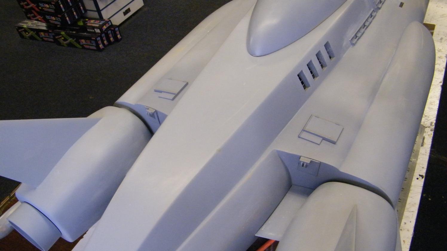

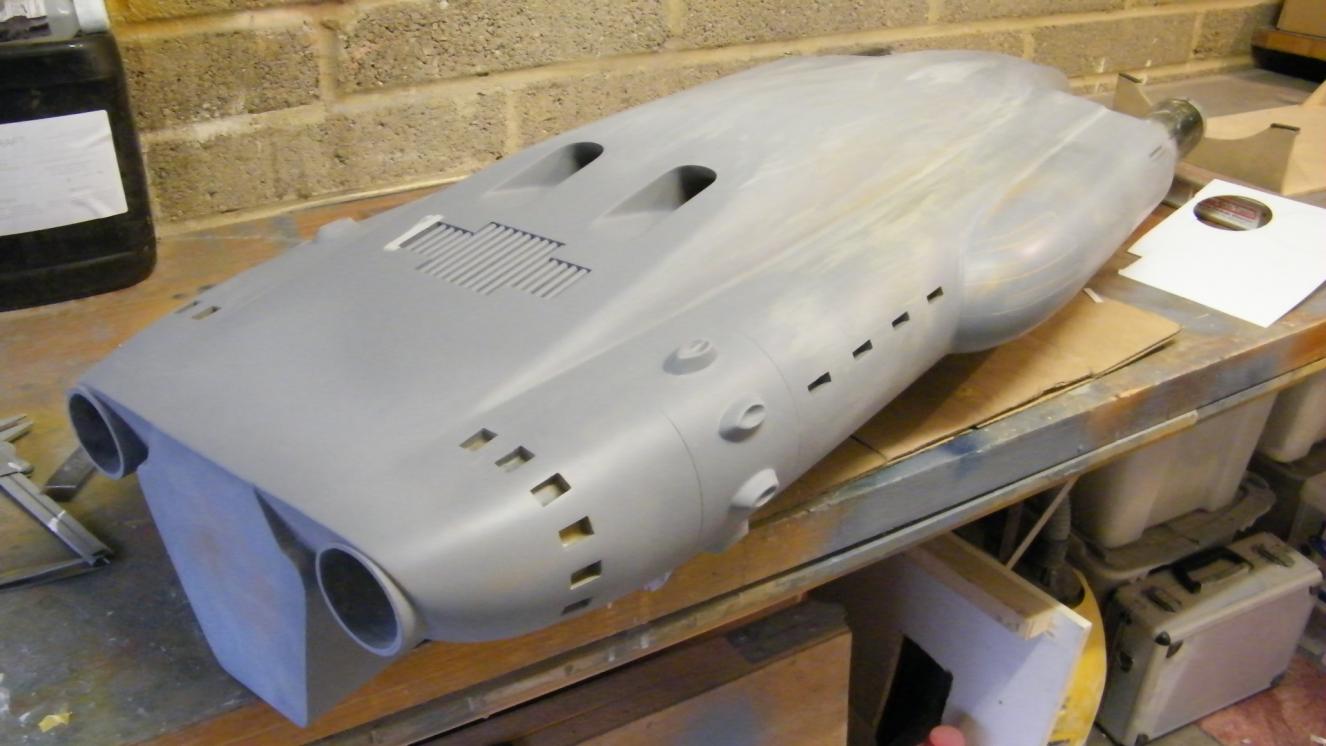

        Back on this now as well, Added the grid vent tubes and If you look closley you will see I also defined the side venty things. Mark, I did the side vents by Laying down 10mm strips of Tamyia masking tape where the black areas would be, I then Plastered the area with Primer, Filler Primer and then Primer again. Removed the strips and Hey presto!.

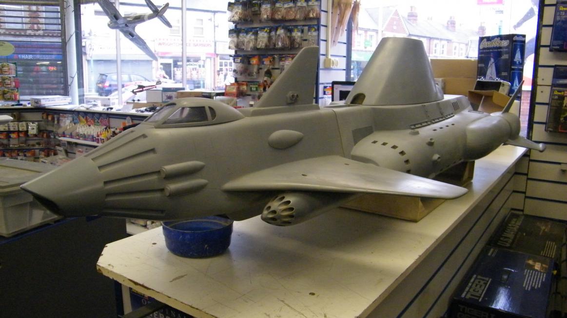

          Another what I did today pic, Dont look like a lot, All six of those pipe type things had to be exactly the same and as I dont have a lathe to do it with, they were all tediously made by hand,

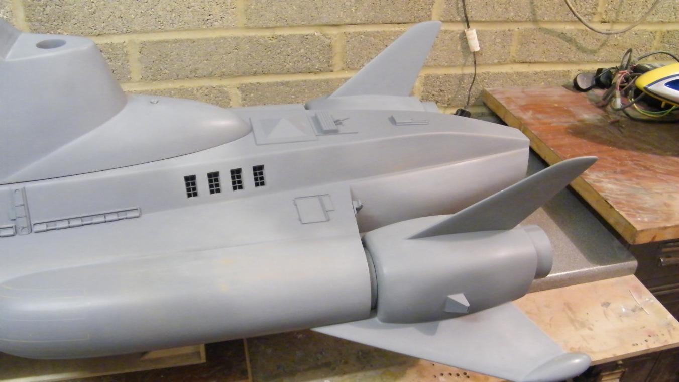

            Finished off the Side ballast venty things, and also stuck the side blisters and fin thrusters. All these technical terms huh.

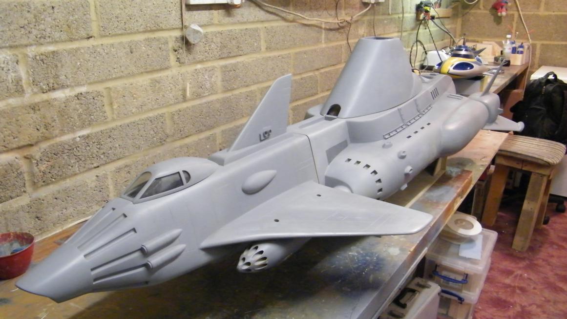

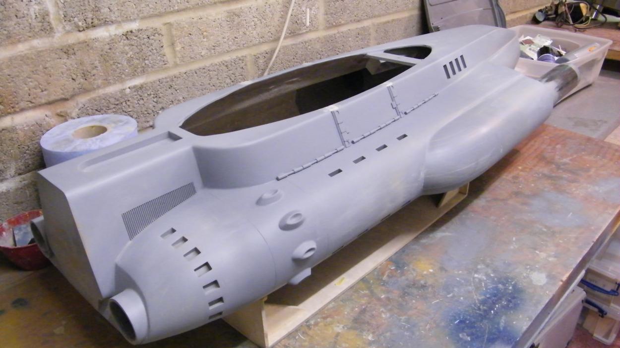

                        Latest pics, Just the 4 bits added today, was quite busy in the shop lol.

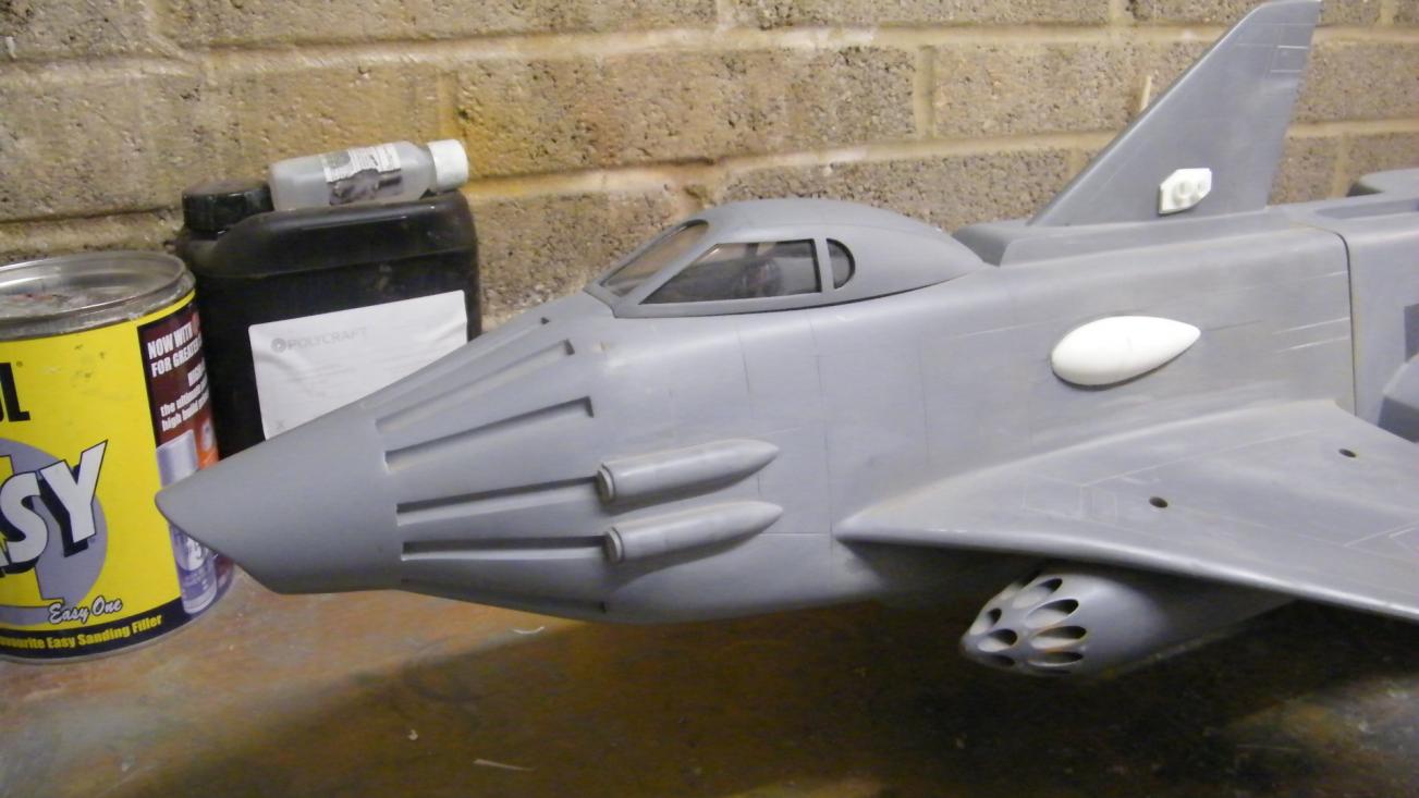

                          Well Heres what I did today, three enlarged Kit parts behind the sail/conning tower. The 3/4 shot had to be there
                            #103
                            That things big enough you could put two "McCullough chain saw engines in there, for surface propulsion!!
