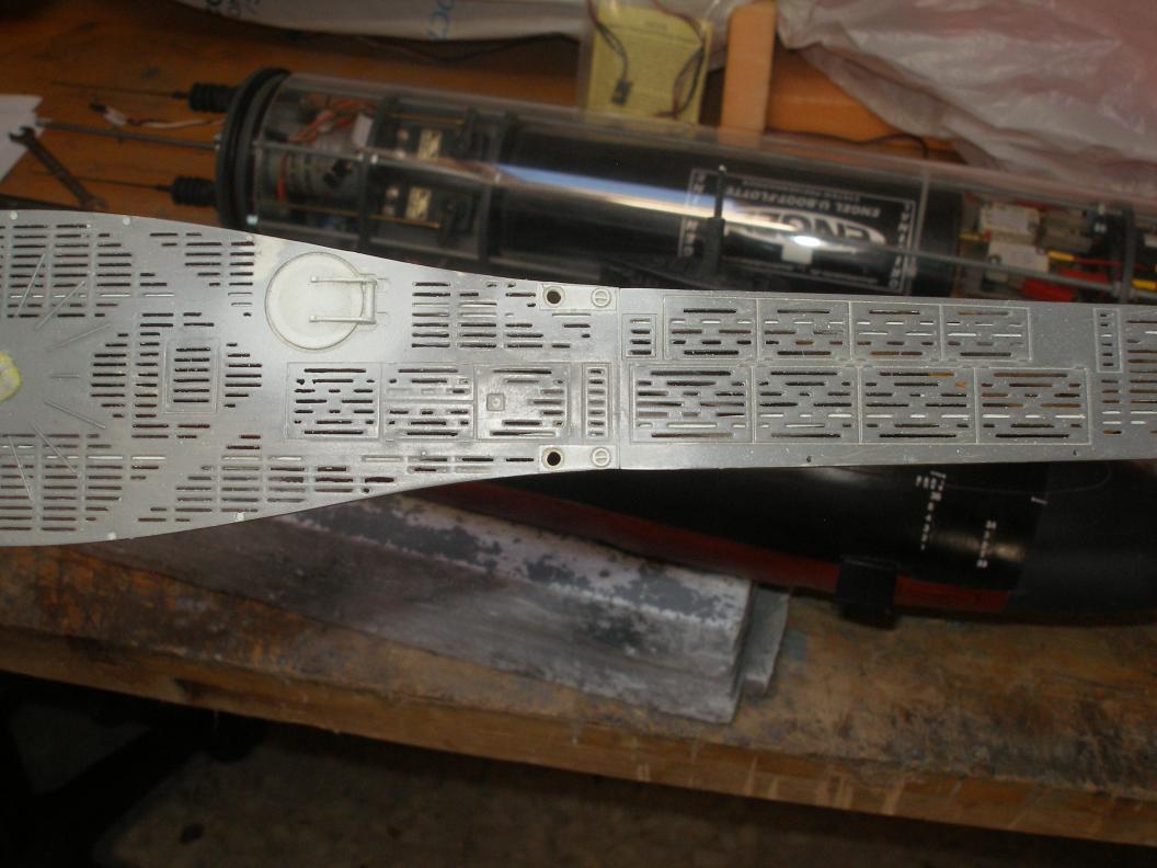

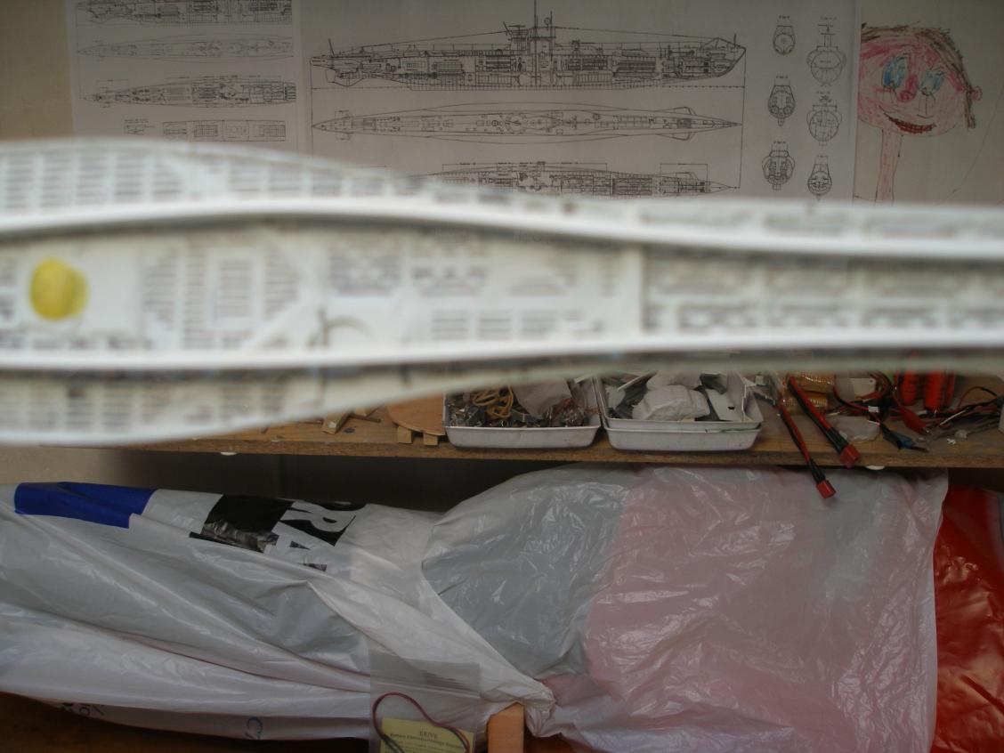

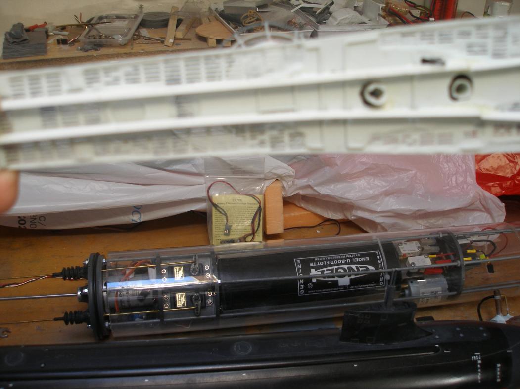

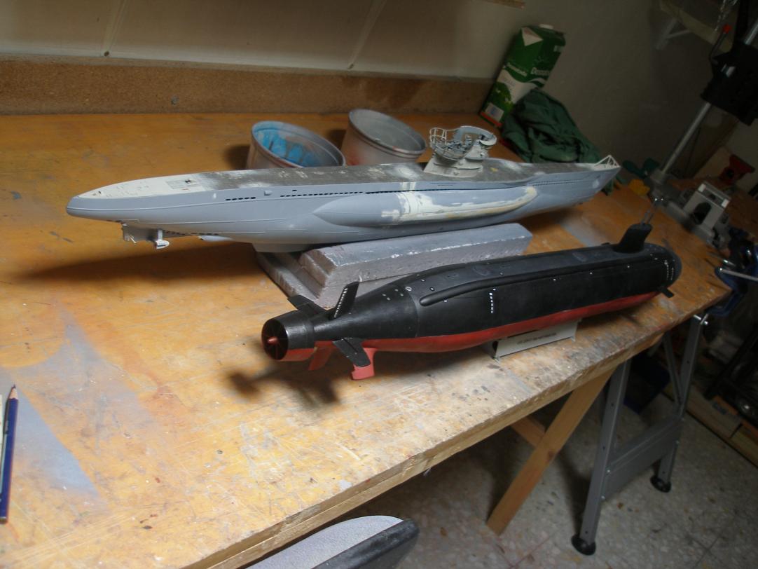

                  I reinforced mine with plastic beams below and had no structural problems with it. regarding air or water trapped under deck, there wasn't any problem at all with water when diving; you can see some tension with it when surfacing. And with air, the main problem is the bubble trapped under deck's rearmost part, where there aren't any slot. Click image for larger version

                    is that a mini engel tank in there?
                      #100
                      custom job maybe, probably around 250 ml or less.

                        No, is a 650 CC normal one. It's an optical effect cause the deck is nearer to the camera and a little bit unfocussed. The ENGEL tank is the one fitted for my AKULA II.

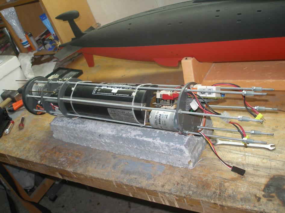

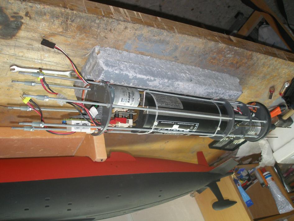

                          Hi. AS I've been requested about how I've fitted the stuff inside muy VII C, here I send you some pictures about.

                            A bit blurry. Maybe you could repost it.

                              I',m sorry, but are not able to upload this and another two in an apropriate size. Keep trying
