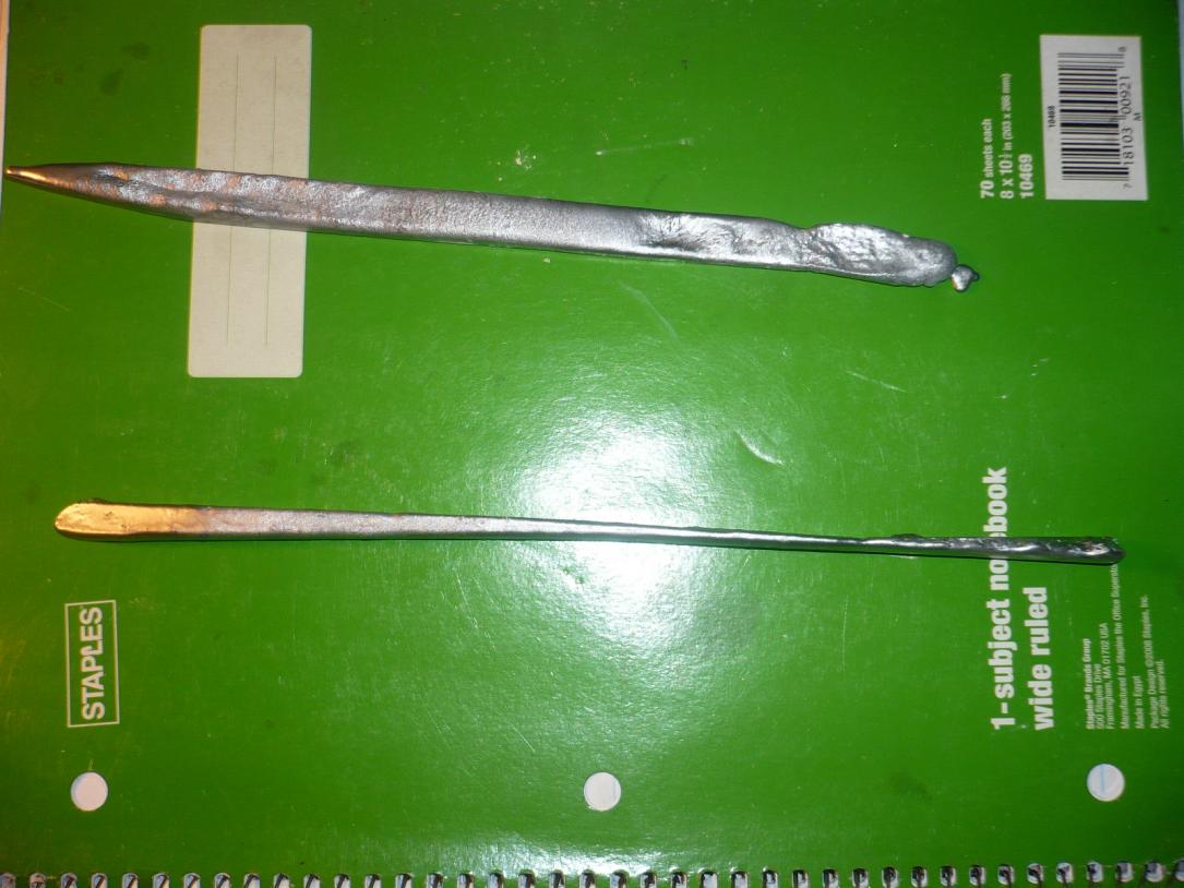

        well try 1 epic fail. mould to deep makeing another tonight.heres what came out not so good.gonna keep trying.. ackkk just broke the log positivegoung to have to start from scrach tomarrow... such is life...the saga continues..

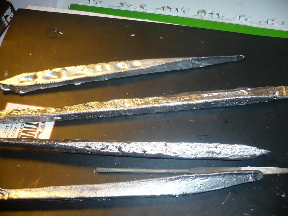

                  had a better idea to day and will post pics tonight and will explain then..overengineered the plan that was the fail....

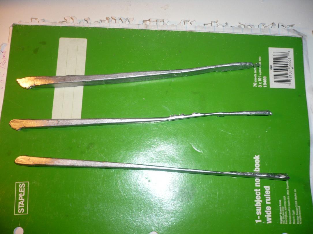

                    ok 1st fail,didn't measure the amount of lead poured.2nd fail mould too deep..got a good idea of how much as 4 oz of lead is. working on a mould that is not as deep and has a removable bottom to allow weight to be pushed out if this attempt fails..tried crisco as a release agent will try car wax next if crisco fails. also need to scoop/bevel the upper edges to make a better release . i think this one will be in the ballpark as today used only 4oz per pour. now i think have a workable ft and rear keel mould but have been down this road before...
