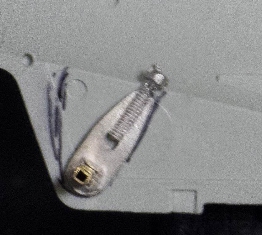

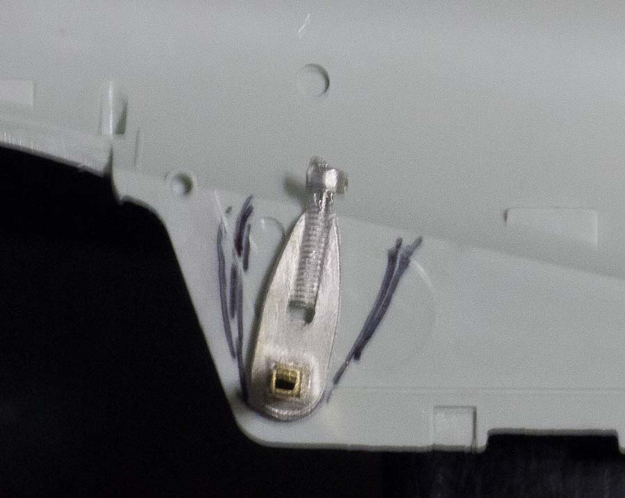

                  Ordered more tools to make the holes and pleasantly noticed that the props are both left and right hand. I am surprised that only one speed controller is used as it would be advantageous to run each motor independently in order to make tighter turns especially in close quarters.
                  ON a second issue, the area to shave down for the stern plane control is smaller on my model than what is display in the Cabal Report #1(see attached photo). Is this okay and to make the two halves fit the amount of plastic left over in the area is going to be fairly thin.

                    Increase the area you're going to grind away aft; make that after cheat-line parallel with the after edge of the skeg.
                    Yup -- paper thin! Use a back-light to gage your work as you grind away.

                      If I remove more material aft, won't the screw head either bump up against the wall or move below into the skeg causing the magnetic coupler to disengage?

                        Also is it better to use 120 or 240 grit on the Dremel?
                          • 13982
                          Thin down the plastic shank of the Kli-Con and it will get down in there to follow the head of the stern plane bell-crank. Use #240 is quick little jabs using light pressure, keep a damp rag nearby and use it to keep the plastic near room temperature.

                              RE: aft skeg,
                              Depending on how much material you remove and where, I suppose needs can differ from one build to another, but I will share that I once slimmed down the Kli-Con connector as David described, but I found that it wanted to get stuck if it went down too far into the cavity, and the opening was as wide as I dared already. This may not be the case for you, but in mine the original connector width worked better, as it rides over the top of the skeg opening and never binds. Even tho at full aftward throw the magnet may ride up a bit to the top of the bellcrank screw, there is plenty of throw angle for the stern planes. It may not look like they are moving much, but you will be amazed how effective they are in the water the first time you dial in a little down angle.
                              -Kerry
                                • 13982
                                25-degree up, and 25-degree down from zero is plenty on this set of stern planes.
