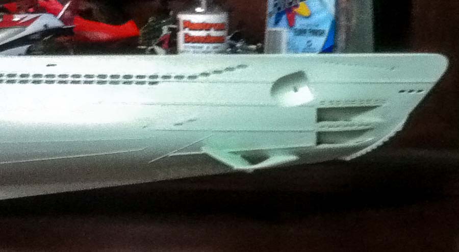

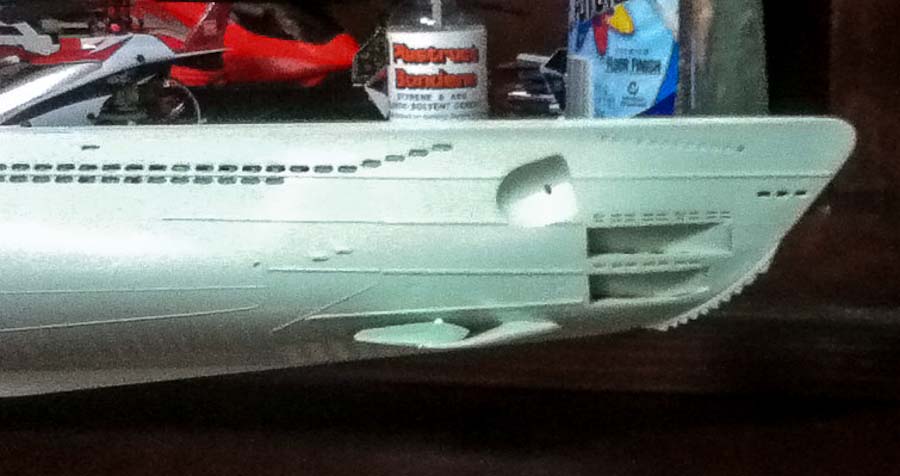

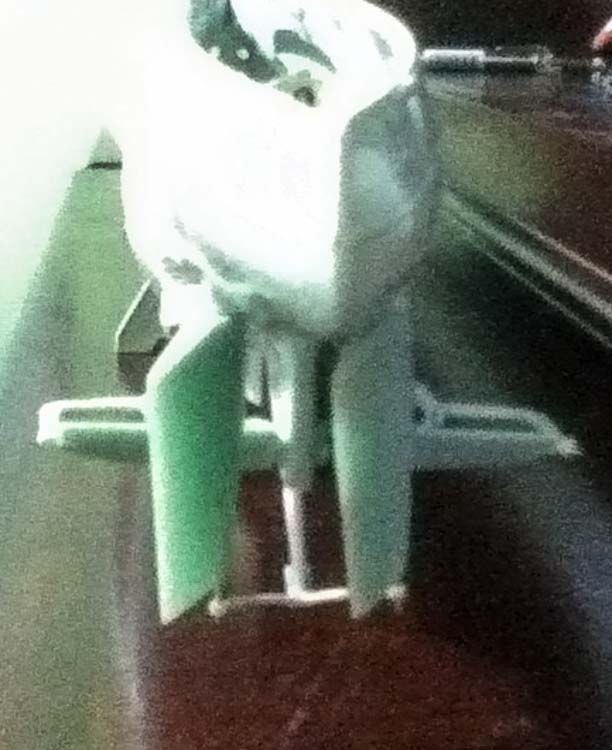

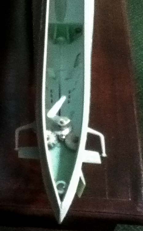

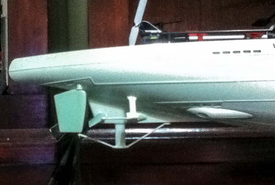

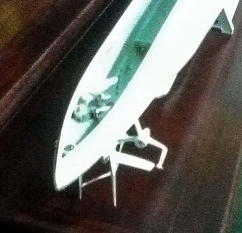

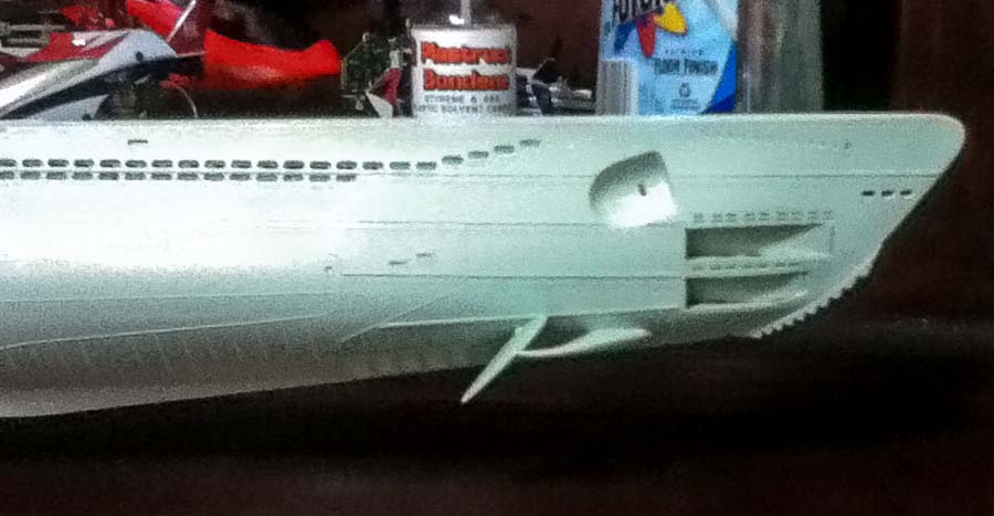

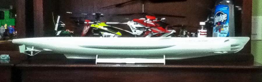

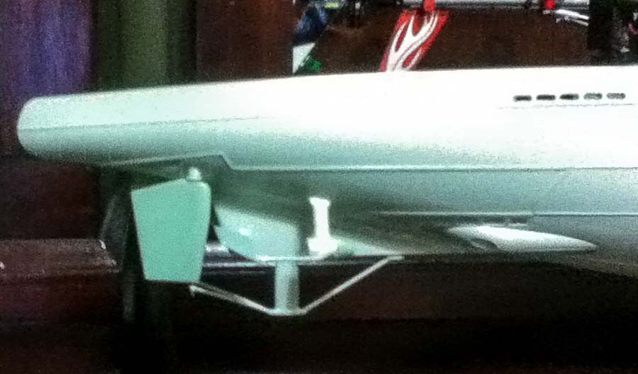

                          PS: I added some pictures of my progress, pretty poor quality from my iPod Touch. I'll do better later, this was a quick thing.

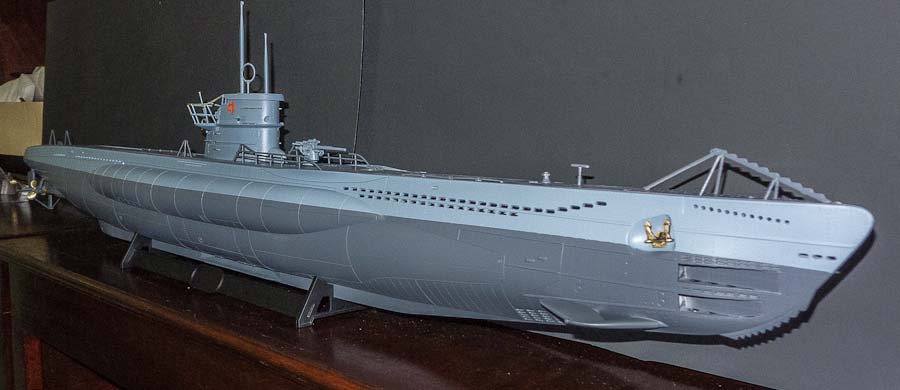

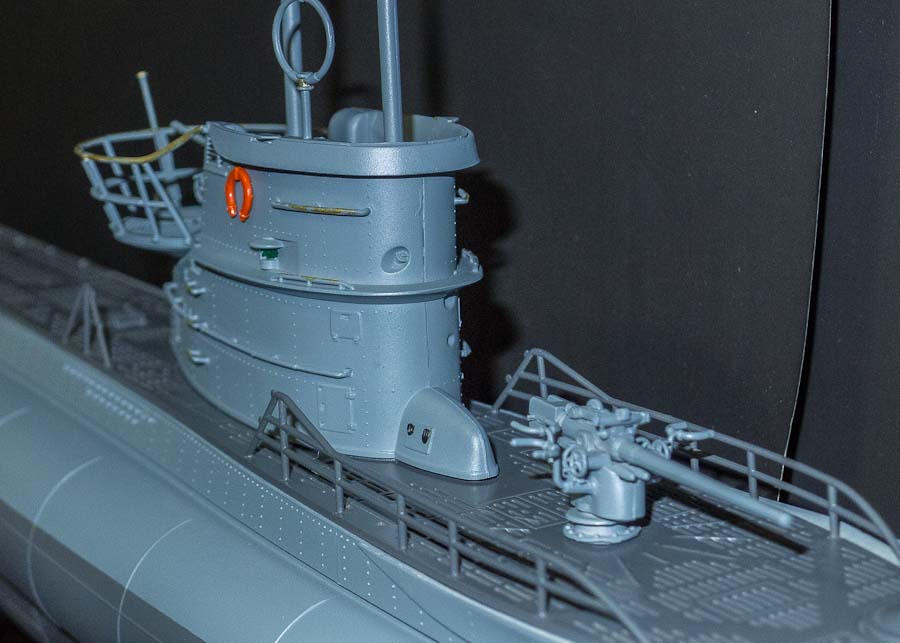

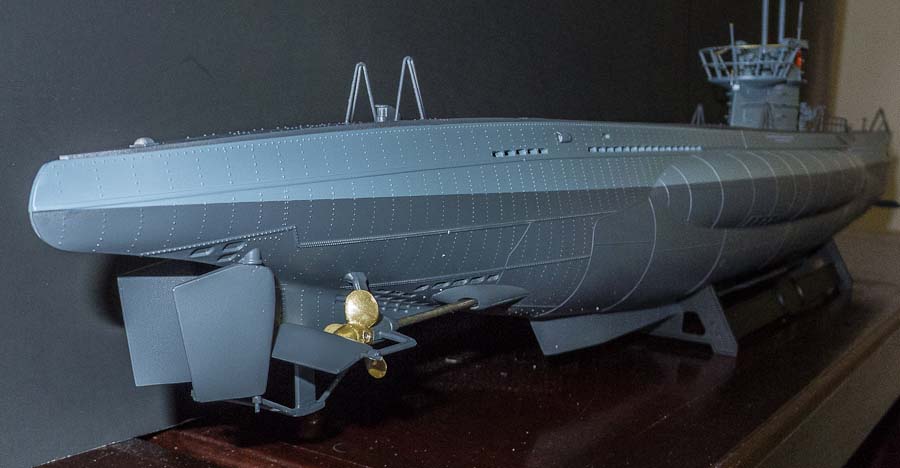

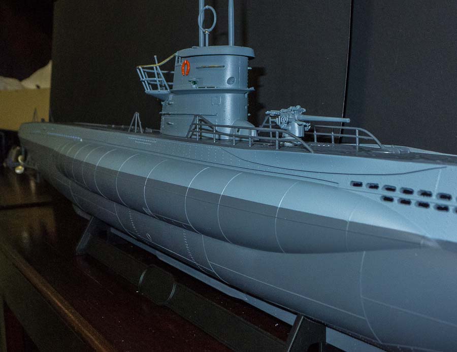

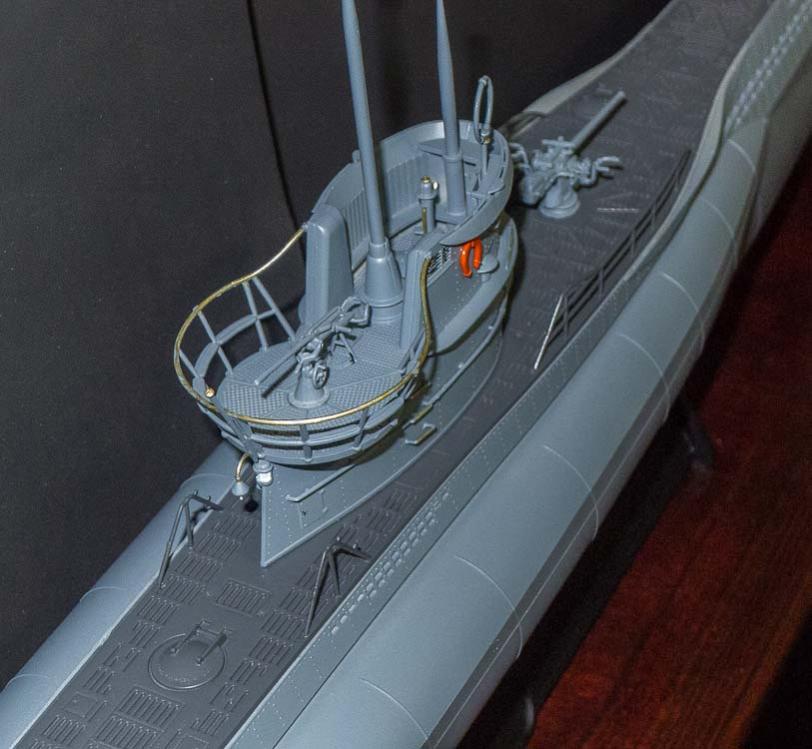

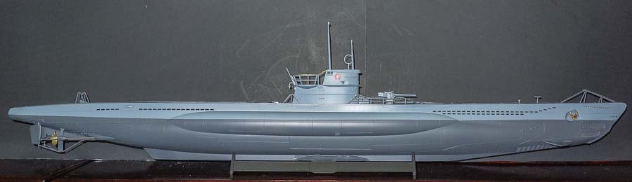

                              #44

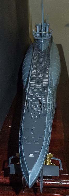

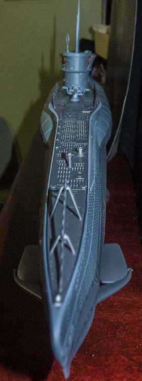

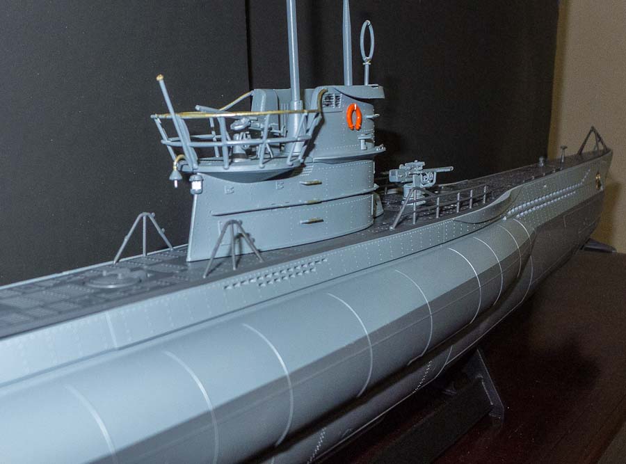

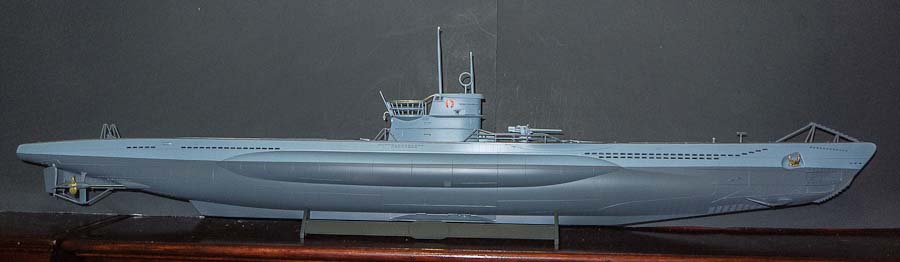

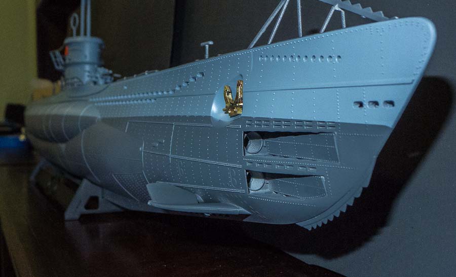

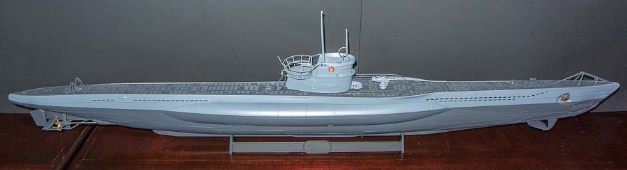

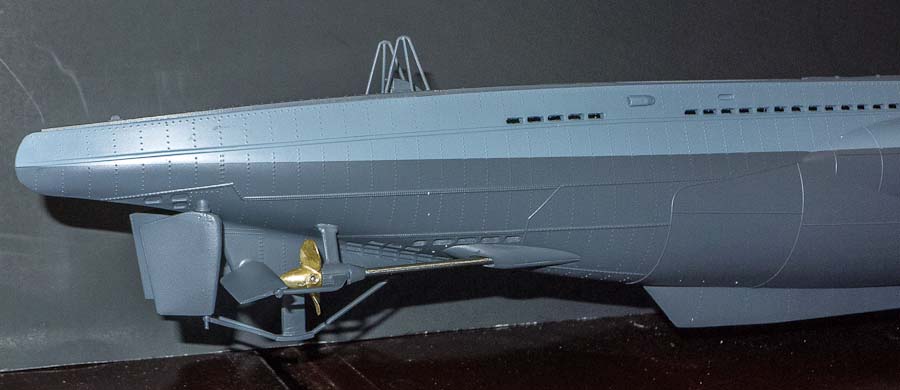

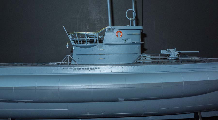

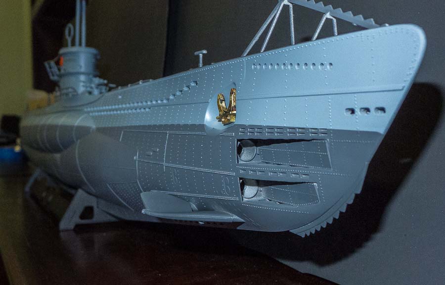

                              Since my last post, I have been working on completing the plastic part assembly and some painting (I could not resist and could not stand looking at that pale light gray plastic mixed with the resin colored parts). I have attached all the fitting parts and now will be ordering the SD and rest of the electronics to begin the trim work. I have made some better photos of my progress. Thanks to everyone for the advice and inspiration, especially David.
                              Andrew
                                • 13948
                                #45
                                You're welcome, sir. What's with the gold anchor? The Kriegsmarine had a recruiting drive on when you assembled that kit?
