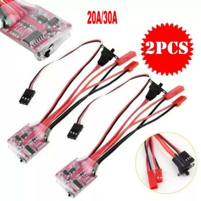

    Thanks Andy, and David. So, maybe back to Mtroniks. I was looking at these two. I am using 3s Lipo with brush motor.
    The Viper 15 specs say not compatible with Lipo.
    The Viper 15HV is compatible with Lipo. But the voltage range is 12-24v. The nominal voltage for 3s is 11.1 volts. I have seen enough that besides dying esc's, that the Mtroniks line is touchy when it comes to under or over voltage from the specs. How true is this? Will the plain Viper 15 be fine? I have 3s Lipo/brushed motor in my Skipjack, will have to check which Mtroniks is in it.

    A lot of brushless esc's also have a brushed mode too, so you can use the controller with either type of motor. These ESC's tend to be super compact and cheap. e.g.

    David, what is your go to brushed ESC?
    Mtroniks........

    These also work well enough for low draw applications, but only okay for lower voltage (under 8v ) systems. If you're running 2s it should fine.

    Haven't purchased a brushed esc in years. Tended to use Microgyros but no longer available. This one comes recommended but perhaps a bit big for your boat?
