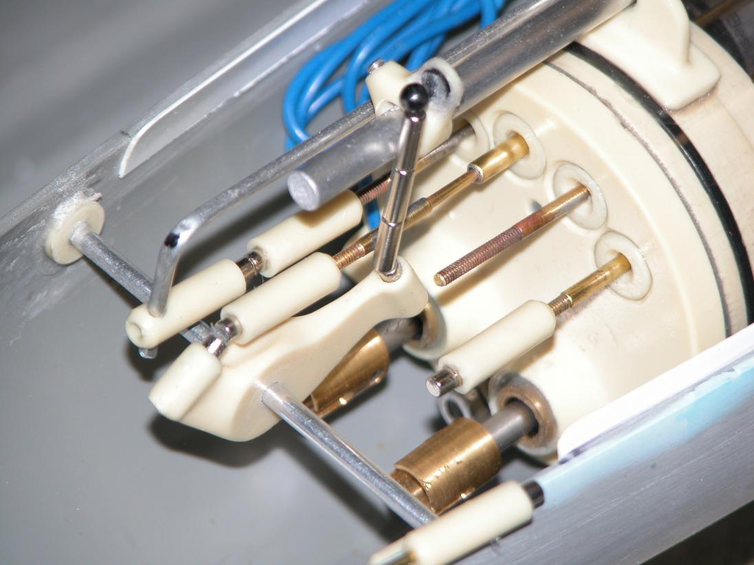

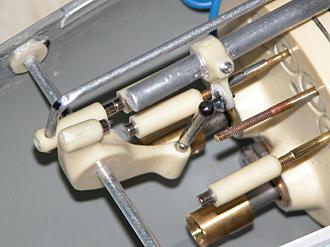

      What links the large belcrank mounted in the hull aft the driver to the forward planes torque tube? It must be magnetic to grab the ball end in the torque tube arm. What ever it is I don't see one in the kit. I did get some of the control linkages hooked up. Looks like I'll have to hog out a little of the supports in the upper hull for the forward planes torque tube and control rod.

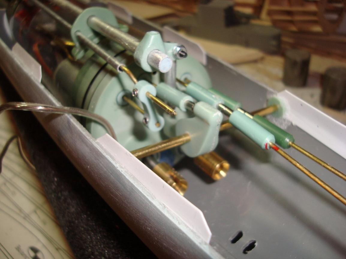

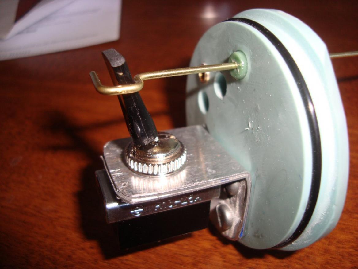

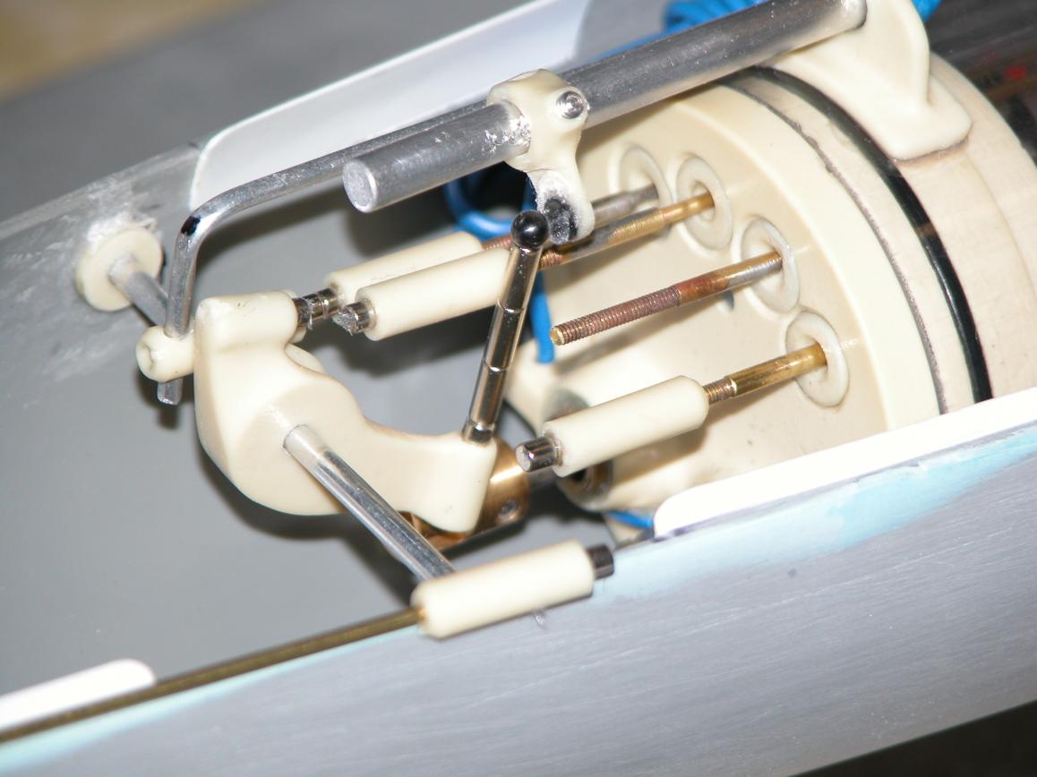

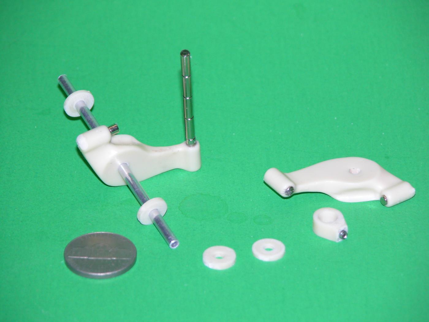

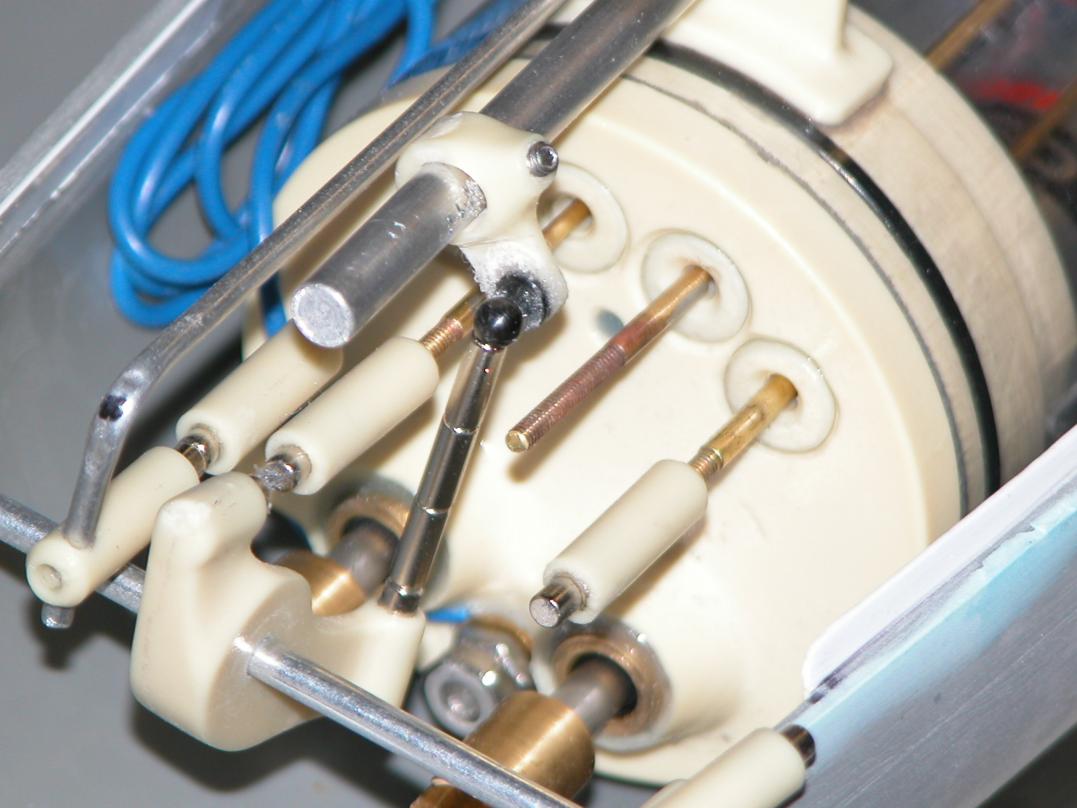

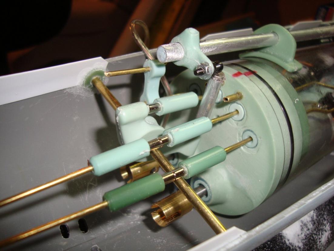

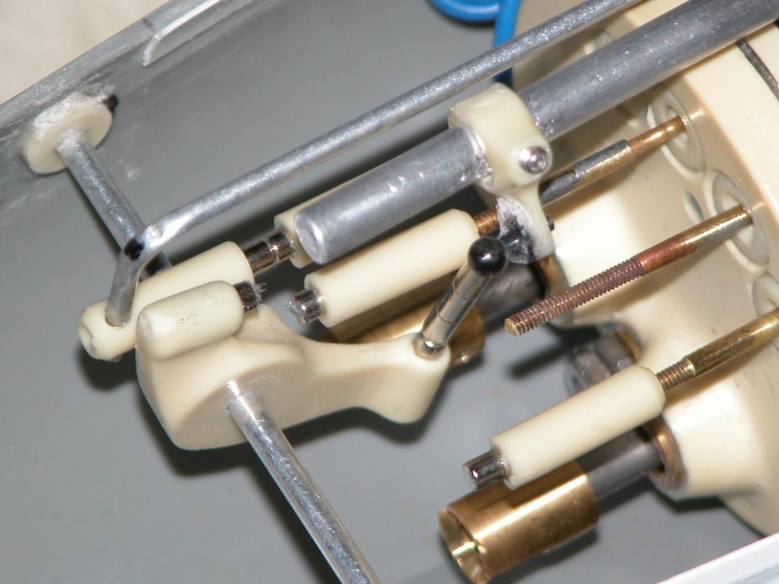

                        Oh, someone was asking about how the swing-arm engaged the torque tube bell-crank. Magnets.

                          Aha! It's multiple magnets. Was I supposed to get those in the kit, because I didn't. I went to Radio Shack last night and picked up two small magnets and I was going to epoxy them on either end of an aluminum tube the proper length. It looks like I'll need about a total length of about one inch.
                          Jay

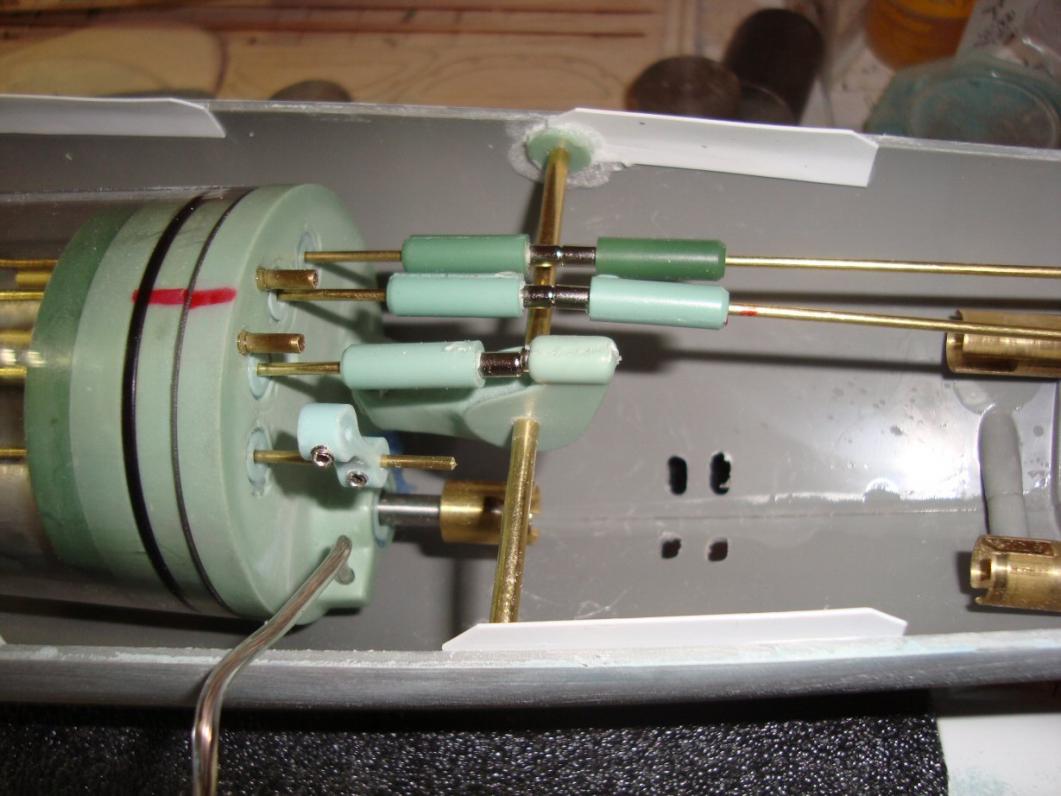

ID:	65733Click image for larger version
                            Good progress tonight. Note to others: if drilling through the fore planes push rod supports that glue to the sub driver, turn the drill motor in reverse and bear down gently and grind your way through. I broke one just as the drill bit into the plastic.

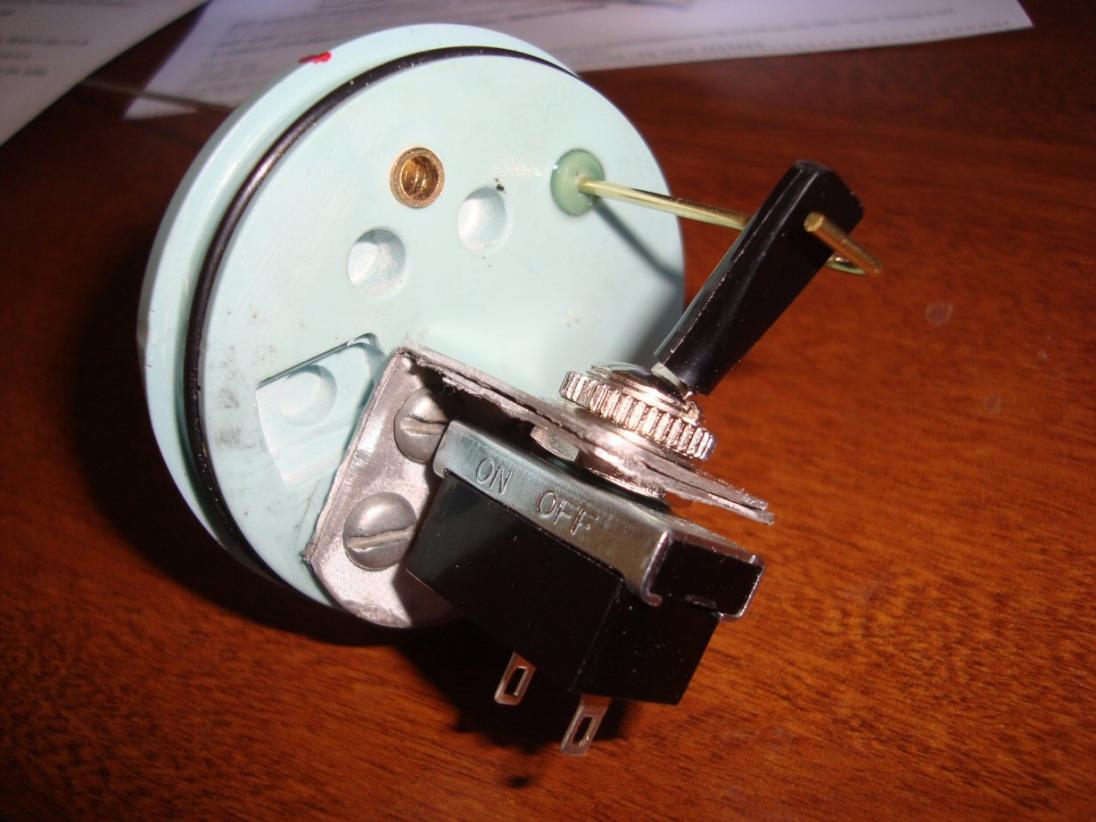

                                Here are a couple photos of my idea for the on/off switch. I still need to solder on the battery wires. I thought it made good use of the extra push rod seal in the kit! And no rubber boot to wear out. I'll have to solder the wires on sideways to clear the tube, and I may just leave the outside of the push rod cut off about two inches long. I guess you could put a wheel collar on the outside. I don't want to bend it in case I need to remove it and replace the switch.
                                Mike sent me two Lipo batteries with my sub driver. Do I need a wire harnes to use both at the same time, or are they for individual use?
