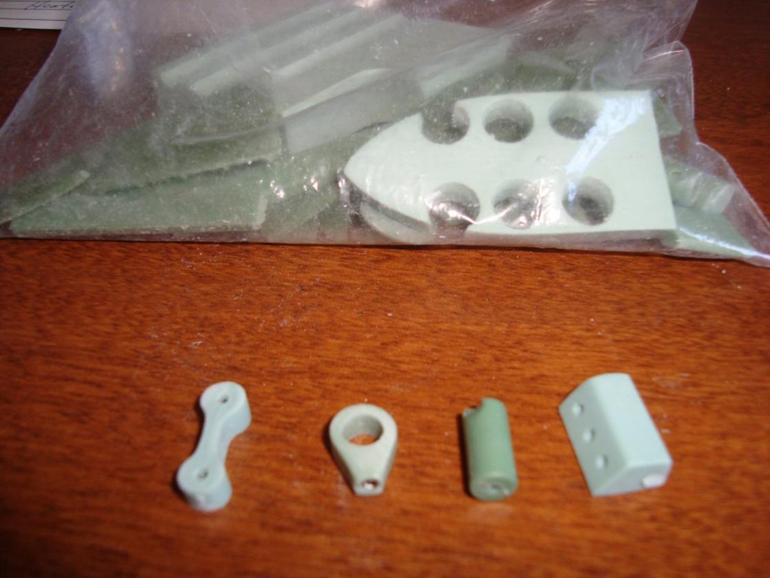

          I hope someone can help me identify my leftover parts. The stuff in the bag I'm pretty sure is if I wanted operational torpedos (?) or to detail the bow. The four items in the front really have me stumped. I now know for sure I'm missing a few important parts, and I will shoot Mike an email about that in a moment. The bone looking thing to the left has set screws in each hole like it's for push rods maybe?
            • 13998
            #155
            Left to right:
            Klystron Relay, Hydro-spanner, Flux Capacitor, Interoceter (no longer available in kit form)
            (bow/sail plane dumb-bell SD attachement point, bow plane torque tube collar, 1/16" pushrod seal, forward bulkhead (end-cap) wire releif block)
            • beeryboats
              • Jun 2011
              • 124
              #156
              What are these two for?
              David[/QUOTE]
