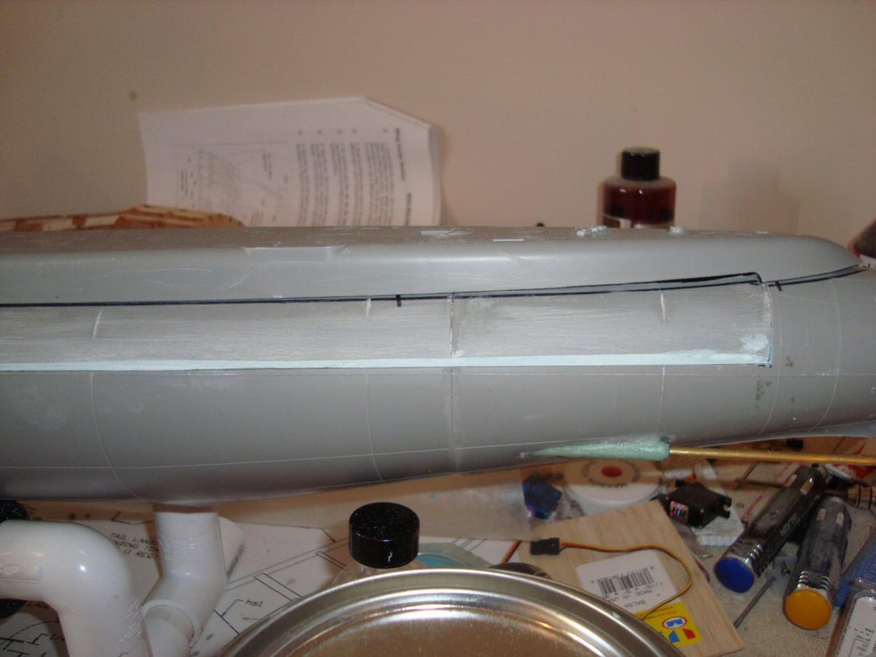

ID:	65165Ok, I got one side to look pretty good. It still will need a dab of filler here and there.
                      • 13948
                      #115
                      Very good work. Your reward will be an easily accessed interior.

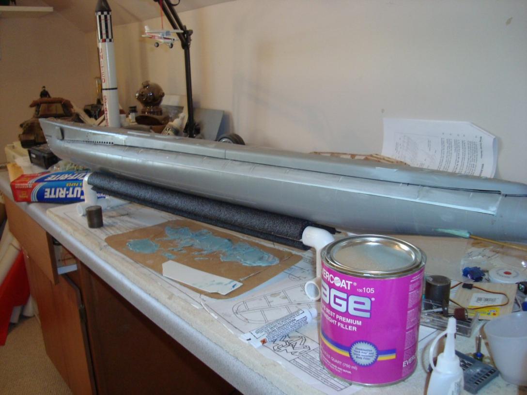

                        Through trial and error I found the trick to using the Rage filler. I was being generous with it and then trimming off the excess with the hobby knife. After some pretty good initial results, it would tend to come off the plastic. Now my process is just use a dab along the gap, place the deck on the hull and walk away. My last section, which was really a repair of a couple areas that had lifted off, sat untouched for two days. I sanded off the excess and hit the inside with CA.

                              Tonight the wife had a Pampered Chef party so I could enjoy the whole evening working on my sub and watching a little TV on my new flat screen. Hey, ya gotta take a break once in a while! I got all the alignment tabs on and life is good. I have a couple gaps in the hull to deck joint that I didn't have before. Small, but noticeable if you look hard enough. I also got half the weld lines filed and sanded off. Looking good so far, but I need to add a little filler at the fore and aft hull joints after I finish the welds on the other side.
