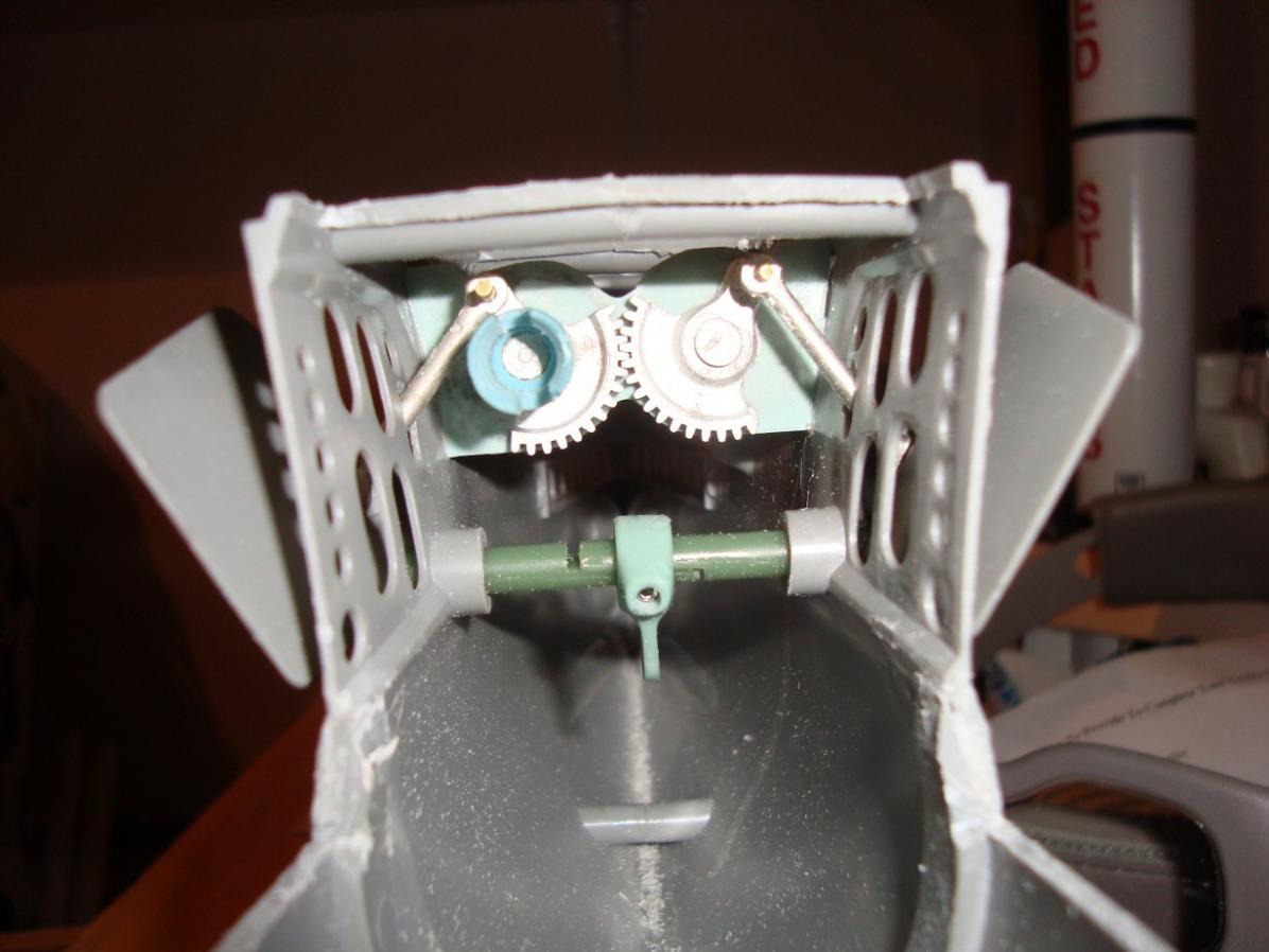

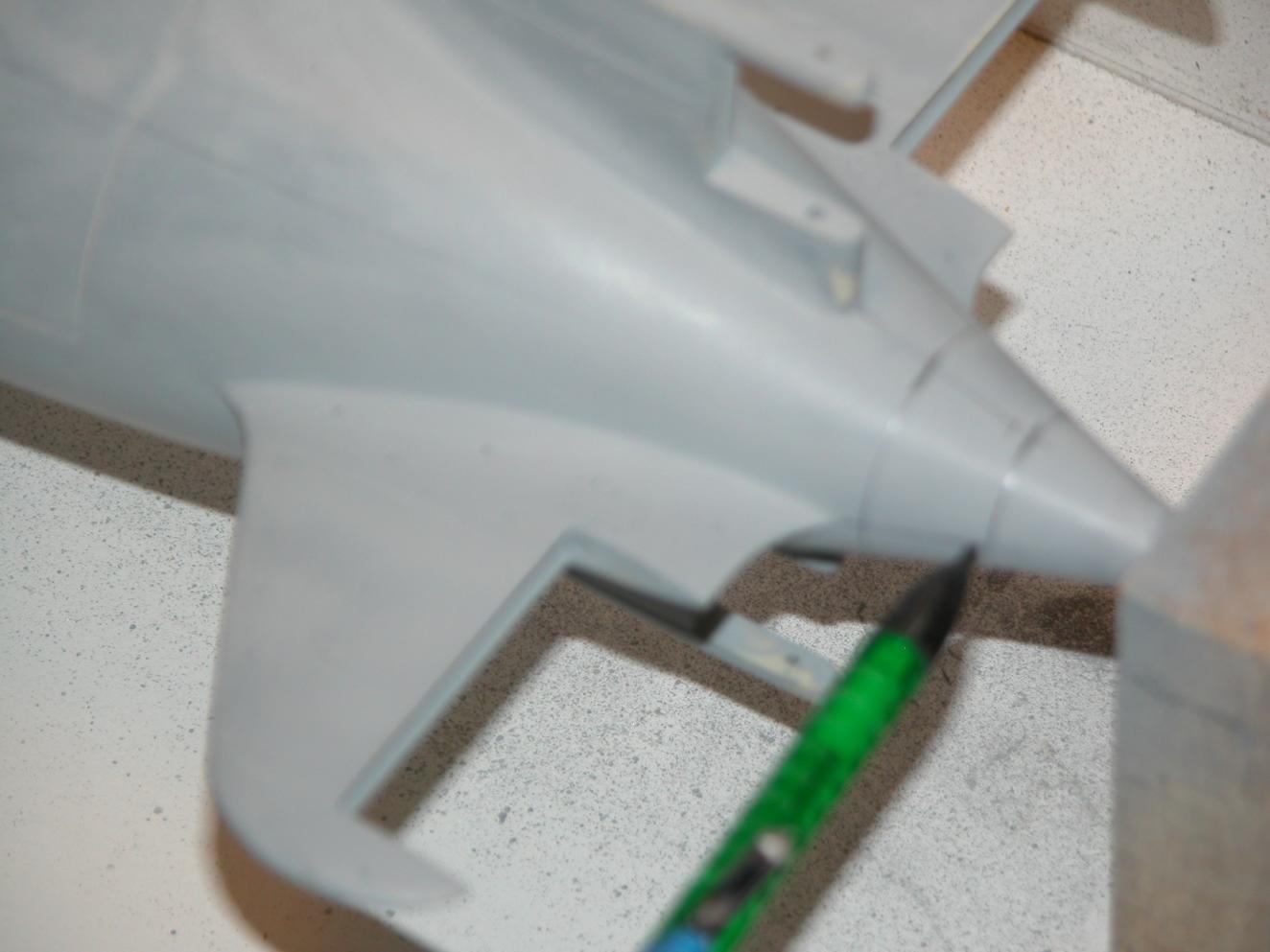

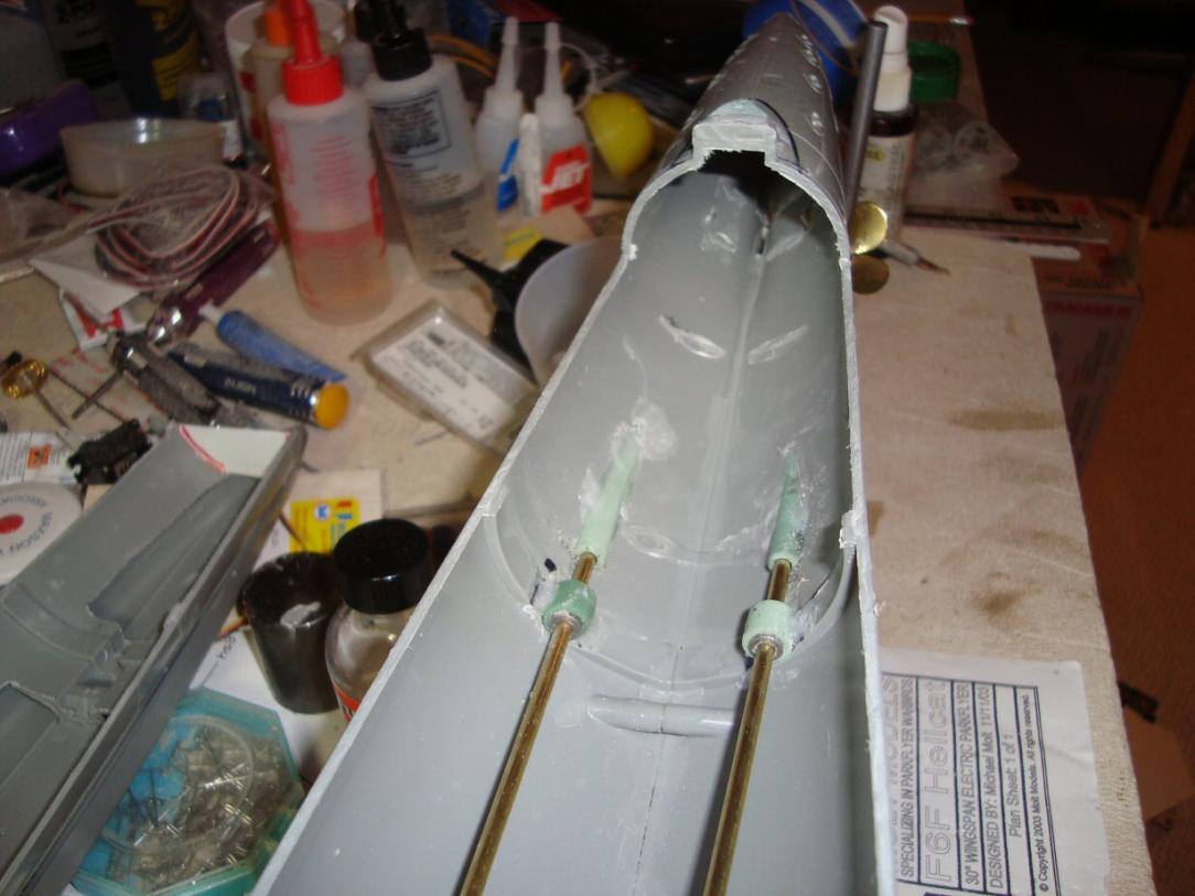

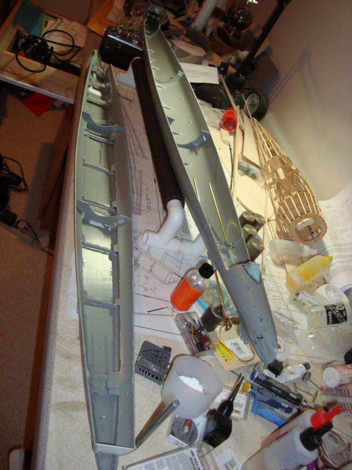

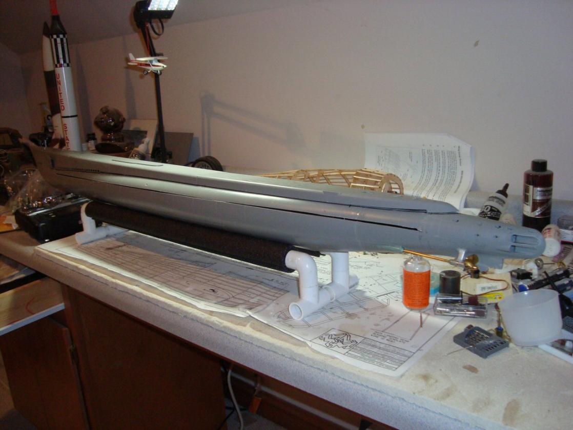

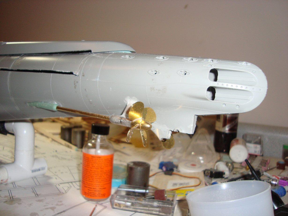

ID:	65102I've had a PM request for photos. I'm a little shy about my first build, so take your best shots. I know the kerf is huge between the deck and hull. I'll fix it. This is totally off topic, but I had just finished taking the trash to the curb ( It's a long way so I drive it out with a truck ) and as I park a helicopter is coming right at me! I jump out of the truck just as he slows down. I motion for him to land and he puts it right in my front yard. He won't shut down, so I run out to introduce myself and it turns out to be the young man I let fly from my strip out building time in a Robinson R22. So cool, too bad it was just about dark and I couldn't get a photo.

        Wow! What a ragged looking POS! What did you cut that hull with ... dynamite!?
        • pjdog
          • 302
          #94
          Jay:
          Did you use a variable speed Dremel tool for the cut or was it a nigh speed dremal tool.
          I found that I did allot better cutting plastic if I could run my Dremel tool at a lower speed. At high speed the cutting wheel moved around allot. In fact I bought a new battery power Dremel that has a speed control for the power.
          The nice thing about cutting plastic is you can always fill in the gaps and sand it down to fit. I didn't have the balls to cut the hull in half like David does.
          I took the easy route and just cut the top of the hull. No need to then fill anything. However I have allot of trouble getting ready for a mission.
          Jack
            • 13948
            #95
            Jack has identified why you should, as you have done, split the hull at its maximum breadth point -- access!
            Clean up those ragged edges, work out a good closure system between the two hull halves and every time you install/remove or service the SD and structure, you'll thank your self for going through the extra work of splitting the hull as you did.

                  Well, here's the whole story. I couldn't find a saw like cutting wheel as David uses. I did find at Lowes the Dremel EZ lock cutting system that has a serrated cutting wheel you can buy seperatly. And it has a larger diameter than the abrasive cutting wheels. The problem is the EZ lock uses a spring loaded lock that once you start cutting lets the wheel wobble. Which explains the wide kerf along the hull. The Dremel is also the least used tool I own.

                    Never fear David, the fill process is about 1/3 done. Looks good so far. Wax paper is the only way to go for a release border. I tried a Saran Wrap product for fun, but it has too many wrinkles even though it's thinner. The Rage filler works great as well just as long as you keep an eye on it. If you pull the deck off too soon you loose the shape of the fill. If you wait too long it gets really hard to trim nice and neat with a knife. I wish I had removed the weld lines first as trimming the filler would be easier without the bumps from the weld lines. I would share with some photos but the camera was left on while plugged into the computor all night. Go figure, it usually charges my cell when it's plugged in...

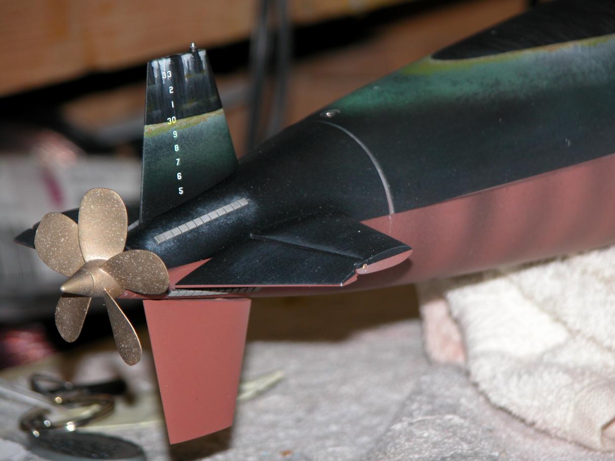

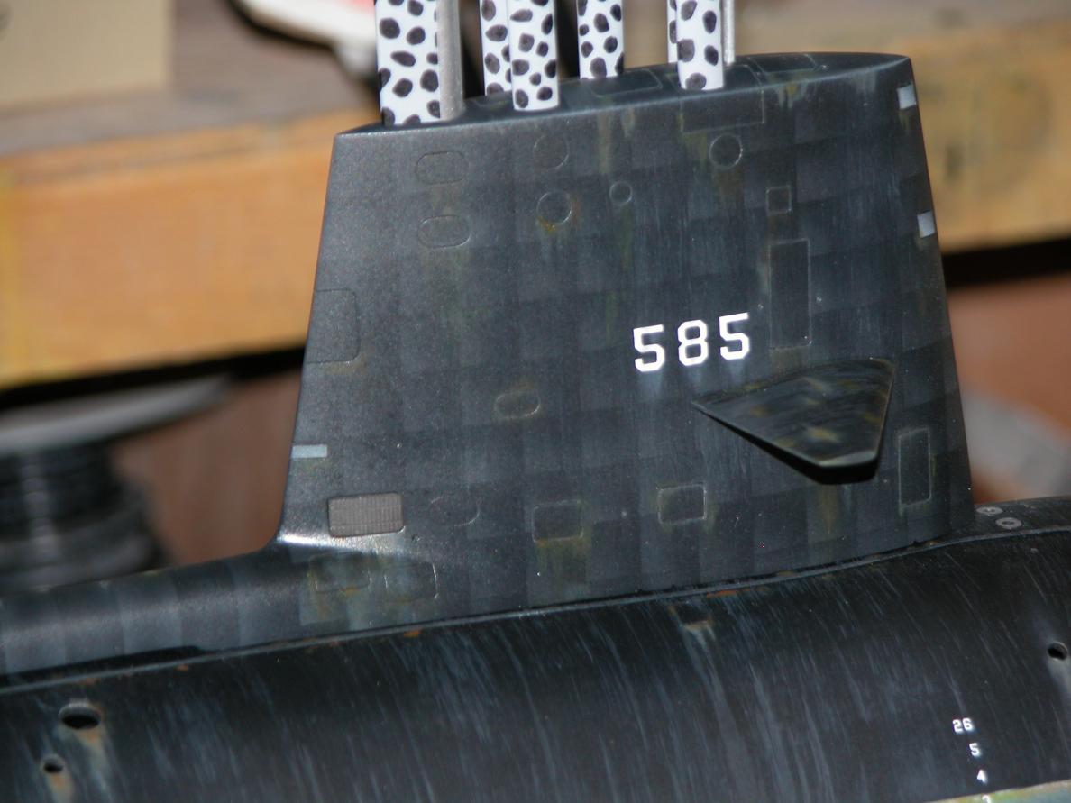

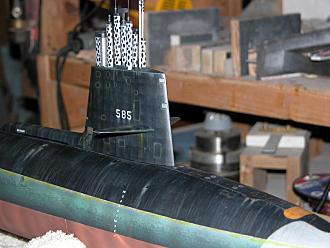

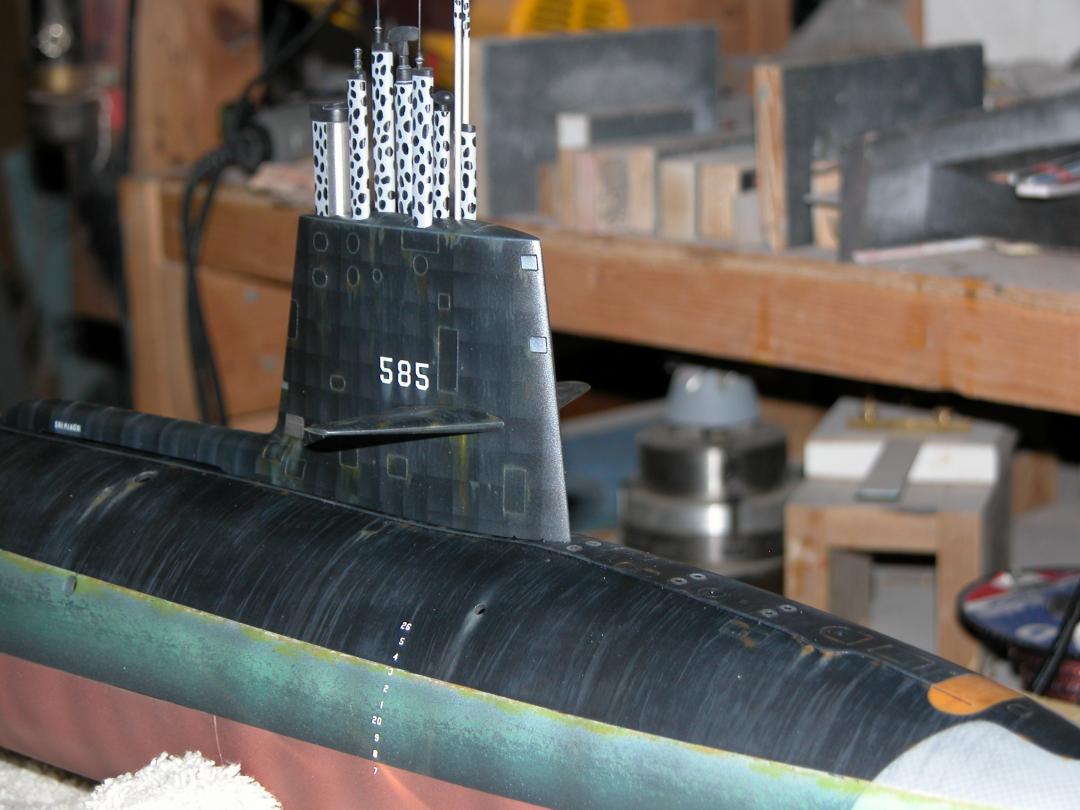

                    David, as most of us have never seen a "working sub" up close, what kind wear and tear do they usually have on the outer surface? I've only seen two subs with my own eyes and both are museum pieces. Were they usuall in pretty good shape or do they rust very fast in high use areas? What about dings and dents? I'm thinking ahead of weathering and detail.
                    Jay
                      • 13948
                      #100

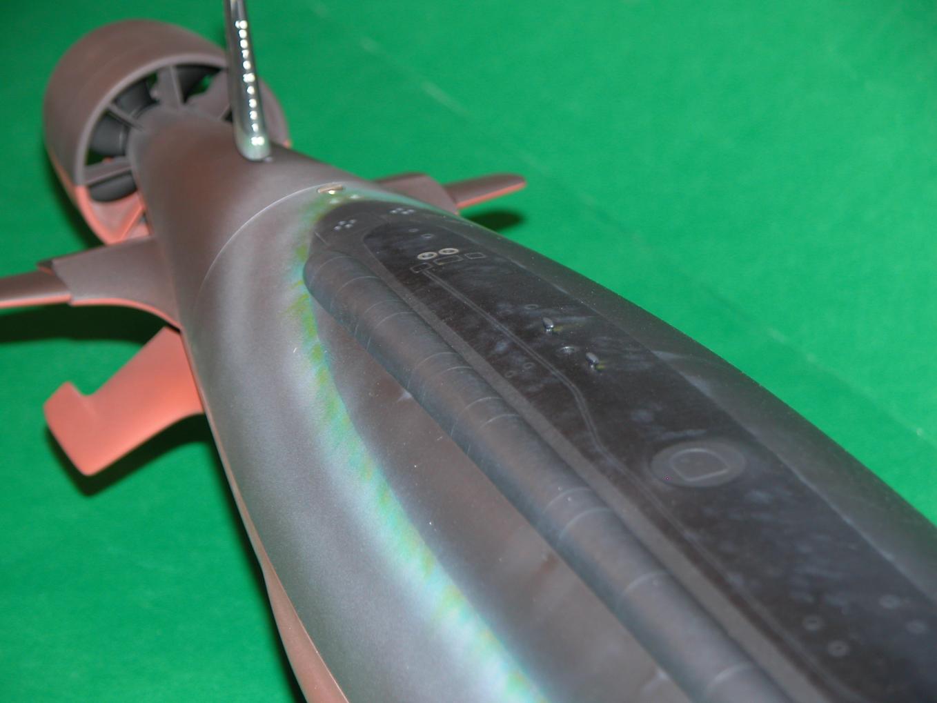

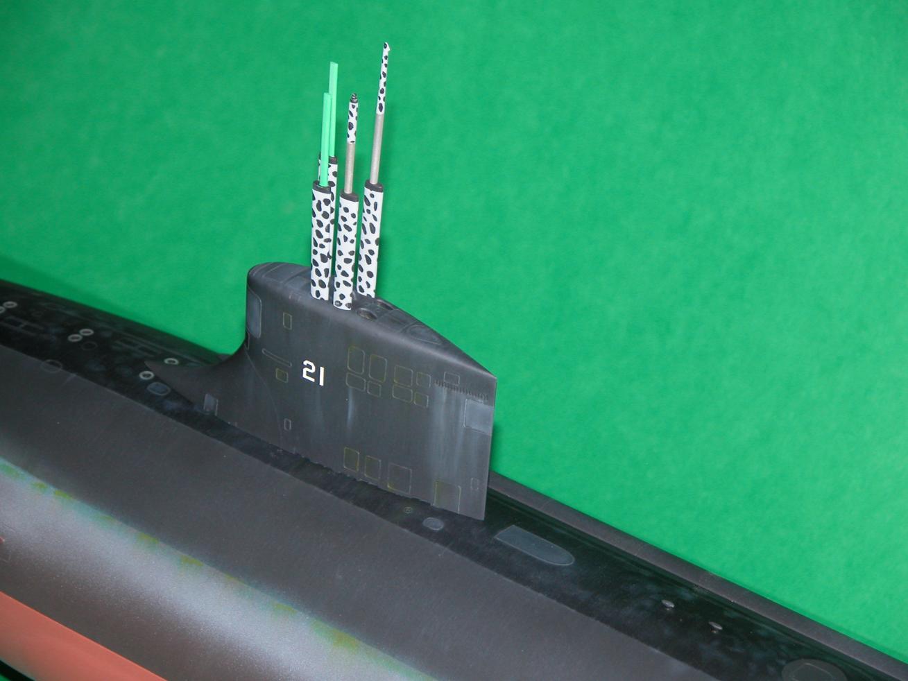

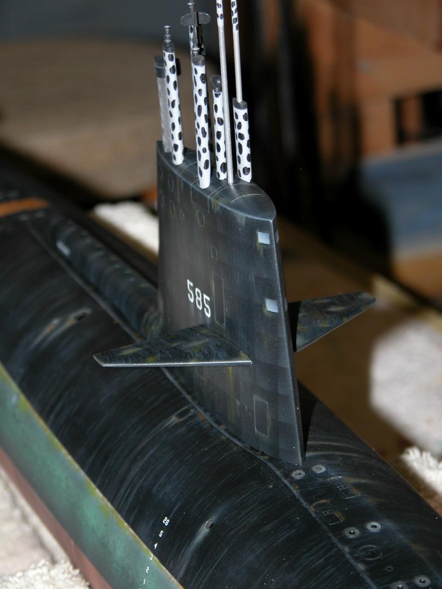

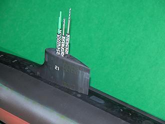

                      Post war American submarines are well maintained. Most 'weathering' evidienced is vertical streaking as a consiquence of rain water pulling dust, oil, and bird-**** down from upper surfaces and streaking along the sides of the sail, upper rudder, and above waterline hull. Think how gravity will streak the water as it falls and that informs you on how to pull down the streaking effect. Rust is not in evidence. Streaking is. Another weathering opportunity for the modeler is the waterline: White at the surface to about a foot down where sea-grass has died and bleached out, green for a few feet deeper, then a light green-brown scum over the anti-foul black/red.
                      Japanese submarines towards the end of the war were in terrible shape and are the perfect canvas for those who enjoy weathering. But, post war the JSDF Navy is even more anal about cleanliness and ships husbandry than the American's.
