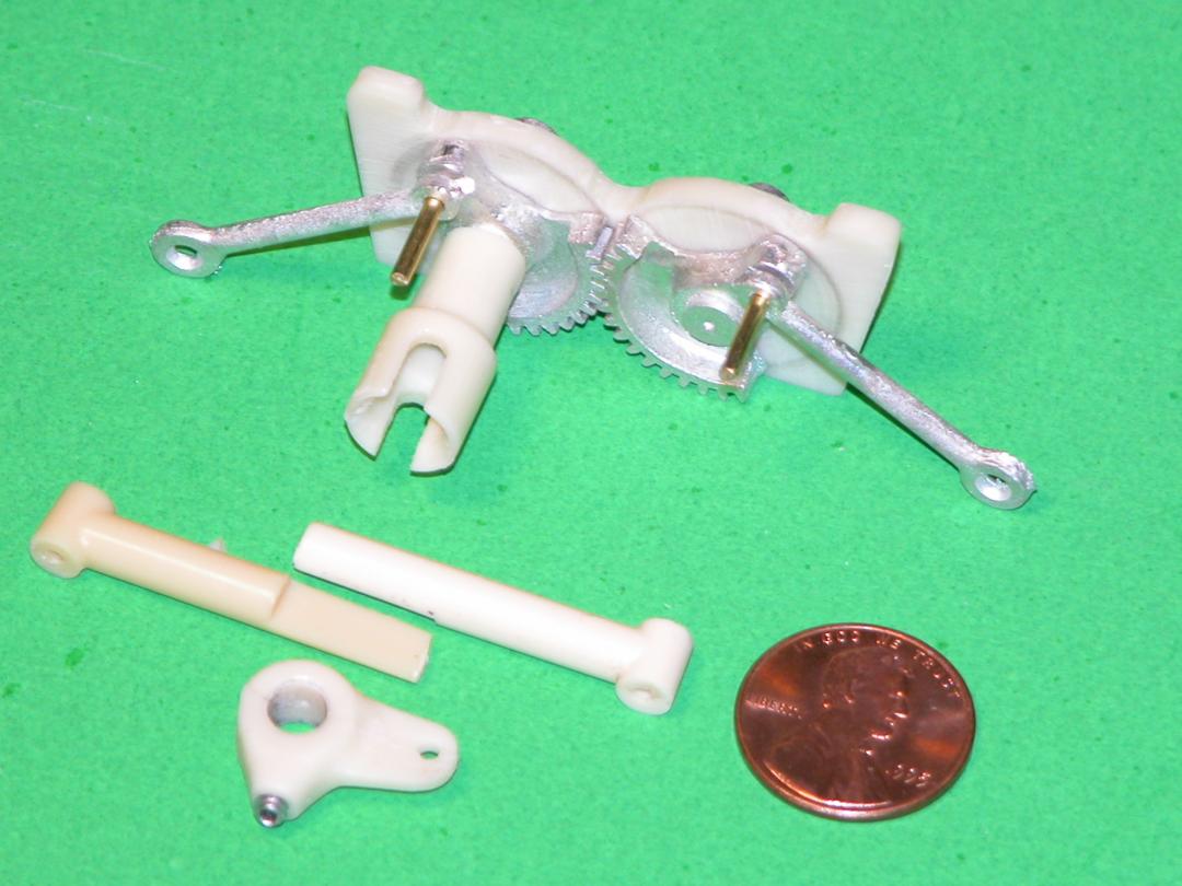

              David, while you're online, can you explain or point me to the right place to see more of the fore planes retract linkage?

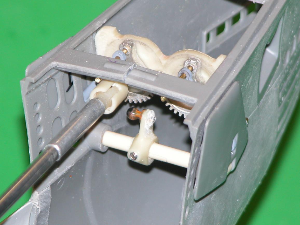

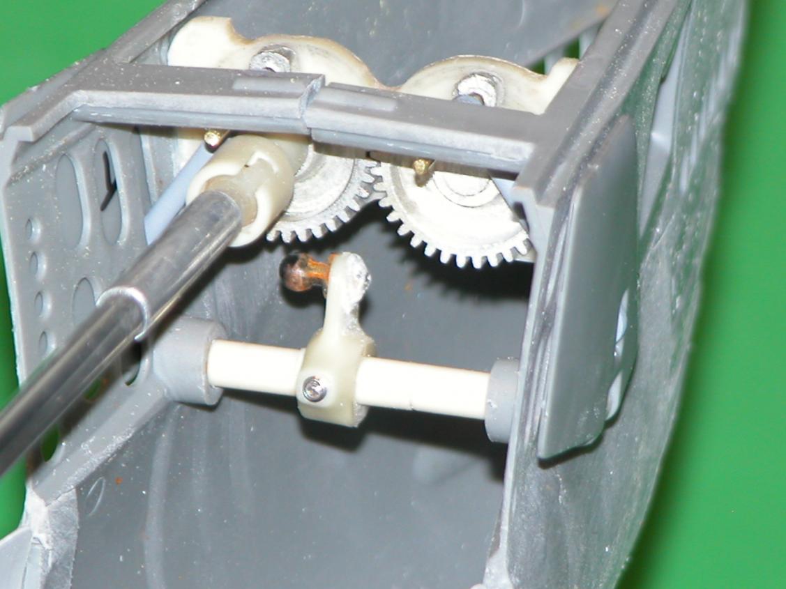

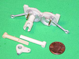

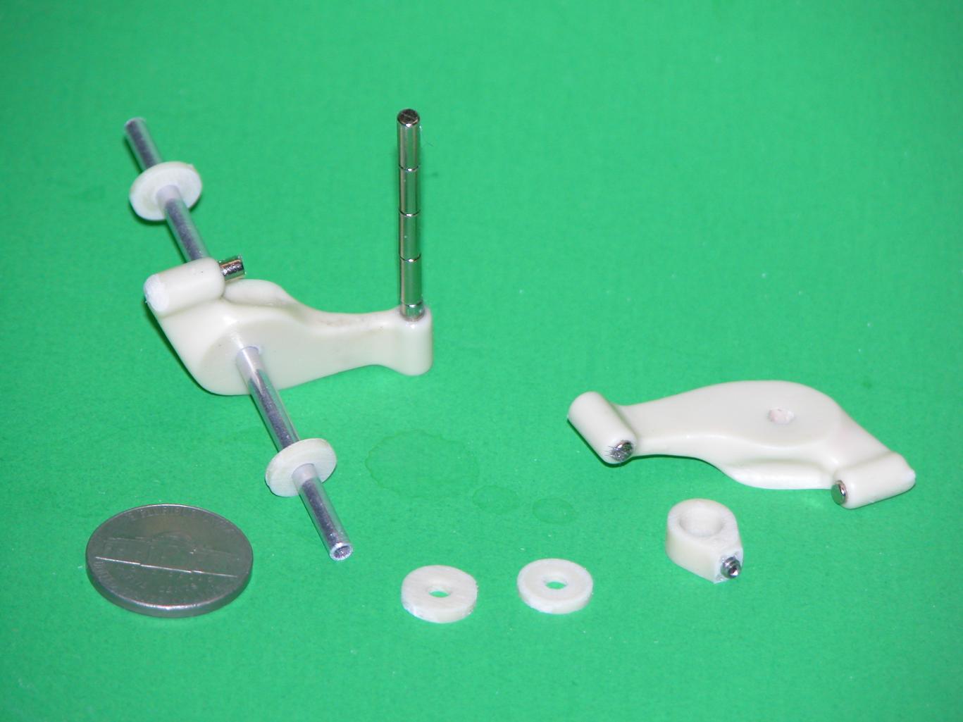

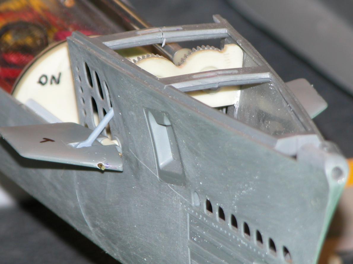

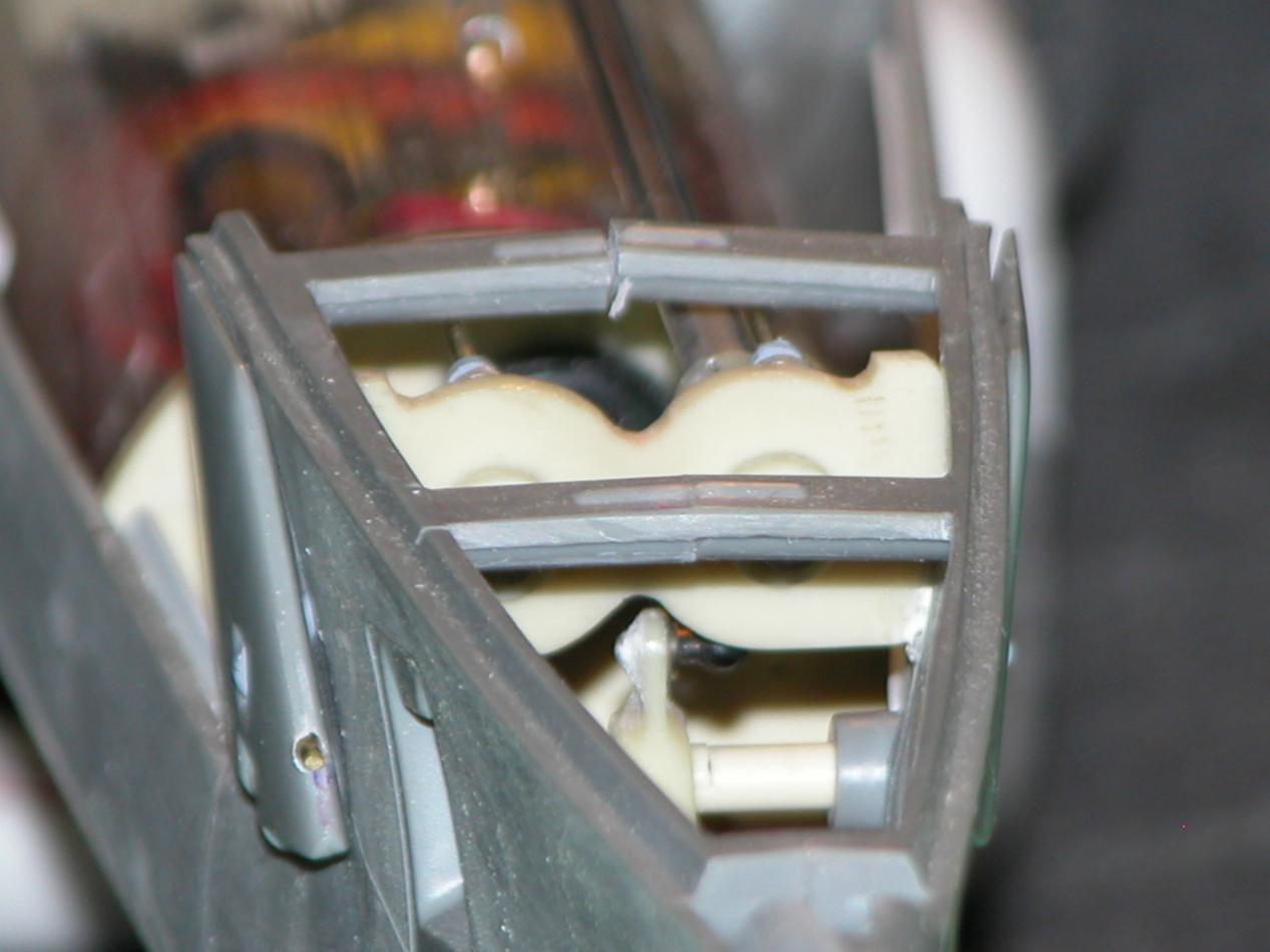

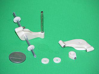

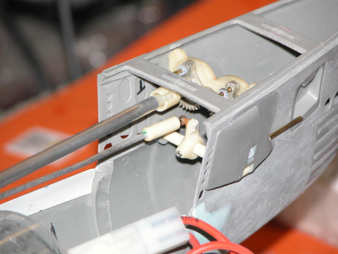

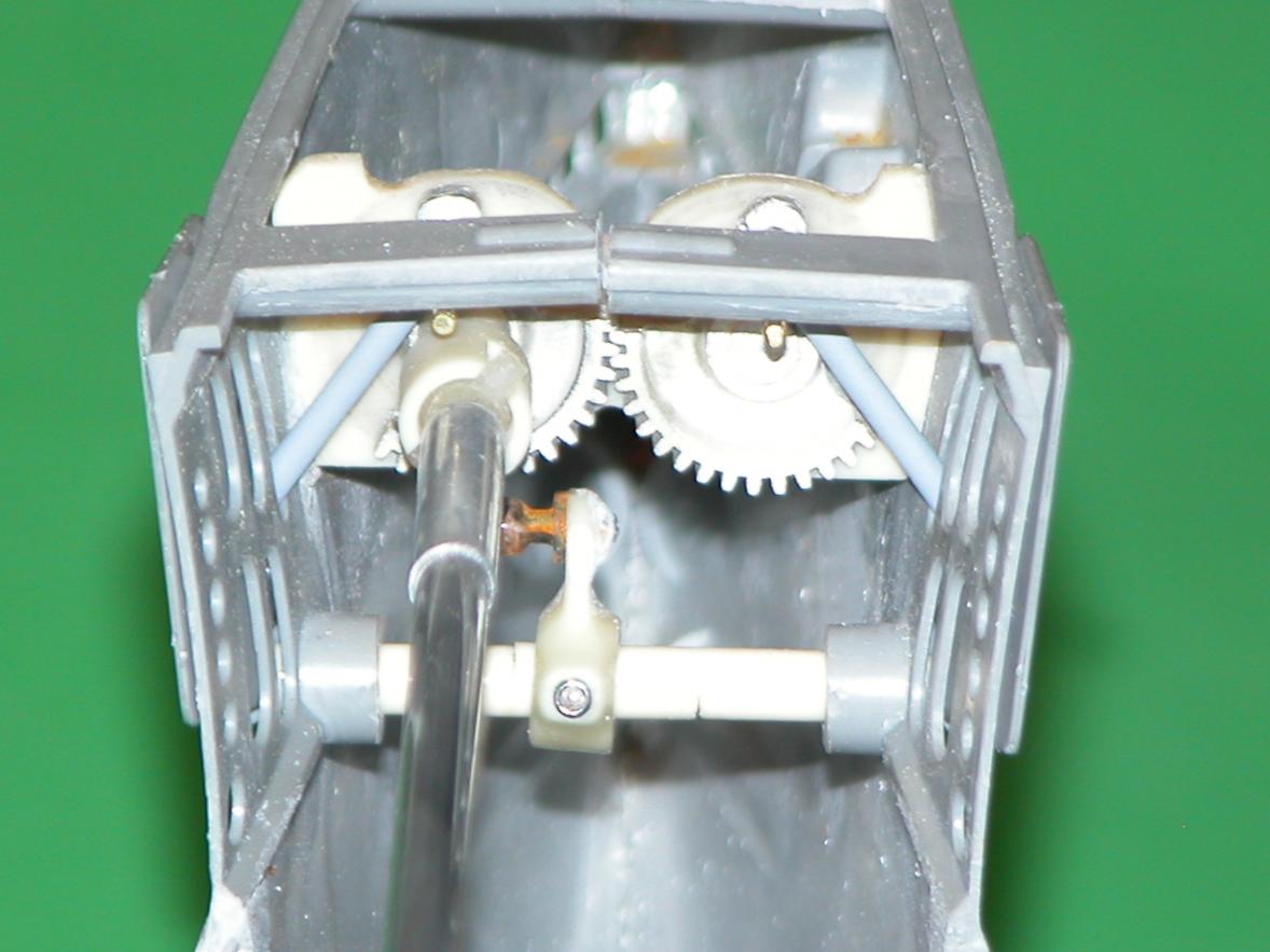

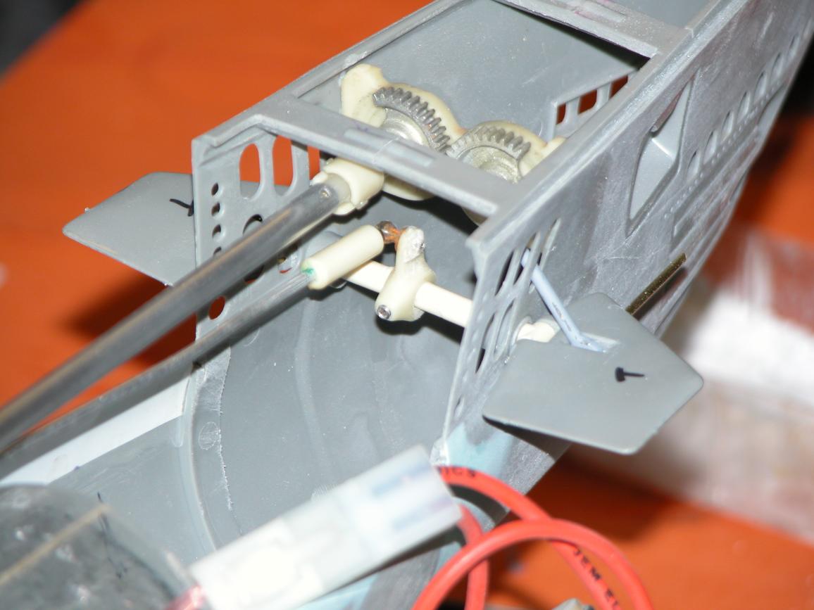

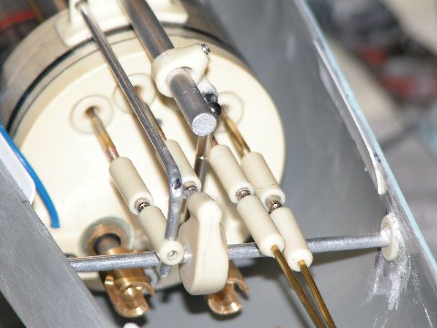

                  Here are some retract mechanism photos for you:
ID:	65335Click image for larger version
ID:	65336Click image for larger version
ID:	65337Click image for larger version
ID:	65338Click image for larger version
ID:	65339Click image for larger version
ID:	65343Click image for larger version
ID:	65340Click image for larger version
ID:	65342Click image for larger version

                      Good deal, I have a half sheet of the pink stuff. Am I correct in my understanding of the ballasting theory? The photo to the right of the actuator arm is what I'm after. Does anyone have a photo or two of the assembled rear of the sub driver?

                        Have you seen this? http://forum.sub-driver.com/showthre...ection-details Has photos of the connections.

                          Aha! Now I see the pivot point. Is that a solid aluminum rod forward to the retract mechanism?

                            I believe it is a hollow tube and not a solid rod.

                              Here's one of the photos on the link you posted. It sure looks solid to me. Or it has some sort of filler at the end.
                              Jay
                                • 13948
                                #135
                                It's a hollow aluminum tube (as is the bow plane pushrod next to it). It's vital to keep the above waterline stuff as light weight as possible, hence, the aluminum tube. I cap the ends to keep the tube water tight. If you don't, as it slowly fills with water it will goof up your carefully set submerged trim.
