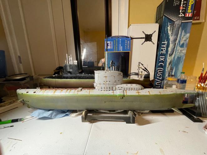

              I have done enough, next will Clear Coat and move on!

                Well done, sir.

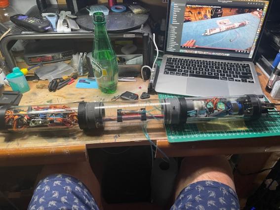

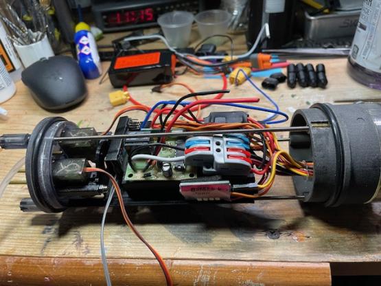

                        #236

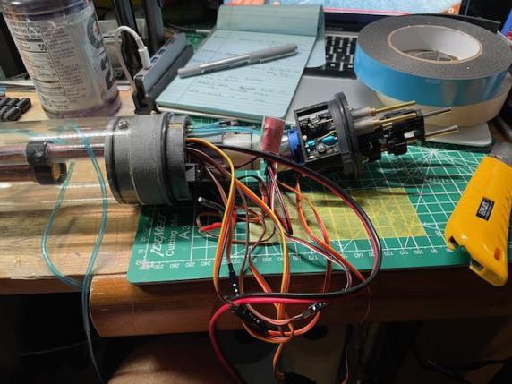

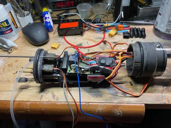

                        Series 250 SubDriver from The Nautilus Drydocks with 7" Ballast Tank, BLM, AD2,Remote ON/OFF Switch, and Emergency Gas Backup System assembled and programmed. So far I "mostly" like this SubDriver. I am concerned that my pump does not sound as loud as the one in the video? I had a difficult time making sure the Motor Wires and the ESC were clear of the spinning motor. Also I may redesign and print a new Battery Tray. With that said, I can now mount the SubDriver in the Type III, and start to hook up the servo control rods and driveshaft etc.

                          Bruce,
                          Looking at you Sub Driver photos, I am assuming you designed and built your ballast tank and control system for it. It looks like you attached that system onto the original 250 series EasyDriver that you got from Jason/Bob Nautilus Drydocks.
                          Looks good! We will all be interested in how that works out...Question: What size and type battery are you running?
                          "Firemen can stand the heat."

                            #238
                            Hi Rob, it is their 250 series with ballast tank SubDriver, they printed the bulkheads in black vs white, I prefer white as one can look at the ballast mechanics better. The battery is 11.1 v, 3s. I use the Spectrum Smart Batteries which you program to discharge after a period of time.

                              OK1 Understand what you have going on. If I would had looked a little closer I could see it was not the 250 Series EasyDriver, but the SubDriver. Thanks for clearing that up. Thank you for the information on the battery that you are using.

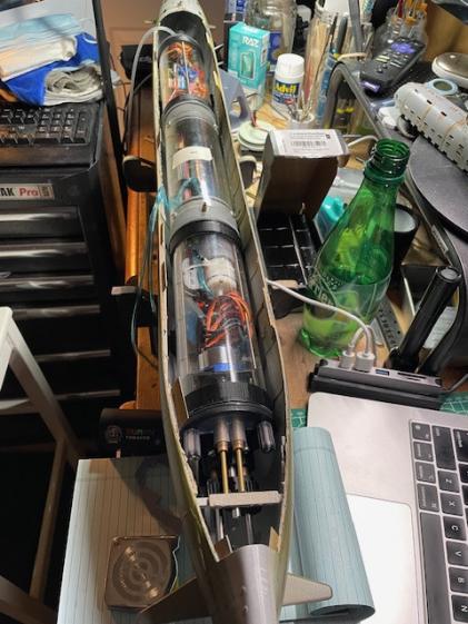

                                SubDriver cradles I printed are perfect, added 354G of weight
