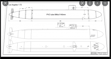

    Here is a file I pulled of the web but it looks strange. I'm trying to form the forward and after hulls but I can't confirm the dimensions. Can anyone point me in the right direction?

          Thanks in advance for your help David. You always come through when I need help. My address is:
          31048 S Canyon Vista Way
          Oracle AZ 85623

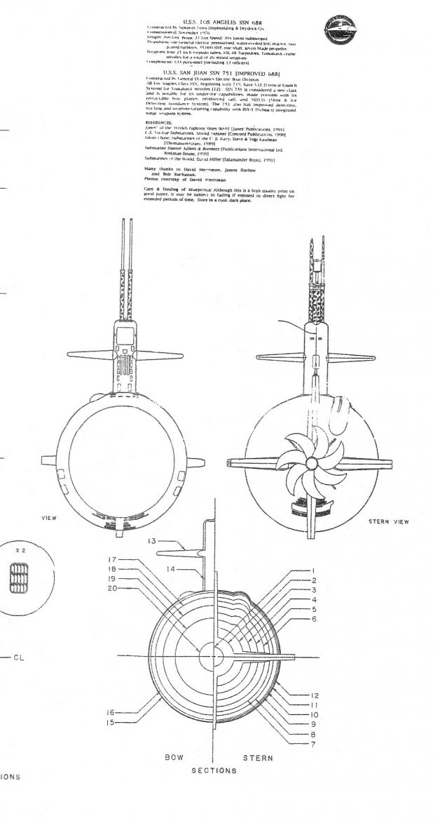

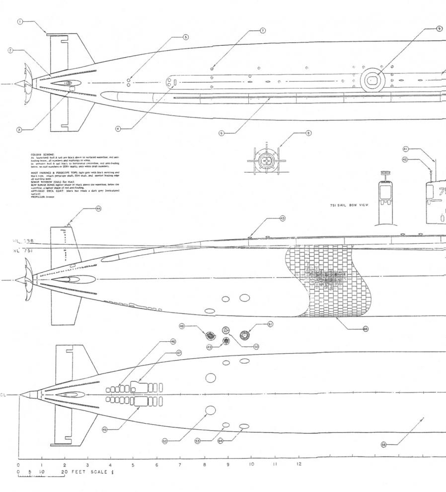

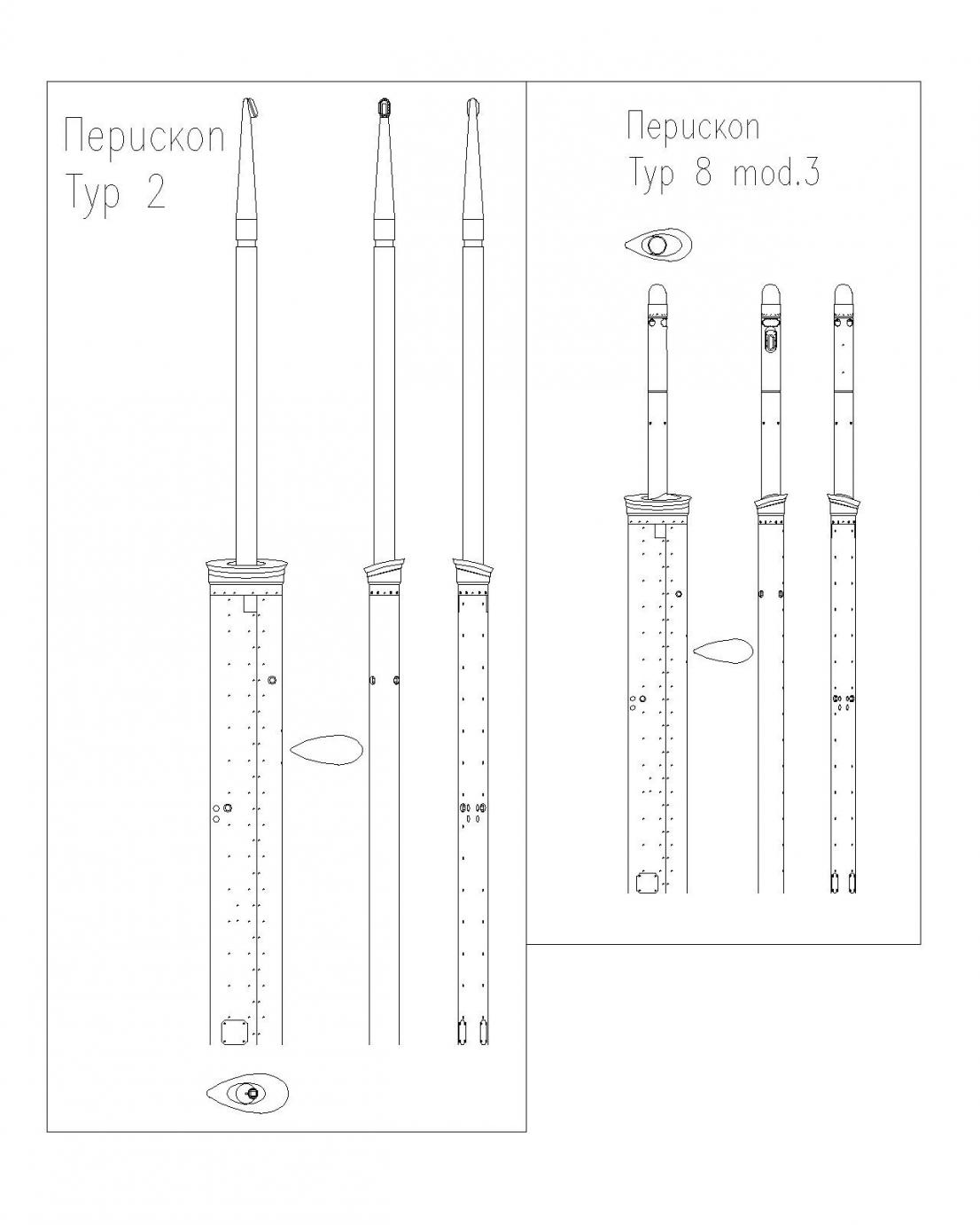

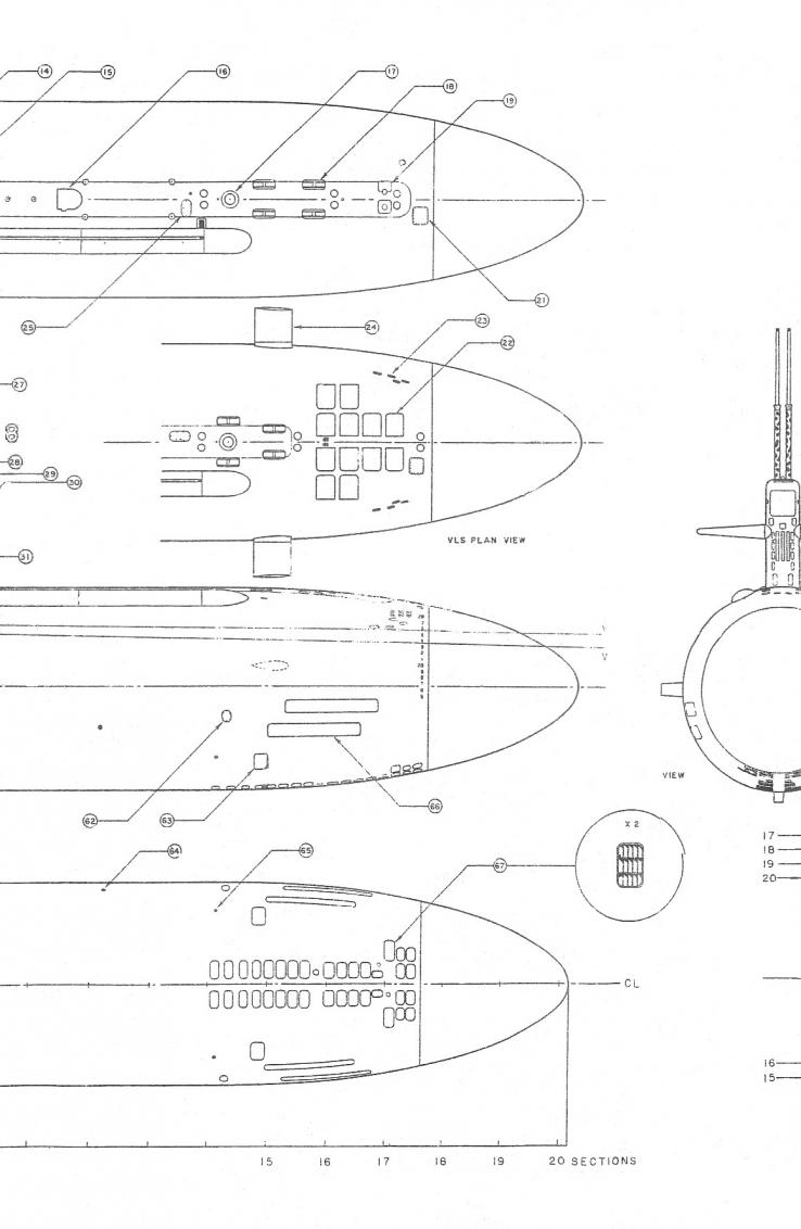

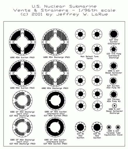

            • SSBN659
              • 418
              #111
              Thanks Sam.
              Will Rogers
              SSBN 659
              • SSBN659
                • 418
                #112
                Thanks to David and Sam for their help I'm ready to start a model of USS Tucson SSN 770. I'll do this in a separate thread.

                  #113
                  Only 3 MBTs in the bow! So, only 6 MBT vents. The rest were aft end, behind the Engine Room, in the tail cone.
