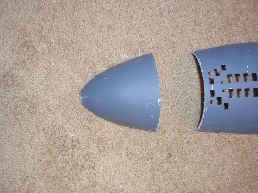

                  #38
ID:	63241So, marked, and cut the nose off on the lower hull half. Picture attached. I need to clean it up before it gets glassed onto the top half. I'll probably make the rear cut before I do any kind of glassing.

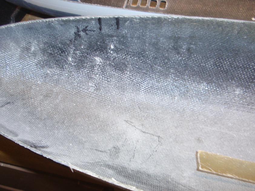

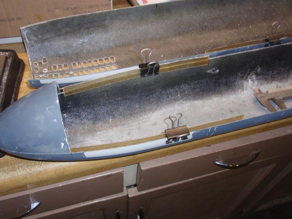

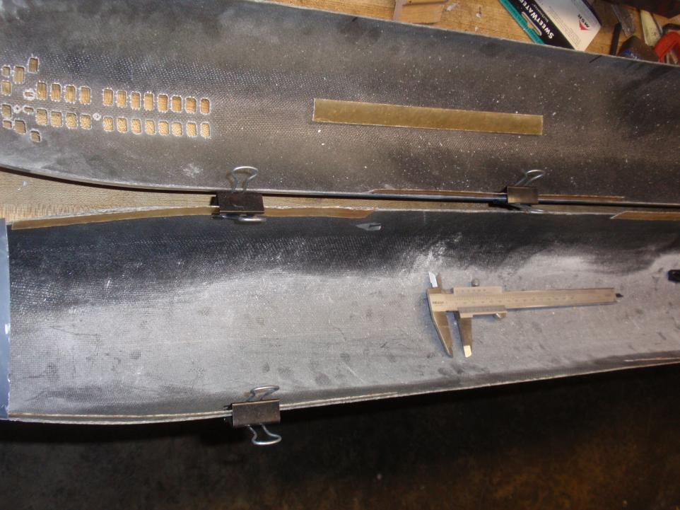

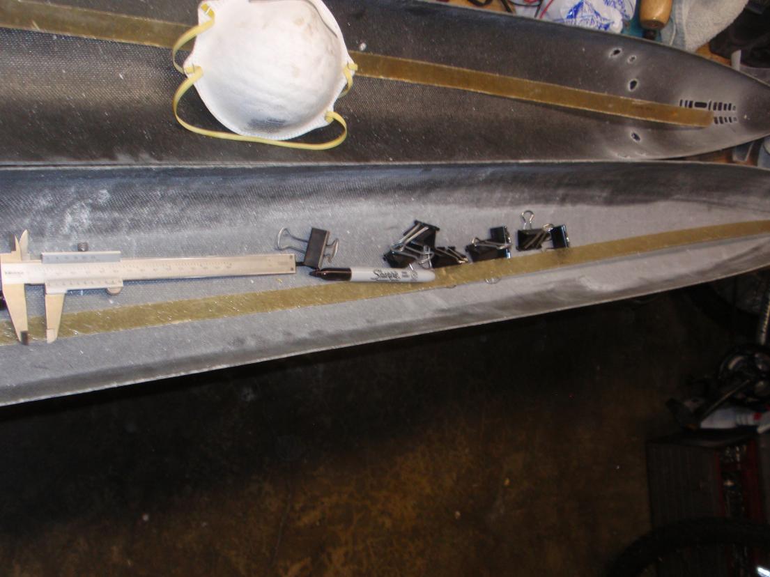

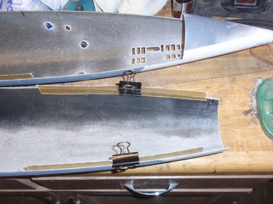

                      #40
                      Yeah, that sounds like a good idea...try to kill as few brain cells as possible....I need as many as I can keep ahold of.

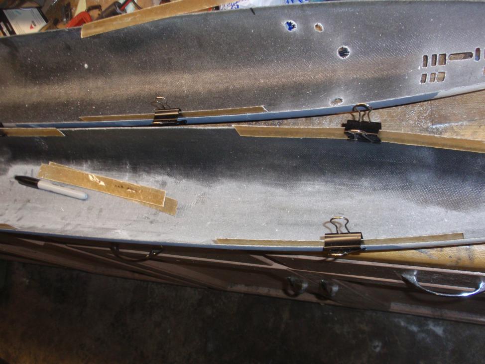

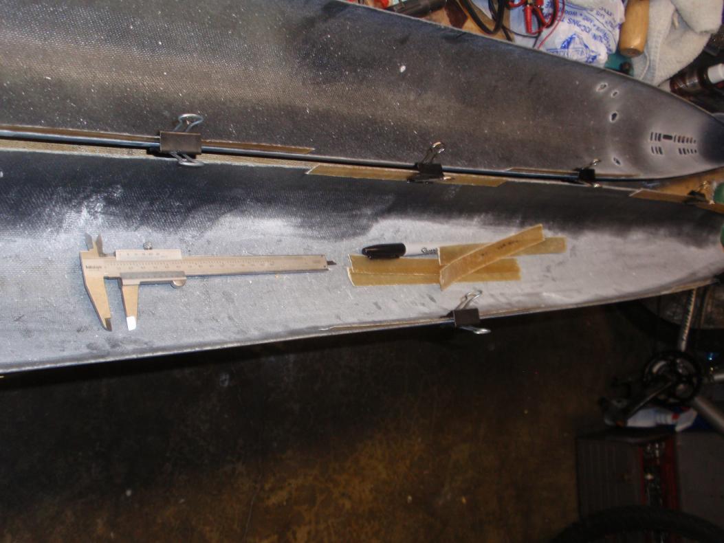

                      I just cut the AFT end of the 'Z' cut. The hull came with indexing lips, which I heard were good to alternate...more work to glass them on, but I think it might help keep things lined up. The linear distance of the hull that needed indexing lips was ~50", so the plan was to go with 5 strips. 3 of the strips will be on the top of the hull, and two will be on the bottom. I've used paper clamps to show them in position, where I intend to glass them onto the top and bottom halves of the hull.
                      I will mask off the whole top and bottom halves of the hull, so that through sloppy glass work (Entirely within my ability to do), I dont get any resin on the 'good' sides of the hull halves.
                      Before I glass the stuff together, I'm going to be working on finding some blocks of either plastic (Probably LDPE or HDPE) or possibly aluminum or brass. These will be positioned in the tail cone where the rudder and plane penetrations will occur. The intent is two-fold...first, have a thick solid surface to act as a 'bearing' / support for the planes and rudders as their control arms pass through the fiberglass hull. The second purpose will be when I extend the top piece of this support material (for the upper rudder) in the AFT section past the Z-cut. If this material is aluminum or brass, I will drill, tap, then thread this, and the top hull half will screw onto the bottom half into this material. If plastic (Polyethelene) I will glass, or in some way glue a nut on to the material, and it will also function to attach the two hull halves together. I'll attempt to draw something that show's what I'm up to later.
                      In any event, attached are a couple photos of the hull halves which have been cut, and the indexing lips.

                        #41
                        Good plan on the indexing strips. You can minimize dribbling of the epoxy resin by mixing in some talc or other inert filler -- make a paste, less likely to run.
                        Way, way overkill on the bearing holes for the rudders and stern plane operating shafts -- keep it simple!
                        Looking good so far.
