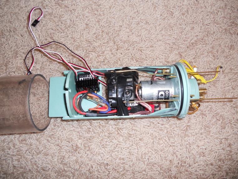

                        After a LONG hiatus, I've gotten back on this project. I'm Active duty at Flight School, so for those of you aviators out there, you know this takes most/all of your time.
                        Just putting together the Subdriver that Mr Caswell and Merriman sent, it was the last of their old 3.5" units, and I'm very grateful to have it.
                        Question....As you can see in the picture below, I'm starting to put stuff onto the rear motor tray, and wondered if anyone had any advice about preferable locations to put stuff.
                        I just bought a new 50MHz Lepton Receiver, so when that gets here, I am going to put that on the most forward tray shown in the photo. Any issues I should be concerned with about where those servo's and the speed control is with respect to the motor?
                        I'm planning on putting the level keeper (just bought this from Caswell) on the bottom of the tray, right below the two servo's. Any problems with this location?
                        Dan-
