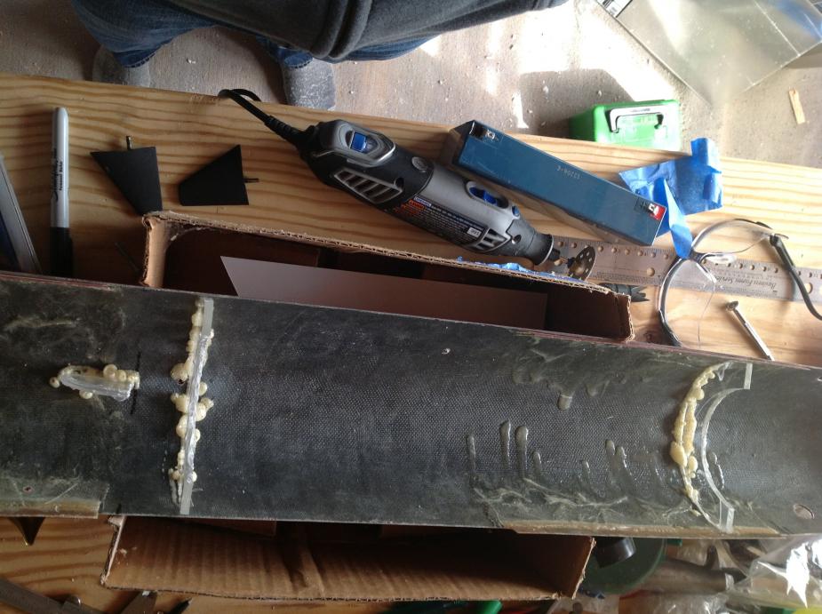

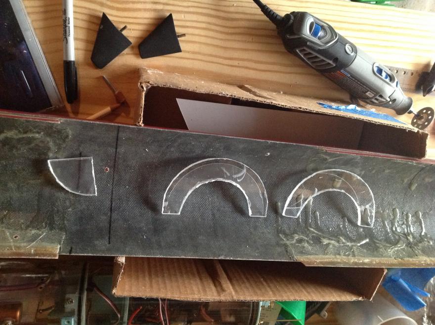

    So I did what you suggested, and I've mounted bulkheads (tacked them down) for the WTC. See photos. The center of the ballast tank will be 1" fwd of the geometric center of the boat.
    Next thing to work on is getting that CG slightly forward of the center as well, then trimming.

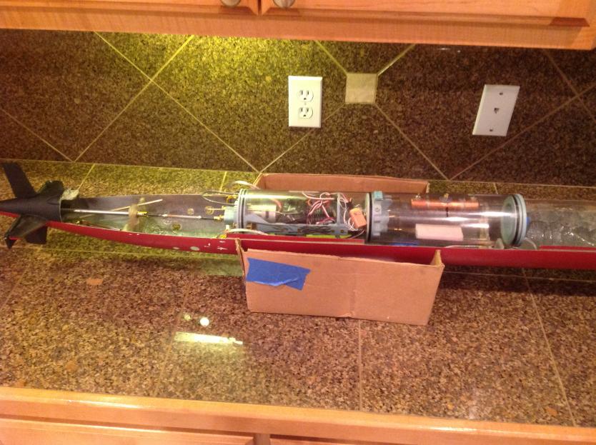

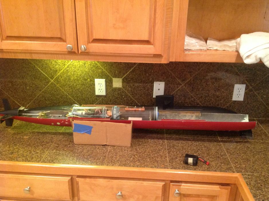

      Next Update,
      Just soldered up a prop linkage from the shaft on the hull to our Most Esteemed Leader's WTC. As you can see, the WTC is presently positioned aft so that the Center of the Ballast tank is ~1 inch forward of the center of the boat (lengthwise). Thanks Admiral Greenman.
      With no battery installed, the CG is somewhere near the aft 1/3 of the boat.
      I'm planning on a 6 Volt, 14 AH Werker Gel cell, unless someone wishes to correct the abhorrent error of my ways. This cell weighs ~6.1 lbs, which should drive the dry CG into the forward 1/3 of the boat.
      Is there a rule of thumb for where the CG should be in relation to the Center of the Ballast tank, which is positioned as stated above?

        #93
        Spankey, 6.1 lbs seems like a lot. Looking at what youve got there, youve got plenty of room for a battery WTC up front. Inside you could put a LIPO or a stick NIMH. Im sure that you could make the 6 pounder work.............
        As far as center of gravity in relation to center of ballast tank Id start with 1" forward of that and just see how she handles. On my Albacore I had to play around with that, but thats only because I wanted to go fast.
          #94
          Im thinking that if you put that much weight in there that you would have to put a heck of a lot of foam in there as well to help your ballast tank float that much weight.
            #95
            4Ahr's is plenty, and like Mark said, too much battery!

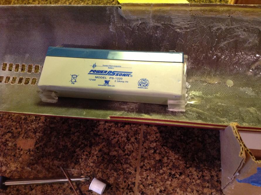

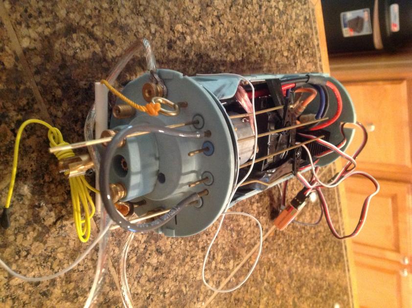

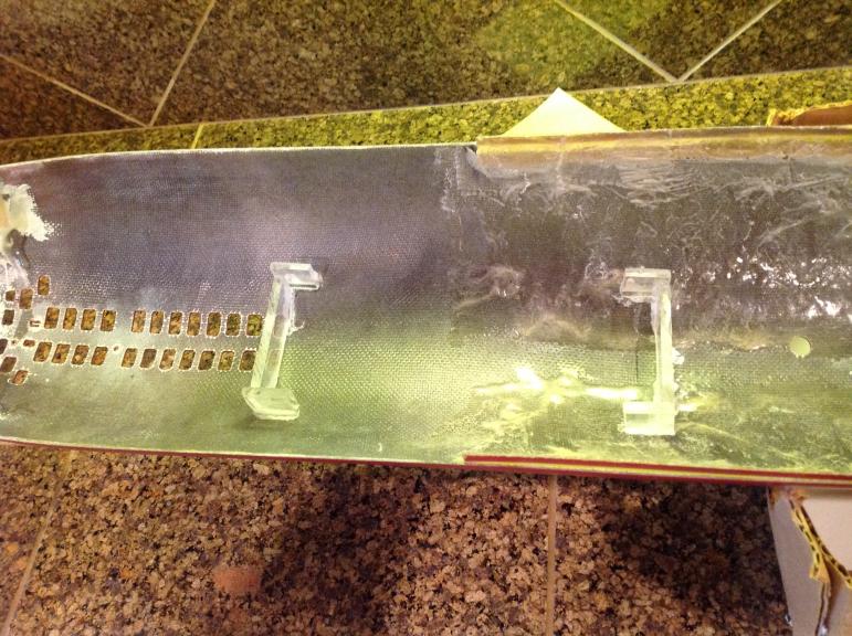

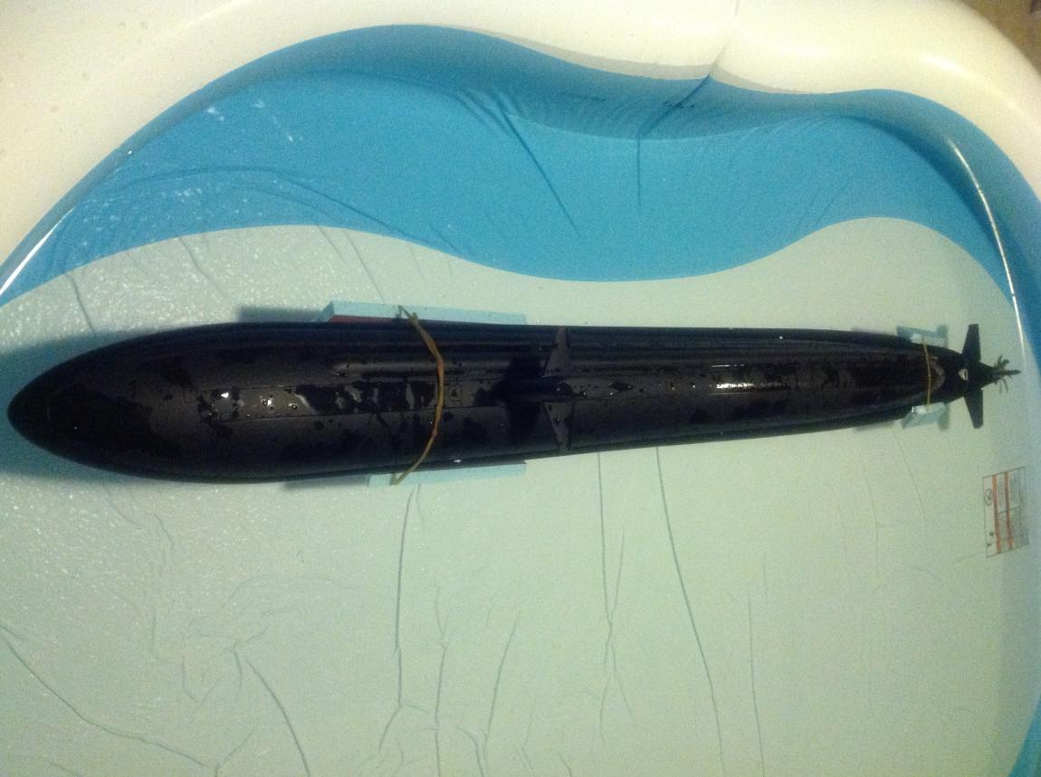

                  So, I went back to the drawing board with the battery...I dug up an old 12V, 2.5 AH battery I had lying around. It weights 2.5#, so more reasonable than 6 #.
                  I would prefer to get everything dry in a forward compartment, BUT I've been doing this boat for over 2 years now, and Its the only obstacle in my way of getting another boat.... the 1:72 Skipjack, so I'm going to wait on fixing up a dry compartment until I get that Skipjack.
                  I did some trimming yesterday in the kiddie pool, and discovered some leaks...
                  One of them, probably the most concerning was a slow leak from the pushrod seal on the Ballast tank bulkhead. I put some silicone on that pushrod, and we'll see how that works.
                  The other two leaks were embarrassing...there are four (4) pushrod exits on the 3.5" WTC, and I'm only using two of them. Last time I checked, 4 minus 2 equals 2, which leaves two pushrod exits still open. Yup, there was water in the enginerooom.
                  I'll deservedly get my pee pee schwacked by the boss for doing that, but I guess live and learn. No real damage done.
                  Below are pics of the battery location, and the pushrod exits, NOW PLUGGED!

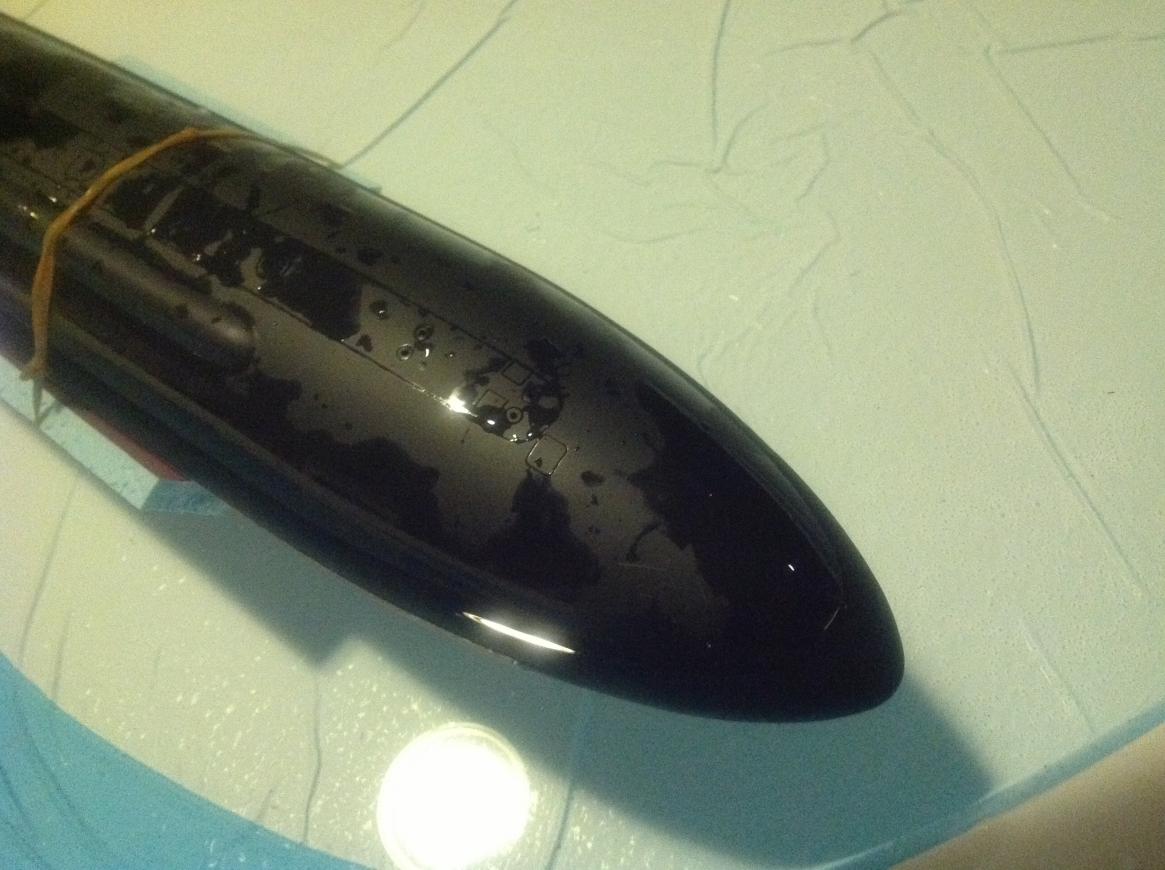

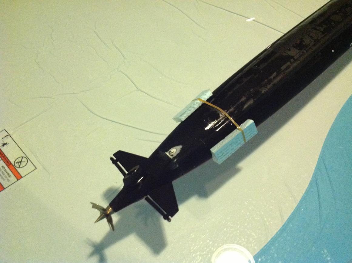

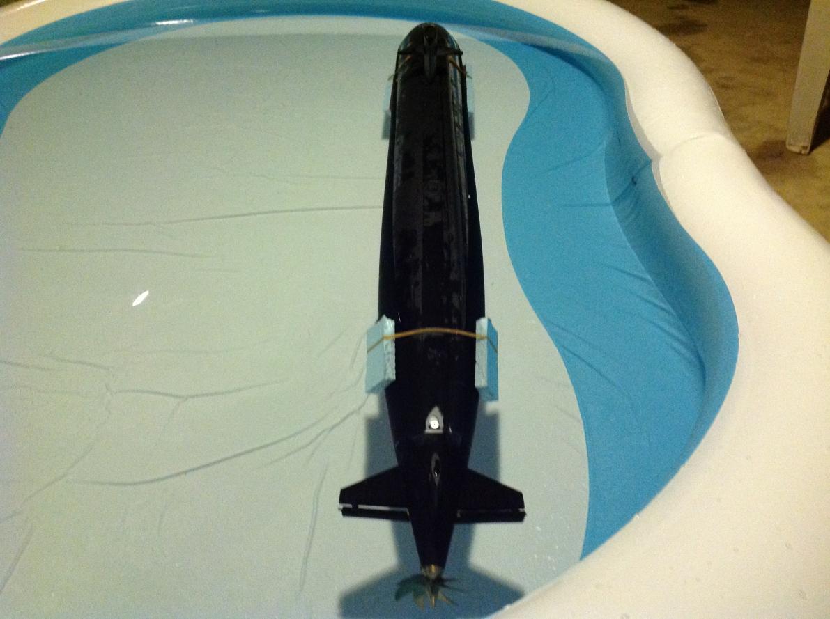

                    Thank you for saving me from 6 lbs of a battery, I would have needed a lighter than air substitute to trim the boat!
                    Right now, the CG is within +/- 0.5" of the center of the ballast tank, which is 1" forward of the geometric center of the boat.
                    And, the boat is wet.....

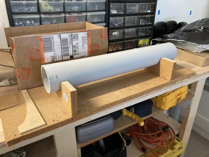

                          When we moved to Arizona I gave up my Greg Sharpe LA plans along with several others. Now I'm sorry I did that. The LA plans I found online are suspect. Can someone tell me the following dimensions?
                          a. Length of bow to fwd parallel mid-body hull
                          b. Length of parallel mid-body hull
                          c.Length of after end mid-body to fwd end of prop.
                          This will help as I start another model using 3-1/2 inch PVC pipe as my parallel hull.
