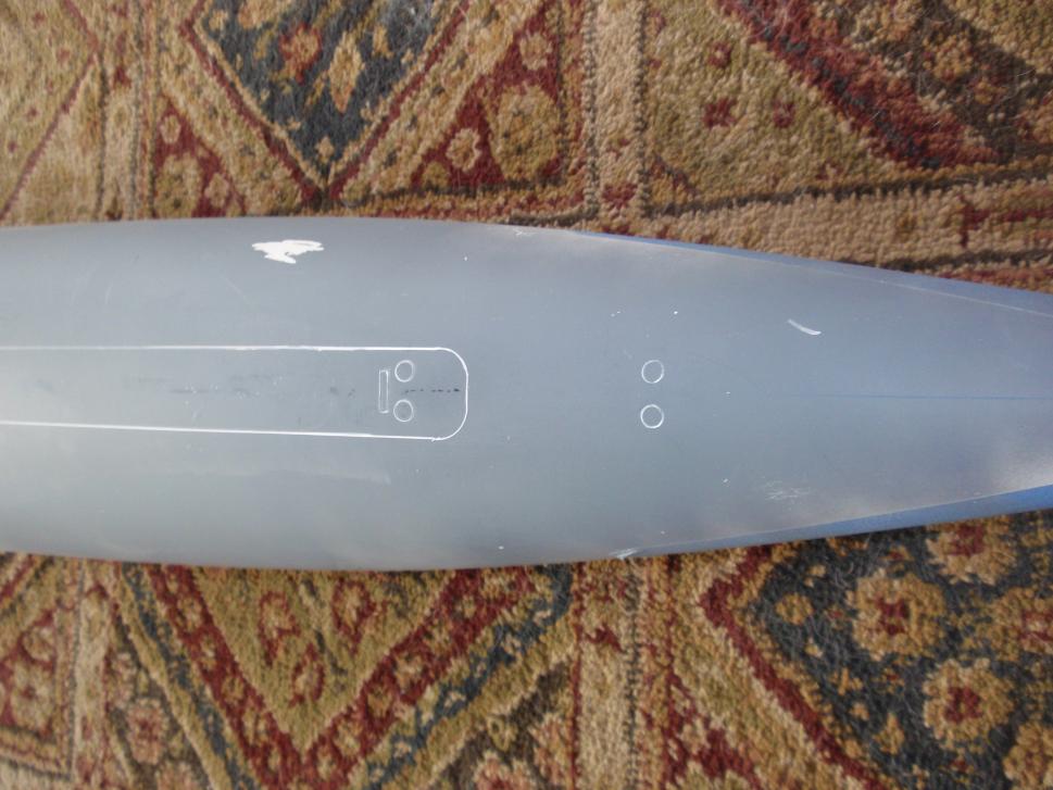

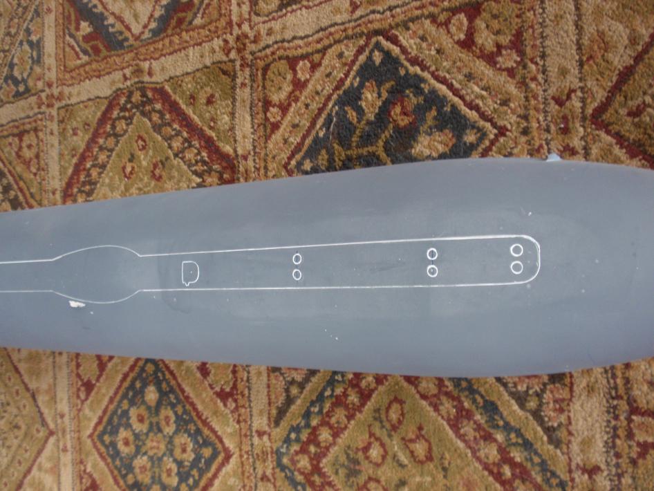

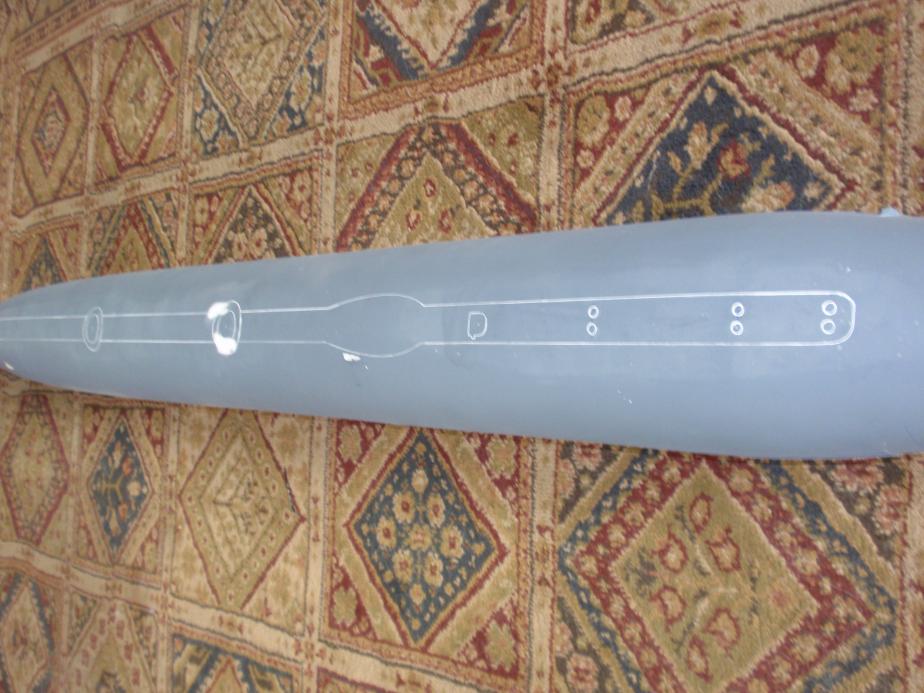

            I just finished with a bit of the corrective scribing.
            I attached a scan of the tail end...I think greg's plans only showed two sets of vents on the stern. Anyone have any confirmation on this?
            She looks a bit better now. Click image for larger version

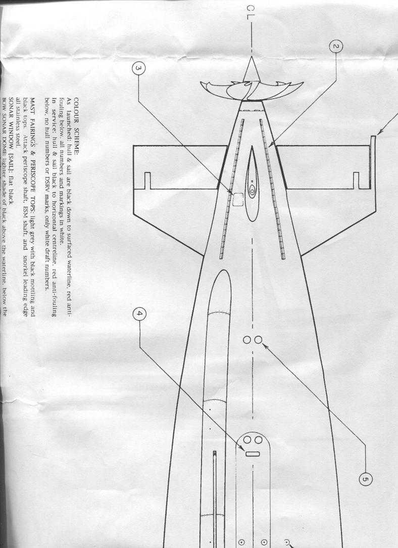

ID:	63194this is that tail end shot, with only two sets of MBT vents... That right? Most of the time, those things are underwater, when the boat is at the pier anyway, so its hard to see them.
                • 13948
                I stand corrected. There are only two ballast tanks in the after group -- four MBTV's.
                The stanchion foundations are 'bumps' on the pressure hull (remember, other than the bow, stern, and ballast tank areas, what you're looking at is pressure hull) around the two deck hatches, that stand about three inches proud of the deck. In the center of each stanchion foundation is a taped hole that receives a screw-in type stanchion.
                Pretty ratty looking engraving. You'll improve in time. Tip: make many light passes with the scratch-awl, not a few heavy ones.

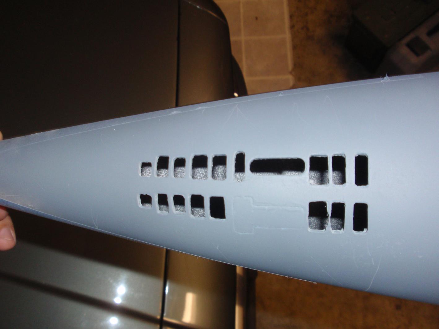

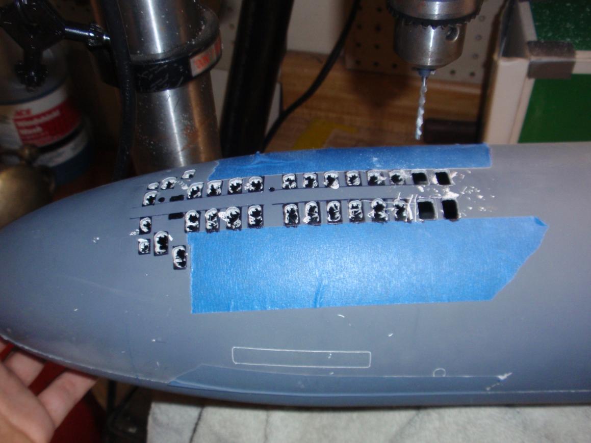

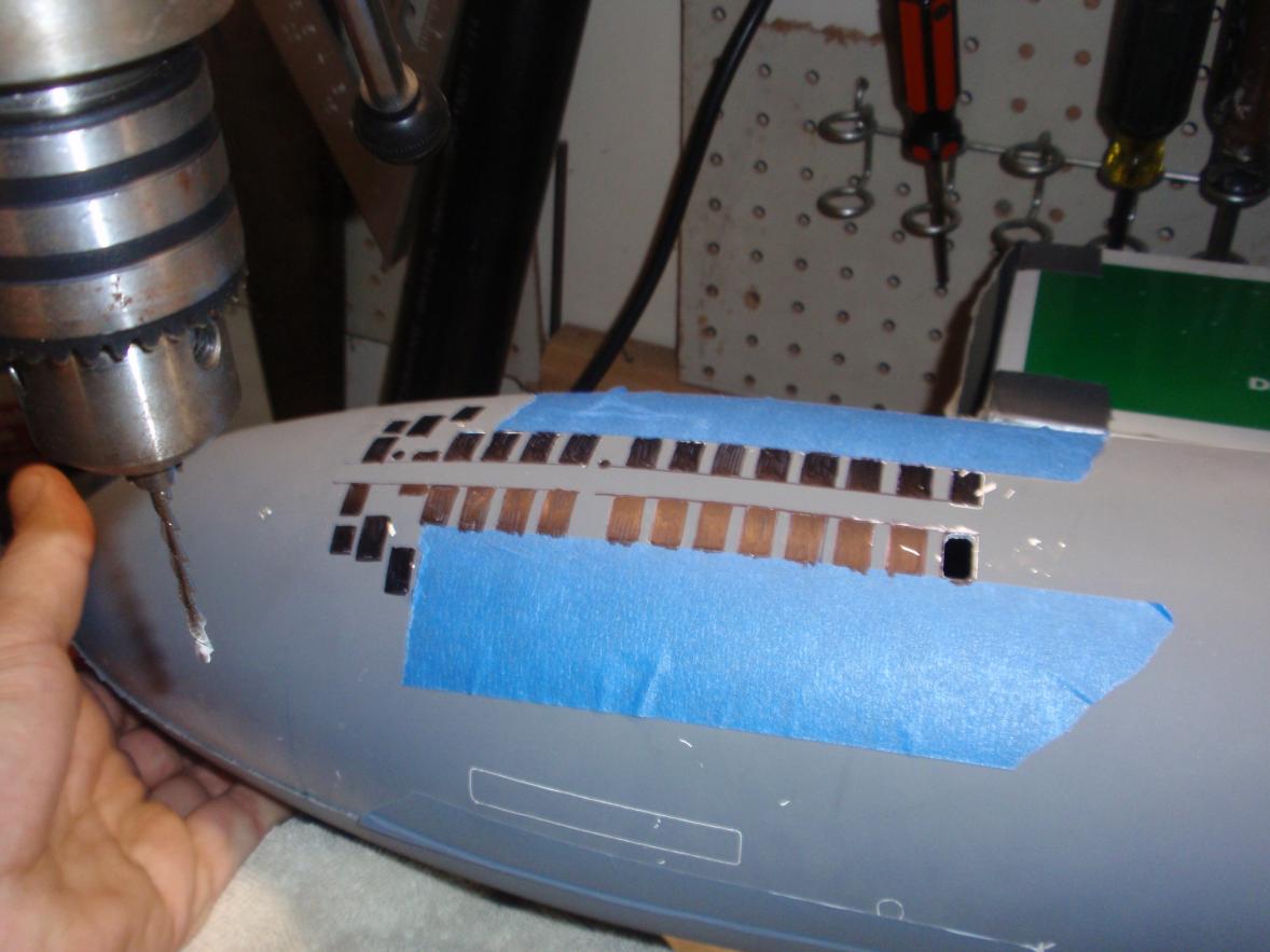

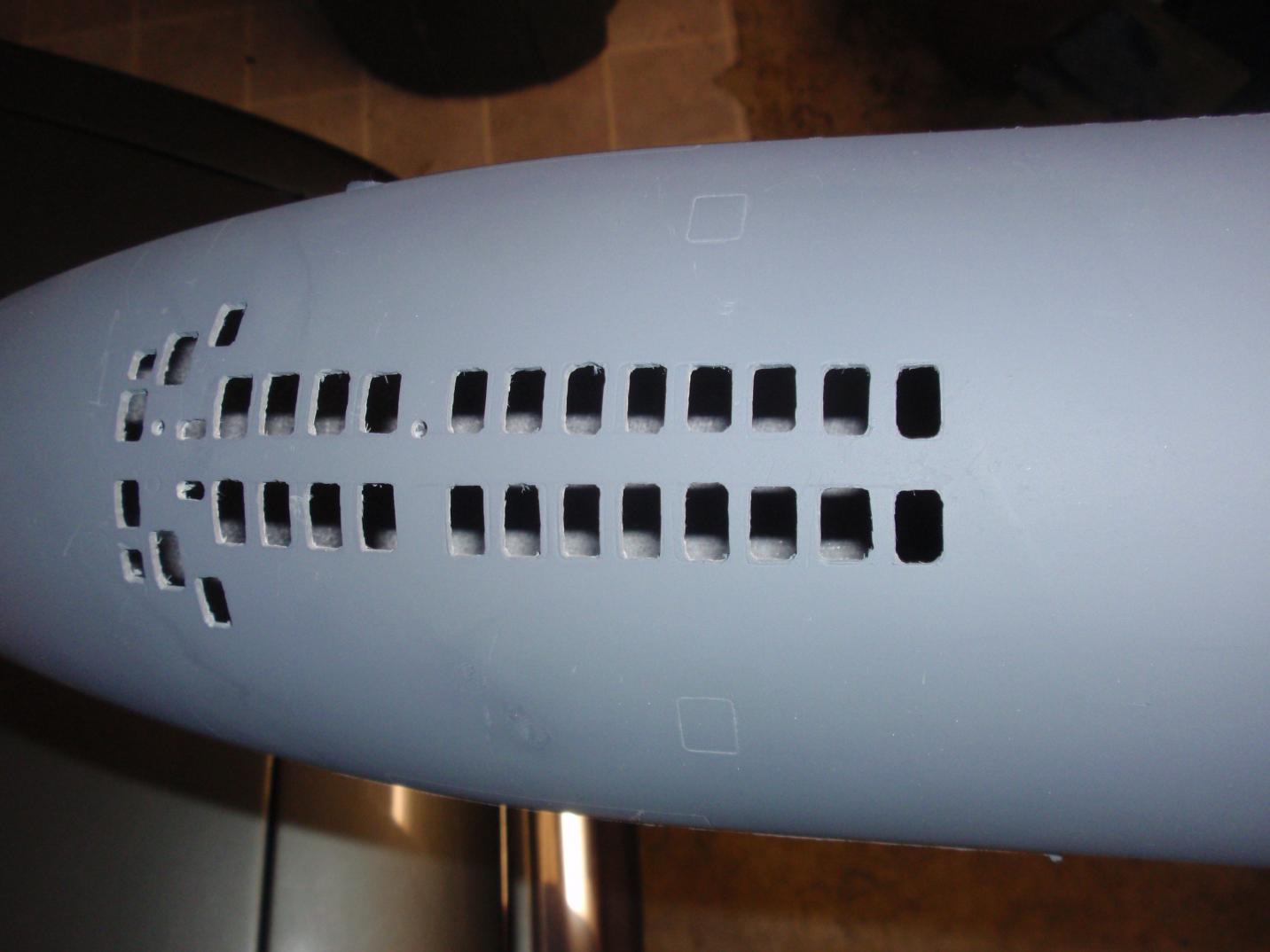

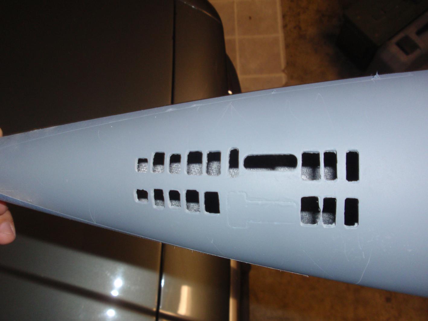

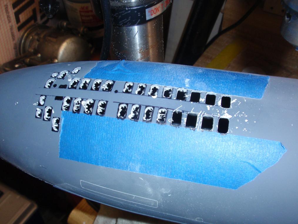

                      I did the FWD MBT flood holes this afternoon. Attached are a couple of shots of that progressing. The bottom half of the hull had been scribed with these holes prior to my receiving it, and they were not (1) straight, and (2) incorrect..i.e. not scale. SO, to the best of my knowledge, I corrected the flood holes, and cut them out, then filed them down.
                      You can see where I had tool chatter, and where the file dinged the hull in a couple of places, but it'll get filled and fixed.
                      Tomorrow, if I have time, I'm going to try to do the AFT MBT flood holes. They are also already scribed, so we'll see if they've been scribed straight.

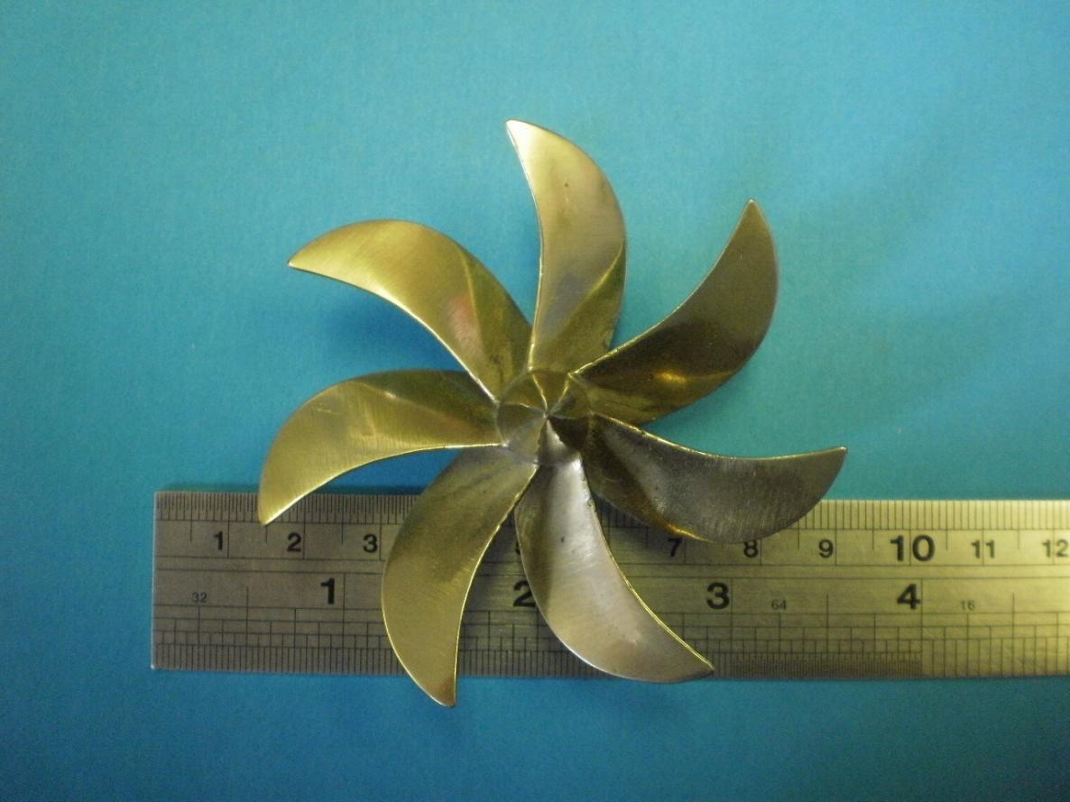

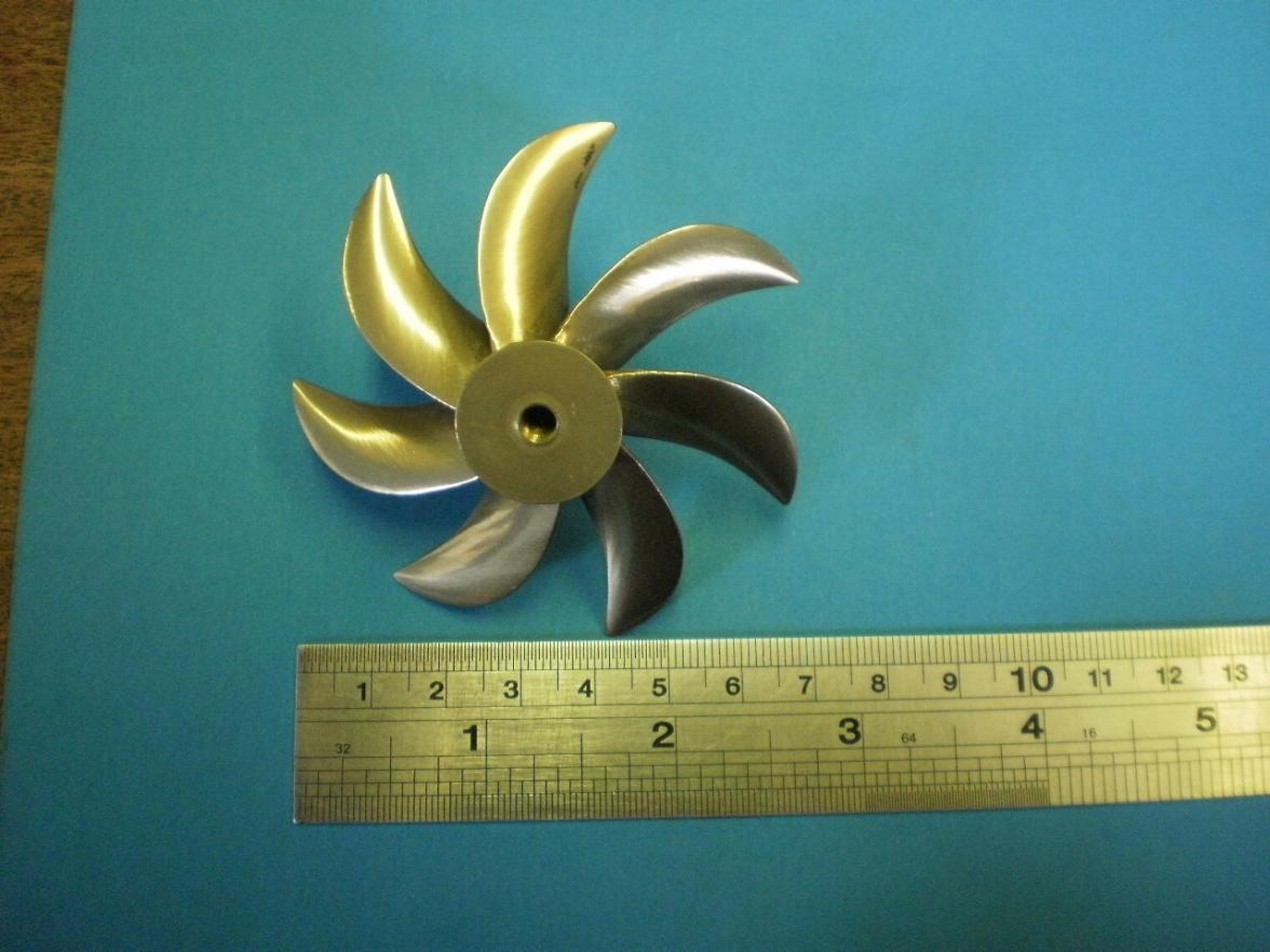

                      Also, ordered the PropShopUK propeller today, a right handed, 7 bladed scimitar prop. 2.8" diameter was the closest thing that I could find to scale for that boat. My guestimation calcs were showing a 2.93" diameter prop....2.8 is pretty darn close, and prop shop has some nice stuff.

                        Good work opening up the flood-drain holes. Nice propeller. Yes, alternate the indexing tabs. It's good and an accepted practice.
                        Keep at it, Spanky.

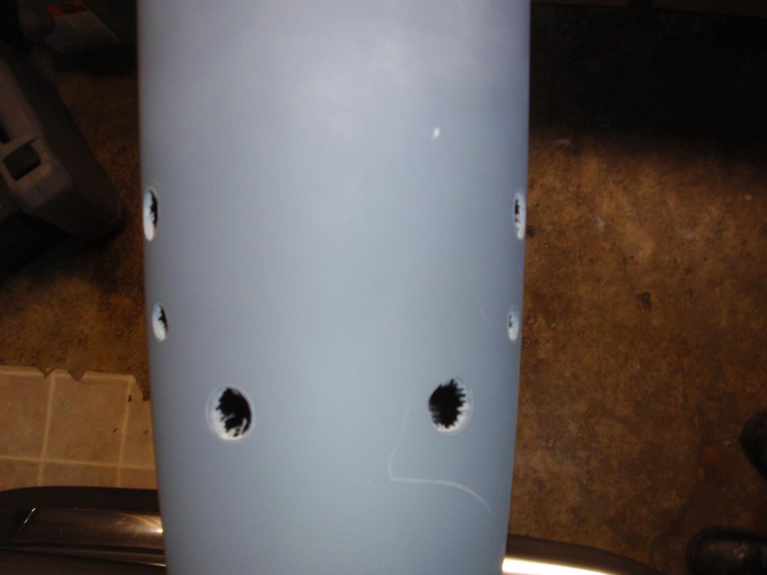

                          I had a little bit of time, so went ahead and did the AFT MBT flood holes. I was dealing with scribing that already existed, so I missed the fact that the anchor (next to the secondary propulsion motor) should not have been cut out...ohh well, we'll get that later.
                          Have to fill a chip in the Gel coat too...Yippeee

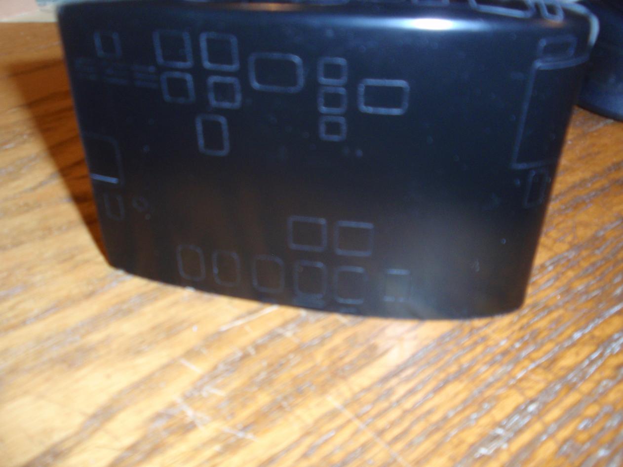

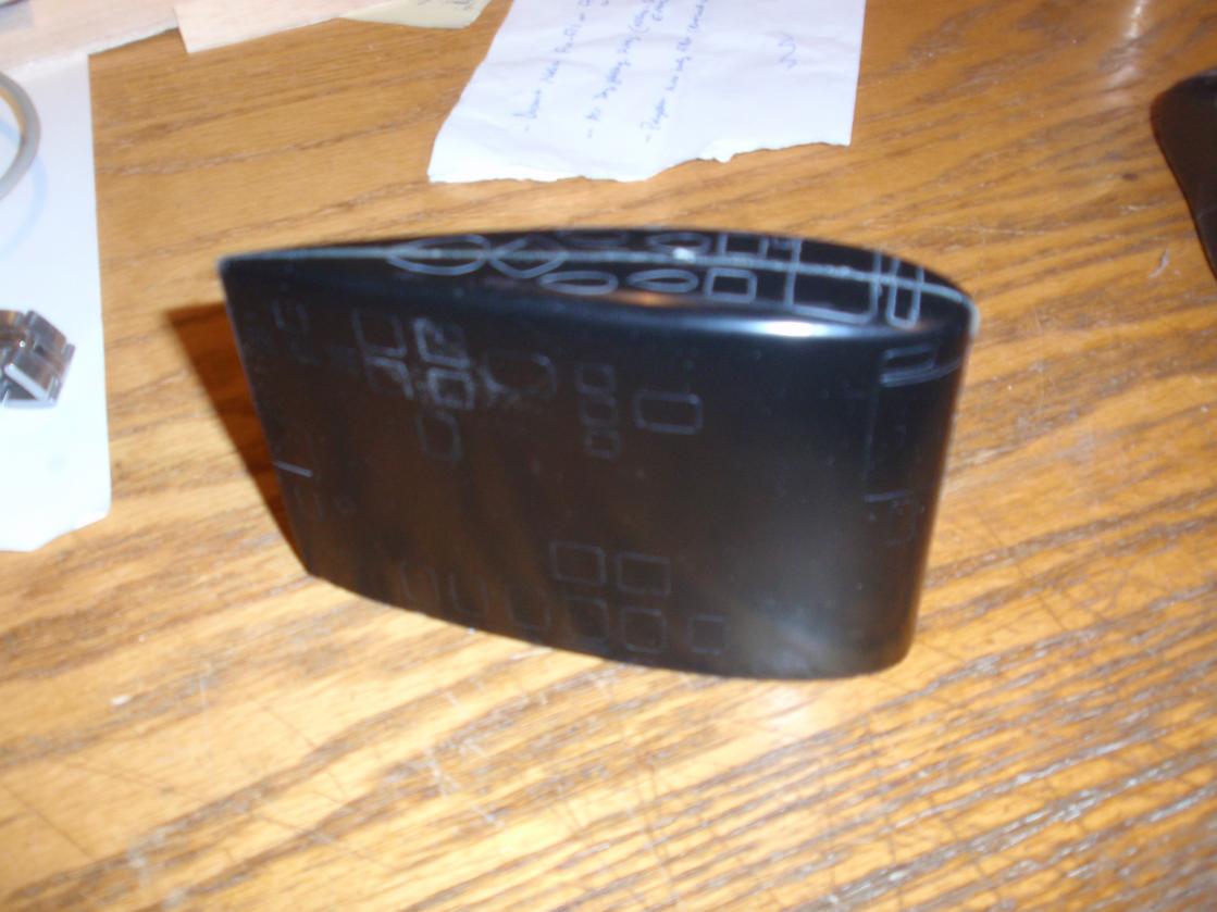

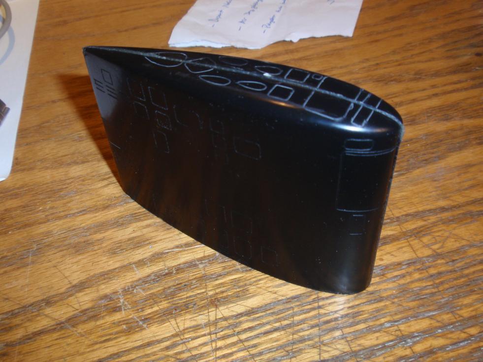

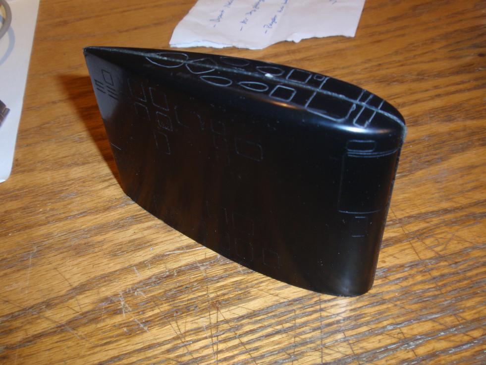

                          Also, a photo of the sail with its scribing.
                          If anyone has any advice, I'm building up a full set of planes/rudders for this thing. Was starting with balsa, and then going to fill it, paint it, seal it, then make some molds using clay. Problems with that? ...
