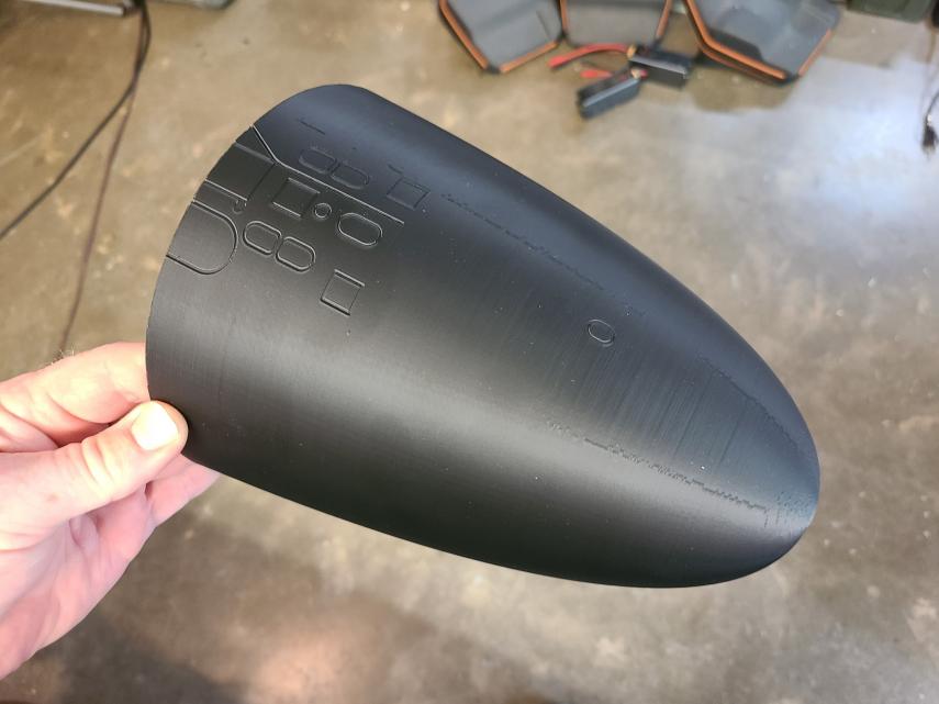

    I have started printing a 1/48 scale Thresher. It will be almost 70" long with just under an 8" beam. The bow just came off the printer. This one is being done in ABS+. It turned out very good.

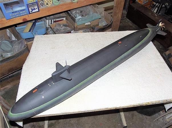

    A tease. Here's on in 1/72nd.
ID:	151986Click image for larger version

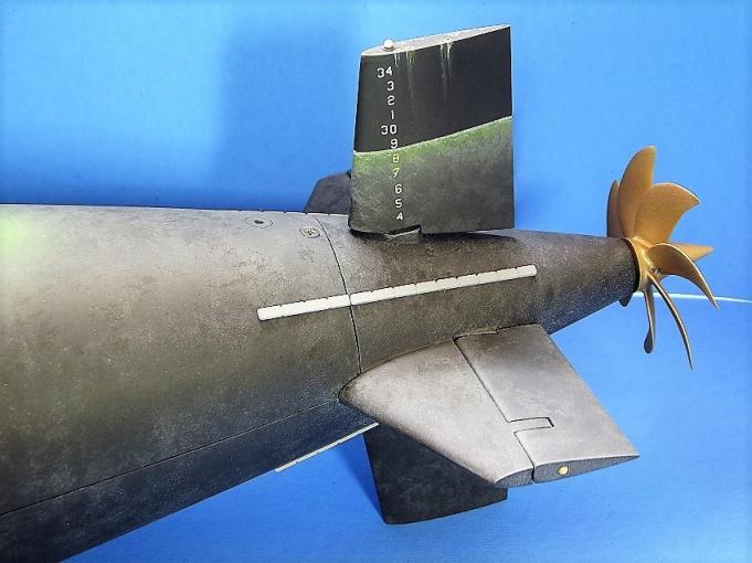

      Few questions for you if you don't mind?
      1. I have read that the Thresher had a 5-blade prop while the rest of the boats in the class (Permit) had quieter 7-blade props. Is that true?
      2. Do you know what diameter the prop was on the Thresher by chance?
      3. Did the Thresher have anti-fouling paint on the lower hull and if so was it at the water-line or middle of the hull?
      Thank you in advance.
        • 13997
        Stunning as always sir!
        Not at all, sir.
        1. I too have read that, but have never seen photos of the THRESHER (a Government design) outfitted with the five-bladed wheel. Likely -- as SKIPJACK, THRESHER, The early SSBN's, and STURGEON class used the same S5W propulsion plant -- the THRESHER had the five-blader for comparative speed-runs. The new wheel was quieter (a premium characteristic), but less efficient.
        2. The seven-blader is about 14-foot in diameter.
        3. Until later in the last century the government yards on occasion used a black anti-foul paint. Yet there are pictures of the PERMIT launched from Mare Island (a government yard) with anti-foul red from centerline down. I may be wrong, but at one time I believed that THRESHER, a Portsmouth (government yard) boat was launched with black anti-foul, but I've never seen a color shot of the boat on the ways to tell if it was all back, or had anti-foul red from waterline down, or centerline down. Still remains a mystery to me.
        At time of loss I think THRESHER had anti-foul red from centerline down.
        Sorry. Short answer is... I don't know!
        However, all that said: there is a video of the boat sliding down the ways where there does appear to be a color/shade demarcation line at centerline. Not clear enough to make a definitive call.
        One more thing, in most of the video of the boat cruising on the surface, topside was painted in the 'Pacific' scheme.
          Not at all, sir.
          Excellent information! Thank you.

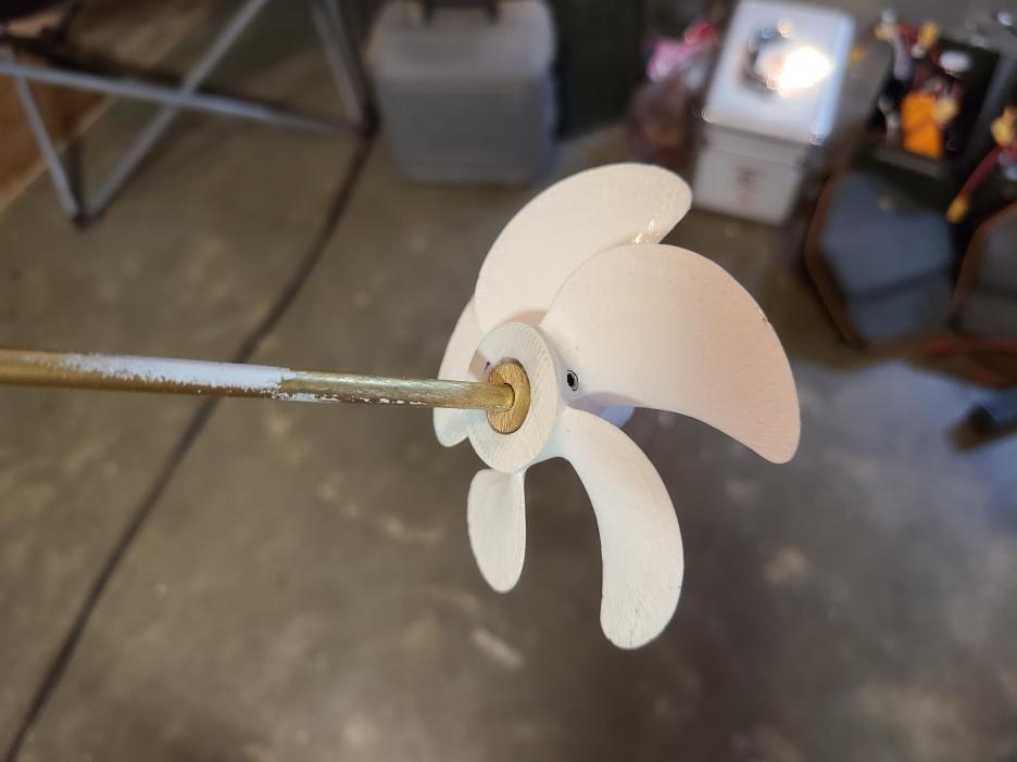

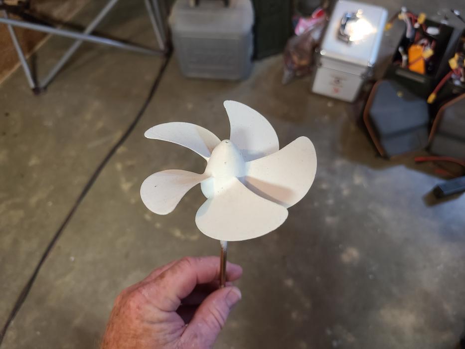

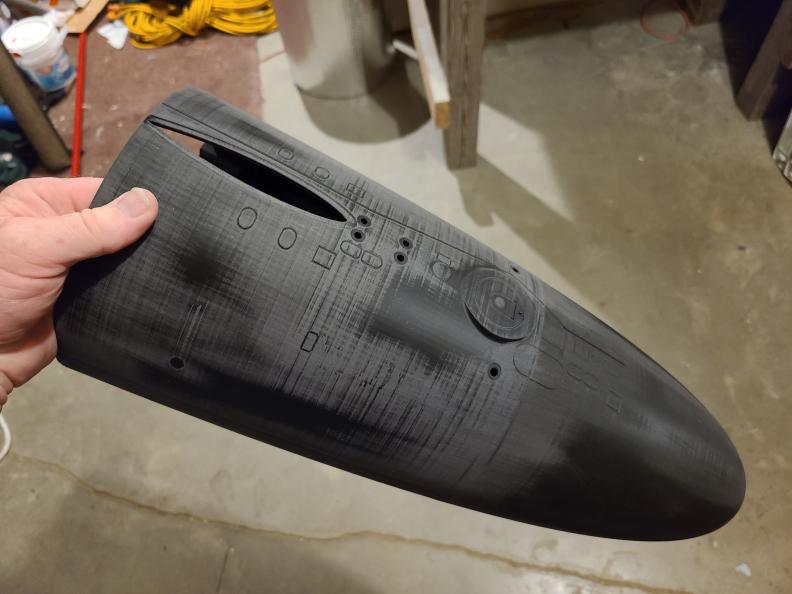

                      The first three sections of the hull are printed. The detail of the files is exceptional to say the least and the parts fit together very well. I have spent only a minimal amount of energy sanding them to the point that one good coat of high fill primer (Finish 1) will be all that is needed before paint. I am going to make brass catches to slide lock the upper hull to the lower hull to help lock the two together through the center. The ABS+ is some good stuff and the Ender 5+ is printing great. The way the parts are designed there is minimal if any need for support structures. I hate wasting filament on supports. I also downloaded and printed a 5-blade propellor (3-1/2") as I decided that is what I am going with. It may not be exactly true to the original prop but I really don't care. It will work. After I hit it with the primer it will make it very strong.

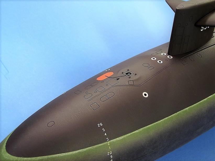

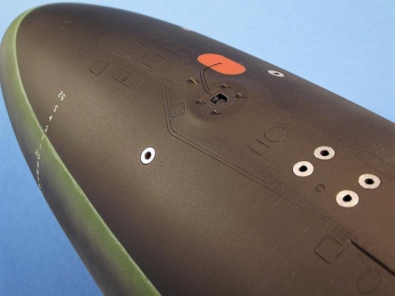

                          Hey David, can you tell me a little more about this hatch detail?
                            • 13997
                              Excellent! Thanks again.
