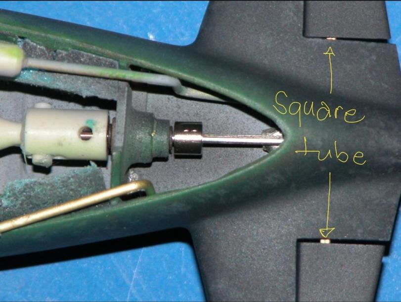

    I see now. I used round rods, epoxy and baking soda attached lower halves first, checked for free movement then attached top halves. I am having trouble getting my head around the square tubes...
    The square rod rotates about as well as traditional round rod in the bearing surfaces; provides a 'flat' for the pushrod control-horn set-screw; and provides a 'flat' for the set-screw set within the stern plane/rudder holding the operating shaft firmly in place within the control surface.

    Hi Biggsgolf, I'm talking about the shafts that go inside the dive planes. Click image for larger version

    Thanks David, had a brain fart
