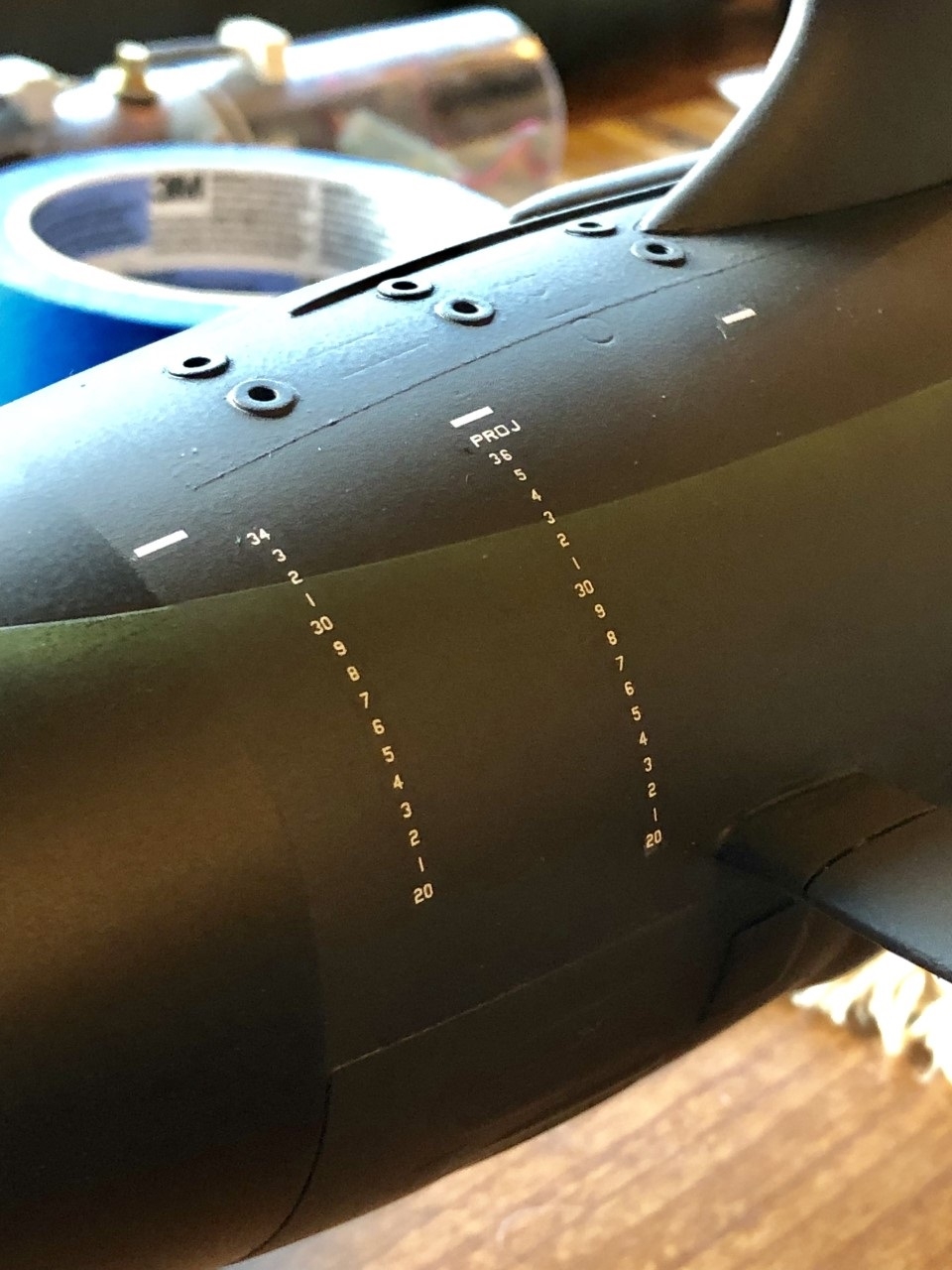

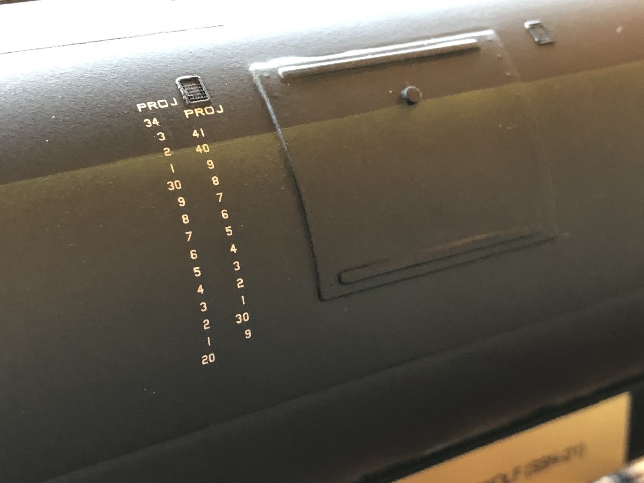

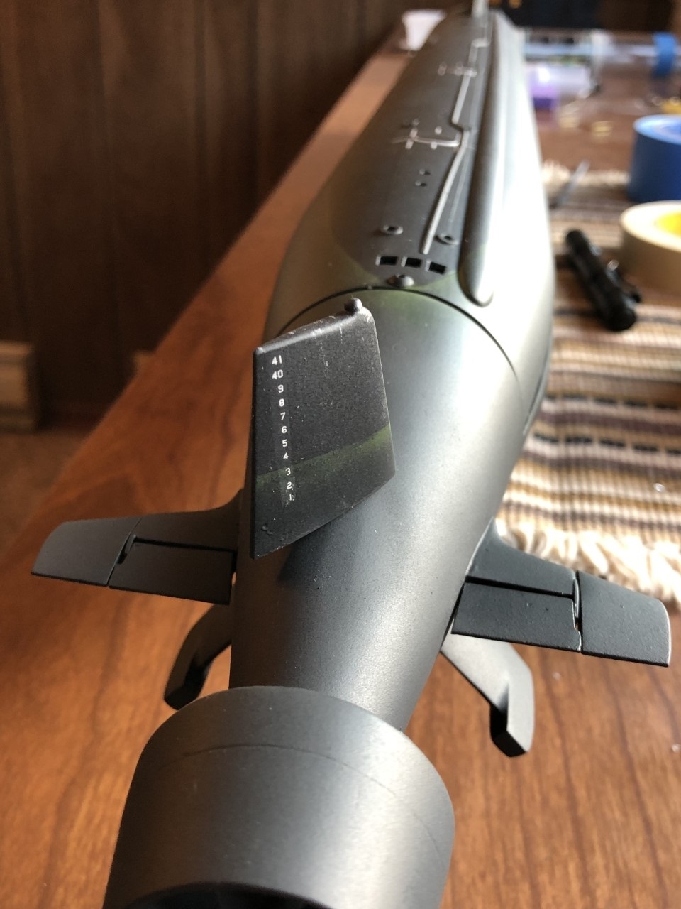

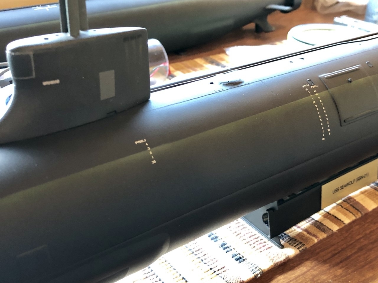

                  As promised.

                  Now let's see how she does on her next trip to the pond. Stay tuned!
                  -Brady

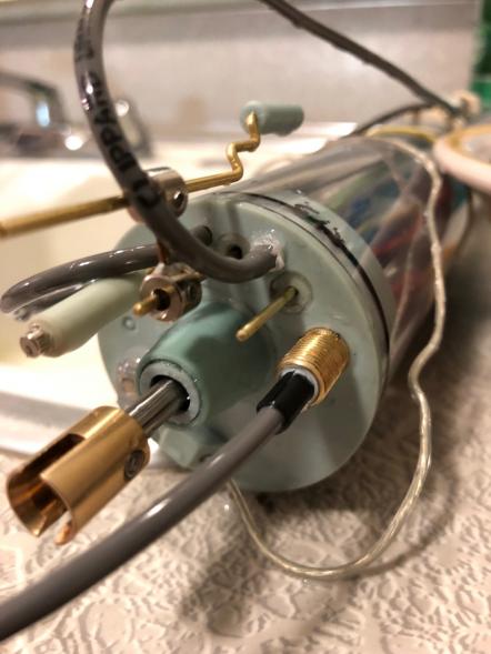

                          Told you there was more to come! Some testing revealed a tiny ingestion of water into the aft space of the SD. Sealing it up and blowing through the modified Shrader valve reveals a small stream of bubbles coming from the aft plane servo rod seal. Thinking I was being clever, I popped it out and replaced it with the spare that came with the SD. Low and behold.... I got the exact same result. Bubbles.
                          Which leads me to two questions:
                          1. Could this gap in the seal + the action of the servo rod sliding back & forth be enough to cause a leak?
                          2. What is the fix? I’ve already tried replacing the seal. The shaft was an impossibly tight fit in the replacement seal, so I lightly sanded it. However, on its own I would say it still fits into its respective seal tighter than the other shafts do.

                            Shaft is slightly out of round. Invest in some silicon grease and lay it on the sucker and see if it stops the leak - otherwise replace the control rod with a nice bright, lusterously smooth, new piece of brass.

                              Bore out the seal with a .063" bit, that will widen the bore, but will not nick the internal rubber seal. That will give you an easy, non-interference fit between pushrod and seal bore. Use silicon grease as petroleum based grease will eventually break down the Buno-N rubber seal.
                              It's hard to tell unless you look closely -- but, is the leak around the seal body where it meets the water-side face of the motor-bulkhead, or is the leak from between the pushrod and seal itself?
                              When I send you that 212 fitting kit I'll throw in a few spare seals for you (I'll bore them out for you).

                                I think I solved it.
                                Using all of your suggestions.... 1/16” bit to bore out the shaft opening, plenty of silicone grease, I fabricated a new servo pushrod, and per the recommendation from Scott, I shined it up to a high polish.
                                Aaaaaaannnnnnnnd it still bubbled. So I took the next step and smeared some RTV around the end of the seal body and the aft cap of the WTC and voila! No more bubbles. I will let it really dry before putting it back in the water, but I am definitely encouraged.
                                Switching gears - Mister M, could you please enlighten the class once more on your preferred media for sealing a paint job? I know you love automotive paints. How about matte clear-coats?
