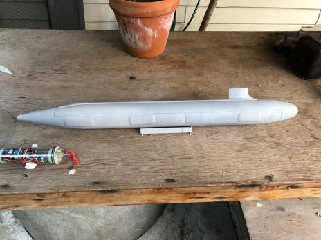

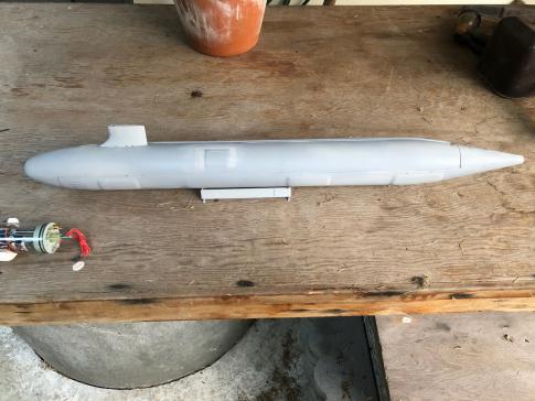

    Somewhere along the line I got the bright idea to try and build a submarine. After many dead ends and forks in the road, I find myself with a modified Seawolf hull, a 2” inch sub driver, some very smartly engineered 3D printed pieces, and the whole stack of Trumpeter Seawolf cabal reports.
    Gentleman, I am no craftsman, especially when stacked up against your ranks. But, occasionally I am a clever little SOB, and I figure that’s at least got to count for something :)
    With the help and talents of those far more skilled than myself, I think I’'ve got all the right ingredients to be dangerous. She’'s not perfect, but at least she looks more like submarine than a banana. I’'ll take it. Click image for larger version  Name:	JC Overall1.jpeg Views:	1 Size:	29.9 KB ID:	127304

    I think the next trick will be figuring out how to place the WTC so it’s balanced, especially with the 7” inches of extra hull. I’’m open to any suggestions.
    Comments and criticism are welcome. Thanks for looking!

    Install about one-pound of fixed lead ballast low in the hull to place (with SD installed) the models C.G. in the middle of the hull. That's it.
    Put the middle of the ballast tank at the boats center of gravity.
      Much appreciated, sir! Thank you.

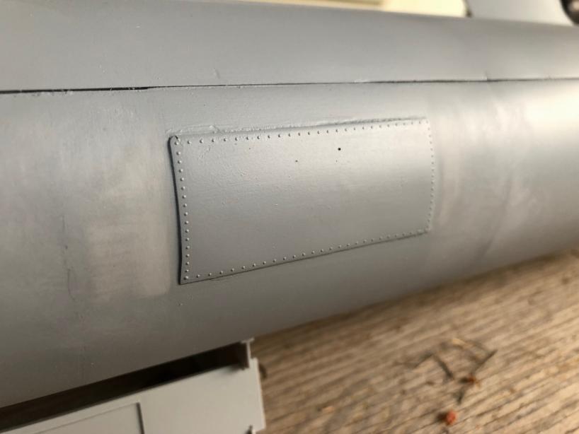

          Nice rivet detail. BTW, How did you extend the hull?

            Thank you! Bob Martin posted a video in which he used Archer Fine Details’ rivets. They work just like a water slide decal, and they’re not inexpensive at about $17/sheet, but they turn out looking great.

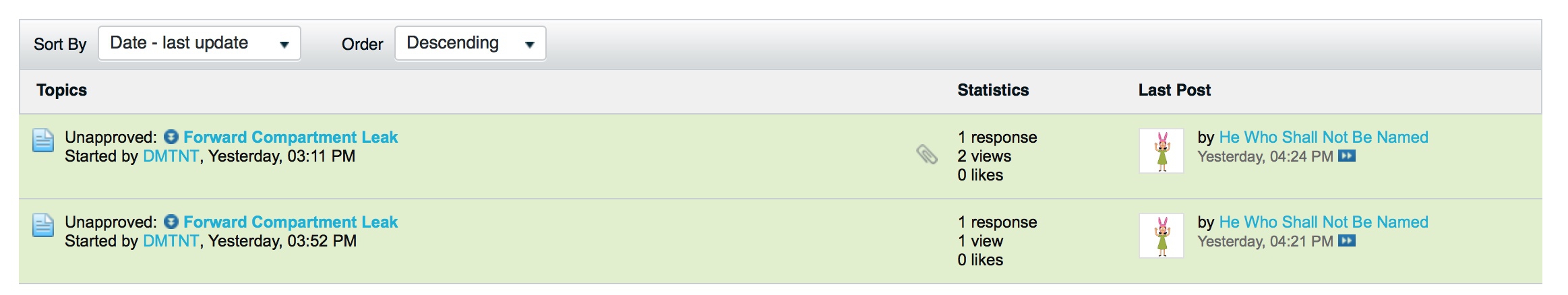

              My forum settings seem to be buggy, hence the quantity of reposts from me in the last few hours. Apologies, this has been kind of maddening. It's like my posts are posting, but they're not showing up - but they're also being replied to.

ID:	127480 Here is what I see as postings. I have no way of clearing these and it says I do not have rights to view.
                Peace,
                Tom
                  Looks like a boatload of duplicated posts when you panicked when they weren't showing up. I approved two that looked to be different (and that Dave replied to) and deleted the rest. I think we're good now, provided you can post up
                    Well I’m embarrassed now.
                    Thanks Bob. My apologies again to you guys if it was cluttering everything up for everyone else - I was trying my best to troubleshoot it without being a nuisance but my screens were all blank every route I went. It even told me to contact the administrator, and when I did, it told me I didn’t have permissions to contact the administrator. Anyway, it seems to be straightened out now.

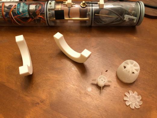

                      Keeping with the theme of working on the aft-end, I've been thinking about how I'm going to set up my driveshaft. I have a 3/16" polished, stainless shaft that's on its way. I went a different route with the propulsor assembly, and am using some 3D printed parts that I got on Shapeways. My question for the group (I promise not to accidentally post a hundred duplicate pages!) is regarding the center opening of the plastic part and how it will interface with the shaft. The hole down the middle of the printed piece is 4.8mm, so just a shade bigger than the shaft itself. For those not familiar with the plastic that Shapeways uses, it is remarkably durable. Much, much more so than your average model kit polystyrene.
                      I also have a couple of Oilite bushings that have a 3/16" inner diameter. Given that the shaft will pass through two concentric supports at the tail end, do you guys think it'd be necessary to bore one out to about 1/4" and press-fit an Oilite bushing into that space? I guess my biggest concern would be the spinning shaft creating friction/heat if it were resting directly on the plastic. Then again, this stuff is pretty damn strong as it is. It's not really that much more effort to add a bushing, but I thought it might be worth asking the group before adding an extra step if it was unnecessary.

                        I assume the rotor fits between the two concentric circles. If there is an oilite bearing in the stern of the model, that will keep the shaft from moving latererally. If so, in that case, you don't need bearings in the bores of those two weird concentric thingies if you make them a non-interference fit to the rotor shaft. Just what the hell is the function of those two things, anyway? **** it! Cut them out of there!
                        Here's what a proper pump-jet looks like:
                        And the PJ I developed for the 1/144 SEAWOLF kit:
                        Maybe you should check with me before jumping off the deep end on such things?

                          I've attached a sketch that shows the individual pieces in exploded form. Hopefully that clears up some of the confusion. I don't honestly know why he's included the opening for a shaft down the middle, but it seems like enough material for me to work with. Worst case, we improvise. That's half the fun, right?

                            That piece is the forward 'pre-swirl' type stator with bearing foundations. I assume you glue that to the ass-end of the hull and it forms the transverse-thrust bearing for the rotor shaft. Yeah, those two concentric circles are the bearings. Just bore them out enough to make a non-interference fit to the shaft, place a thin stainless washer between the after bearings face and forward face of the rotor hub. This will transmit the ahead thrust load to the hull. And you're in business.
                            You'll need to fabricate a G-10 half frame just forward of the stern control surface yokes and equip it with a bearing. A wheel-collar secured to the shaft and positioned at the forward end of the astern bearing, with a stainless washer between them, takes care of the astern thrust loads. Something like this:

                              Roger that. The plan was to basically copy your design for a bushing ahead of the stern yokes with a 1/4” piece of 3/16 ID Oilite smushed into a styrene sleeve bored out so it’ll be snug. I’ve retained the lower hull piece’s.... face? Whatever you cut off of the top one to make room for everything.
                              Good idea on the washer on both sides of the after bearing. Provided I can fit the damn thing in there without having to cut the forward plastic bearing out. Maybe it’s unnecessary.
