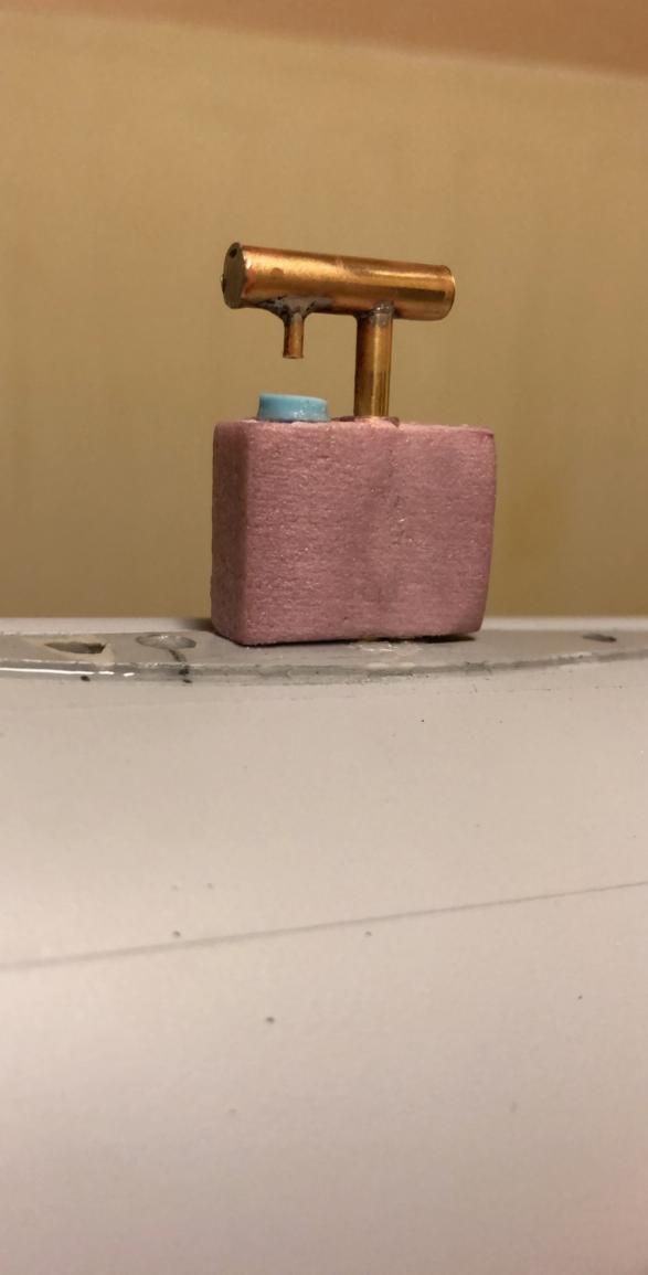

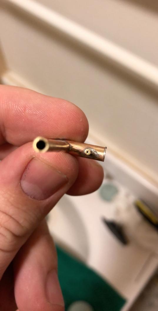

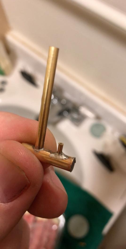

          I had an idea and began to tinker... Click image for larger version  Name:	IMG_1219.jpg Views:	1 Size:	23.1 KB ID:	129538
          Click image for larger version  Name:	IMG_1222.JPG Views:	1 Size:	34.8 KB ID:	129539
          Click image for larger version  Name:	IMG_1223.JPG Views:	1 Size:	34.8 KB ID:	129540
          Click image for larger version  Name:	IMG_1221.JPG Views:	1 Size:	32.1 KB ID:	129541
          David, I know you've sent another care package my way, but my mind is restless. I feel like this is a better effort than my first design, but it still isn't cutting it. There remains just the tiniest pinhole leak of air between the induction tube and the rubber gasket. I'm positive it's coming from that one spot, and I'm not sure how to stamp it out. I know I can make it worse with ham-handed attempts at trying to file the end of the tube, and I can bring it back to "almost there", but I can't make it go away completely.
          I went for an all-up test in the bathtub again, and while it did better than the old setup, it's still drinking a few CC's of water into the battery compartment after a handful of successive flood/blow evolutions.
          Other thoughts I've had regarding water ingestion - I wonder if part of it might also come from when the sail and the float are just broaching the surface. It would seem like a good practice would be to blow ballast for about a few seconds to achieve positive buoyancy, then let the boat rise until the sail is out of the water before trying to fully blow the remainder of the ballast tank.

            I love that you jumped in with your own fix. Good, aggressive problem solving.
            As a young torpedoman, working the forward torpedo room in the TRUTTA, I learned all about lapping tight the seats of brass torpedo tube valves.
            Those lessons have since been applied to the seating issue between the brass intake nipple and rubber element of the SAS snorkel valve:
            Bevel the opening of the nipple to reduce the seating surface area, then slide a piece of #400 sandpaper between the rubber disc and nipple -- grit side facing the nipple. Slide the sandpaper back and forth as you apply a very light pressure holding the rubber-sandpaper-nipple sandwich together. This will lap-fit the tip of the nipple to the surface of the rubber. Test. Sing my praises. Recommend me for sainthood. Mow my lawn.
            Also, as water is getting into the forward dry space of your SD, this points to a failed safety float-valve. Likely the float within that assembly has hung up. Invert the SD and slam it on the table with terrible, ruthless force a few times to shake the float loose. If the safety float-valve is doing it's job, no water should get by because of a flooded induction line.
