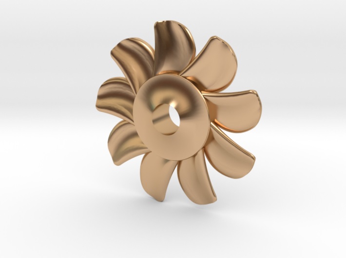

                      While we're at it, I have a question for the headmaster... Do you recall when you fabricated the impeller for the 1/144 Seawolf what the overall diameter was? I finally hooked up my setup and was beyond pleased to see it works, but I'm curious how my prop compares to one that's proven. Mine was designed by a fellow from Spain on Shapeways who intended it for RC use, but to my knowledge has never tested it. Attached are a few 3D photos. It measures 35mm and is cast in bronze. I've done some hunting for 35mm props / impellers, and while there are a couple out there, the options aren't great. I'm size limited due to the dimensions of the impeller shroud, which is also a 3D printed component. I could use the kit supplied impeller shroud and a slightly bigger prop, but it would require some redesign of how it attaches to the stern on my boat.
                      A few observations:
                      * Whatever poor handling characteristics the stock Trumpeter Seawolf exhibits are made even worse when you stretch her into Jimmy Carter.
                      * All testing thus far has been with an un-shrouded prop, for what that's worth. I intend to attach it with some RTV sealant so it can be removable if need be in the future.
                      * My prop, as is, with the stock 2" SD motor does power the boat forward. Not achingly slow, but it's not also not a rocket. I suspect if it were faster, the rudders and planes might exhibit a bit more control authority. I also realize it's nearly 4ft long, and those little rudders can only do so much at their scale size.

                        That rotor is a screaming piece of ****! Hardly any pitch to it. (Rule of thumb for marine propeller/rotor: pitch=diameter and developed blade area, less the hub, is between 60-70% of the disc). And there is no useful stator in there, just a four point shroud support. That makes this propulsor a dumb-ass Kort nozzle.
                        Don't equate pretty with useful. That propulsor is useless!
                        I get plenty of thrust from my PJ as applied to the 1/144 Trumpeter SEAWOLF. It's a frig'n rocket!
                        Why don't I just send you a proper pump-jet assembly for your long suffering 1/144 USS Peanut?
                        Yeah, the longer moment arm turns this piglet into a full-blown pig in a turn. Double or treble the area of the lower rudder.
