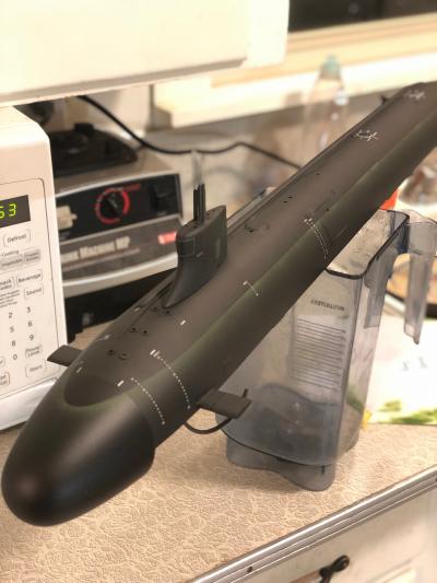

                          I have got to say, I am pretty damn pleased how this turned out.
                          Comments & criticism welcome, as always.

                            Looks like good, clean kit assembly there. How about some close-up shots of the exterior and interior. I want to see how you worked out the linkage to the bow planes. How were the markings achieved?
                            And lets have some video of this thing on and under the water. And take pictures of you shop (don't clean it, take them raw!) -- I find a man's working space to be the true picture into his state-of-mind.
                            And world peace …..... do something about that too!
                              #119
                              "I find a man's working space to be the true picture into his state-of-mind." I'm just scurring off to clean up my shed. No reason; just cleaning etc etc, mumble, mumble. PS That sub looks grerat Brady, (but it would look AWSOME in 1/96! Just sayin.

                                Thank you for the compliments, gents. I am out of town on the East Coast for the week, but when I get home I will provide some more detail.
                                DM - Evidance that I am too single for my own good, my dining room has served as my primary workspace on this project. To my credit though, it gets plenty messy.
                                Markings are from 4 of the Yankee Modelworks 1/144 Seawolf sets. I needed like 8 of those little PROJ markings! Also, the real CARTER has some draft markings amidships that don’t make any sense. At least she does in one photo I saw. Somehow 41 is stenciled below 34 in an immediately adjacent row.
