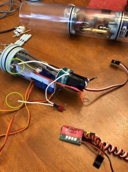

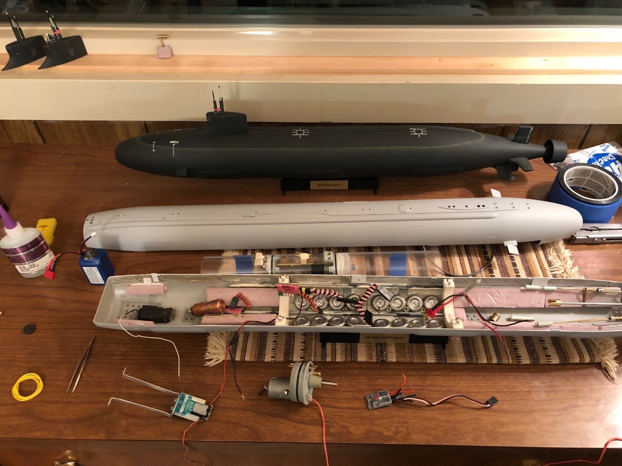

            Two days ago, my Sub Driver suffered a casualty in the ballast tank servo. It sounded like the motor inside of it began to run-away, and when I finally got it sorted out, it had burned itself out. Simple enough, I figured. Got a new servo to put into its place, but for whatever reason, the repair didn't work out. Also, while trying to re-install it, I must have put the wrong screw back into the wrong side on the brass strap that holds the servo to the forward bulkhead of the aft dry space. To boot, for whatever reason, the servo no longer properly actuated the mechanism that vents the ballast tank.
            So we're starting again. Only now, with the benefit of experience. There's more to the story that influenced my decision, but I put on my captain's hat and pulled the trigger. It's only money, right? I've disassembled the SD and there is a wealth of equipment that I can salvage, and put right back into use when I get my hands on its replacement. In the meantime, I'll clean up my workspace and get my things in order.
            Honestly? I'm more than a little embarrassed. And my pride is a little bruised at the notion that I could **** up something as nicely built as an already-assembled Sub Driver. But, it has been a learning experience. Albeit an expensive one. I figured it was best to confess my sins here and then get back up on the horse.

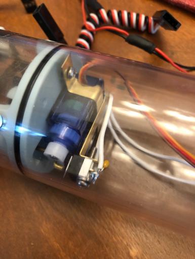

                    Ok Mr. Meriman.... you've gone and pulled a sneaky on me. What the hell is all this?
                    I'm guessing you've made a MOD to the design and already incorporated a Y-harness for the vent servo / lpb motor? Also, now that I've got parts in hand, I would love to hear your thoughts on cramming all this **** into the aft dry space.
                      It's a Klystron relay.
                      Seriously, though...
                      … I've replaced the electronic switch that drives the LPB motor with a mechanical one -- specifically, a limit-switch. This eliminates the need for a Y-harness from the ch-4 port of your receiver. Now, just the ballast servo hooks up there and the servo driven limit-switch activates the LPB. Just make up the two bare wires to the battery cables and you're good to go.
                        Gotcha. Stupid question, but which one is positive and which one is negative? They’re both white
                          Don't matter: neither the switch or motor are polarized.
