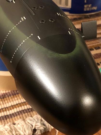

          I know you hate hobby paints, but try to remember that static applications have literally been all I have ever done. That said, one thing I have always appreciated about Testors Dulcote is I know what I am getting. I have applied it over a wide array of paints with almost universal success. Not to mention it dries relatively fast, relatively stable, and generally provides the effect I am after.
          No great reward comes without risk, so that is why tonight I am going to try this latest can of Rustoleum Acrylic Enamel on CARTERs lower rudder. Detached, of course. If that checks out, I will spray the entire boat. Either way, I will report back to the class.

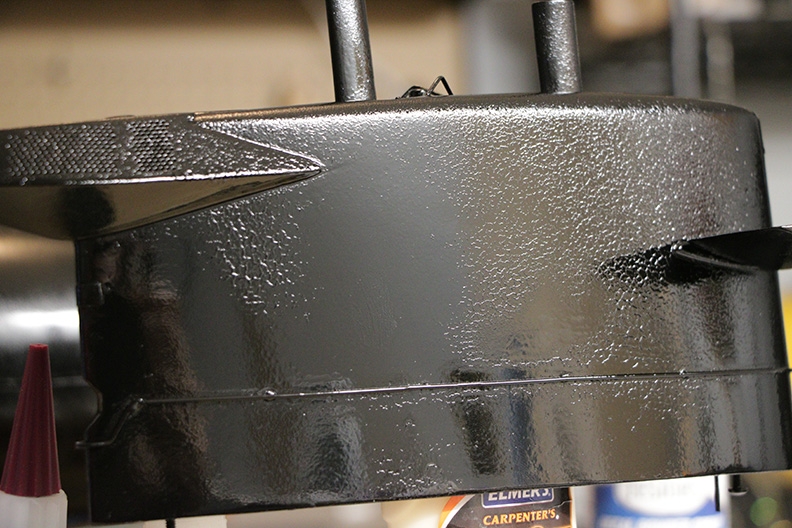

            I can only agree with David. I just recently tried Rustoleum gloss black (a new can because my old one was empty - that was what I used over the summer). I sanded and cleaned and sprayed a light coat and it immediately began to crinkle. I used Rustoleum Matte clear and no issue. Plus many paint cans do not say if they are lacquer or whatever. I am reluctant to buy Automotive paints, but I may have to sell my kidney and some bone marrow to start buying the stuff he keeps yelling at me to use (with a few explicative thrown in). Click image for larger version

              Well, I think I can breathe again...
              Click image for larger version  Name:	EACAD6E8-FDD7-48FE-870C-75A6D9300C10.jpeg Views:	1 Size:	27.5 KB ID:	130631
              That bit of texture was already there, and is exaggerated by the light, but this is what the boat looks like overall. God that was nerve-wracking. The overcoat is now dry to the touch, but I will give it at least until tomorrow night before I touch any of it. It still looks glossier than I would like, but we will see how things shape up as it gasses off and cures through.
              Tom, I know what you mean. The can really does not tell you **** about what you are getting. The guy at Home Depot was very helpful though. I may try the automotive route on this little 212 that David gave me. We shall see how this goes.

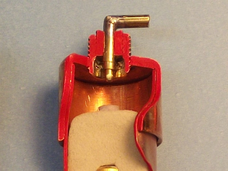

                      The upper cap is simply pulled off as it's secured with RTV adhesive. Take the float out, mount it in a lathe (or big drill chuck) and as it's spinning, shave the surface of the rubber element with some clean #220 sandpaper. Check that the nipple within the cap is clean and free of obstructions. Coat the surface of the rubber element with some silicon grease, and re-assemble. Curse at the safety float-valve mightily, wave a 3 lbs. hammer at it, and threaten its family. Install and test.

                        David, is there any consequence to there being a gap between the float and the walls of the copper cylinder? Say, a total of ~.5mm ?
                          No sweat.

                            I see your testing with a syringe. I'm guessing that a successful test, pushing water in from the bottom, will result in no flow through the top nipple? I tried it a different way by attaching a tube to the top nipple and sucking both air and water through it. With the air, I heard just a tiny hiss, which is what started me on my current hypothesis.
                            Thank you, as always, o' great keeper of knowledge. Stay tuned.
                              Your protocol is also a valid test of operation. Carry on sir. (got your goodie-box off this morning).
