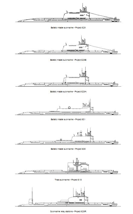

    I can help you out here, your SAIL pictures are NOT from the same projects/class
    The left one is from a GOLF II
    Project 629A,
    The right one is from a GOLF I
    Project 629
    To be complete, below are the variants on the same, but the difference can be easily noted, except the 629B she is a 629 and 629A lookalike.
    You can tell the difference between the 629, 629A and 629B as you look to the missile hatches.
    So if you are making the 629A GOLF II make the sail as the left picture and you will be alright.
    Project 629B
    Project 601
    Project 605
    Project 619
    Project 629R
    Grtz,
    Bart

    Perfect example of what I am talking about. 2 different drawings of a Golf II sail. Which one is right and which one is wrong?

    Thanks for the info. I have those same drawings as well as 40+ drawings for the Charlie I. The problems I have run into in making Russian boats is no two are the same. Like the Charlie drawings I got from Russia no two are the same. You can look at photos and no two are the same. Take for instance the Charlie I. Russians mad a early and a late version Charlie I. Basically you have to take the info that is published and see what is consistent. Same with my Golf hull. What you is what is getting molded.
