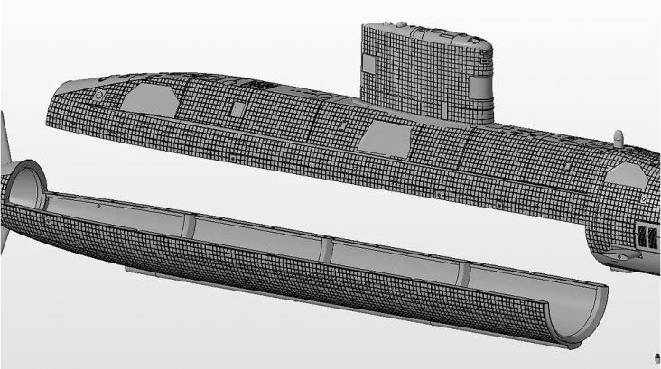

    The files are quite detailed - the outer hull is well crafted with the Anechoic tiles showing clearly, and the 'bits' underneath them appear to be mostly in the right spots based on my rough guestimation. Torpedo tubes, flank SONAR arrays, torp loading hatch, access doors, etc, well detailed and looks really good.

        To add - if you look at the lower hull joins, you'll see the inset angle part - I think that's designed so that you can add some fiberglass cloth/resin over them inside to give a stronger join.
        The slight misalignment of modules is my own fault - less than 1/2mm on them, so a bit of sanding and it was all fixed up and smooth.
        The small holes visible along the length of the join line between the upper and lower hull appear to be for magnets that can be inset to hold the hull halves together to enable easy access to the interior.

              I am just getting started myself. I also purchased the Victoria/Upholder files from the Drydocks. I intend to start a build thread on what I have so far on mine of the HMCS Victoria. A couple of items that may help for a potential RC version:
              • The material that I would recommend is ASA for RC use due to the temperatures it would be exposed to.
              • The bow would typically be attached to the upper hull, and the stern to the lower hull. In this configuration, the bow can be slipped over the lip of the lower hull, and then a single screw attachment can be used to secure the upper hull at the stern location. This is the "Z cut" that is referenced at different times. With the current hull that you have it may be challenging to get the upper hull to tuck under at the bow and clear the stern if you had to separate them regularly like an RC application. Magnets may not be needed at that point. I believe I will be able to just use small tabs to keep the hulls in register down the length of the split.
