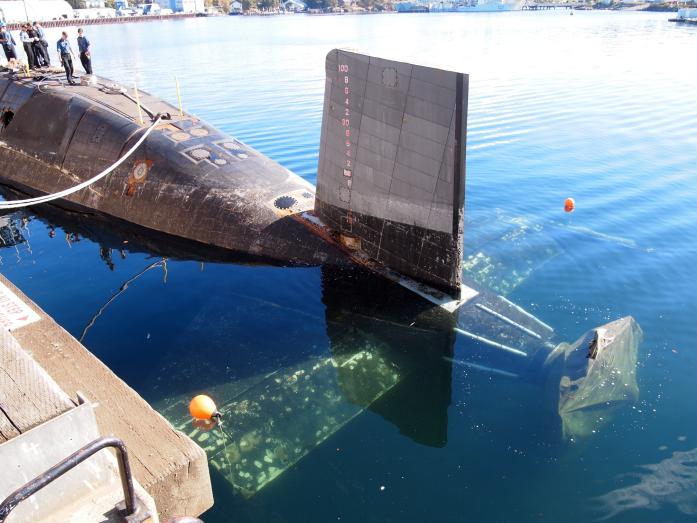

      Rudder of sistership HMCS Victoria

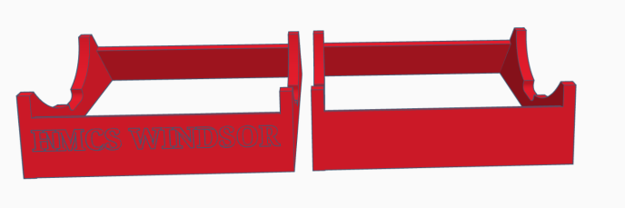

          Also, I created this sub display stand - It was something that didn't come with the print files.
          If anyone wants copies of the print files, let me know.

            Based on the dimensions given above, I'm working on watertight cylinder end caps now. Tinkercad is a simple program, but for stuff like this it's quite handy.
            Here's my first go - should fit in a 70mm OD 66mm ID (2mm wall) cylinder, and accept 66mm O-rings (using 2 because...why not?)
            One has a central hole for the shaft. I'm thinking of drilling the other holes.
            Print ABS and add a layer of epoxy to seal them completely?

              • 3746
              I would print with all the holes in the escape and drill out to the correct size if needed. You may need to print a couple of times to do minor adjustments for shrinkage and o-ring fit. You will want the right squish to fit the tube. I personally like 1/8th inch o-rings, but have used 1/16th inch.
              it is a fun adventure you are on!
                • 2637
                O-rings will typically be dimensioned on their inside diameter, assuming you purchase from a reputable supplier, so you add on the o-ring cross section twice to get full outer o-ring diameter. So for your example a 66mm o-ring with say a typical cross section of 3mm will be 72mm diameter overall- too big when using radial compression. You would want an o-ring of 60mm or lower for 3mm cross section rings. There is some tolerance with o-rings, but they shouldn’t be too loose or too tight to get a good seal.
                Getting the right seal is not art it’s science, assuming your printer is accurate if you dimension the parts right you’ll nail it first time,
                You should pay close attention to the end cap groove depth and width, the depth allows sufficient squish and the width allows the o-ring space to extrude as it squish’s, that last part is often overlooked. I aim for 10% of o-ring cross section squish sometimes less, o-ring supplier often specify up to 25% squish, but this will give the o-rings a hard life and make endcap removal difficult.
                I would use a minimum of 3mm or 1/8” o-ring cross section, but use a single o-ring rather than two. Extruded tube tends to have a poor internal tolerance and a thicker o-ring is both stronger and gives a bit more tolerance.
                Make sure you chamfer the edge of your tube to avoid the cylinder chafing/cutting the seal.
                I would also make your end cap outer edges larger than the cylinder if you have room in the boat, and consider printing some kind of knurl pattern on that part. Will make them much easier to remove in the field.
                Good guide on designing for o-rings https://www.parker.com/content/dam/P...e/ORD-5700.pdf

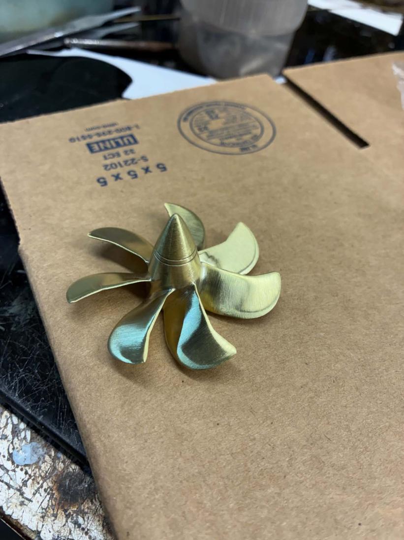

                    Here's a peek at the custom prop I had made by a gent named Keith Bender, and he's got it in the mail to me as of tonight.
                      • 2637
                      Have they fitted scimitar bladed props to this class? Certainly models I've seen here fashioned after the original UK Upholder class designation had a round-bladed prop design.
                      • SubSteve
                        • Apr 2022
                        • 143
                        Can't speak to the Upholder era but at least HMCS Victoria has a 7-blade scimitar. I suspect they all do. Scroll up to Post 17 and you'll see the outline of the prop under the cover.
