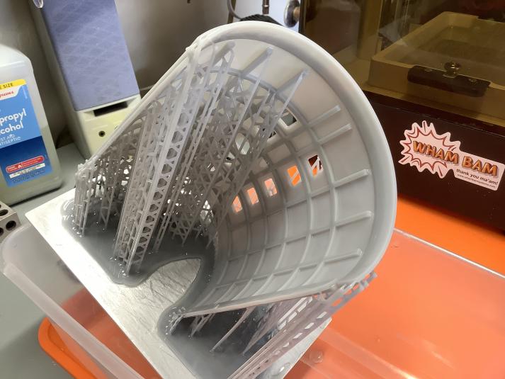

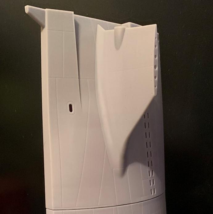

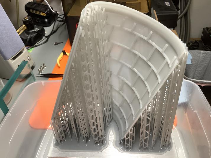

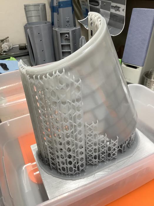

                        The CGTrader SSN-571 Nautilus is ripe for RC adaptation, but requires a resin printer to take advantage of the high detail built into the model. That being said, printing 2mm thick hull sections it while keeping it dimensionally accurate took me a few failures before I started getting consistent results. I'm using ABS-like matte grey resin over standard 4k Grey. It flexes a little more, but can be brittle around corners on the hulls.
                        First, I model in a ribbed support structure in all of the hull sections. This not only gives the model more rigidity while printing but once cured, make the parts stronger.
                        Slicing orientation needs to be a minimum of 45 degrees. This still leaves a large raft, but can that can be changed by increasing the tilt; I'll go as high as 60 degrees before the ribs start needing too much support. Anyway, manually attaching heavy supports to my rib junctions works well, and I throw a lot of supports at the corners and leading edges of the hull sections. Using lattice support structures intertwined in hexoganal patterns (on the Z axis) gives dependably rigid supports.
                        Once cured, everything lines up good and tight. For flat pieces, I cure them using a lab glass block. It keeps the parts from warping during curing and allows light to pass through. For larger parts, I place it on the turntable and it cures the lower edges and refracts light into the interior of single-piece hull sections.
                        As for PPE, I print in a well-ventilated area that is thermally stable. Resin is a skin irritant, so I wear gloves anytime I handle uncured parts or work with liquid resin. When sanding hull joints and raising dust, goggles and a respirator are highly recommended. I wet-sand whenever I can.
                        While a different Nautilus, the techniques are adaptable.
                        CC
