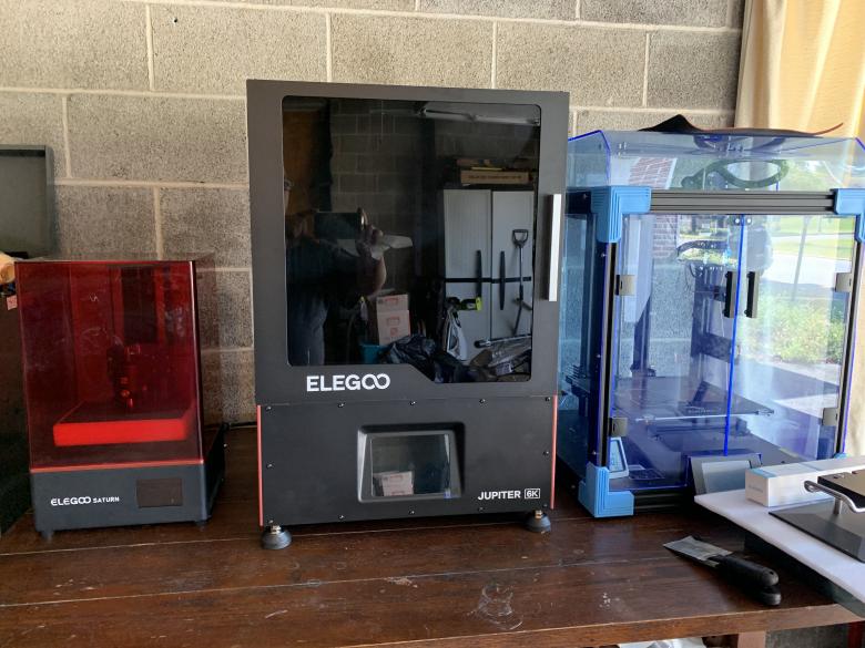

            Well this is my printing setup. One Elegoo Saturn resin print, one Elegoo Jupiter resin printer and one large Ender 6 FDM printer. My Jupiter resin printer is larger then my FDM printer lol.
            Click image for larger version  Name:	IMG_3128.JPG Views:	0 Size:	73.8 KB ID:	163269

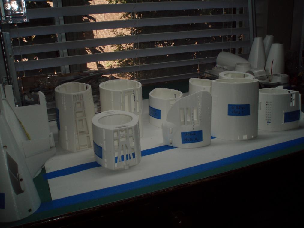

                        I have to date 3D printed14 boats in the 1:96/1:72 scale. Everyone one these boats have been built using PLA! All these boats have been set up to use WTC and have been in my pool an operational many times! Arizona has temp. in the summer 100 to 115 deg. Using PLA you cannot leave them in the heat for any extended amount of time. To date I have not had any problems with my PLA boats. I do seal up the hull interiors with resin to help cut down on moisture penetration. I print all my boats at 100% infill which provides even less moisture penetration.
                        You have been following most of my builds, so you know that I use PLA only!
                        So for what you are doing (Model Building) you do not need to use anything other than PLA! You do not need a high-end expensive 3D printer! You do not need heated beds, or heated enclosures, and another good thing about PLA you do not have to deal with the fumes. Thats it from my corner of the world. PLA works great for me, and has done for many years!

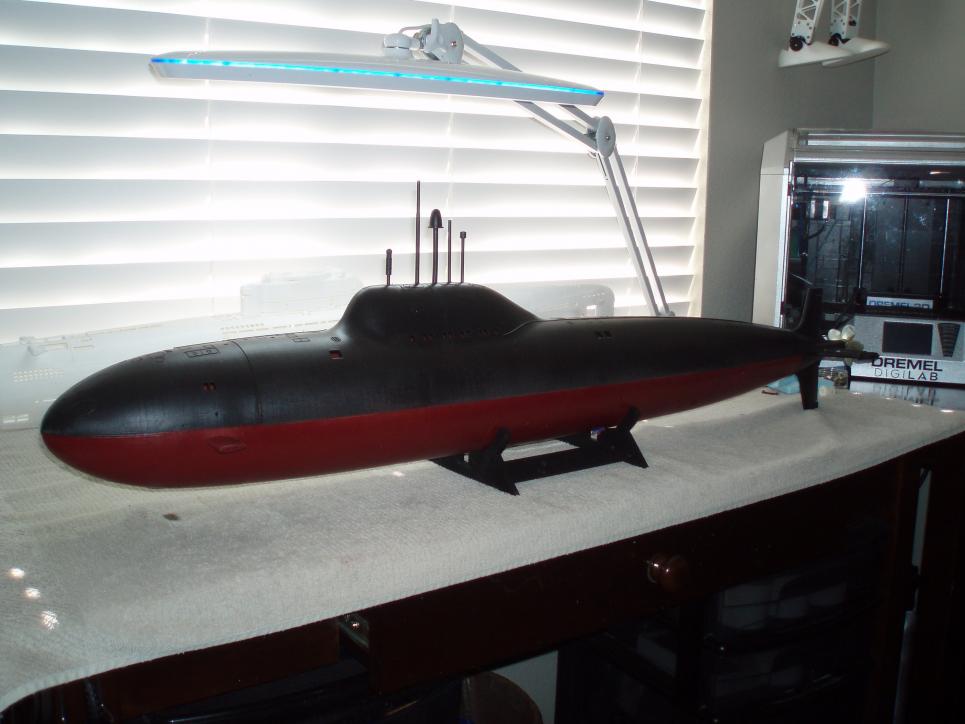

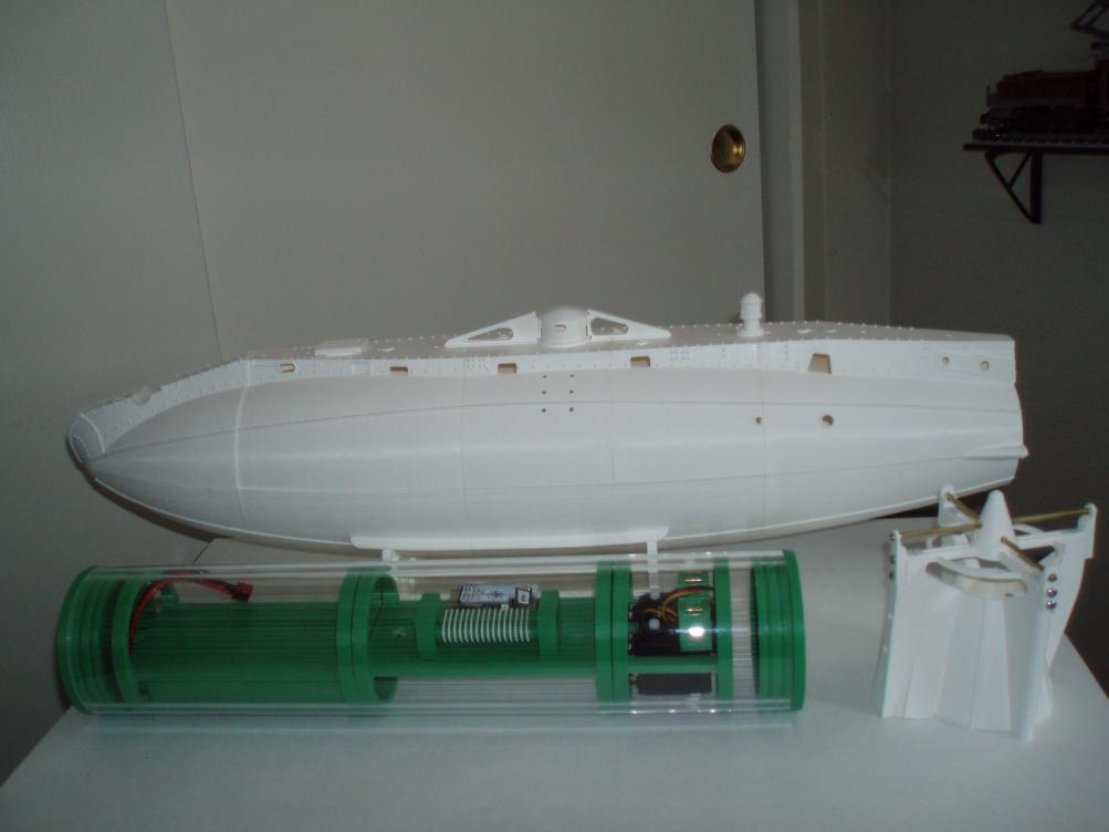

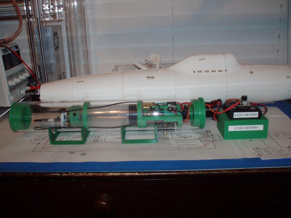

                              Click image for larger version  Name:	P1010037.jpg Views:	0 Size:	62.0 KB ID:	164334Click image for larger version  Name:	HOLLAND ! PROGRESS 1.jpg Views:	0 Size:	42.9 KB ID:	164335
                              Click image for larger version  Name:	Alfa Boats.jpg Views:	0 Size:	56.8 KB ID:	164336Click image for larger version  Name:	Drive system 5.jpg Views:	0 Size:	61.8 KB ID:	164337
                              I have built 14 3D printed submarines! All with PLA with 100% infill!
                              Click image for larger version  Name:	ALFA INTERIOR 1.jpg Views:	0 Size:	56.7 KB ID:	164338Click image for larger version  Name:	ALFA INTERIOR 4.jpg Views:	0 Size:	62.9 KB ID:	164339
                              I use a good quality PLA for the build then a good quality primer on my interior and exterior, I then use a good quality exterior final finish! As I am sure you have already heard you DO NOT want to leave a PLA built sub in direct sunlight or heat for an extended length of time because it could warp, take heed on that for sure! I know there will be others challenge me on this and tell you not to use PLA. If PLA is your preference! You go for it! If you want more photos of my PLA boats in or out of the water, let me know!
