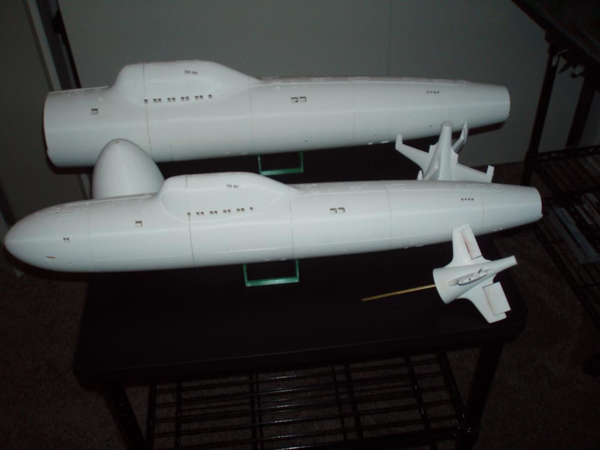

                              Click image for larger version  Name:	P1010037.jpg Views:	0 Size:	62.0 KB ID:	164334Click image for larger version  Name:	HOLLAND ! PROGRESS 1.jpg Views:	0 Size:	42.9 KB ID:	164335
                              Click image for larger version  Name:	Alfa Boats.jpg Views:	0 Size:	56.8 KB ID:	164336Click image for larger version  Name:	Drive system 5.jpg Views:	0 Size:	61.8 KB ID:	164337
                              I have built 14 3D printed submarines! All with PLA with 100% infill!
                              Click image for larger version  Name:	ALFA INTERIOR 1.jpg Views:	0 Size:	56.7 KB ID:	164338Click image for larger version  Name:	ALFA INTERIOR 4.jpg Views:	0 Size:	62.9 KB ID:	164339
                              I use a good quality PLA for the build then a good quality primer on my interior and exterior, I then use a good quality exterior final finish! As I am sure you have already heard you DO NOT want to leave a PLA built sub in direct sunlight or heat for an extended length of time because it could warp, take heed on that for sure! I know there will be others challenge me on this and tell you not to use PLA. If PLA is your preference! You go for it! If you want more photos of my PLA boats in or out of the water, let me know!
                              Welcome to the forum and this great hobby we have here!! :-))
