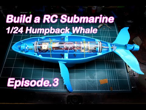

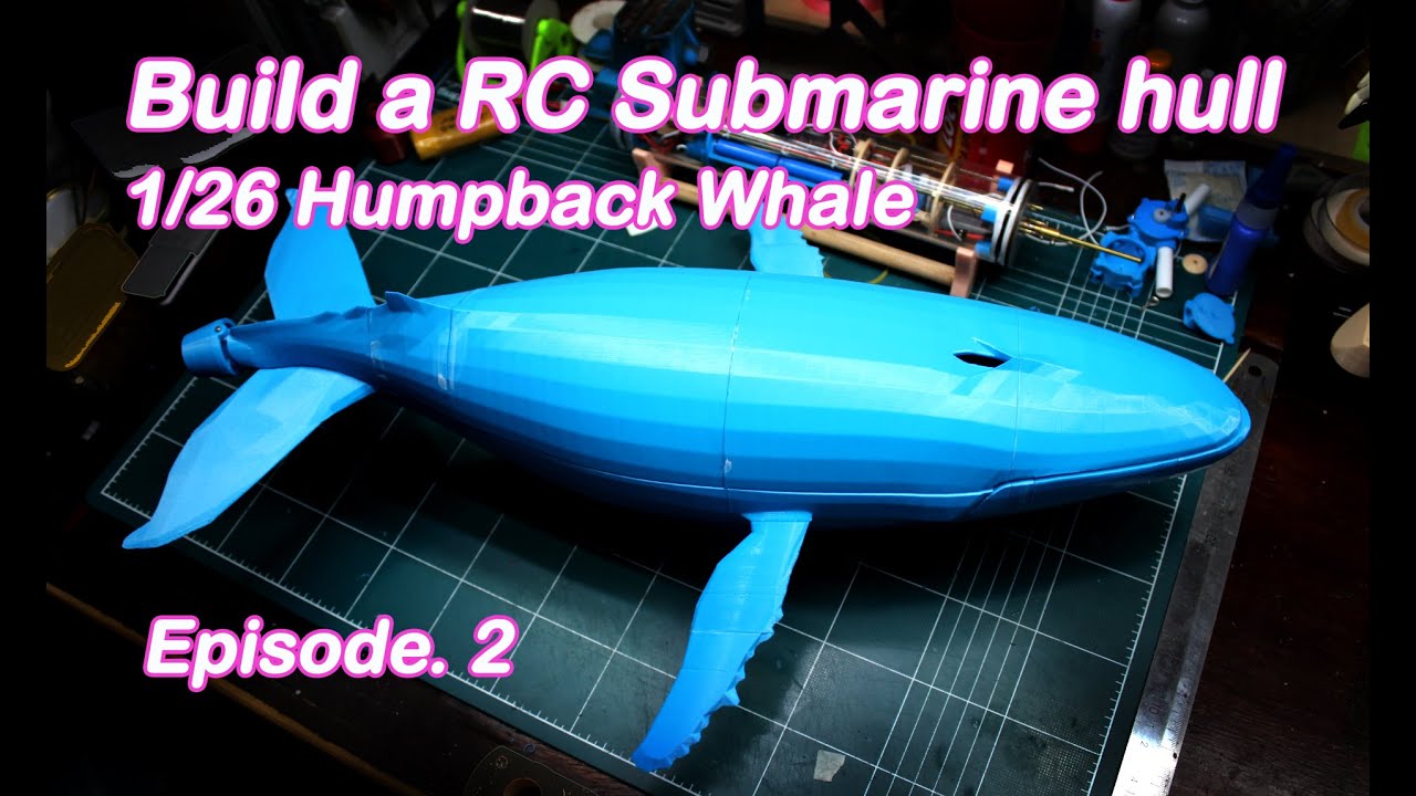

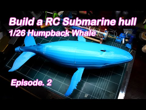

    It could very well happen! I like the concept, and with a ballast system!? Who knows! I found his files and some information on the WTC that he may have designed for the Whale! It measured out to about 22" in length, so it could be a great pool runner!
    Thanks for posting up the YouTube on his build!
    "Firemen can stand the heat"

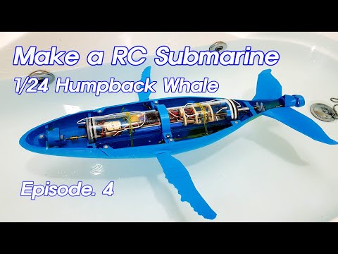

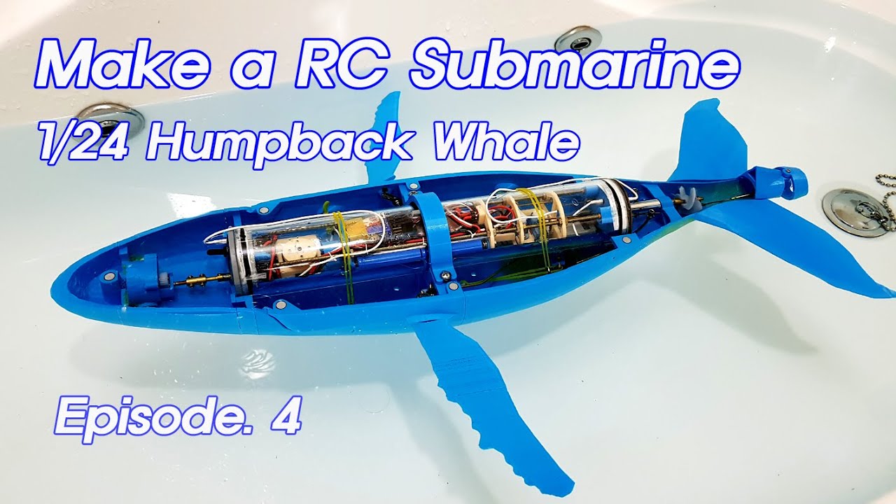

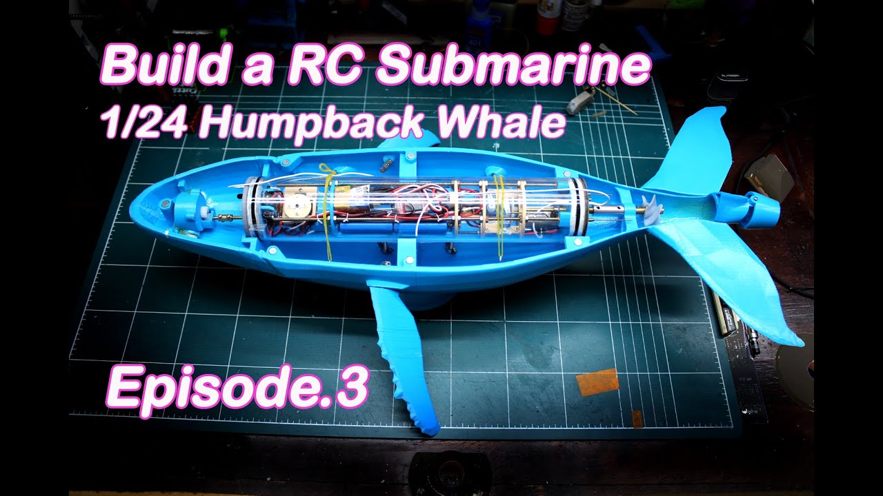

      I do find the pectoral fins smaller and set too far back.
          Interesting, I wonder why he has a bow thruster in there? That koort nozzle aft will let this thing spin on a dime already....
          I really like this, though!
          Bob
            Instead of a bow thruster I think the pump can be used to squirt water out the blowhole.
            Wonder where's the intake for the pumpjet.
              That would have been awesome, but I'm 90% sure that's a bow thruster. Looks like a standard paddlewheel style, and I can't see any outlet running to the upper hull.
              Ditto on the location of the intake for the propulsion.
              Bob
                Maybe swap out the paddlewheel for a centrifugal type pump like those used in windshield washers.
                  Bob
                  As Bob has stated, with the kort nozzle being aft as per design and it's possibility ability to really turn well, why would you need bow thrusters?

                              It doesn’t have a kort nozzle. The prop would be inside the shroud if it was a kort, it’s got vectored thrust and the prop is inside the hull. Doubtful you’ll get any reverse thrust with such an arrangement, so perhaps that’s why the designer has gone for a bow thruster to get out of a tight spot.
