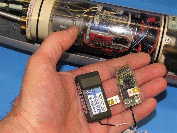

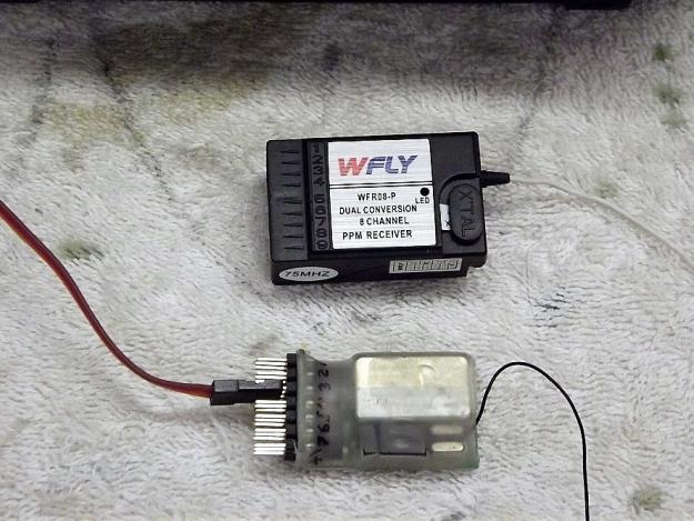

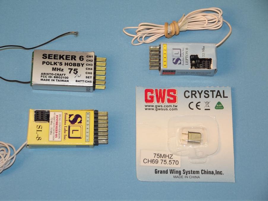

          Is there a brand name 75mhz FM receiver better / more reliable than others? From your Wast Experience HWSNBN ?
            • 14014
            #125
            Futaba, Sombra, WFly Polk's are preferred.

            I've had so-so success with these. A recent use of one of these was glitchy.

            Carona is another favorite, because of the synthetic crystal.

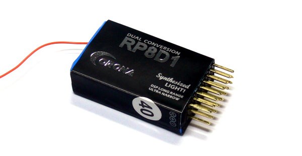

                  Corona receivers and Henge receivers are also great, with good interference immunity (dual conversion) . The most important thing is that they do not need crystals and can automatically search the frequency from the transmitter (for example, a 40mhz receiver can automatically match 40.67mhz or 40.35mhz or 40.78mhz etc.) The Henge receiver is very compatible and can match JR, WFLY, Futaba transmitters. Of course, both receivers can be set the “Failsafe” device.

                    The Corona synthesized receivers will work with Futaba 75Mhz FM Dual Conversion TX crystals?
                    • Sam Victory
                      • Sep 2021
                      • 391
                      #130
                      According to this pic, it seems OK.
