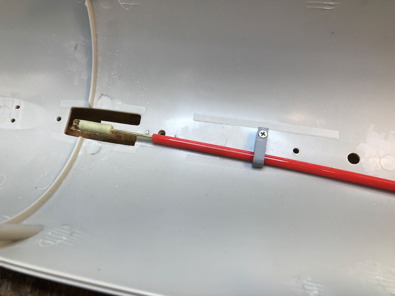

    I am having a heck of a time getting the subject pushrod to play nice between the magnets ends, both in the run and automatically hooking up. Could you masters of this beast please post some pictures and some verbage of successful set-ups to help us klutzes get on the same playing field?? At present I'm trying to do this with a Lazer rod and David's Klick-ons.

      Bill,
      These shots should guide you along. Works fine on the three 1/72nd SKIPJACK's I've assembled and operated.

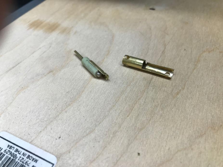

        I improved this connection a little. Tom did as well on his SJ, got this idea from Tom. I used the proper diameter brass tube. Drilled a hole the magnet size, trimmed to shape and CA glued onto the magnetic coupler. The magnet on the bellcrank has enough slip that it can be slid thru the brass hole on the coupler when assembling them, and the magnet holds them together.

              Thanks, guys! It appears that David's pushrod is fixed to the upper hull by a small, black "slider", which seems way much simpler than what I was trying to do with the slider up by the snorkel induction connection. I may even try Ken's nifty brass "keeper". By fixing the rod to the upper hull, that makes all the adjusting happen back aft where it can be gotten to without all of the attendant facial contortions and swearing!!!

                That 'slider' is nothing more than a short length of heat-shrink tubing, Bill. It's glued to the hull and then a single slit, along its entire length, is cut to permit insertion and removal of the pushrod without the need of threading that pushrod through the tube. Though flexible, the heat-shrink has a memory, so once the pushrod is within, the tube closes up tight at the slit and the pushrod will not come out unless you pull it out intentionally.
