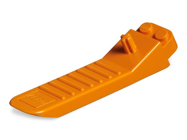

        Lego brick separator. Click image for larger version

        Should be easy to 3D print something similar.

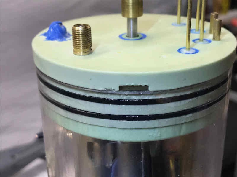

                When using a screwdriver, the square edges tend to dig into the resin and damage the acrylic tube ends. That's why mine looks the way it does.

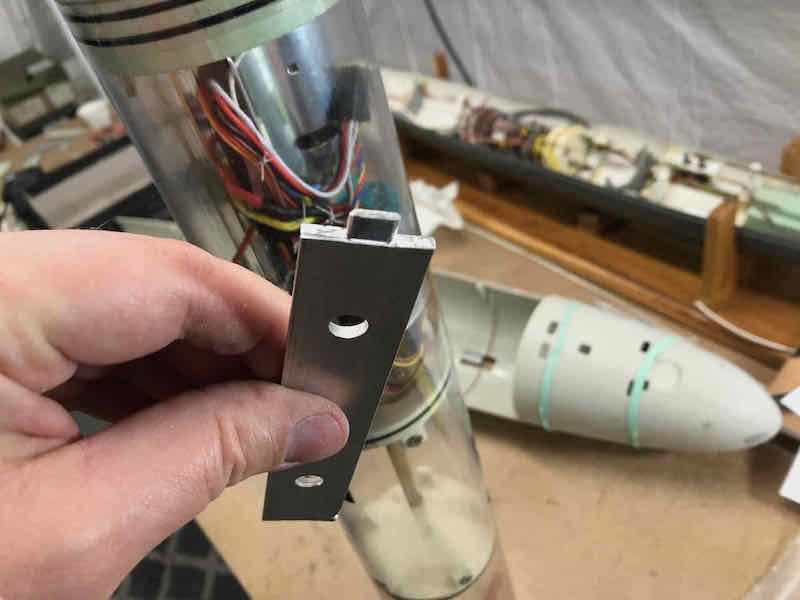

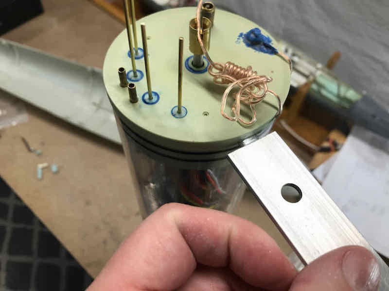

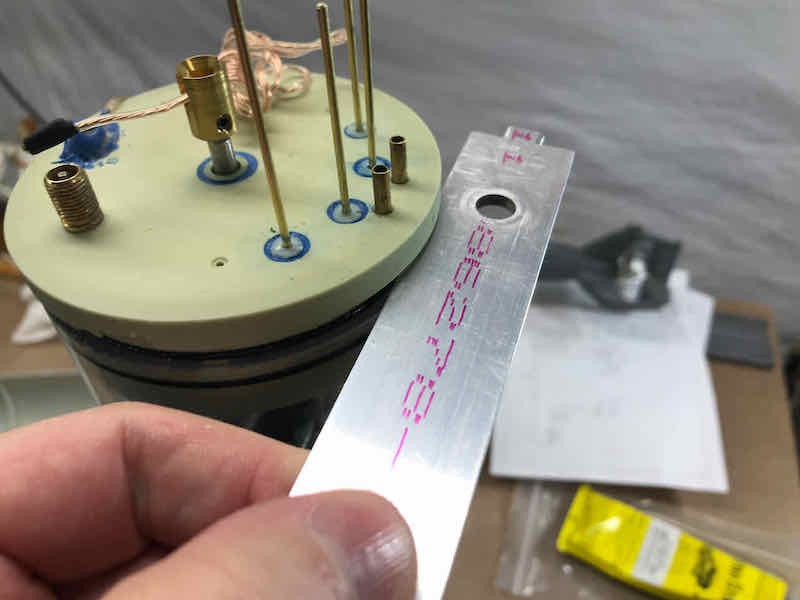

                I made my own tool. Before anything that matters is trashed, I always take things apart and save items I think may be useful. I had a bad doorbell, took the aluminum bar out of it, that's what I used here. I cut and ground the end down so it fit in the pry slot of the resin. The corners of the pry part were rounded with a file. Stick it in and twist and it pops the endcap out some. When it's far enough out use the other edge to shimmy the endcap out the rest of the way. Works well so far. Could ground the edges of a screwdriver down but don't have one to waste, besides didn't have one that was as wide as the slot.

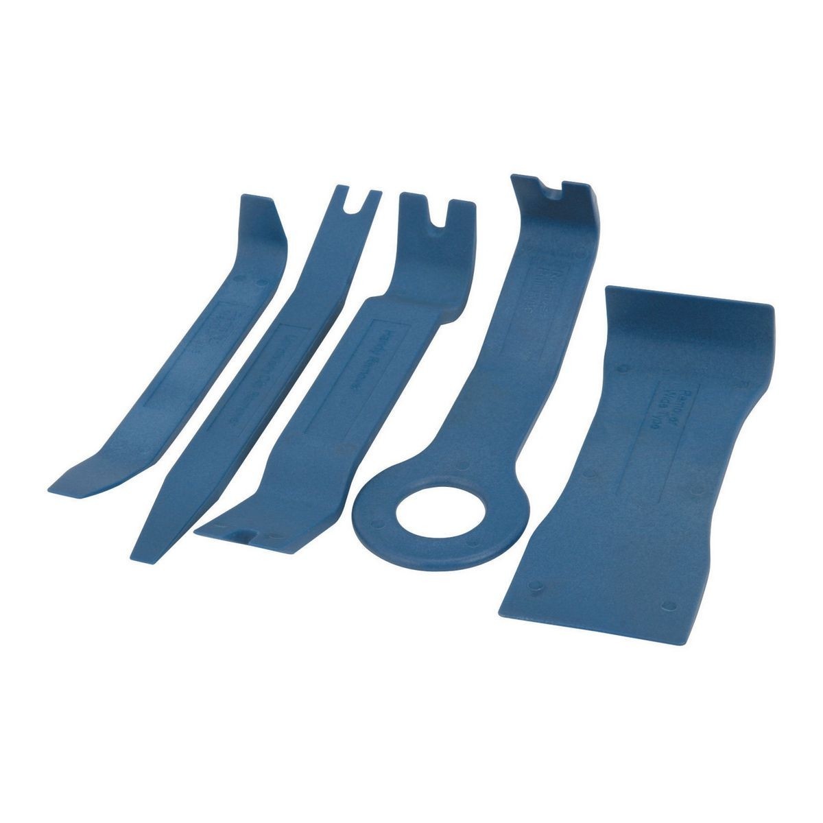

                  Harbour freight plastic dash board removal tools , pry bars wedges, grease
                  • Rick Teskey
                    • Jan 2009
                    • 265
                    Also comes in yellow

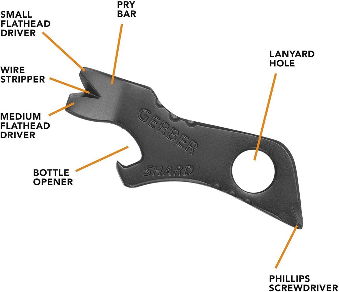

                        Shard. Even has a bottle opener for your beer Click image for larger version
