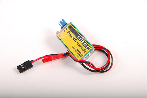

          After some mucking around trying a different Rx which yielded no change in the problem I extracted the 5A/5volt Bec (a Hobbyking purchase) and swapped in a 3A/5 or 6volt BEC HektronikClick image for larger version
ID:	91245, I have used these before in USS Long Beach and USS California (I have several spares for new projects as these ones can take an input voltage between 6 to 23Volts) So far on Bench testing the ESC sutter and servo crazies seem to have stopped! I will re tidy the wiring arrangement and try a test tank run to see how it does in H2o.....
          I am leaning toward the BEC brown out theory.....the 555 motor is off the hook!
          Cheers Bruce

                    I reckon it was a BEC problem.....probably the 5A BEC I was using isn't really capable of 5A! dodgy cheap POS..... seems to be running fine with the more expensive (By $2...) 3A BEC currently in there.

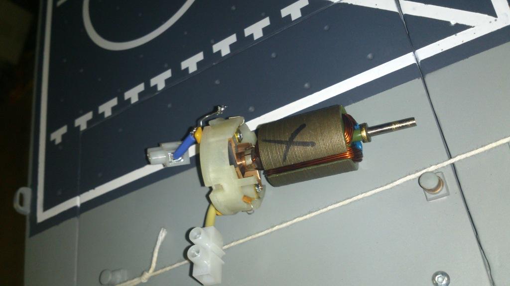

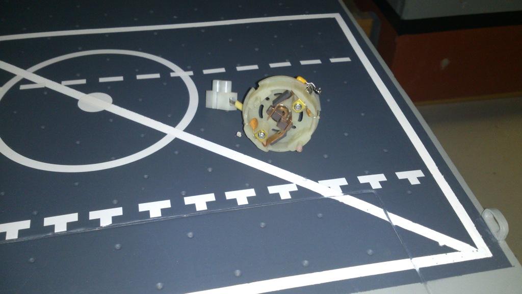

                          Here are some pix of the disassembled 555 just before I put it back together...
                          end plate of 555 sitting on the helo deck of USS Long Beach(freshly re done with Hawkgraphics USN flight deck markings)
                          Note the unmarked brushes and factory Caps....probably a good idea to run these 555s in before final install in the SD

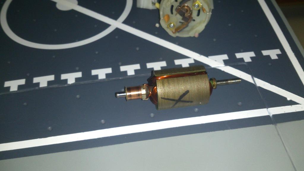

                          nice clean commutator..

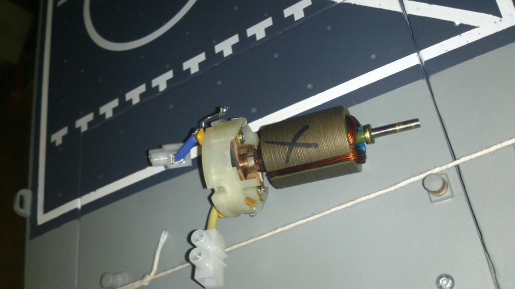

                          re assembled just before I put it back into the motor can. Which is a fiddly job because the magnets try to snatch the coil part of the motor there by disengaging the brushes! I used a bit of 1/8th styrene rod thru the front bush of the motor (against the motor shaft) to stop the armature jumping fwd, the carefully pushed the end back on folded the tabs over and then tested it on a 12v battery....screams nicely!!
