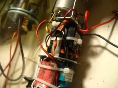

    microviper 10 esc stutter forward only
    ok sorry to have started a new thread.. i think h2ohaze has the same problem as i am haveing.. i think the root cause of the stuttering in all my servos with the adf2&lipogard&lpb in are due to the esc.. i have removed the power leads and rx connecters for the adf2-liopgard-lpb...
    1 only stern/bow plane servos and rudder direct to rx along with esc
    2 to elimanate the possabilty of rfi r/x antenna lead removed from s/d lug and set aside..
    3 esc learned set up prior to vid start to elimanate that...
    during the run i noticed that the esc led's would flicker during servo operation...so i think we are down to eather a bum rx(however since i beleave h20haze is running the sl8 r/x and i have the lepton6 that would in theory rule that out) or a bum esc....
    NEED some help here..i'm stuck nowSwearing Smiley
    esc stutter 001.MOV

    for a review this is the effect it is haveing on the whole set up..and with the lpb plugged in the r/x it comes on/off with the moter stutter...thanks for everones input&help so far....so what do you think dave.. need to send me the esc now or is there further diag i need to do??????

                i elimanated the adf2 by unhooking it at rx and power leads...vent/blow servo to r/x only..as well as other 3 servos only.. no adf2/lipogard...
                when i moved the 4 servo's the red/green led's on esc would light up while in motion with the esc neutral/ stopped tx in middle/neutral with esc zeroed before vid start....
                also if i go over 1/8th stick travel in forward..i start to get the stutter and flashing led's on esc

                    Just to make sure I understand: you also ran the motors when you did this? And couldn't get the blow servo to chatter? Or did it still chatter? I apologize for not understanding.
                    "with only servo's r/x and esc hooked up no servo chatter while the moters were running,but moter stutter still present in forward only.during stutter red/green led's on esc flicker together...."
                    Okay, I got that part of it now. So you HAD neutral dead on...and the lights still went off and on like Christmas when you moved the servos. I don't have that problem. If I had to wild guess it what? Maybe Rx, esc, RFI/EMI?
                    "myguess is internal to esc when moters start/stop voltage spike backfeeding through signal line to r/x affecting other componants.. rfi elimanated by removeing r/x antenna of s/d antenna lug and routed away from moters.."
