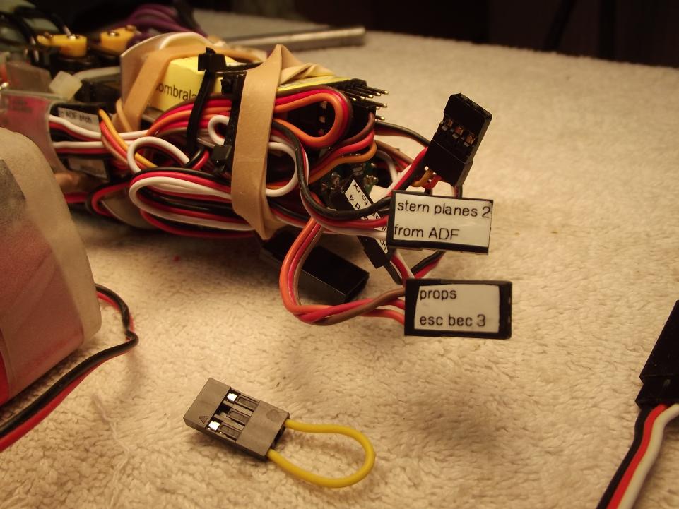

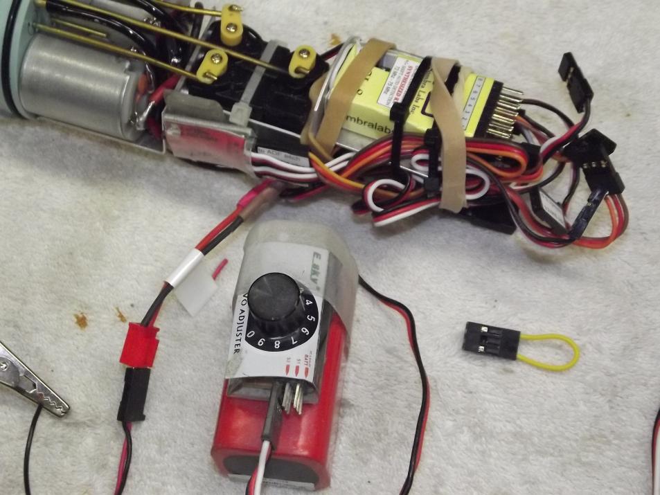

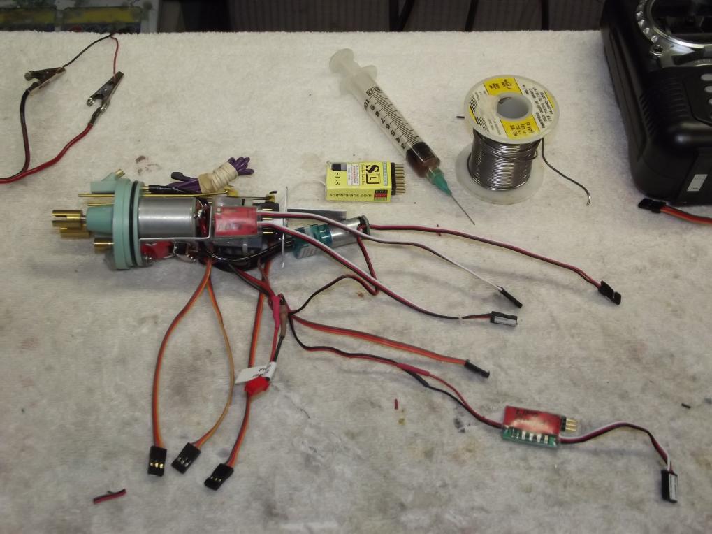

                      Nice job with the packaging, Jim. No damage. And a big pat on the back for the clean, well thought out assembly of the devices and packaging of the leads. Good stuff. Love how you've tagged each lead plug with port and function. Very anal-retentive, and makes my trouble-shooting job a lot easier -- we all can take a page from Jim's book here, gang!

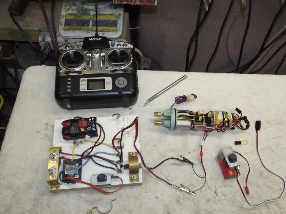

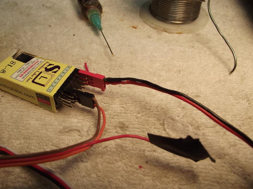

                      First thing I did was to yank all the plugs from the receiver but for ch-1 so I could program the SL-8 receiver to read my transmitter, which is on 69. Receiver works fine. Pushed all the plugs back into the receiver and powered up. Throttle had big hick-up issues. Pulled all plugs and started in on the trouble-shooting routine: one device to the receiver at a time and check each device for proper function.
                      It was getting late so I got as far as checking the ESC. And Bang! from the start I got the stuttering at high-throttle. First thing tomorrow I replace the ESC and see it that's the issue here.
                      You'll note use of my power-supply rig during the initial evaluation run.

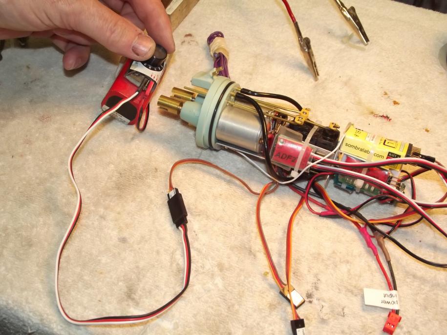

                        Thank you. I was surprised when I ran the Rx channel 3 (esc/BEC) through my servo tester and the motors still stuttered forwards. This of course, takes the Rx out of the equation, the motor stutter is not due to Rx interference. And it does seem as if the starboard motor is weaker. Gremlins...

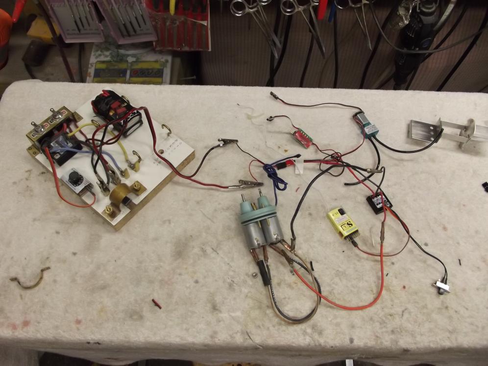

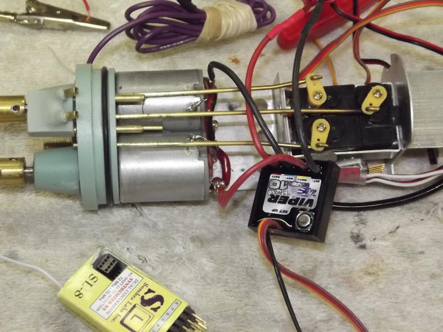

                          Following a conservative testing methodology I too took the receiver out of the loop and found, as you did that the ballast system servo stuttered. I then replaced the ESC with no change. I've added a third capacitor to each propulsion motor, no change. I broke out my type-7 SD and it works fine.
                          Oh! Deary me! Bother!
                          I'll address this problem again Monday -- got production work to get out of the way this weekend.
