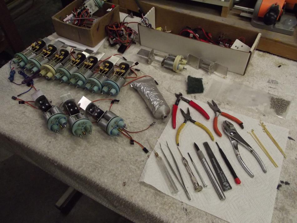

                          #57
                          I've got a box full of just assembled and tested 2" SD motor-bulkheads. I'm going to hook one of these up to your device tray see what we get. If no stuttering, then that's the bulkhead you'll get and I start digging into the motor(s) to find crap shorting between case and armature. Things will be resolved today and I'll have a report off to you tonight or tomorrow, followed by shipment of the repaired unit. And thank you for putting up with this long delayed work.Click image for larger version
ID:	76027That's your unit in the cardboard box at the upper, left.

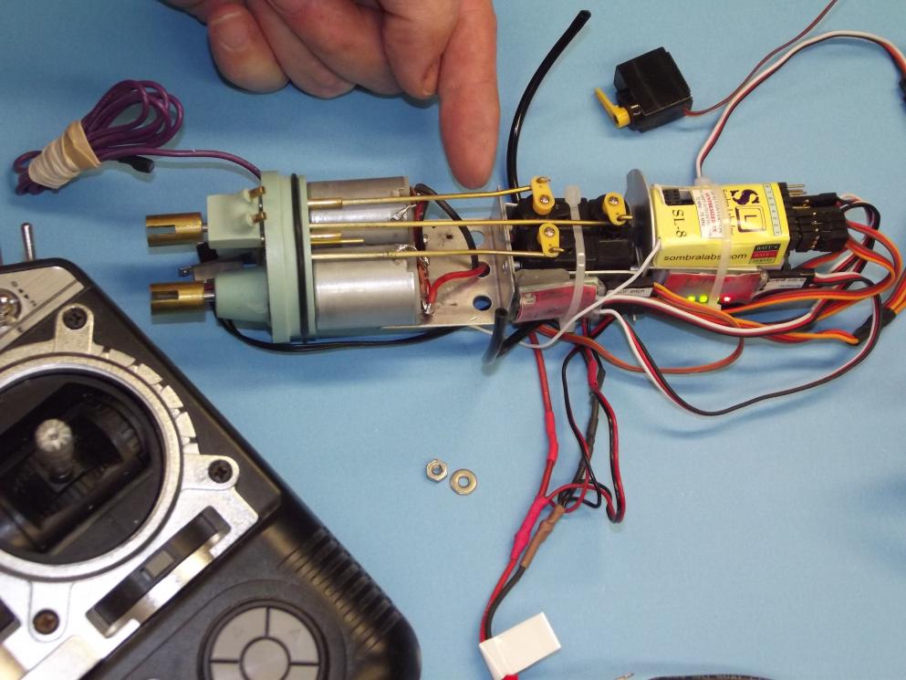

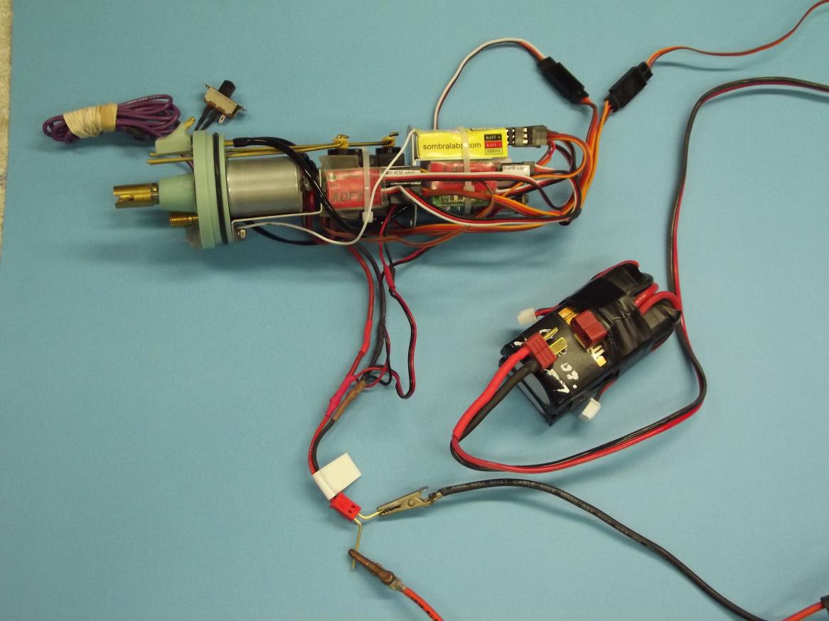

                                #60
                                Bad news: It does not appear to be one or both motors. I separated them, no change. I replaced the motors by installing a new motor bulkhead, no change. I'm going to stick with the new motors and easter-egg all devices till I find this damned cause of the chattering! I feel like Cal Meachem trying to assemble an Interoceter without the instruction booklet! Click image for larger version
ID:	76050Click image for larger version
ID:	76051Click image for larger version
