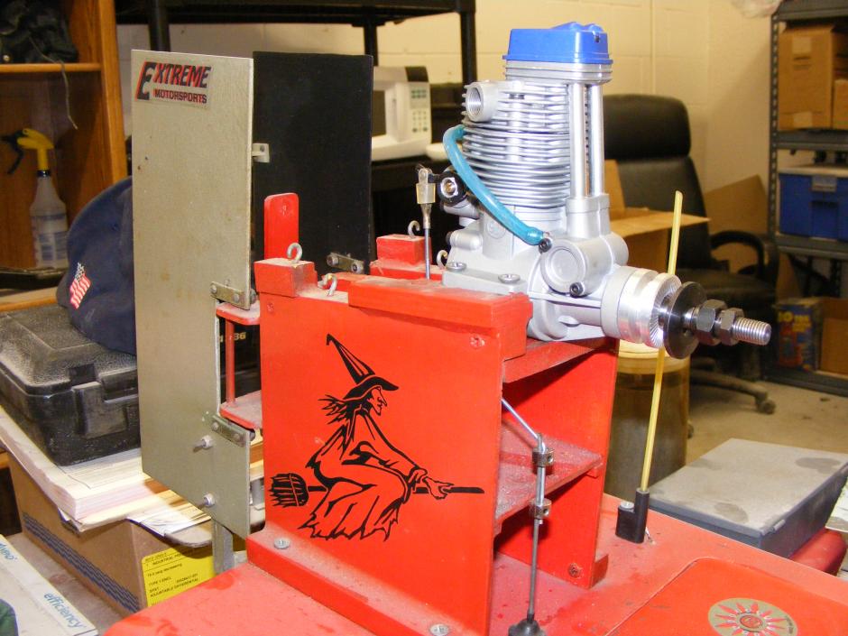

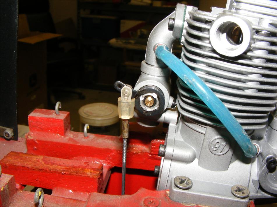

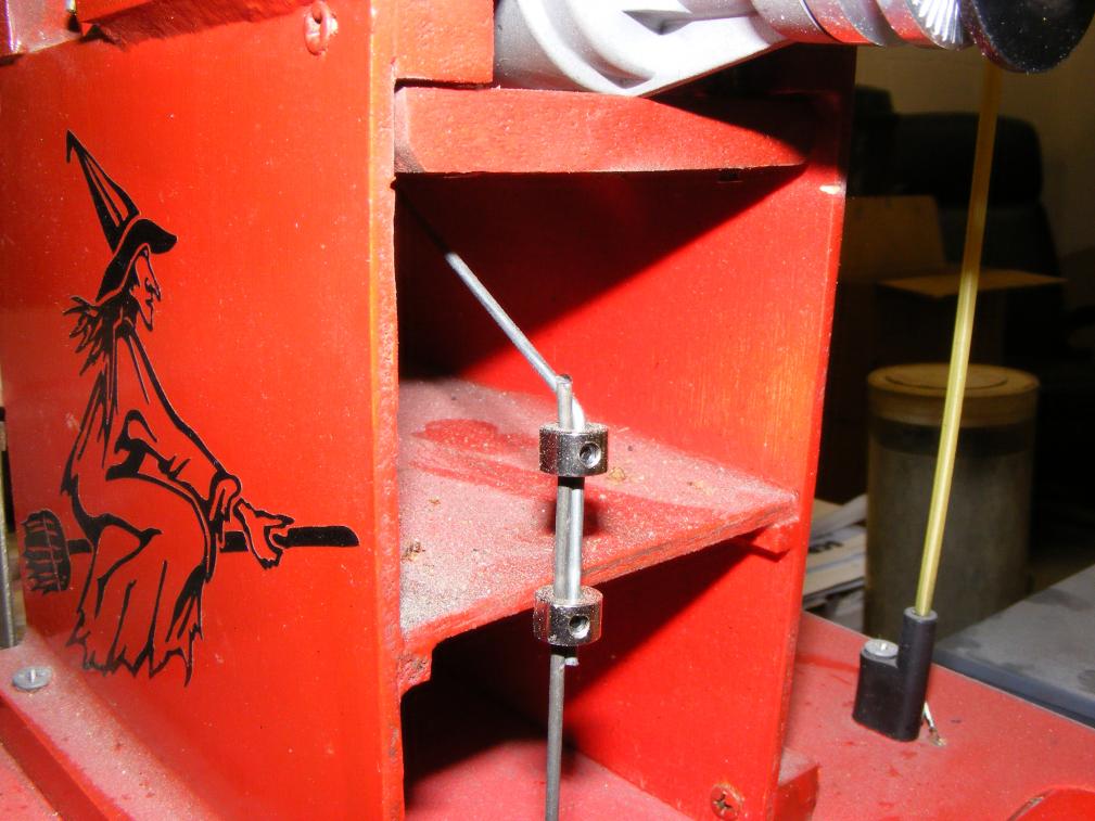

        Here we go with a little progress. Here we see the new motor mounted and the different throttle linkage setup. Next we will mount the 4 blade prop and spinner and the fuel tank. Then itll be time for engine break in. And then...........................WATER!

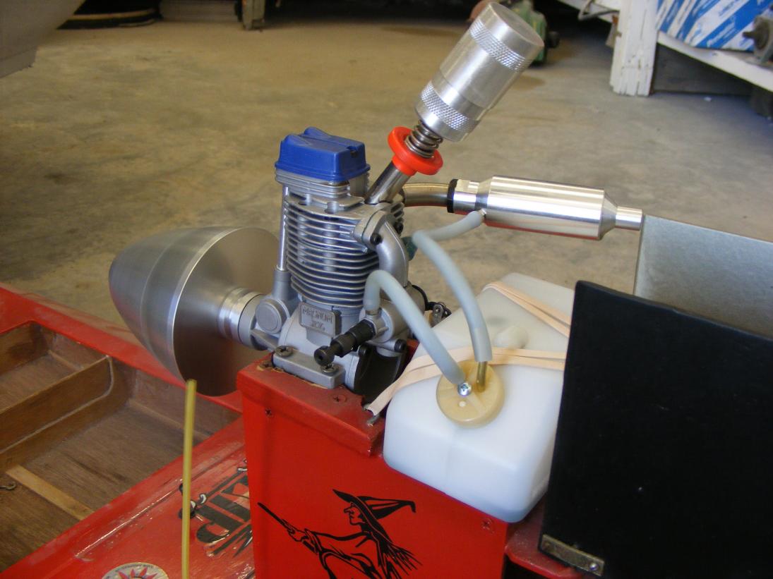

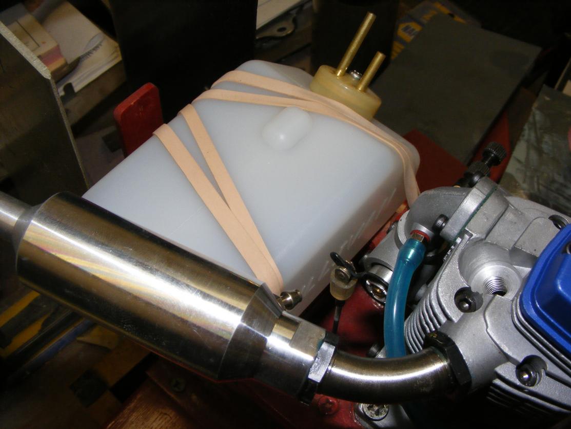

          Looking at the available space, there is not enough room behind the engine now for the same fuel tank configuration. This being caused by the rear mounted carburator. As you can see in the picture , Im going to shave off the wood blocks that the tank used to sit on and turn the tank sideways and let it sit down in the recess.

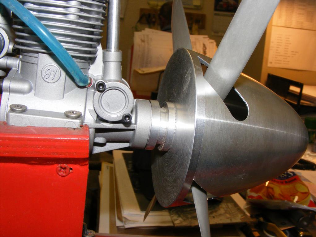

            After those mods. ,here we have what we ave mates! The big 4 blade alluminum spinner didnt come with a "adapter". Now that I know that , Ive got one of those on the way too. In the mean time , here she is mounted up with fuel tank straped down.

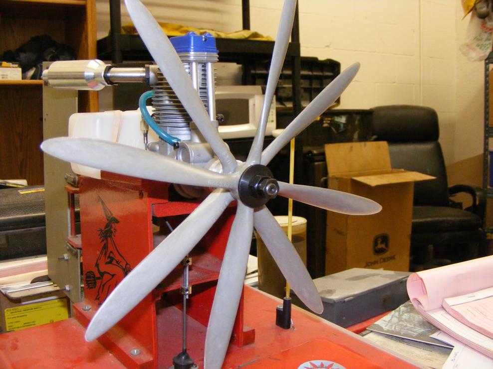

              #36
              Sorry Guys! I just cant resist. If the 4 blade prop is not big enough for this engine.................I will resort to this. Two props on one propshaft. I tried it before with great success. Just depends on if we have enough power. If it works we will have an eight blade prop. Ill do it by drilling and pinning the props together. That is, of course after its broken in and I see the possibility of success.

                #37
                Shes now ready for engine break in. At this point it appears that the prop shaft is too short to put two props on her, unless..............................

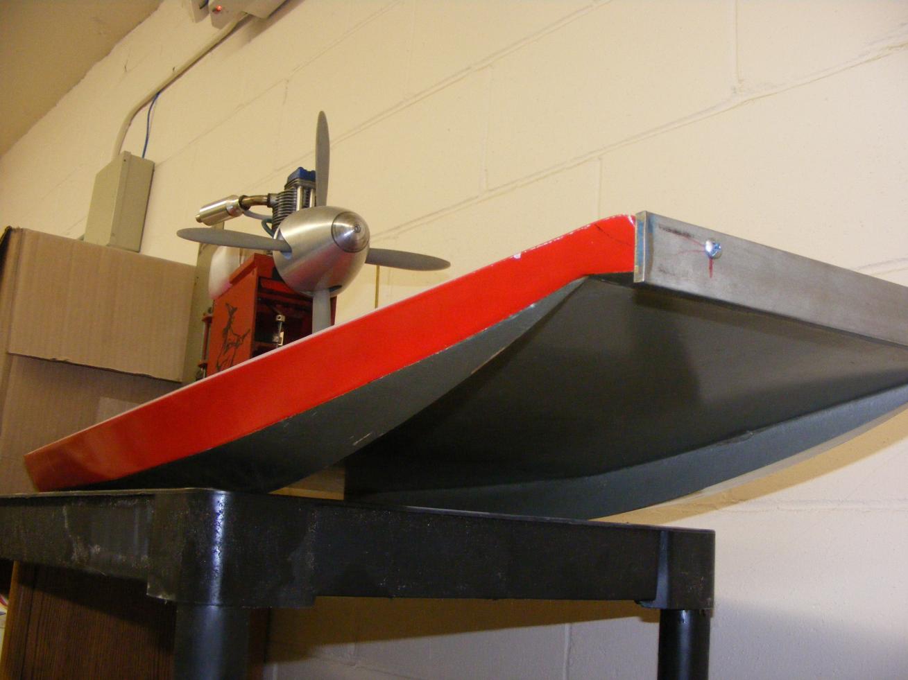

                    #39

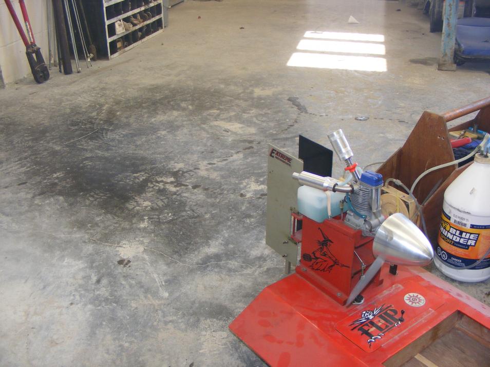

                    Today was the day. I took her down to the backup submarine pond and let her go. WONDERFUL! She has more power than before for sure. Put her down on the grass and it moves along real good. In the water, just idling she moves along pretty good. A full speed run and she almost blew over. Im going to make a removable weight for the front end to keep her from blowing over but removable for maximum dry land capability. Because of wear and tear on the bottom corners of the sponsons , I limit dry land usage to grass.
                    The 11x9 prop seems a little too much for her. Shell be happier with the 11x6 prop. I changed it tonight.
                      #40
                      Tested her again after the prop change in my back yard. She revs more authoritatively, for sure. Gotta get the weight on so we can do some high speed runs. At the same time Im gonna show you something cool.

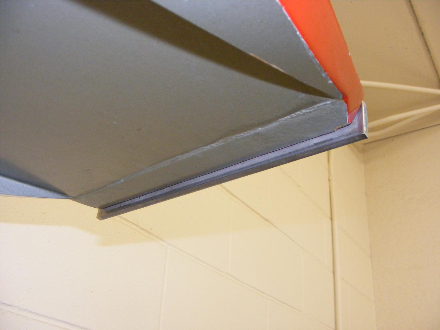

                        #41
                        Cut and installed the weight. A piece of Stainless Steel flat bar. 1/4" thick. It weighs 11 ozs. If its too much ill shorten it. It comes off with two wood screws. Ill remove it when running on land.

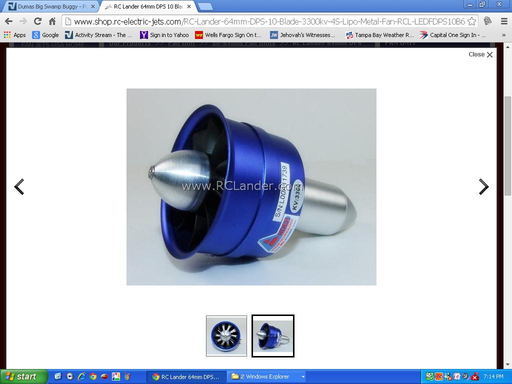

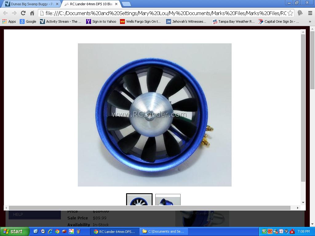

                              What if?......................What if, I took that bottom hole and filled it up? You know......the hole ...or space on the bottom of the engine tower structure. You can see it in this picture. Down , close to the deck, that space is 3" across and 2&1/2" in height. What if I filled it up with something useful.........................like another power unit that would work along with the 4 cycle engine to produce more thrust?Click image for larger version
                                #45
                                What if we jammed one of these in there...............just for the heck of it? Why do we need more thrust? Because, this boat does not have a flat bottom like most airboats. It is a tunnel or Catamaran as some boats are known. It therefore has a lot of drag when its on grass. All the weight of the boat is "point loaded" on to the ground on two points, whereas a flat bottom would distribute the weight over a large area, thus reducing ground pressure and drag. Conversely, when its on the water it has less drag than a flat bottom boat because the tunnel shape of the bottom of the hull will allow air under it and lift the boat up.Click image for larger version
