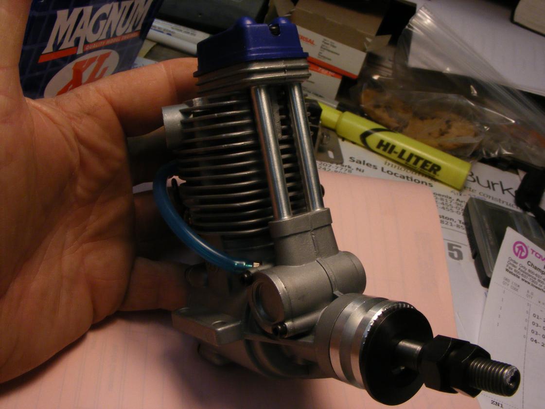

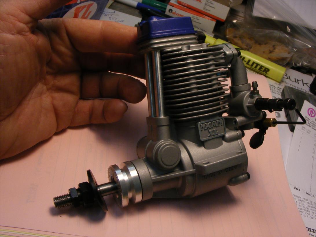

      OK, the new engine is here along with an alluminum spinner and a 4 blade prop. I dont believe that the 11-6 prop that I ordered will do the trick so I am ordering a 11-9 4 blade prop on Friday.
ID:	66678Click image for larger version
ID:	66679Click image for larger version
ID:	66680 Under that blue valve cover are the rocker arms and the two tubes on the front of the engine are the valve pushrod covers. A little FYI for those who didnt know.

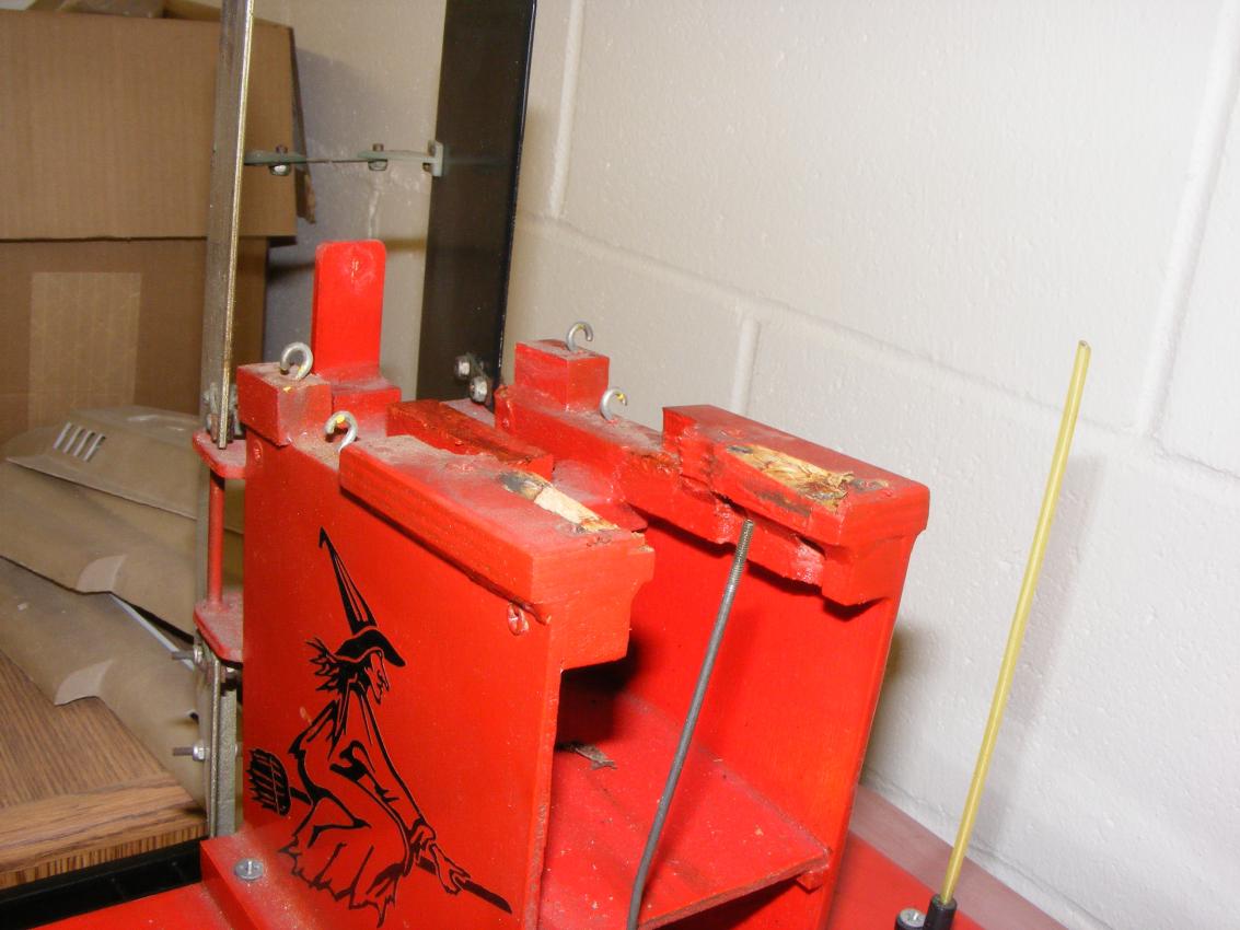

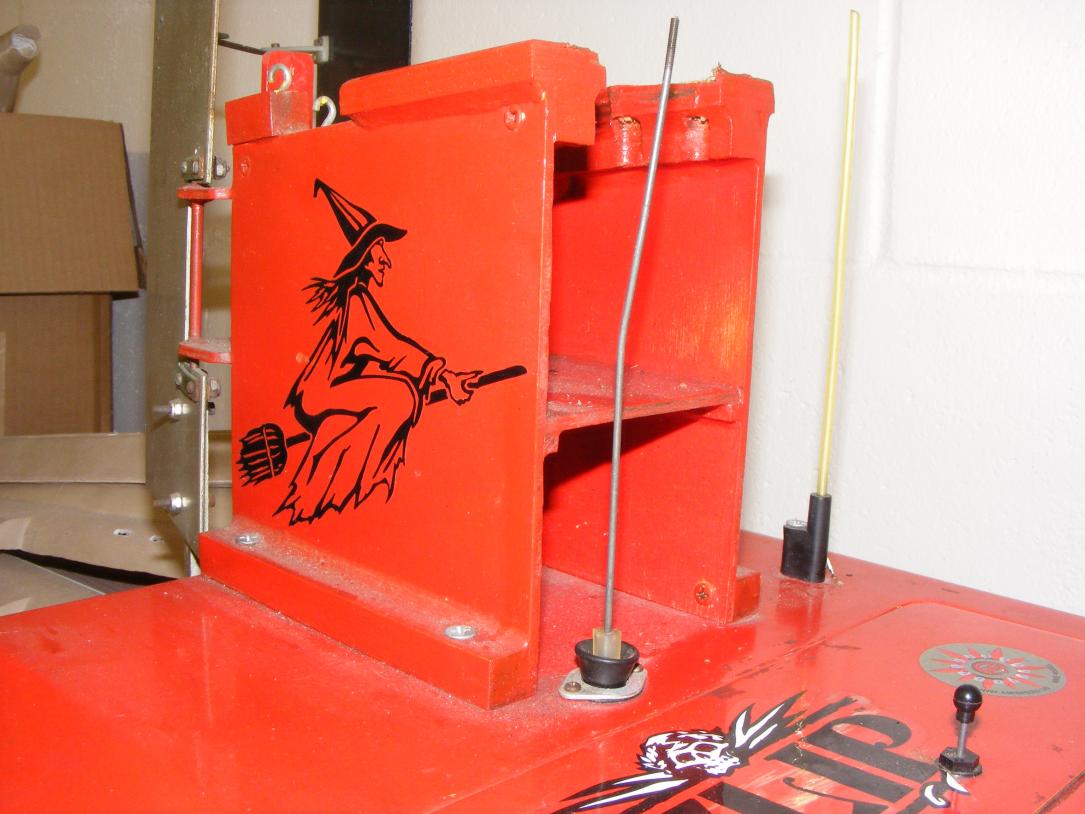

        Now for my next trick......we are going to install this 4 cycle motor on our Swamp Buggy. I have taken the liberty to remove the .74 2 cycle engine. The first problem is that the 2 cycle engine had a front mounted carburator, thus the vertical control arm that you see in the pictures. The new engine has a rear mounted carburator, so we will be modifying that control rod.
ID:	66681Click image for larger version
          Also the fuel tank that went behind the engine will now have to be slid further back because of the space that the carburator on the rear of the engine takes up. That vertical red painted wood strip was the retainer for the fuel tank. It will be removed and repositioned. You can see areas on top of the engine tower where there is no paint. Thats the engine mounting lug location. I trimmed those down so that a forward angle could be put on the engine so that it wouldnt have as much of a tendancy to FLY. In so doing we used up the extra space between the prop and the deck. That means we cant put a bigger prop diameter on this boat unless we modify again, which we can do if it becomes necessary. To get the thrust that im looking for we may have to go up to a 12" or 13" dia. prop. This engine is reported to be able to turn a 14"-6 prop as a matter of routine. I will start out with 10% nitro and after its broken in go to my usual car and boat fuel of 20% nitro and 20% caster oil. Oh, you can see parts of the UFO Skydiver in the background. Thats all for today FOLKS!

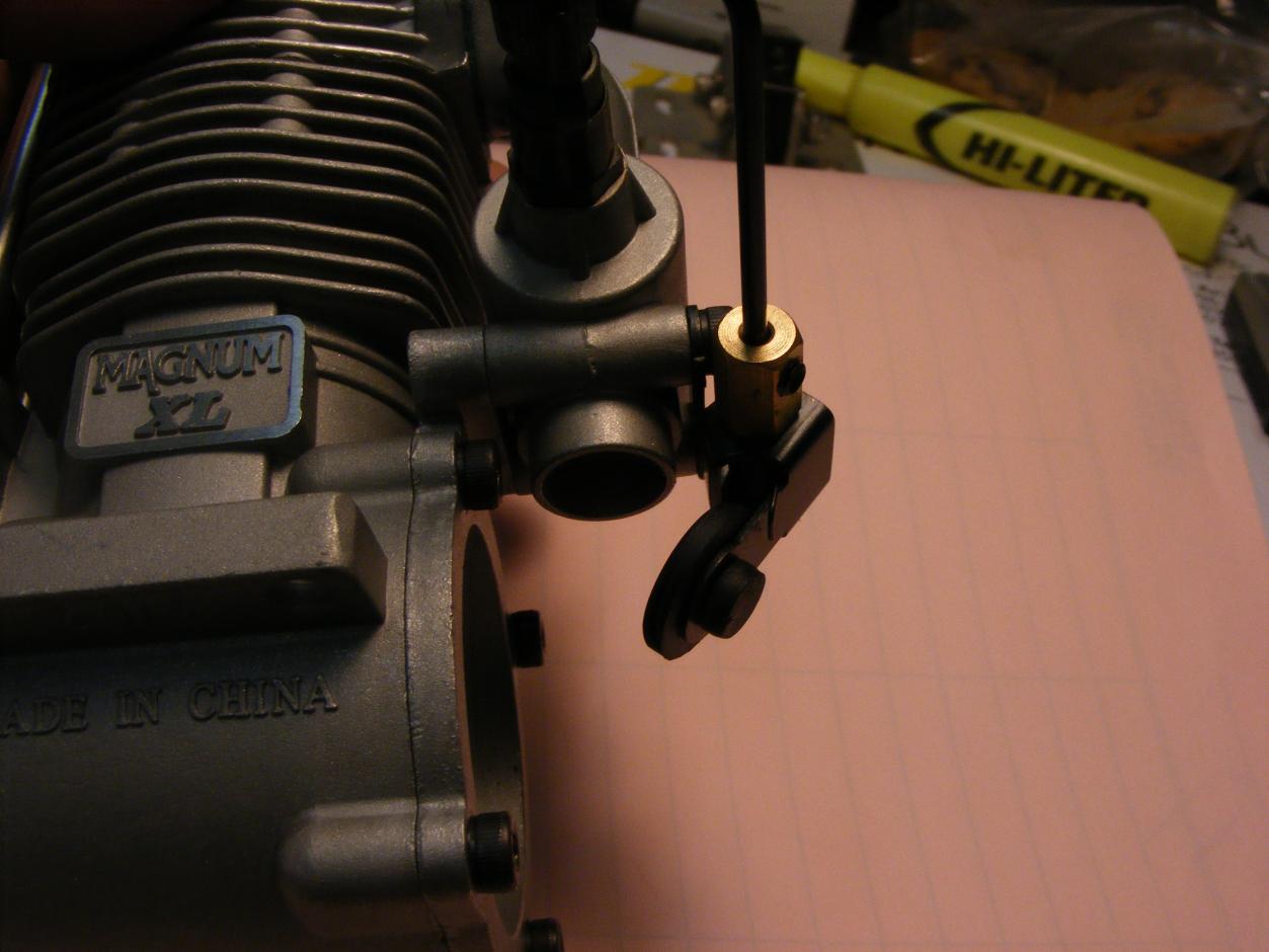

              The DADBLAMED carburators control arm reqs. a 1mm allen wrench to adjust it around to a usable position. Well guess what? All the sets that I own and all the sets at the job only go down to 1.5mm. Been searching the internet for a while and nobody has one! If I cant get one then Ill have to use a cable to work the carburator. Anybody know where I can get a 1mm allen wrench??!!
              • Reckless
                • Jan 2012
                • 183
                I know you said in an earlier thread that you bought a kit off Ebay... but I picked up a lil kit from canadian tire or walmart that had a crap load of little bits in it ... included were 1.5, 1.3, 1.0 .. .9 .7 etc...
                  Thanks Reckless. I was just guessing on the 1 mm. Im sure that the 1.3 or.9 will fit it. Ill get it in a couple of days and then we will see. If I can I will drill out and retape for a size bigger. The smaller the set screw the more fragile it is .
                    The funniest thing. I recieved the metric allen wrench set last night. My 1.5mm allen wrenches would not fit in the offending screw. The new sets 1.5mm does however. WEIRD! I guess "Its the same, only different" I guess it depends on the flavor. At any rate I can now move ahead on it.
