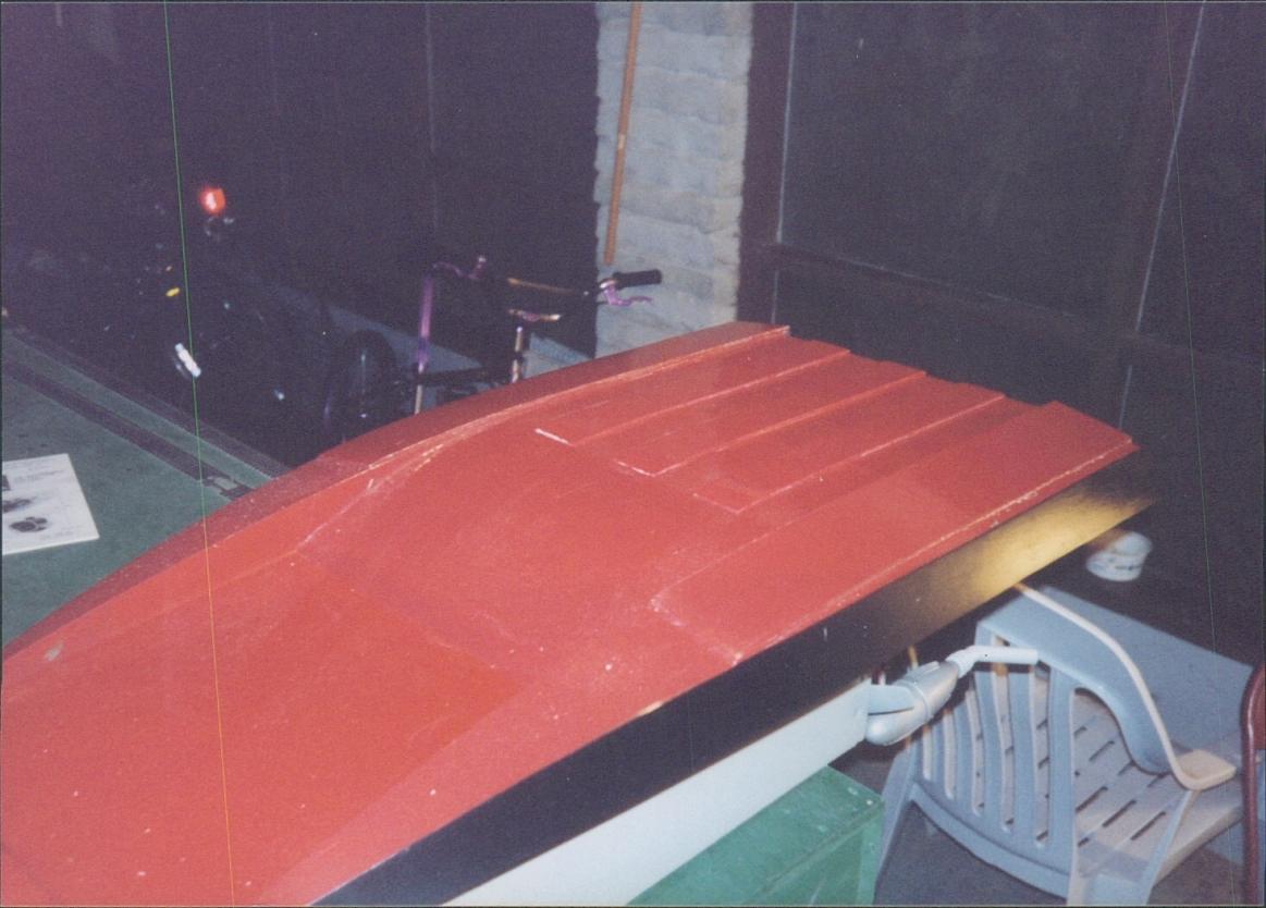

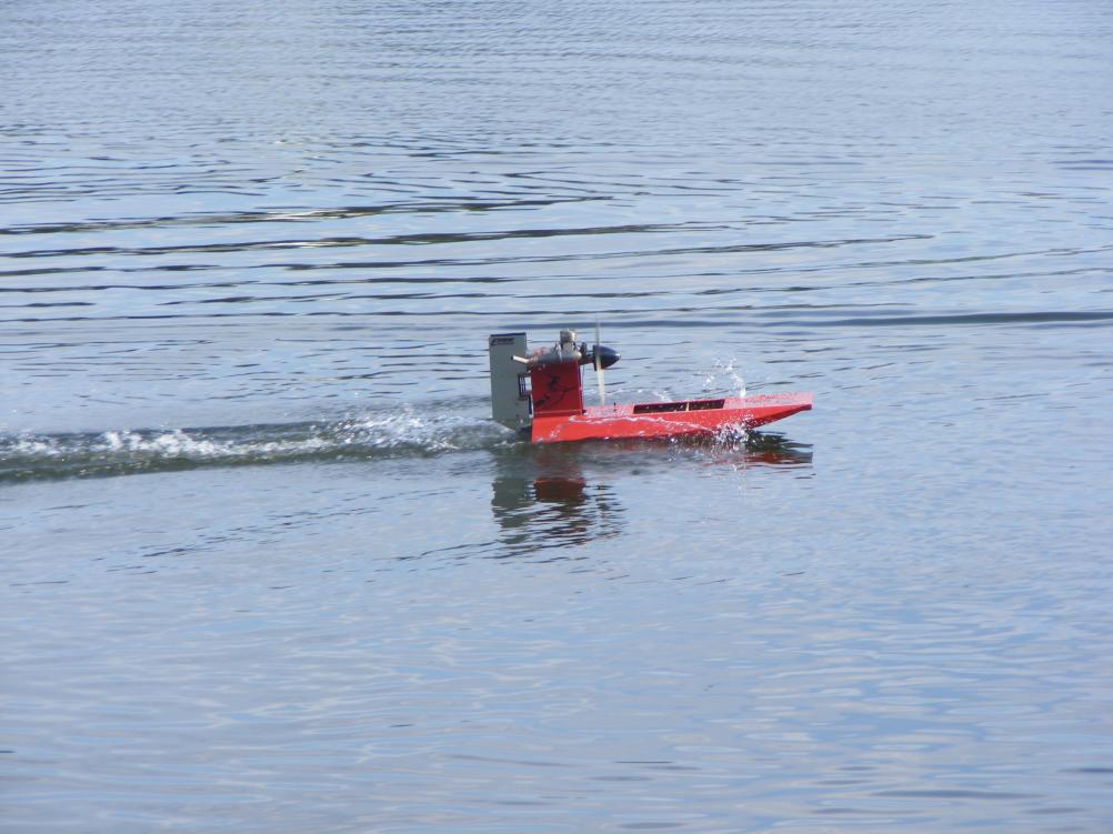

    Not really a buggy but a tunnel hull powered by up to a .60 size airplane engine. True to form, I , of course, have a Fox .74 on mine and wish that I went bigger. Oh well.(Heavy Sigh!) The hull comes unassembled and is made of die cut birch and mahogany plywood. So you will be doing a lot of CAing and epoxying. It really is a lot of fun. This is my second one. My first one I equiped it with a K&B .61 and the first time out it literally flew. After that I put some weight in it to keep it on the water. It would be a lot more tame if you installed a .40 size motor, but then you couldnt do any of the fun stuff! Fun stuff like driving it up on the bank and seeking out wet standing pools of water in grass fields after a heavy rain. I would drive like mad on the water and then head for shore and up on the bank I would go , blasting around thru the grass and then back down into the water it would go , water splashing up into the blades and splattering water all over everywhere and anybody around. A 12 oz. tank of fuel seems to last forever. I sought to improve performance by filling in the bottom tunnel and making it a flat bottom. Spinning out and around was really fun and driving thru wet grass a blast. Then I built my second one. The changes I made was upgunning the engine size and installing a removable water rudder to work together with the air rudders to give improved turning capability on the water. But with the water rudder on you cant drive up on the bank and weeds catch on the rudder. With it off you can really fly thru lily pads and weeds and anything else thats there. I used to chase alligaters with it. As I charged them they would hold their ground for a minute until it got too close to them and then with a splashing crash of the tail they would crash dive as I drove thru the spot that they used to occupy. Fortunately this game of chicken ended well for the Big Swamp Buggy and her foolish driver. What, who me??? Its all hollow inside so IClick image for larger version

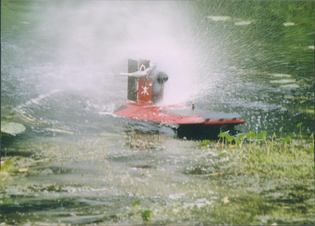

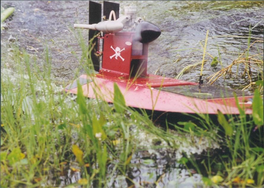

ID:	58599 In years gone by I have accumulated pictures of many boats in many different bodies of water Click image for larger version
ID:	58598. Here is the Big Swamp buggy in amongst the lily pads and weeds where most boats are afraid to tread!Click image for larger version
ID:	58597 Even on land! Is there anyplace safe???

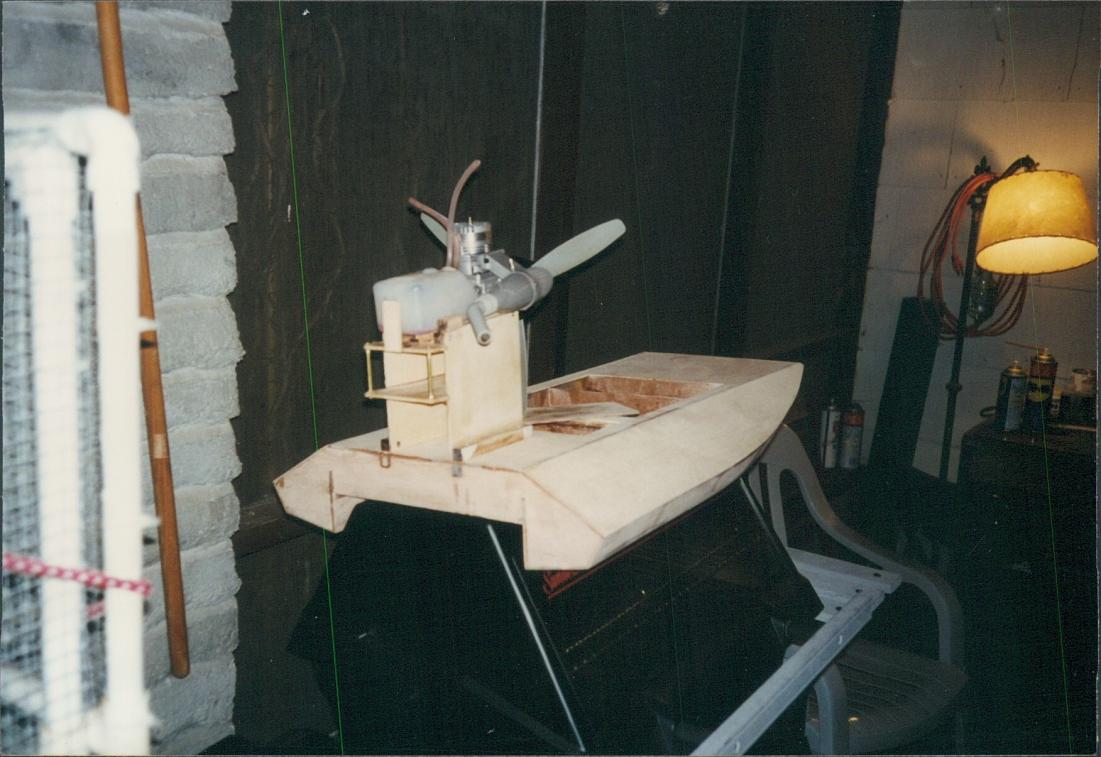

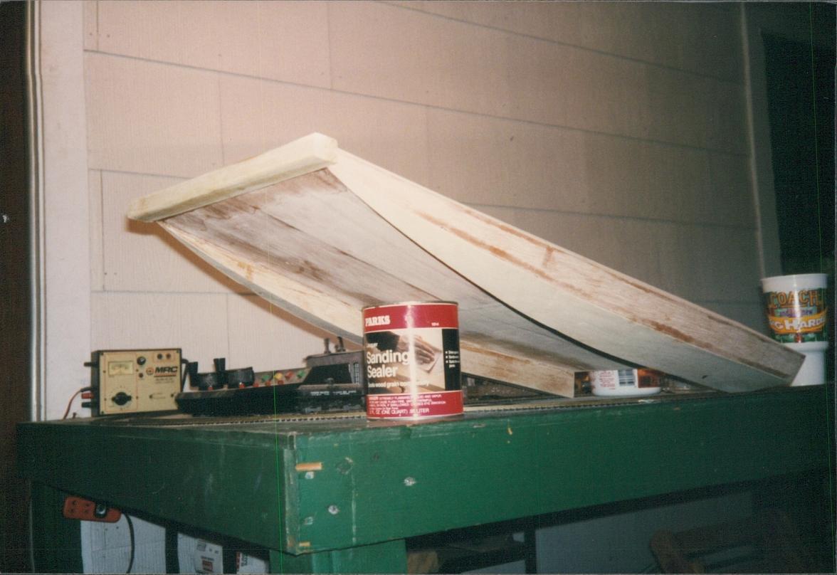

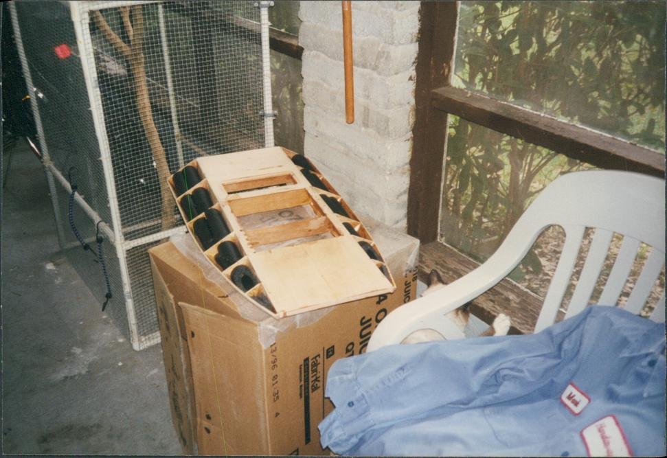

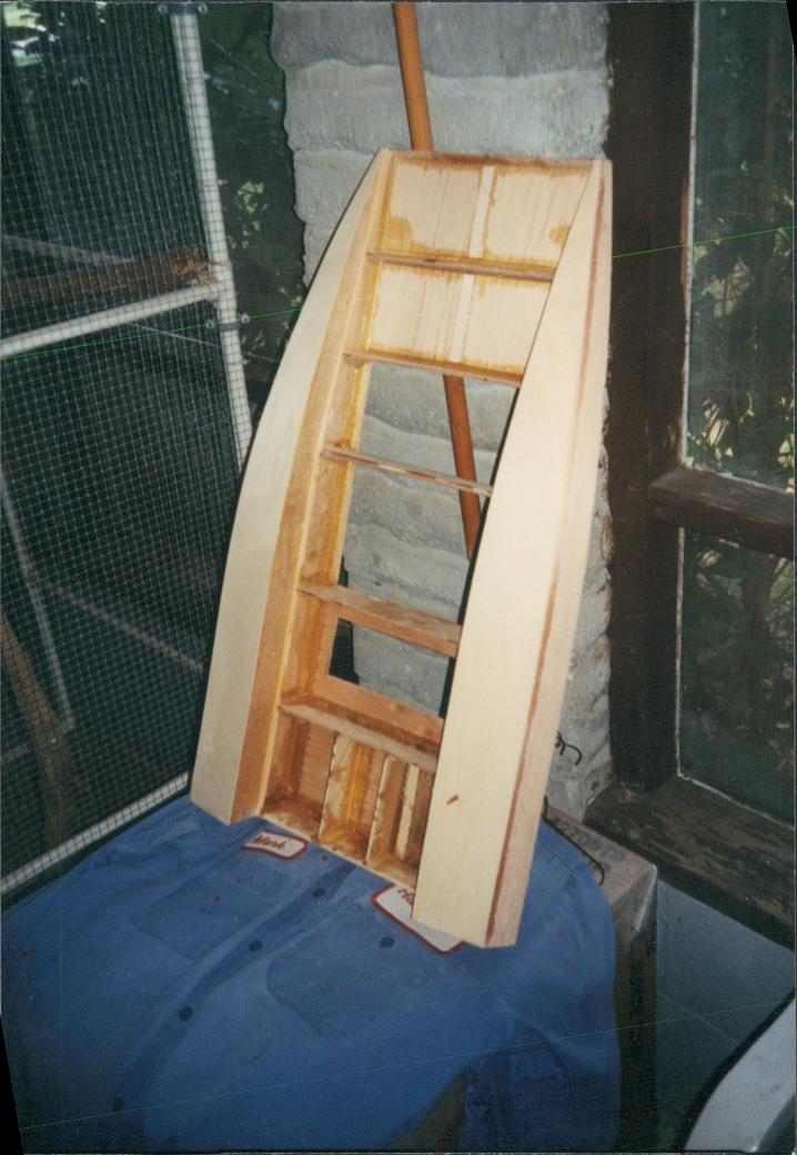

ID:	58604 Construction was a breeze. Here you can see where I have stuffed the sponsons full of A.C. insulating foam. Its now ready for paint.

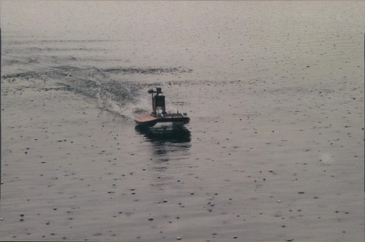

ID:	58608 Here she is comepletely out of the water, in the rain. With the K&B 61 sportster engine and two blade prop it moved out well.Click image for larger version

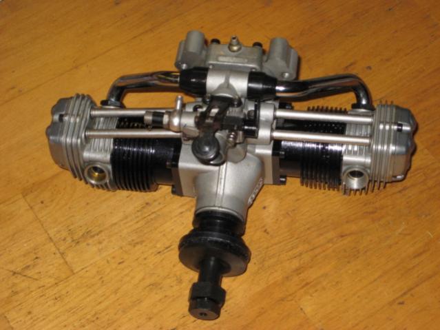

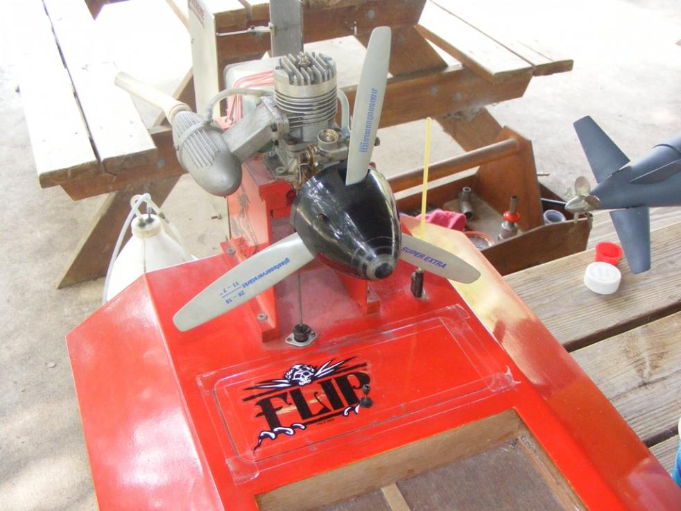

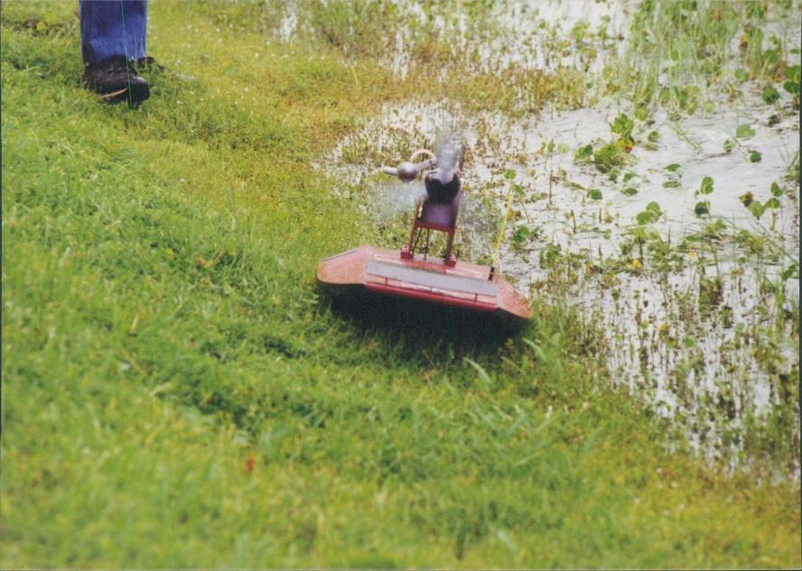

              Im not satisfied with the Fox .74 engine and the performance that it brings to the Swamp Buggy. NEED MORE THRUST. So im presently considering a YS-110 4 stroke engine. And to capture and utillize the extra horses Im possibly going to a 4 bladed prop to boot. Im still mulling over the prospects. In the meen time look at another possibility.Click image for larger version
                Why do I need more thrust do you say? Because this boat is a tunnel hull and the weight of the boat rests on the knife edges of the tunnel. Therefore when you are running it on land it doesnt want to move. If the grass is wet then its no problem. So if im at a lake or pond and want to bring it up out of the water you get stuck at the waters edge. MORE THRUST!
