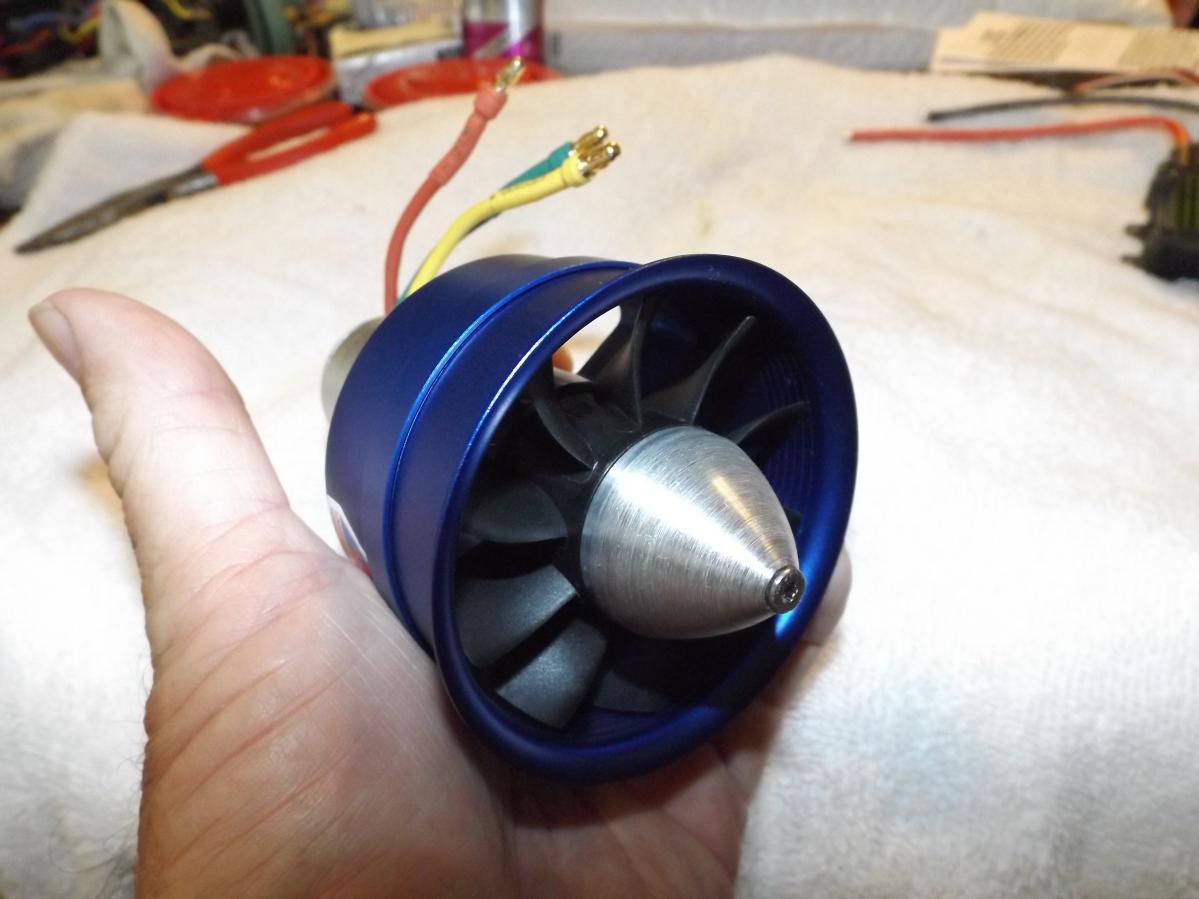

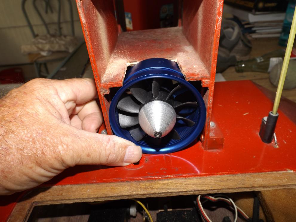

    Yep its a ducted fan unit, of the brushless variety. 64mm, 10 blade 3300kv and all metal. It runs on 4s power. The website I am going to get it from is:http://www.rc-electric-jets.com/

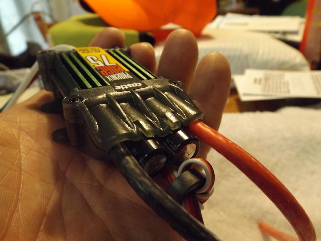

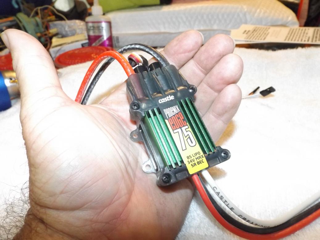

              Wow! That was fast.Click image for larger version
Name:	Fuji transfer 1366.jpg
ID:	91852Click image for larger version
Name:	Fuji transfer 1364.jpg
ID:	91853Click image for larger version
Name:	Fuji transfer 1360.jpg
ID:	91854Click image for larger version
Name:	Fuji transfer 1359.jpg
ID:	91855Click image for larger version
Name:	Fuji transfer 1368.jpg

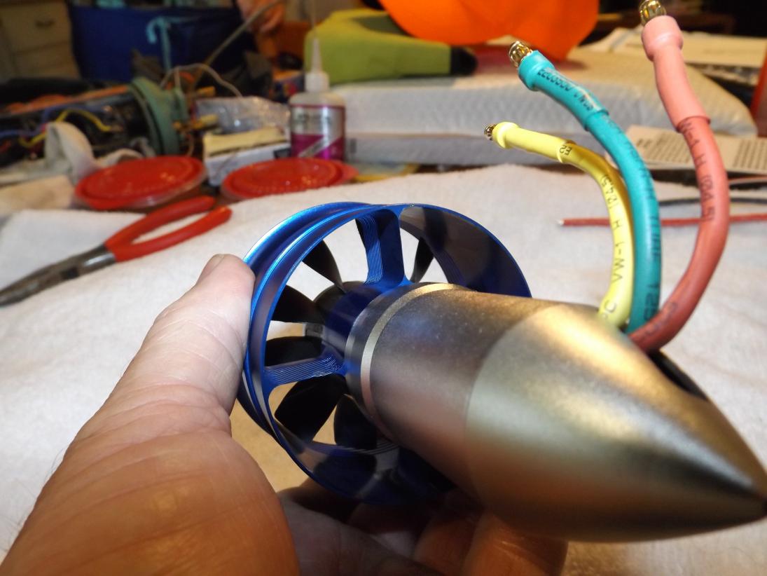

                #52

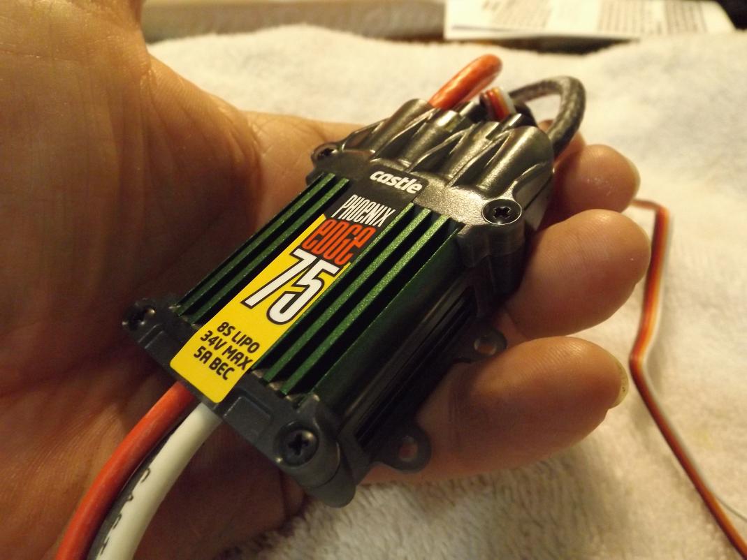

                Youll notice three output wires from the ESC to the brushless. Its just like(sort of) the three phase 480 volt power that Im used to working with on the Job. AC power has a hot and a neutral, hot being HOT and neutral being the return path to the generator station. Well , in three phase power there is no neutral wire. The three individual wires are the Hot and the neutral..... each one, part time hot....part time neutral...but all carefully out of phase with each other so that there wont be any crowding of events. At anyrate...it works well and reduces worldwide the number of wires to complete a circuit. This is all an over-simplifacation....... but its all mine. At any-rate....thats how the brushless motor setup works. Hook up the three wires how ever you like. If the motor turns the wrong direction , just reverse any two wires.

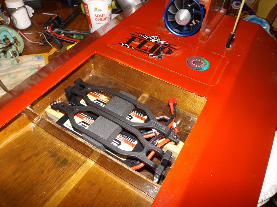

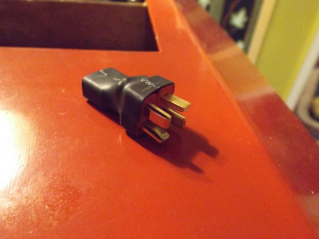

                    Next, we need a place to put the two Lipo batterys. In the cockpit area, I mounted two battery hold-down systems for............well....battery hold-down. Notice this neet, ready made plug for providing a series output for your two Lipos. They are also available in parallel. With that in place, I will be able to see the best mounting location for the ESC, and then we will move on from there.Click image for larger version
Name:	Fuji transfer 1374.jpg
ID:	91885Click image for larger version
Name:	Fuji transfer 1376.jpg
ID:	91886Click image for larger version
Name:	Fuji transfer 1377.jpg
                      #55
                      That is so cool. The battery lockdown on your boat, makes me think about our subs. The installing of batteries and the way we pull them out and stuff them back in, is an area that could use some improvement. Maybe a frame for our tubes that mount to the bulkhead and the forward most end flips open, so battery changes could be as simple as drop in and close the end. Hmmmm I need to ponder on this. Thank you Mark!
                        #56
                        Ive even gone so far as to build a tray that goes in the forward battery section, made out of sheet plastic, that securely holds a battery and the esc.
                          #57
                          The hold downs are off the shelf "Traxxas" units, that I started with and I modified them for this boat. Because the Swamp buggy has a roomy open cockpit, it worked well. Other boats are not so roomy.

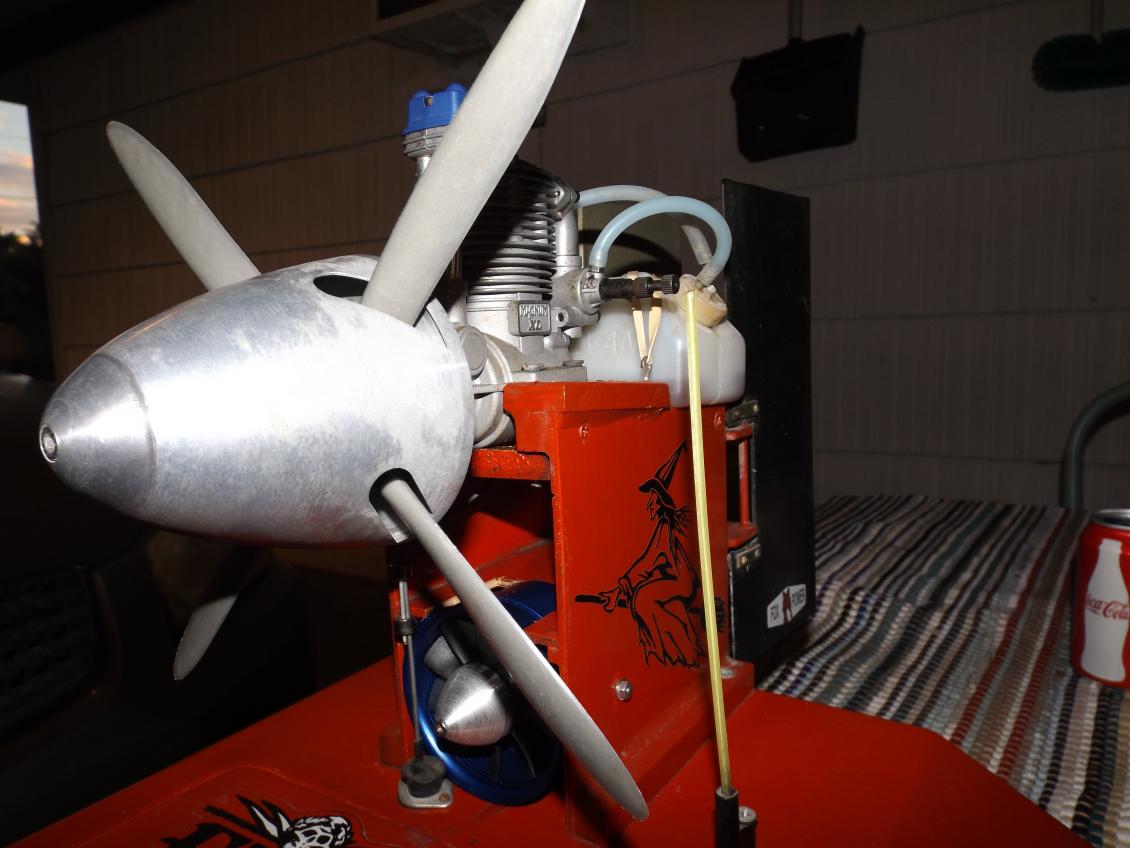

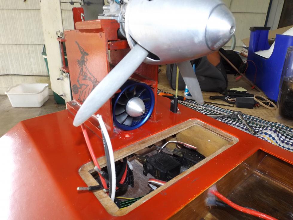

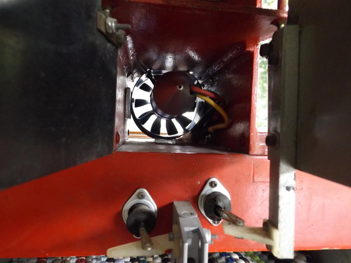

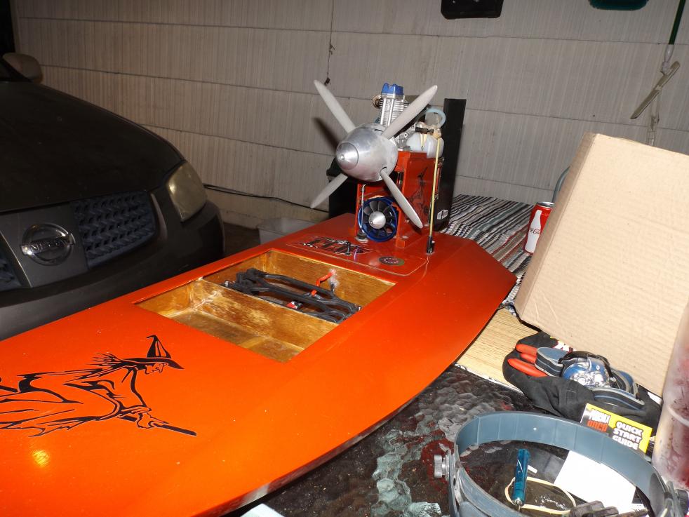

                            OK ...finally all installed. Now I need a day for testing.Click image for larger version
Name:	Fuji transfer 1295.jpg
ID:	92529Click image for larger version
Name:	Fuji transfer 1296.jpg
ID:	92530Click image for larger version
Name:	Fuji transfer 1299.jpg

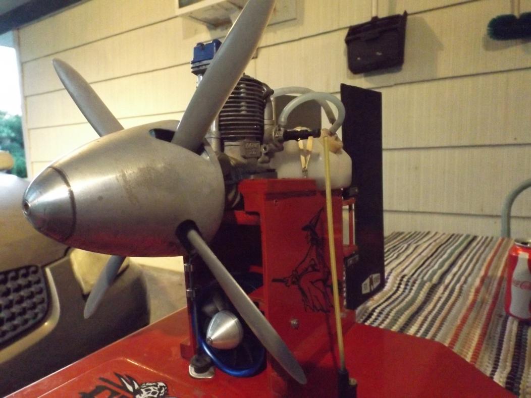

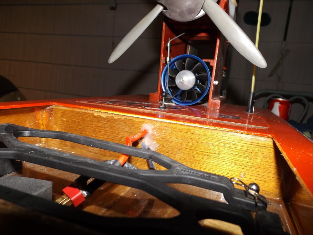

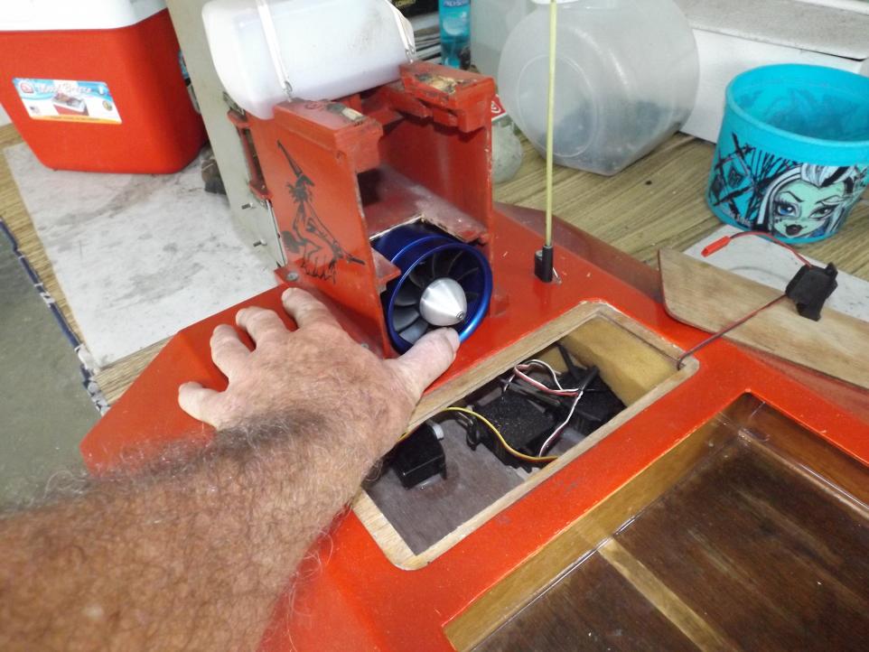

                              #59
Name:	Fuji transfer 1301.jpg
ID:	92532Click image for larger version
Name:	Fuji transfer 1302.jpg
ID:	92533Click image for larger version
Name:	Fuji transfer 1303.jpg
