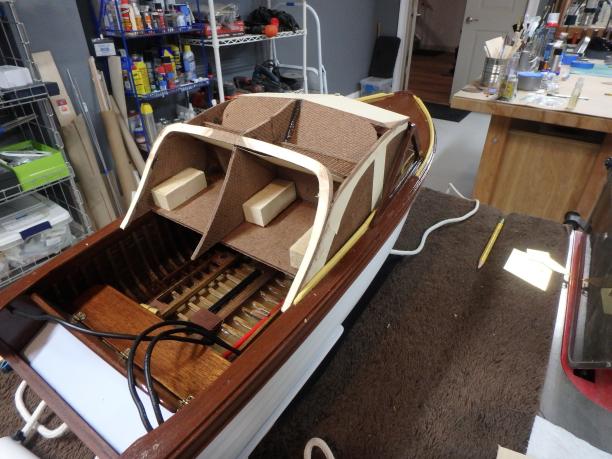

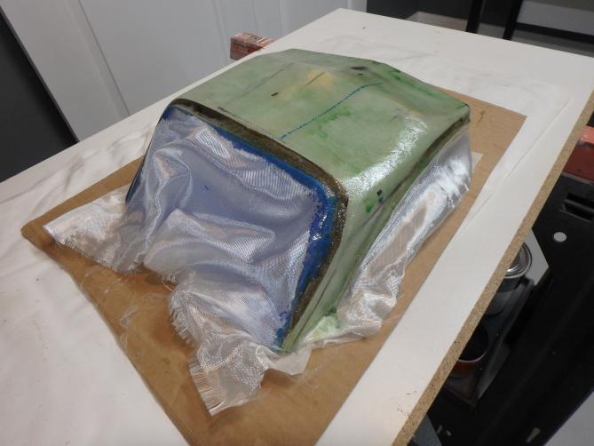

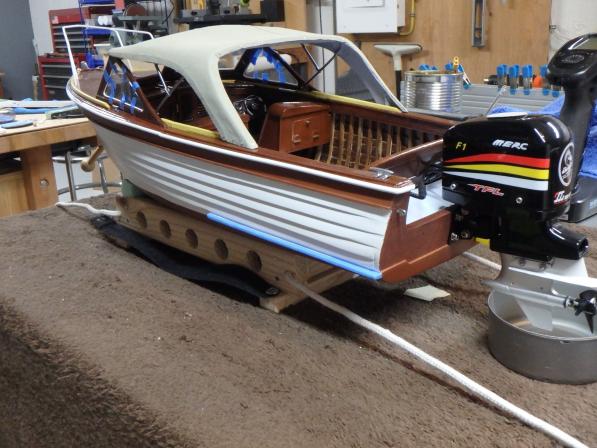

    I had to make the navy top from GRP, duplicate the sags and wrinkles and cover it with muslin. Then match paint to period Duck material. Then added simulated lift the dot fasteners.-BG

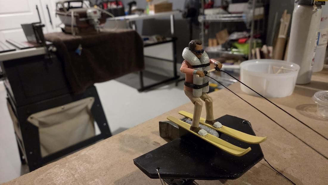

        Click image for larger version  Name:	20260928_164524.jpg Views:	0 Size:	68.1 KB ID:	197975 I have been experimenting with this guy... And it seems promising! He's been in the water twice behind the fish Pole.. first time it did not work well, after a few changes the second time (added a foil made from construction foam and grp sheet then connected further out on that wing for more lateral stability, at this point he cannot stay inverted or lying down on the water he will always stand up in the ready"to go"position... Ski tips just out of the water and leaning back with the water at the back of his head)- he got up twice behind the fishpole. I lowered his center of gravity and raised his center of float- I'm hoping for the third test to be Sunday. If being towed behind the ugly stick goes well-I'll hook him up to the Thompson.

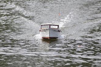

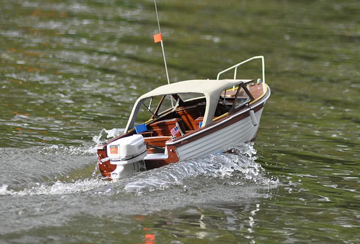

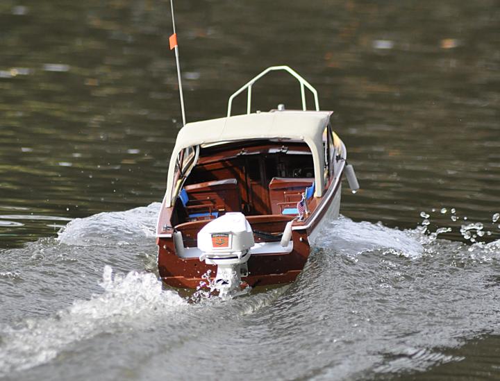

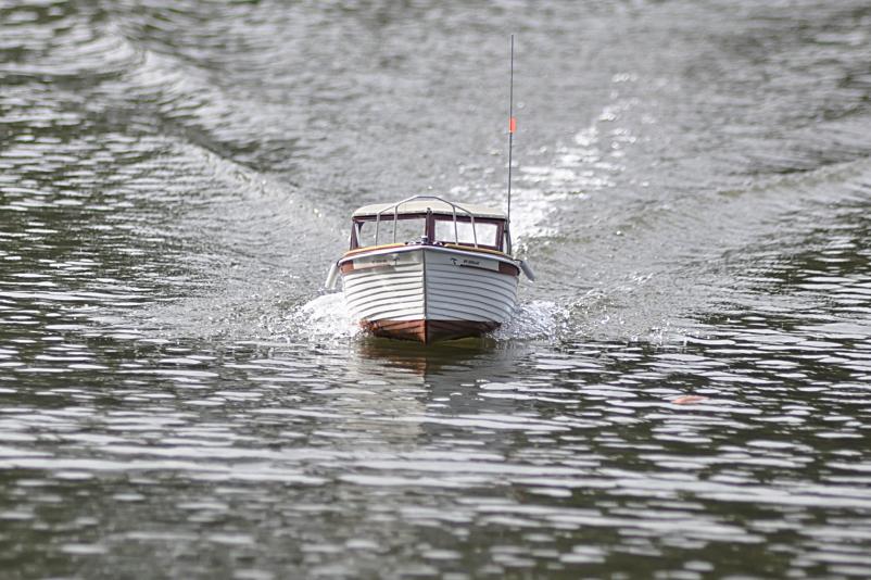

            Here's some finished boat underway pictures. (courtesy Capt: Sub Ray Mason)
            Click image for larger version  Name:	lYiBmrdQ.jpg Views:	0 Size:	83.0 KB ID:	198096 Click image for larger version  Name:	Thompson.jpg Views:	0 Size:	66.9 KB ID:	198098 Click image for larger version  Name:	DSC_0748.jpg Views:	0 Size:	61.9 KB ID:	198099
