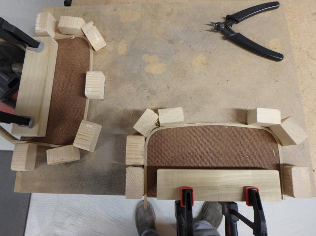

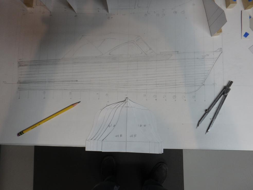

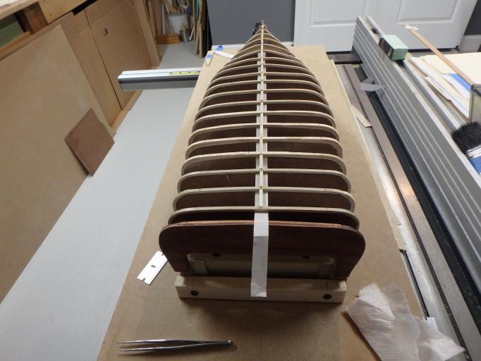

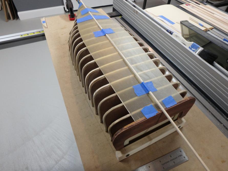

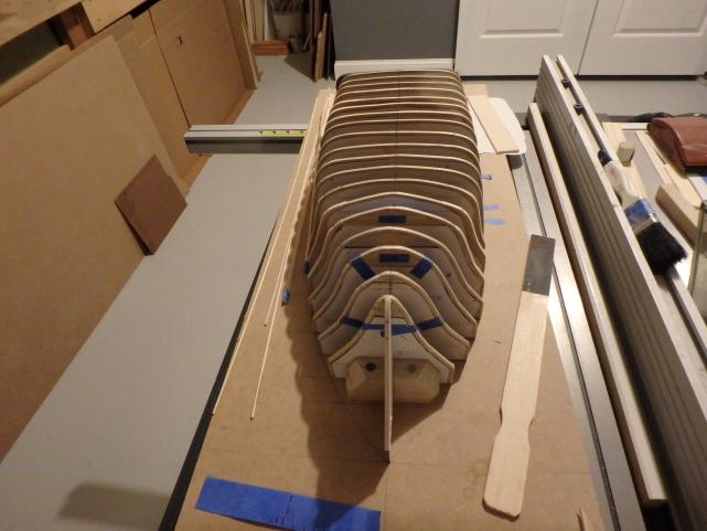

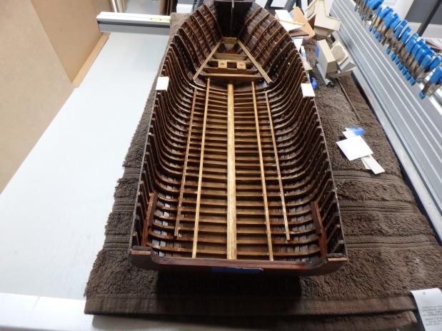

    Since there are no real bulkheads to stiffen the hull (and nowhere to hide the RC equipment) everything will be visible inside and out -
    I decided on using a fiberglass plank in place of the 1st plywood garboard plank that Thompson used to keep the hull ridged. The ribs are CA tack glued to the Masonite formers down in the datum area and notched into the building board for easy removal after planking.

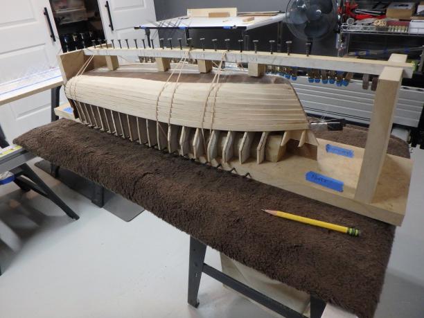

    • Bob Gato
      • 898

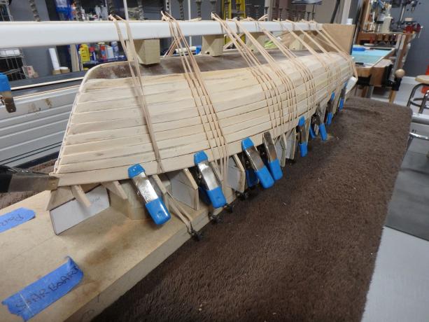

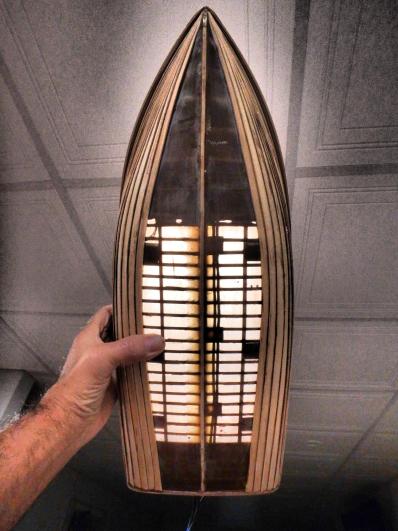

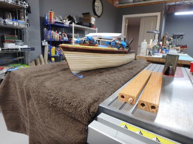

      I am using spiled basswood planks epoxied to each other and onto basswood ammonia bent ribs -very similar to the 1:1 method.
      Surprisingly the planked hull was way stronger then I had expected!

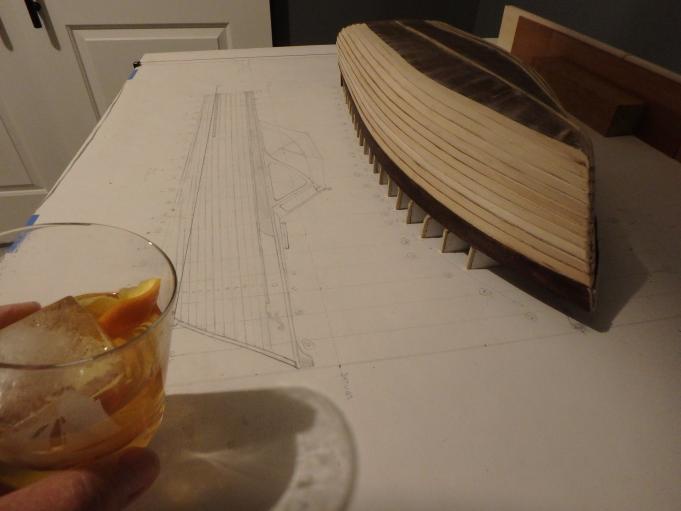

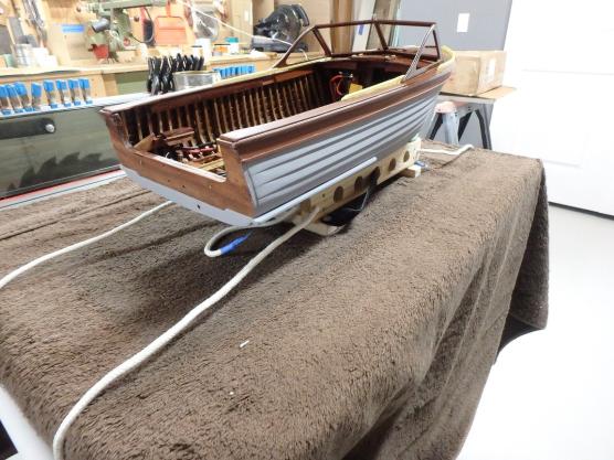

        The last (Whiskey) Plank has been secured. " Here's to successfully closing up the hull" as customary at this point- a sip of whiskey and a drop down the length of the stem. Thanks to all who cheered me on-one of my most challenging and complex scratch built hulls yet!

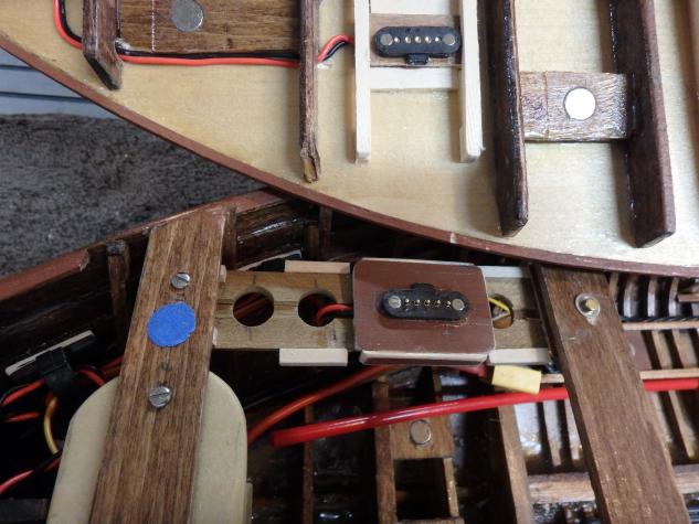

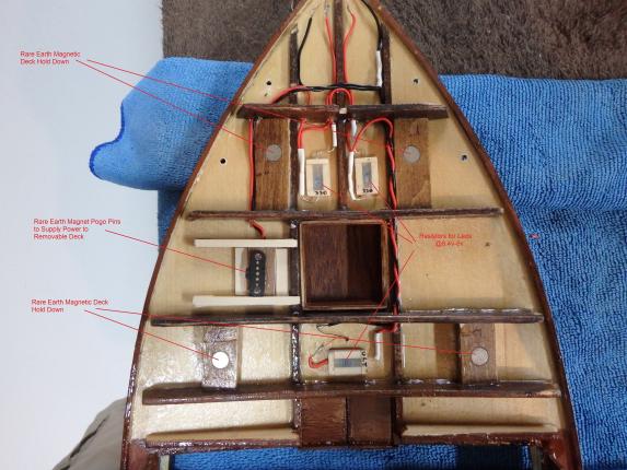

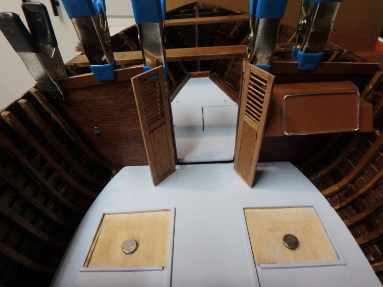

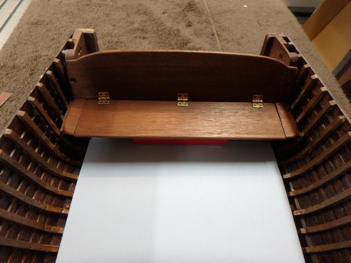

              Since I have no place to hide RC equipment, I decided to make the entire fore deck removable and attach by rare earth magnets-The Battery, receiver, steering servo and the resistors for the LEDs will be up there counterbalancing the outboard motor hanging off the transom. The windshield and glazing are being mocked up-they will be the last to go on permanently (for fear of damage) Note: the windscreens will be operational. The power for the lights will transfer via self aligning magnetic "pogo pins" The removable companionway bulkhead is being fabricated ...and the aft bench seat is where I will hide the Python ESC
              -BG

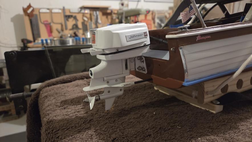

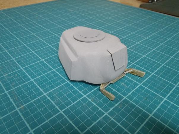

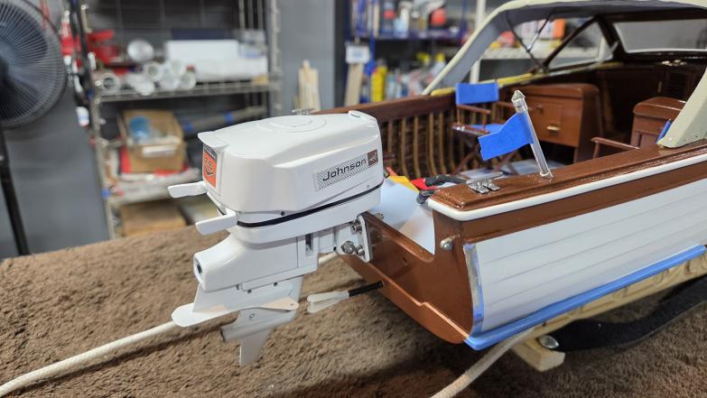

                    • 898
                    Well I might as well tell about the motor-It started as a cable driven TFL mini scale outboard as mentioned above...It is a gofast outboard out of the box and I had to tame her down-also the modern looking Merc didn't hack it on the back of a 66year old boat. I made a plug accordingly and molded a new cowl incorporating 1960 points of interest and removed much of the unneeded empty space-beside needing some cosmetic changes, it also needed mechanical work. It now has a 1200Kv B/L motor and a CNC aluminum two blade prop which allows the boat to plane and cruise unaffected while sucking in vent air from under and around the hull. I also fabricated a cavitation (vent air) plate both for looks and corralling that air from above the prop. I also needed a steering horn since I decided to use a Sullivan cable to steer from below the waterline as a result of only having 1/4" space below the deck and above the ribs. the cable runs forward and comes above the water line as it curves up to the steering servo mounted high, just below the fore deck. Also note the carved aluminum lower unit -its not 100% 1960 but it sends the viewer's mind in the right direction. Decals and other markings courtesy Bob Gaito-BG

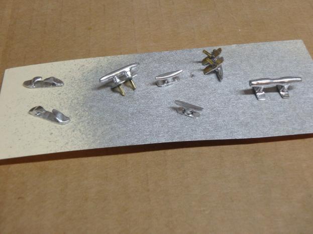

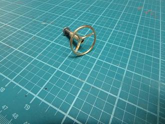

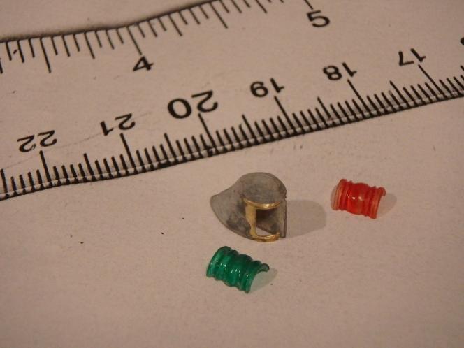

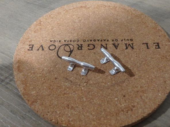

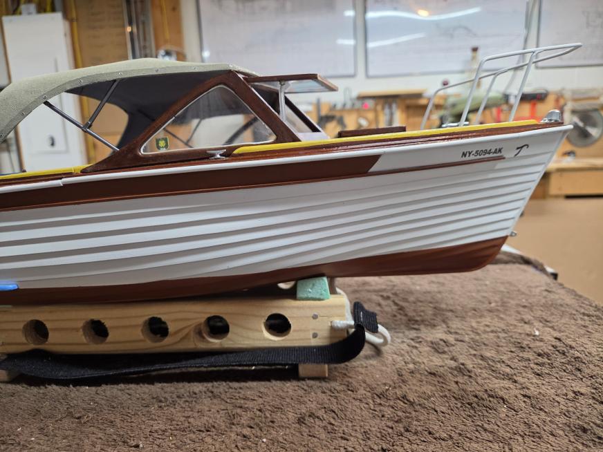

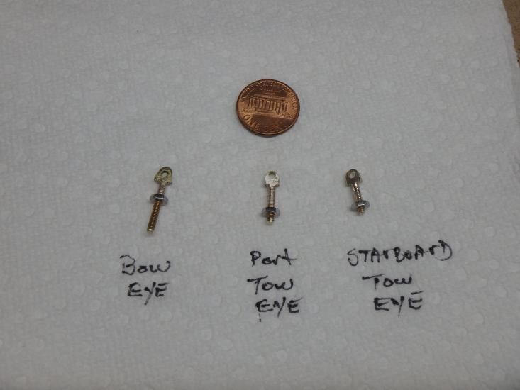

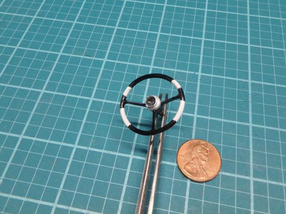

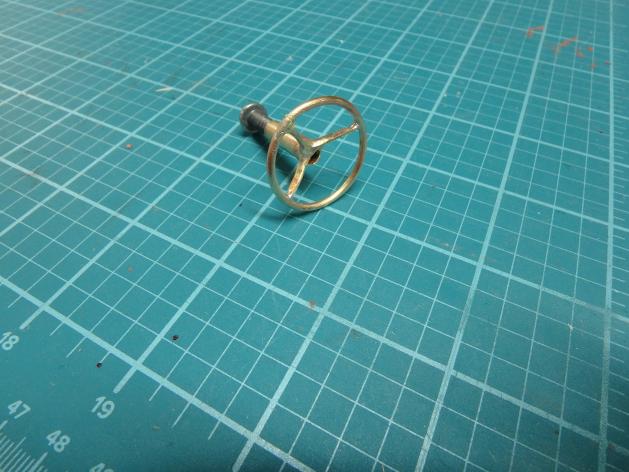

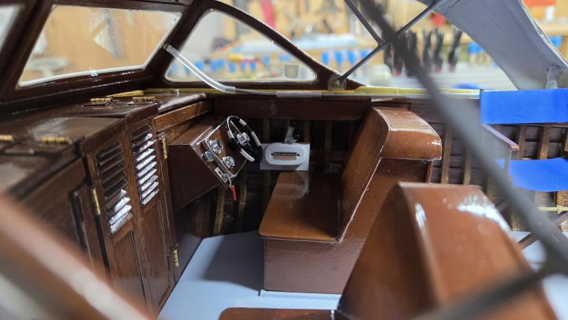

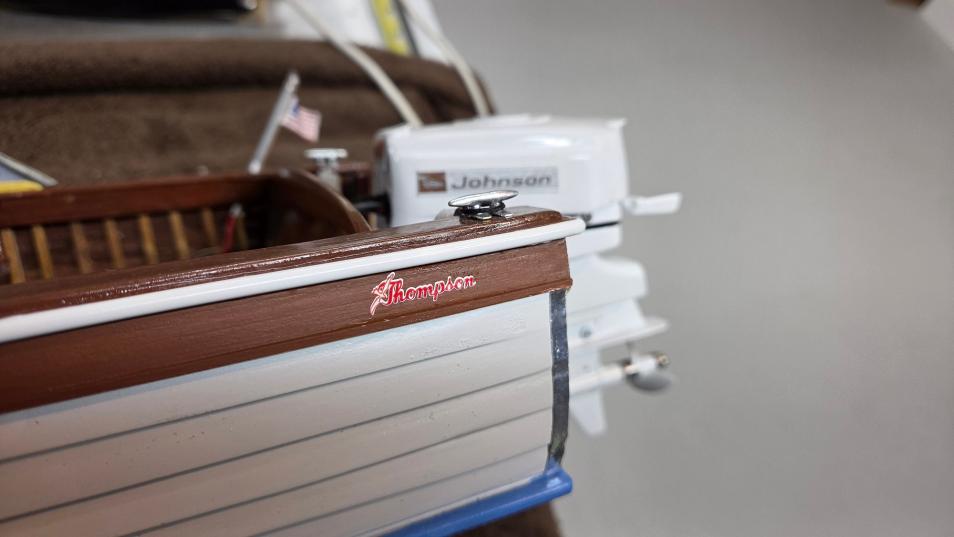

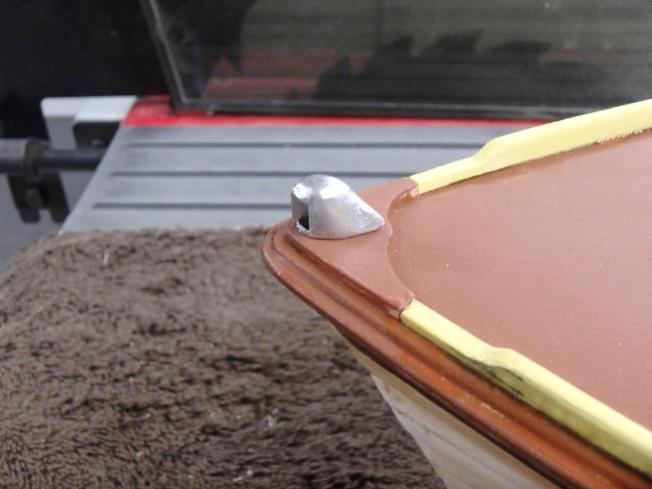

                      I fabricated several items to do just that. The detailed cockpit with period gages -a scale steering wheel(very rare) that was on the 1:1. Johnson shift master control with a Bob Gato repro decal, brass cleats, showing two of the six on board...Bow nav light made from two masthead lights (Harbor Models) which I cut in half to use the lenses in a home made brass and JB weld Perko housing. The Thompson aft quarter badging (purchased from Callie Graphics) Just send her your drawing and she can make almost anything (these are 0.8" x 0.2" with two color and a white perimeter border) ...Replica deck chairs that were on the original 1:1- the tow eyes made from silver soldered brass 2/56 screws.
                      I also needed to replicate the US Coast Guard Auxiliary Courtesy Inspection sticker that was in the corner of the side window of my Dad's boat every year-I could only find an image of one from 1966 so I photo shopped it into a 1961 sticker (can be seen in the cockpit picture below).
                      -BG

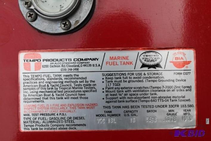

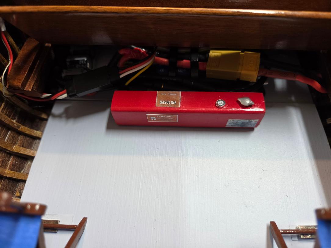

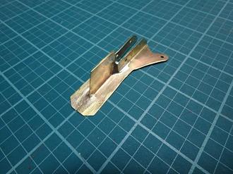

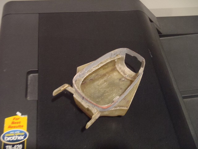

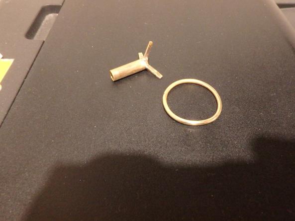

                        I needed a MFG plate for the Tempo fuel tank that I am using to hide the ESC under the aft bench seat-but it showed that it was made in 1967 so I photo shopped a 1959 date instead...then there is the brazed assembly to be the anti-cavitation plate and my steering horn that is bolted to the lower unit of the modified outboard...The ships wheel (readers digest version-3 steps) and also more bling...and out of sequence is the view of the magnetically held Tempo fuel tank hiding the ESC under the hinged aft seat (yea I know its not sitting straight- the two screws that hold it are not in place...its the only picture I had
                        BTW that QTY gage is 1/8" diameter -BG
                        iClick image for larger version  Name:	1959.jpg Views:	0 Size:	58.1 KB ID:	197785 Click image for larger version  Name:	20260819_105301.jpg Views:	0 Size:	75.0 KB ID:	197786 ​​​ Click image for larger version  Name:	P4210007.jpg Views:	0 Size:	43.5 KB ID:	197787 ​​ Click image for larger version  Name:	P4240017.jpg Views:	0 Size:	27.4 KB ID:	197788​​ ​ ​​ Click image for larger version  Name:	P5190076.jpg Views:	0 Size:	34.9 KB ID:	197791​ Click image for larger version  Name:	20260819_105254.jpg Views:	0 Size:	75.9 KB ID:	197792
                        Click image for larger version  Name:	P4240020.jpg Views:	0 Size:	48.5 KB ID:	197789 Click image for larger version  Name:	P5020032.jpg Views:	0 Size:	45.8 KB ID:	197790 ​
